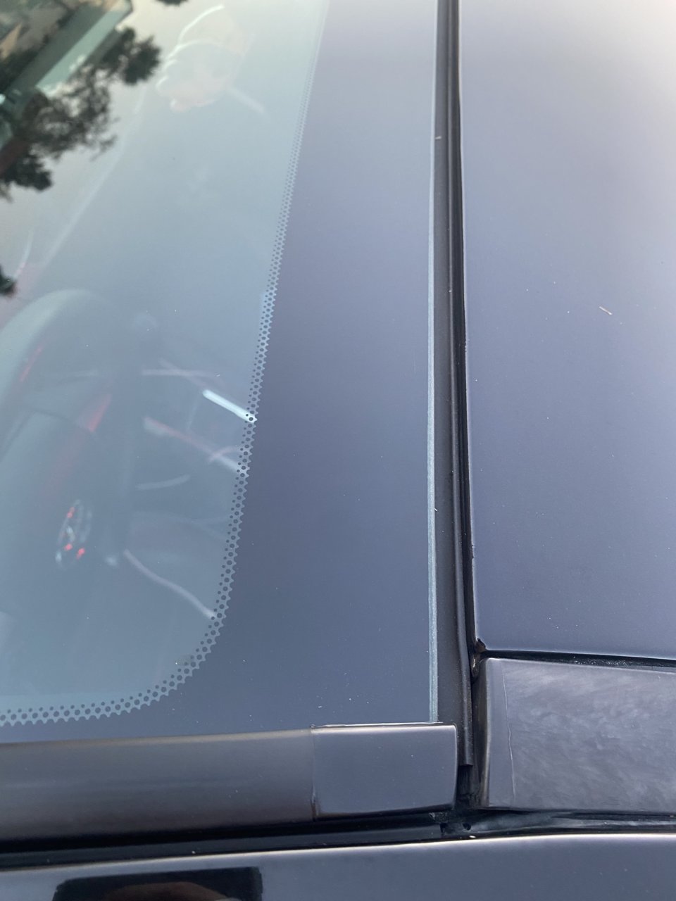

    Here are pics of the top driver side corner and looking down at the mounding. The side gaps appear even with the passenger side.
    Anything look off?

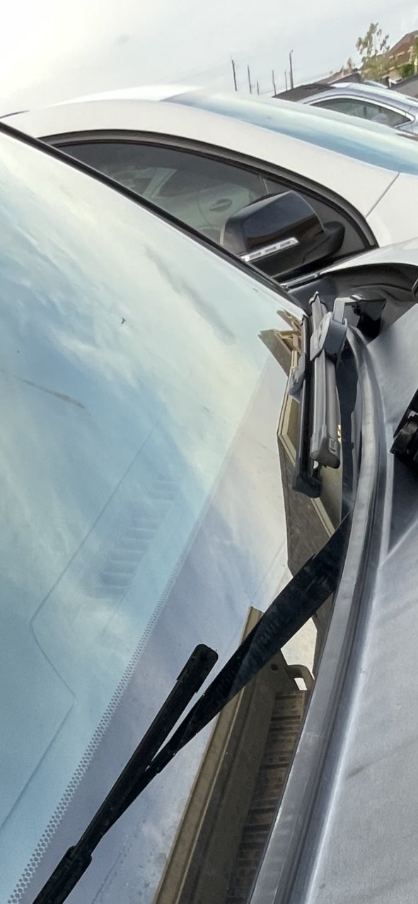

    I too just got my windshield replaced and immediately noticed the gap on the cowl right below the passenger wiper. Luckily , I took some before photos and the gap was there on my OEM windshield. I bought the truck brand new in 2018 and this is my first windshield replacement so it must be normal. I’m posting the before picture for reference.

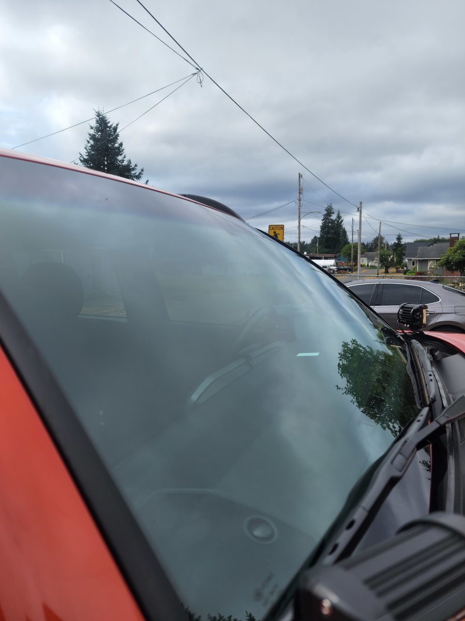

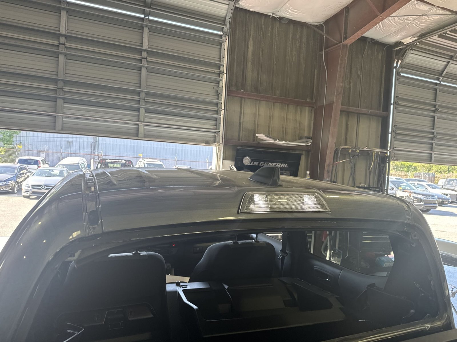

    alright im back with pics, and it just so happens that I had a 22 tacoma come in for a windshield replacement, so I did some documentation of that one. Certain steps I couldn't take pictures of, just because I don't have the time to do it, and I have to get the next step done within a certain time, or the urethane will start to cure and then that fucks up everything for the rest of the window. Fair warning, this is going to be picture-heavy and documentation-heavy. if anyone has any questions, feel free to ask, but ill show a picture or two and then explain that picture.
    first off. this truck was a 2022 tacoma, TRD OR with a 6MT, with 8600 miles on it. IMG_6342.HEIC.jpg

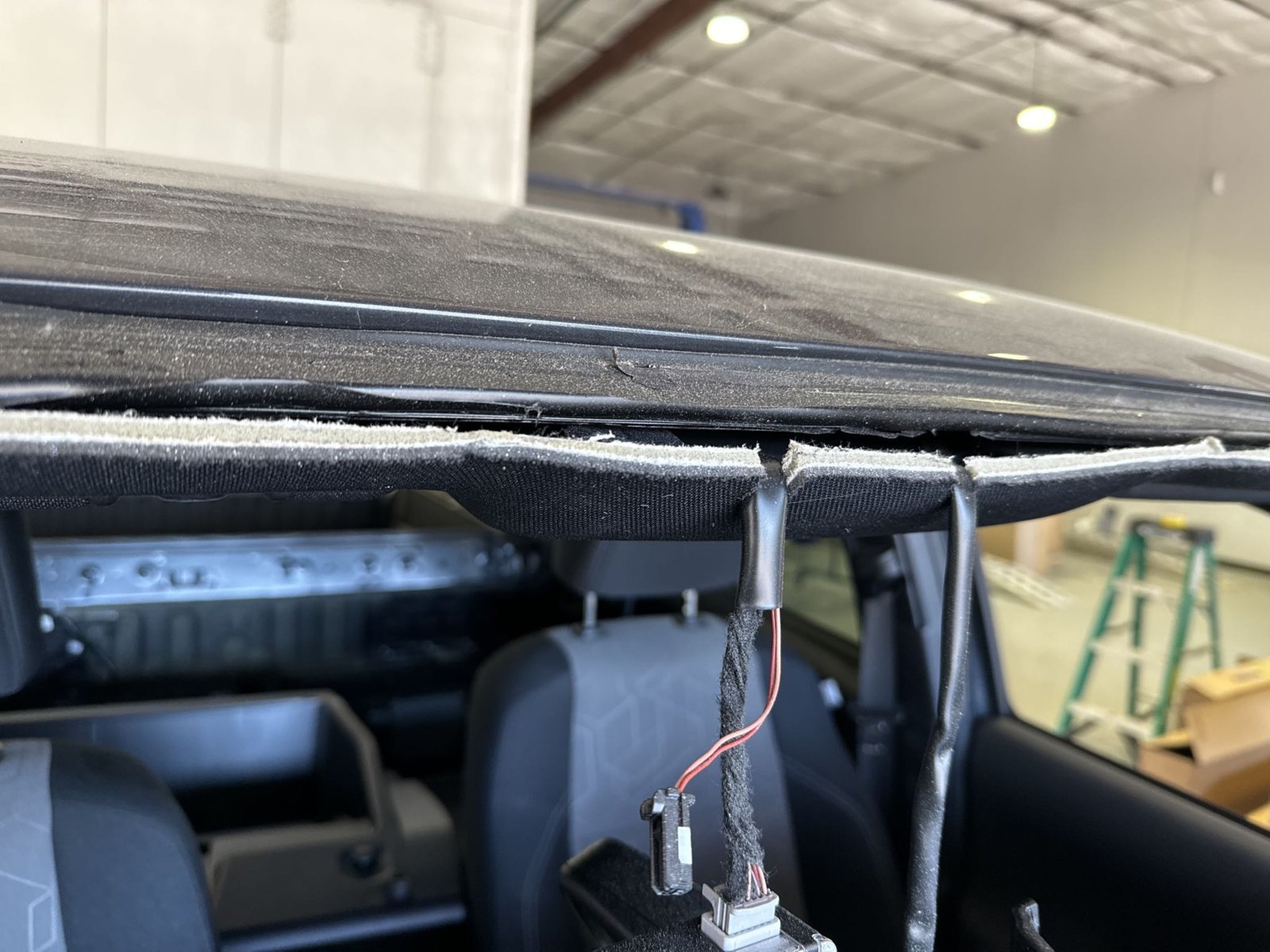

    to stay on the original topic of this thread, these are the cowl 'fingers' I was talking about in my last post on here. its hard to tell, but you can see the little outjuts on the cowl, and you can see how they slide under the window and 'grip' on, holding the cowl downIMG_6337.HEIC.jpgIMG_6339.HEIC.jpgIMG_6340.HEIC.jpg
    with these photos, there is no actual 'seal' on the cowl. the cowl isn't watertight, or have anything to do with how your windshield sits, or how it seals to the body of the car/truck. the main purpose of the cowl is actually just as a dust shield and aerodynamics, making it so that a ton of dust/wind turbulence doesn't build up in the engine bay/above the firewall. you can see with the fingers on the cowl, there's a lot of them, and the tolerances for them are pretty tight, so if the cowl is heatwarped/bent at all, it will end up making it so that one or two of them cant seat properly without having a lot of torsion on the rest of the plastic, risking breaking it, so there's no 'harm' that can come from having one or two of the fingers not lined up under the windshield(don't get me wrong, the OCD part sucks, and I'm the same way, but sometimes there's only so much that you can do about it without just getting a new cowl entirely, and the tacoma ones are stupid expensive for some reason).

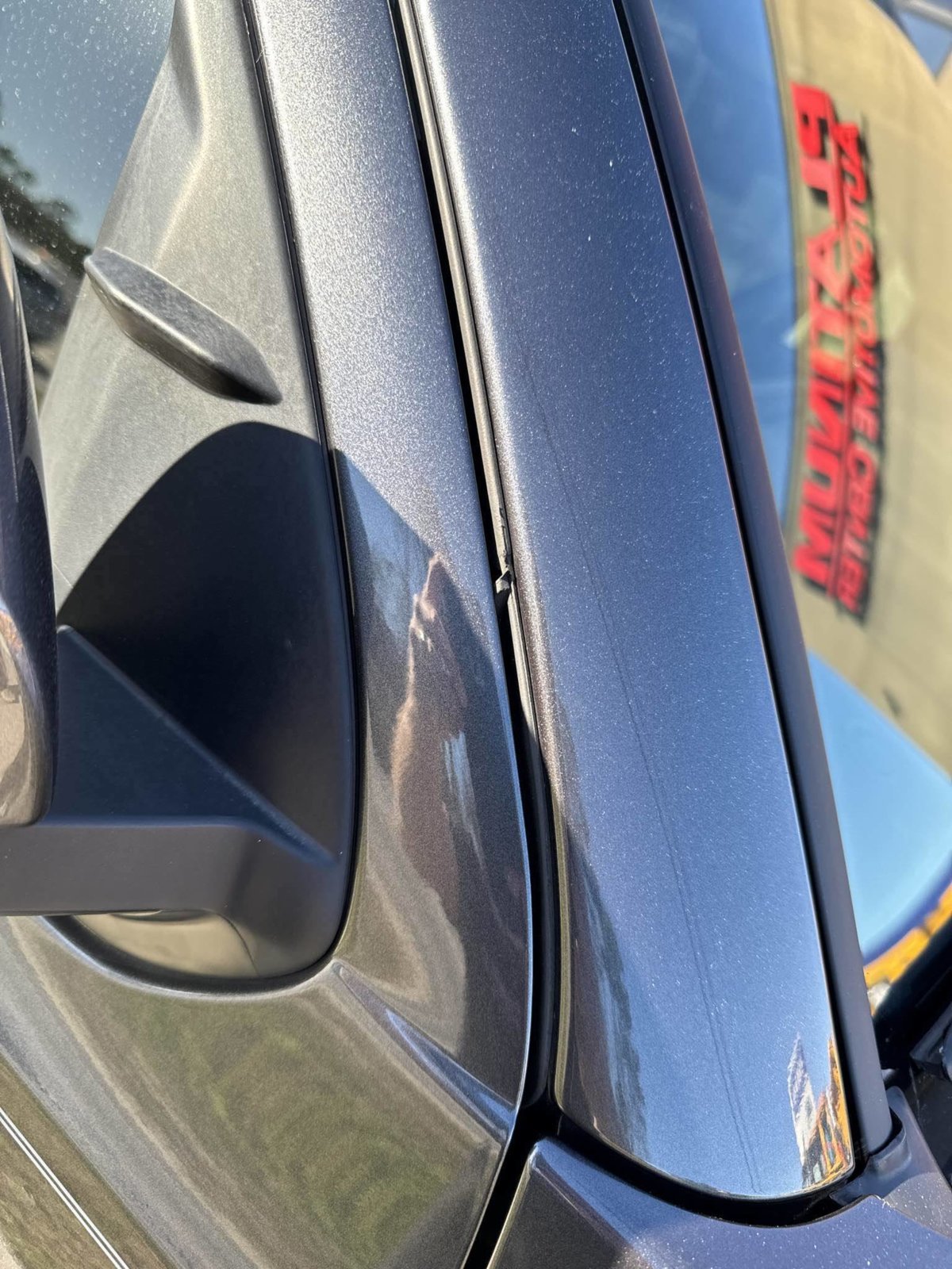

    its difficult to see, but this truck has had the windshield replaced before, and I later found out that it was replaced at safelite. when they were removing the windshield, they ran one of the tools along the entire passenger side A pillar, scratching the SHIT out of it, from the top of the windshield to the bottom(estimate for repairs on this runs somewhere around $4-7k(if done the proper way) because the windshield would have the be pulled, the entire cab primed and repainted to have a proper color match, and then putting the windshield back in). keep in mind. this truck has 8600 miles on it. its a 2022. nice new truck, and safelite fucked it up BADDDDD.

    I just read your post in the "What have you done to your 3rd gen today..." thread. Thank you for this info and the write up. Helped put my mind at ease knowing there shouldn't be any leaks from that area in my last picture. Wish you were in SoCal to do my windshield lol. I noticed that I can see some urethane on my passenger pillar from the inside :annoyed:

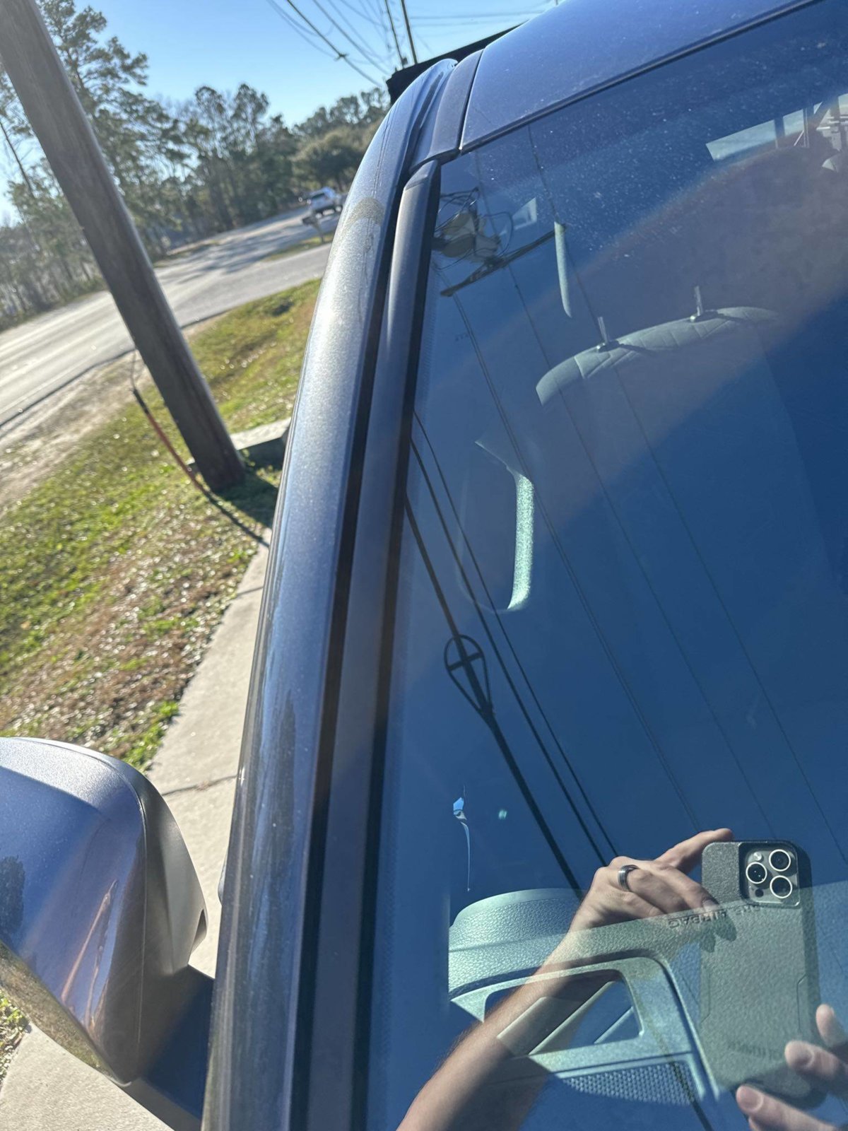

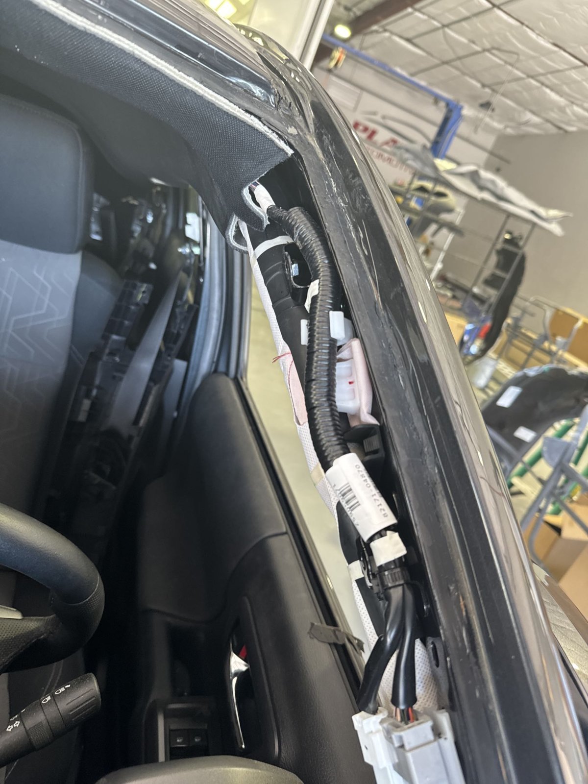

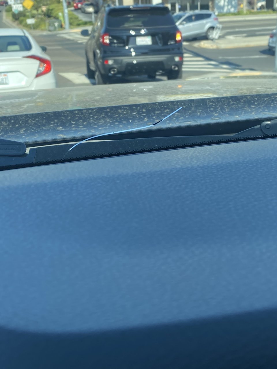

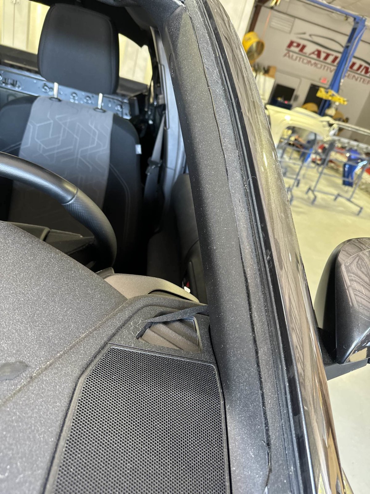

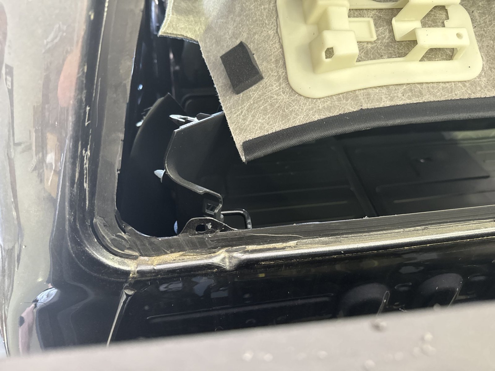

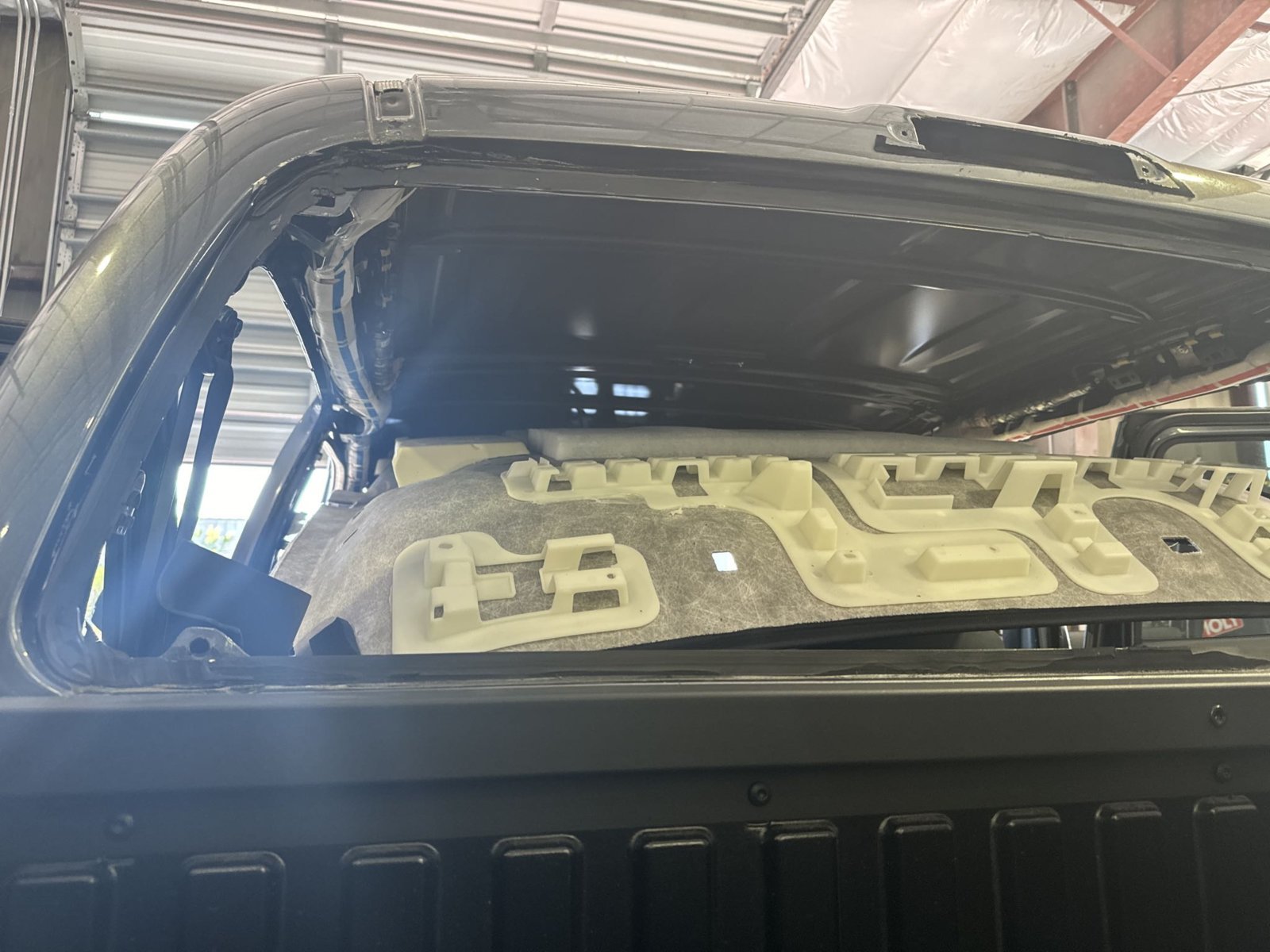

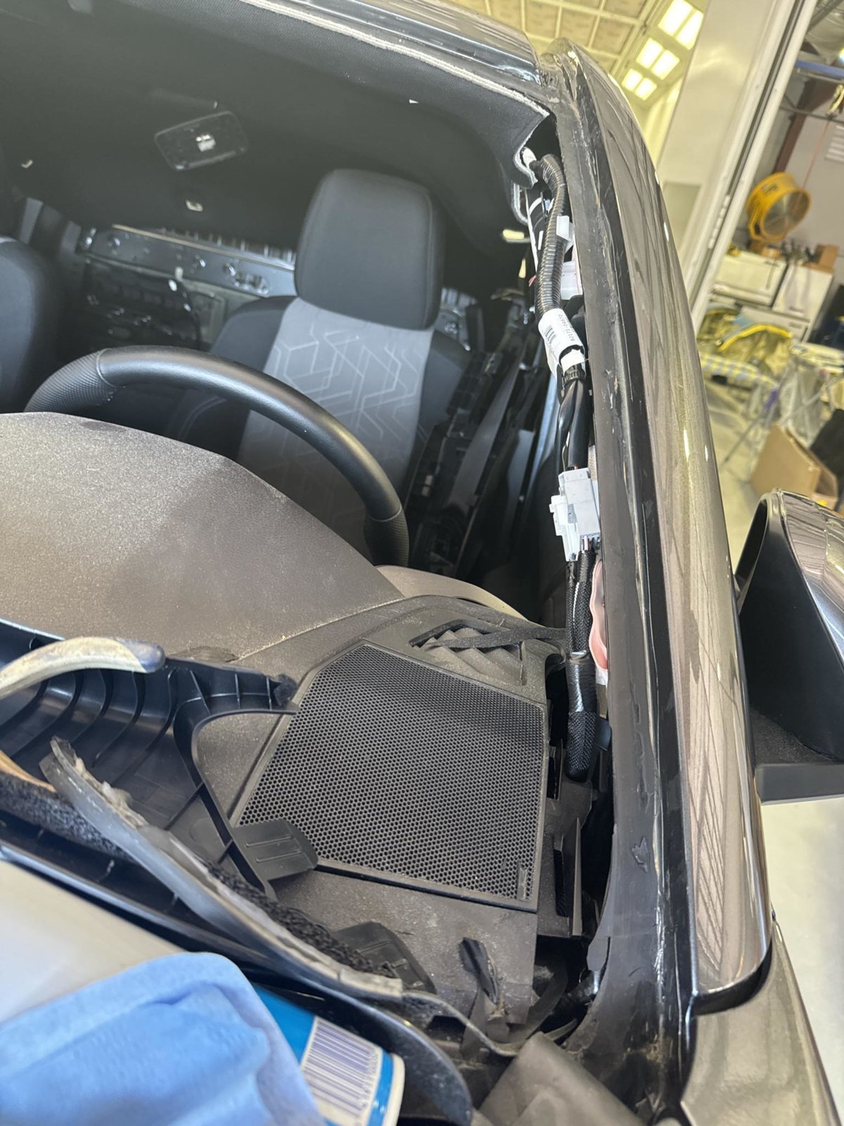

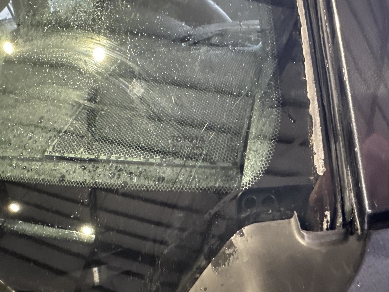

    Back in December 2023 I has safelite replace the windshield on my 2023 TRD off-road. They used non Oem glass the first time and it leaked the next day after a rain. So had to back and ask for Oem glass and they replaced the wind shield. The next day I started looking at the truck and noticed scratches on the pillar. I had to make another appointment with the shop to show them the damage. Only then did they admit to it. So then I dealt directly with safelite client services who provided a case manager. She then handed me off to Fleet Response a third party affiliate. I had 6 different case managers during the process. I kept getting handed off to the next person. The total damage was $6700. The first estimate was $1900 and then once they removed the glass they found scratches all over down to the primer. So the entire cab had to be repainted. I would never recommend safelite. This process was a nightmare to deal with. Just glad they are paying for it.
