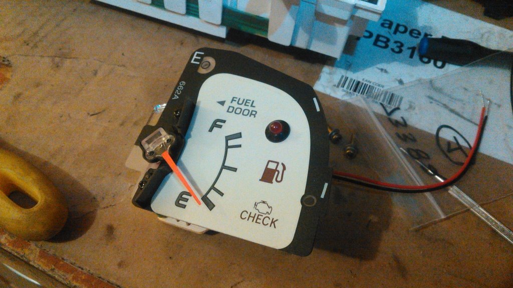

    Last night, I was able to ghetto-bend the old 5VZ high pressure power steering hose and replace the leaking 3RZ hose that I was using on there. She's got 50 miles on her so far! For break in, I'm just trying to vary the load and keep out of wide open throttle for the first 1000 miles or so.
    Here's some more videos. Yes I know the tach doesn't do anything and I'm working on it.
    https://youtu.be/CRMWFjXxQpE
    https://youtu.be/ix4zRghYFSY
    I also got around to putting in some indicator lights. Here's the light for the water-in-fuel warning. I know the duramax sensor is flaky but at least the provisions are installed for a better sensor in the future.

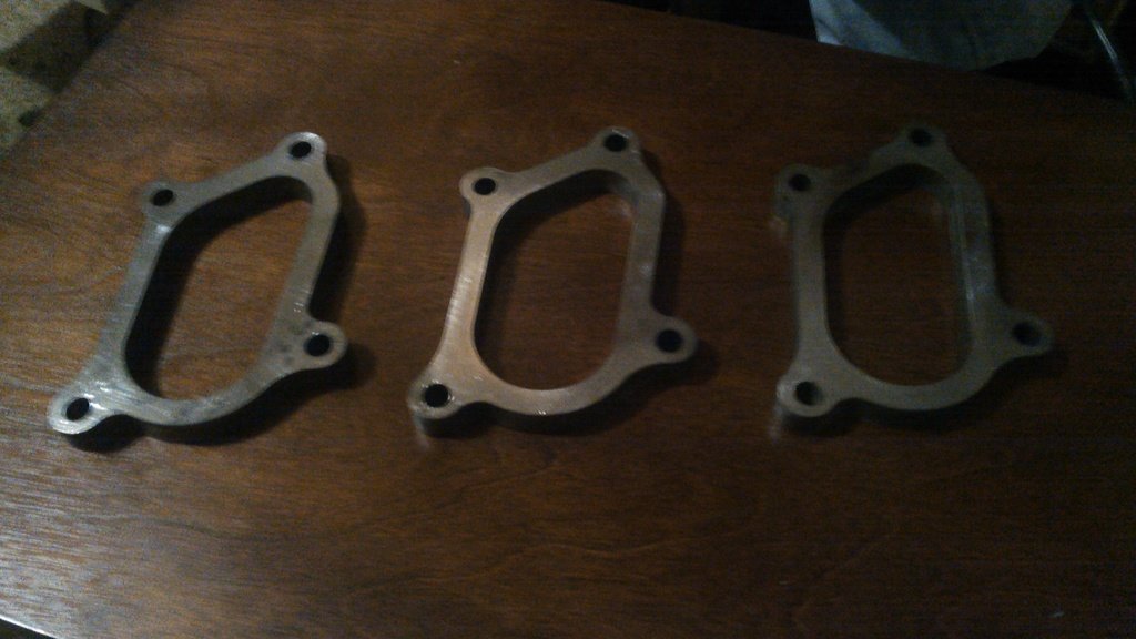

    Laser-cut flanges are in for the 3" exhaust
