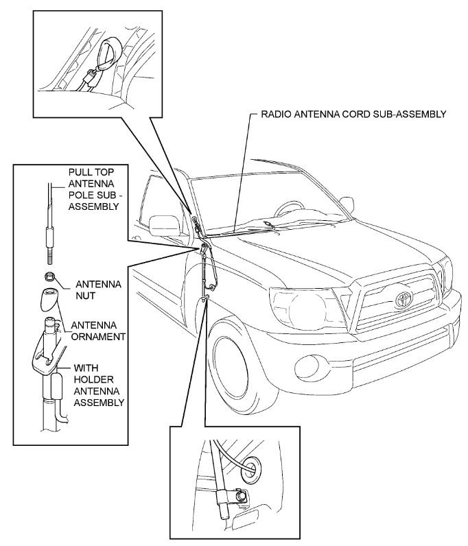

    Removing the fenders and preparing for incoming parts to repair my truck since driving it thru that barn. The antenna mount was smashed into the fender. How do I disconnect the wire? I’m like 10 minutes away from cutting it. I am not removing the radio.

    The connector for the fender-mounted antenna is behind the passenger side A-pillar upper trim.

    Removing the radio on an '08 is one face plate and 4 bolts. Easy.

    But removing the radio isn't required to replace the fender-mounted antenna assembly.

    Just replace the entire antenna assembly on my 06' a couple weeks ago due to the lower antenna assembly snapping. Only thing you need to remove is the glove box and a few of the plastic clips that hold the fender liner in place (only need to peel it back far enough to get at the bolt holding the antenna base). I recommend you pick up a pack of the fender clips (cheapest I could find is on amazon), because I didn't remove any without snapping the heads off.

    Hey, thanks for the diagram, I noticed my antenna mount is a little loose and this will come in handy.
