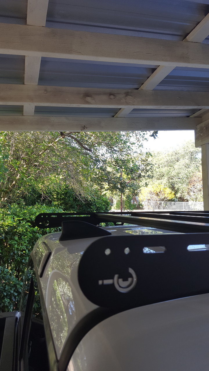

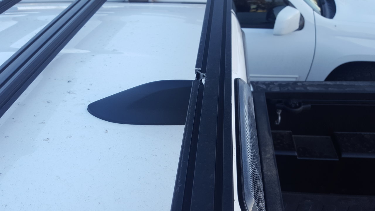

  14. Jan 22, 2018 at 8:23 PM
    darkstar51088
    darkstar51088 [OP] Member
    Sep 20, 2017
    #230538
    22
    Cody
    San Antonio, TX
    2017 Tacoma TRD Offroad Double; 2001 Tacoma ExtraCab
    Here's a crappy pic. The rack sits just above the top of the antenna but you still have to notch to get the bar to clear it
  15. Jan 22, 2018 at 8:46 PM
    OnHartung'sRoad
    OnHartung'sRoad -So glad I didn't take the other...
    Jul 24, 2017
    #224878
    9,567
    Somewhere in the Mojave Desert...
    2017 Tacoma OR 4x4 (formerly a 1998 SR5 PU, 2002 OR 4x4, 1995 4x4 4Runner, 1985 4x4 Toy PU) ... and RIP’s (rust in pieces) to a Bronco II 4x4 & S10 Blazer 4x4
    Stuff mounted on top on the Prinsu rack over the fin clears it, including my heavy RTT.
  16. Jan 22, 2018 at 8:47 PM
    #16
    OnHartung'sRoad
    Jul 24, 2017
    #224878
    9,567
    Looks good, that was a good solution for keeping it horizontal. I found instead of notching the bar, it mounts vertically well enough and tightening up the 2 bolts does hold it well enough so the 2” bar does not spin. But someone could also pin the 2nd holes if desired and for added security.
