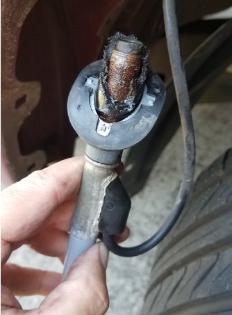

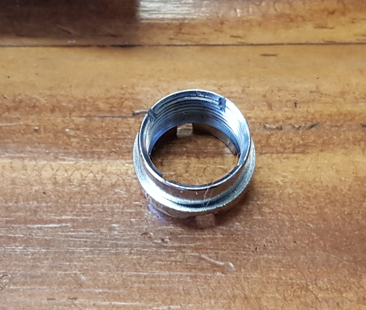

    When I replaced mine, the threads were corroded enough where I couldn't just cut and pull the ornament up. Plus the plastic/rubber ornament was basically crumbling when I tried to pull on it. It was so much easier when I dropped the finder liner because I no longer had to worry about screwing up the paint trying to work on it still attached to the fender too. After I finally got all the plastic off, I cleaned up the threads with a dremel wire wheel, then used a spare antenna nut to try and clean up the threads before putting it all back together. I found the post below which helped.

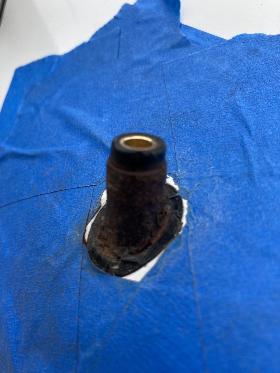

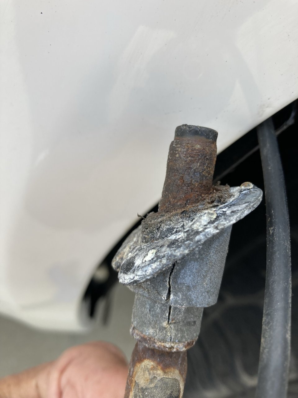

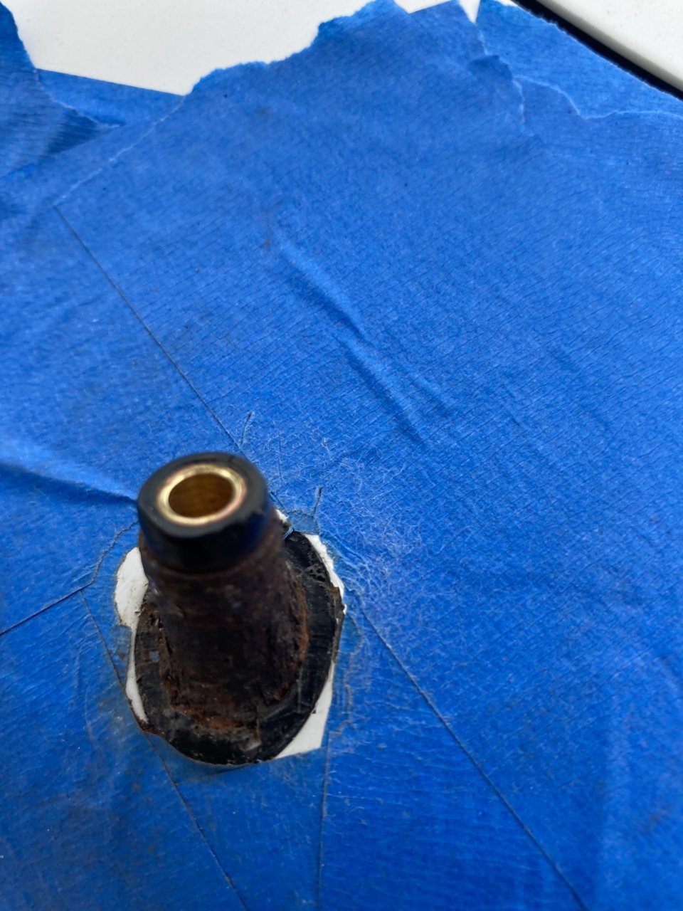

    Thanks for your reply ireymon. I removed the remainder of the nut (there was very little left) and was able to use a thin blade 1" putty knife to remove the above surface portion of the boot (after protecting the paint). The boot was so badly deteriorated that I couldn't remove it by pulling it up. In the process of removing it, I discovered a rubber gasket I did not expect that appears to be in good shape. There is absolutley no corrosion on the surface of the fender and the antenna itself is completley stable.
    On a different thread in this forum I read a number of horror stories about removing the under fender liner with most people mentioning having to buy/replace clips they break removing the liner. That, combined with the fact that my age makes getting on the ground to work from the underside difficult at best, I really would like to be able to work from the top. I'm thinking if I can compromise the wall of the boot by drilling a number of holes in it and then pulling pieces out with needle nose pliers. Does that sound realistic?

    eww, that antenna support shaft is so rusty.... but a replacement is going to have you venture into the inner fender area and find your way to the stereo headunit :(

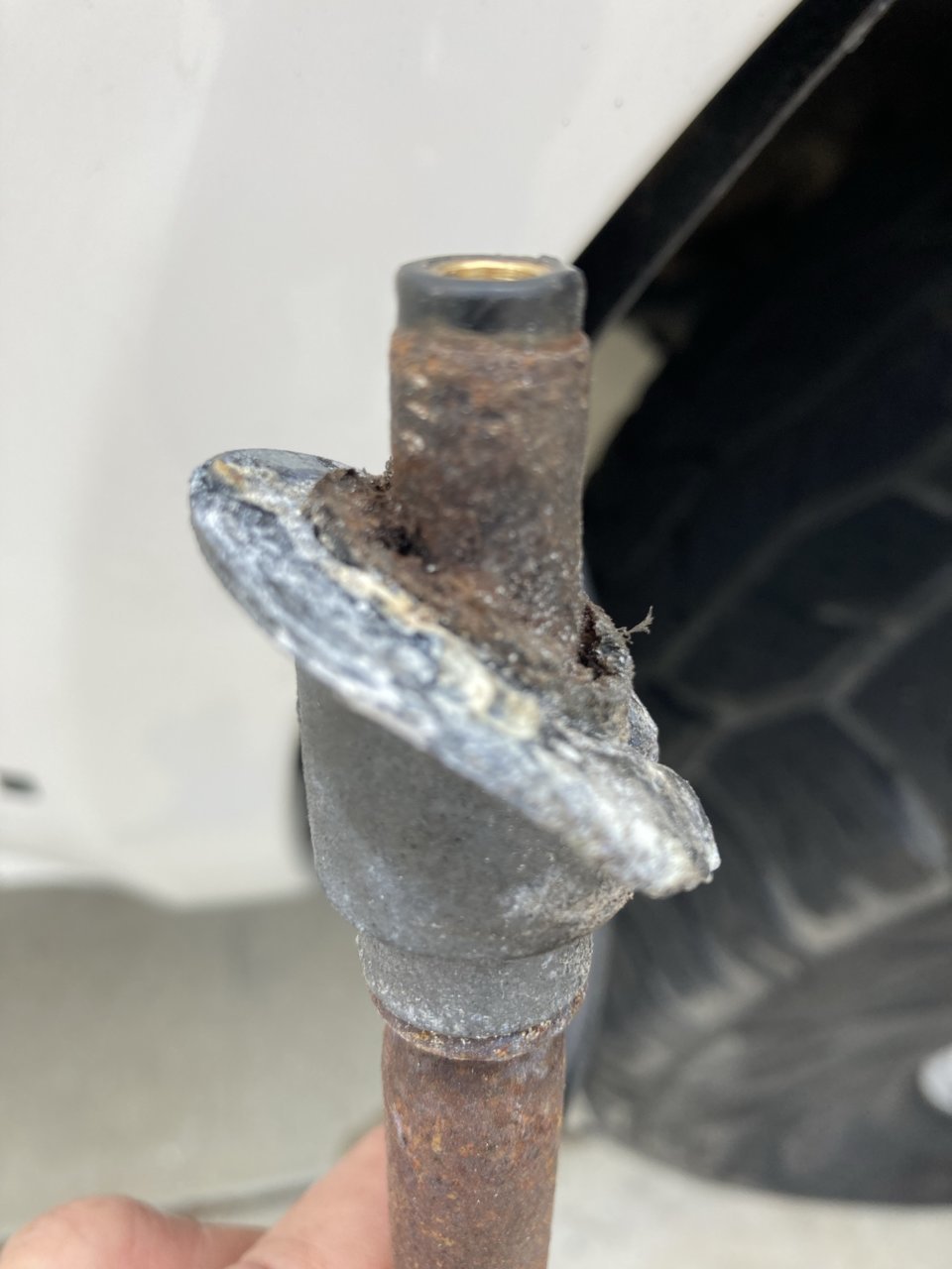

    Yeah, but it's not quite as bad as it looks. Much of what the pic shows is the rubber/plastic(?) boot remaining after I chiseled away the above fender portion of the boot. The remaining portion appears to be fused to the antenna assembly. I'm concerned that even if I pull the antenna down in the fender well that I won't be able to remove the fused boot. Since the existing antenna functions fine, if I can thread the nut onto it I may just cut off the bottom of the new boot that extends through and into the fender well and make it work; the parts arrive today.

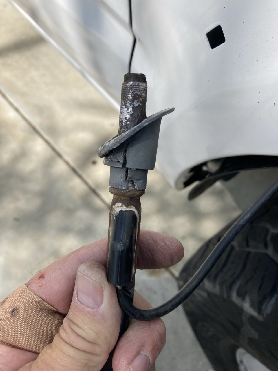

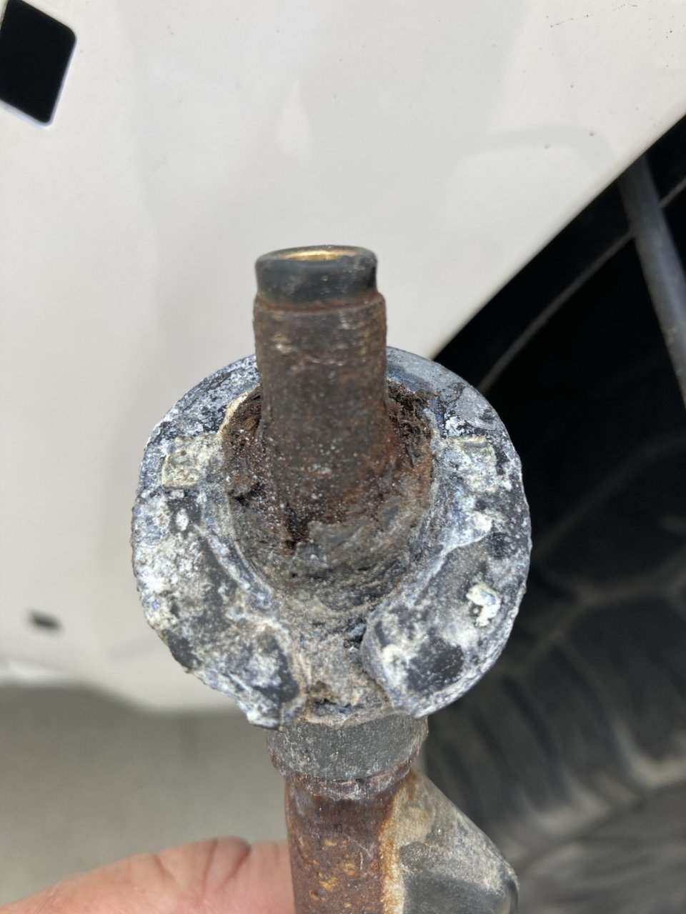

    "What I feared has come upon me; what I dreaded has happened to me." (Job 3:25) Well, determined I'd take advice given and go into the fender well. As I feared it wasn't easy either getting the flare and clips off as well as the clips on the liner. With the antenna dropped down and dry fitting the new boot it looks like it might be wise to just replace the antenna. Can anyone tell me if it is possible to locate and remove the antenna connection from the head unit without having to remove the unit? Can I just feel around back behind the unit to do the job? What I hoped would be a simple job to improve minor cosmetics is snowballing. Help!!!IMG_2019.jpg IMG_2020.jpg IMG_2019.jpg IMG_2020.jpg IMG_2021.jpg IMG_2019.jpg IMG_2020.jpg IMG_2021.jpg

    Mission accomplished. I cleaned up the old unit using a dremel. Took some effort but saved me from buying a new one and removing the radio to connect. Thanks all for your input/suggestions/help!IMG_2024.jpg IMG_2025.jpg
