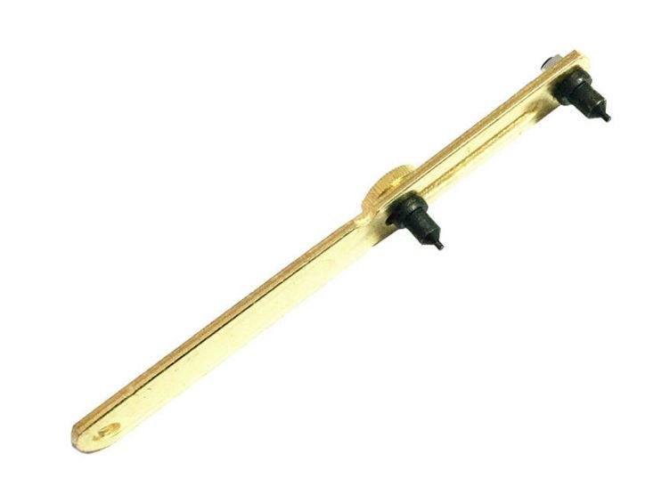

    I put an aftermarket antenna in and it ended up rusting out the inside of the mount. It was a pain to unscrew that deal. I eventually realized that the tool for opening the case of wrist watches fits perfectly. It is $5 at walmart! I figured that out after completely destroying the darn thing and taking a dremel to it to get it off.

    Old thread but bought the Amazon tool and we will see if this will work. I sprayed it with a Teflon lube a day before I’m expecting it to arrive. Maaco didn’t do me any favors on this one.

    I've yet to replace mine. I couldn't get the thing apart without that tool. The threads are boned, so just putting a new antenna in wouldn't work. Need the whole assembly, like posted in the products discussed thing at the bottom of the page.

    You don't need to take off the beauty ring. Get a new antenna whip and screw it into the hole. If the threaded piece of the old antenna is still in there, soak with Kroil, then carefully use a left hand drill bit. Worked like a charm for me.
