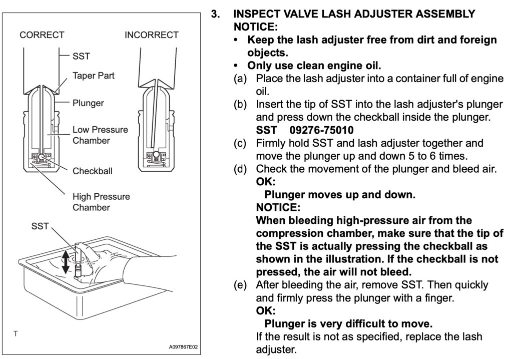

    @BassAckwards had a thread regarding noise they were making when he replaced a head I think and he confirmed you need to prime them before installing them because they drain out slowly. The Car Care Nut has a good segment on how to prime them here:
    https://youtu.be/KwPe4fUEFmE?t=1809

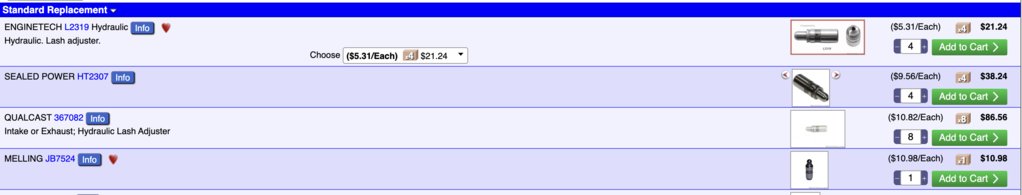

    The FSM had a really nice section on it too. The cross section helped me visiualize inside of the lifter. I got some small drill bits from HF for $4 and found the perfect size to fit into the check valve passage. It's smaller than the opening at the top of the lifter. I'll measure it when I complete the lifters I'm going to buy because 7/16 failed the compress-by-hand test. The bad ones compressed 1/16-1/8" even after being primed twice without any air bubbles coming out.
    @Dm93 and @TnShooter thanks so much for the manual info.
    I'm a little unhappy that the Toyota ones are $26 each even with a 20% off online pricing sale going on at my local dealership. Rock Auto has them for less than half on aftermarket lifters. Is OEM worth the big price difference? Got to order some by Sunday so they'll be here asap either way.

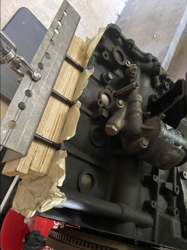

    Made a little tool for removing the short block. Was rushing hence the off center holes haha.

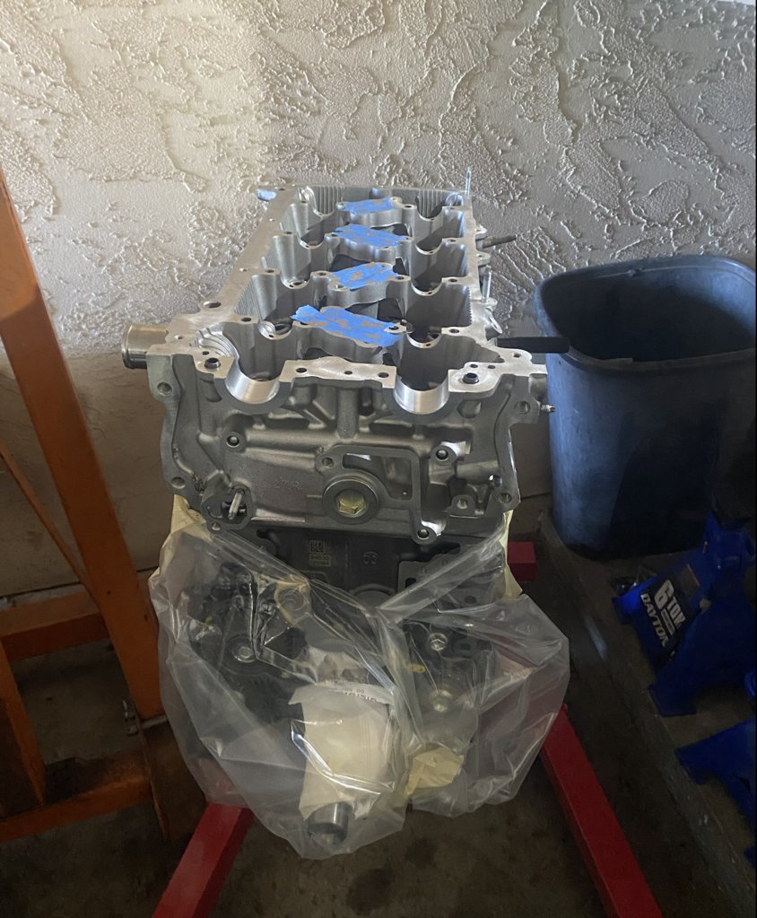

    Due to needing a new clutch at some point now that the OG had 220k on it and the oil consumption of 1 quart every 5k, I wanted to spend the money, get it all done at one time, and got an OEM short block online. @Dm93 you had said that the oil consumption was considered normal and the Car Care Nut, said the same thing (or maybe even 1 quart in less miles) these days. Going through all of this work, I just wanted to spend the $2500 and not be burning that much oil anymore.
    The big harbor freight engine stand is great for having to torque head bolts 90* two times. My other "T" shaped stand was not really going to make it easy working alone.

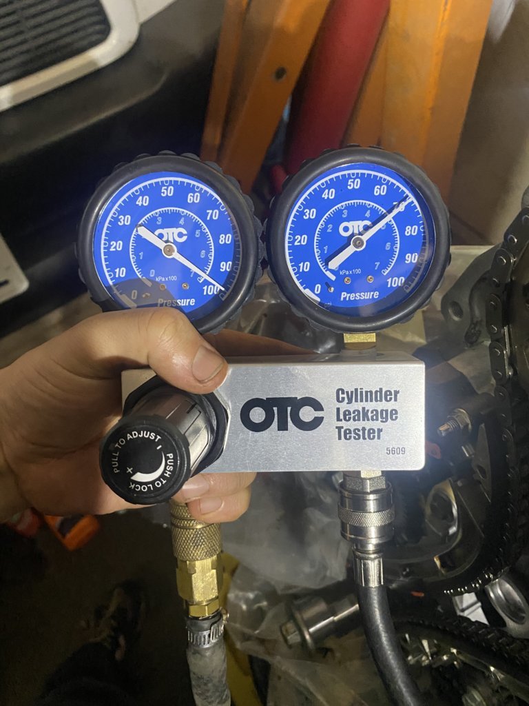

    You guys ever perform a leak down on a new engine? I had 20-25% leak on all cylinders from the exhaust. o_O
    All timing marks seemed to be lined up perfect on install.
  5. Jul 9, 2025 at 7:27 PM
    #165
    Speedytech7
    Feb 20, 2014
    #123587
    58,515
    FCQM+VG Cheney, Washington
    It's less Tacoma and more mod
    Stuck lifters? Bottom end leak down wouldnt surprise me cause the rings aren't bedded in yet. But valves should be sealing
    Dm93 likes this.
  6. Jul 9, 2025 at 11:04 PM
    #166
    Dalandser
    Dalandser [OP] ¡Me Gustan Las Tacos-mas!
    Feb 19, 2015
    #149090
    17,670
    Anthony
    Downey
    08 PreRunner Regular Cab / 98 4x4 Extra Cab
    Empty Wallet Mod
    That’s what I had been anticipating. There might be bottom end leakage but the exhaust is leaking more so much that I can’t even notice that.

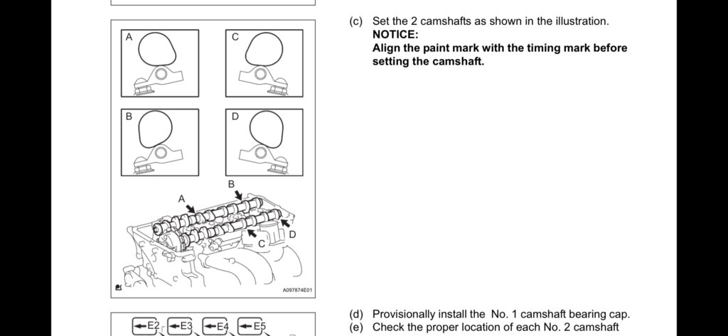

    Should camshafts drop all the way in and rest on the journals when them? When I put them in according the the FSM, like this:
    the bearing caps were floating about a 32nd to a 16th of an inch over their mating surface with the head until I used the pressure of the bearing cap bolts to bring the caps down to the head.
    It’s weird that both of them required some pushing from the bolts to synch them down all the way but it’s only the exhaust as far as I can tell that it’s coming out of.

    Yeah there should always be some lash. Hydraulic lifters should just squish down to take up that last little bit. It's possible there isn't a great bleed path for them right now, I would rotate the engine 720° and try your leak down again

    Did some more testing.
    Removing the cams resulted in more or less identical leakage.
    With cams / Without cams (% leakage)
    Cyl 1 - 35% / 35%
    Cyl 2 - 25% / 25%
    Cyl 3 - 15% / 15%
    Cyl 4 - 25% / 20%
    So it looks like the machinist most likely didn’t forget to grind enough off of the valve stems and it’s a sealing issue at the valve seat vs the valves still being opened up on compression due to too long valve stems / stuck lifters.
    I flipped the engine upside down to see if I spraying some WD-40 on the rings would help it seal and all it resulted in was making a fine mist of WD-40 float up from the block. Same leakage across the board.
    Next I wondered how much of the leakage was due to exhaust valves leaking vs. passing through the unseated rings. So I made a sloppy but decent block off plate out of 3/16 flat bar and squished the old exhaust manifold between the head and the plate. There was some leakage past the plate I could feel, but there were differences in leakage with the plate vs. without.
    Without Plate / With Plate
    Cyl 1 - 35% / 15%
    Cyl 2 - 25% / 10%
    Cyl 3 - 15% / 12%
    Cyl 4 - 25% / 15%
    It appears there’s significant leakage from the exhaust valves. I ordered a valve lapping tool (suction cup style although I saw Fryburger’s pal Steve Dulcich connect a drill to some flexible tubing to spin the valve stems) and some lapping compound. Then I’ll see if I can get the valves to seal with some liquids on a bench. If they do I’ll test it again on the short block. If they don’t looks like it’s eBay remanufactured head time. I did not want this to be a science lab lol.
