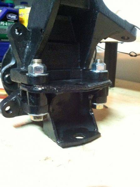

    Lol fine then! What did you do for the adapter? Could you share a pic of it? Abs hurts more thane helps IMO but you can always patch the cable and make it longer ask me how I know lol
  8. Dec 8, 2013 at 7:43 PM
    #1028
    anthony250f
    anthony250f [OP] Well-Known Member
    Feb 18, 2012
    #73066
    16,772
    Anthony
    San Diego, CA
    2008 dcsb trd offroad 4wd
    there are triangle supports on the uniball adapter...you have to grind/cut them down for it to slide into the doube sheer....few hours worth of ditting
    heres why abs doesnt work
    you can see where i cut behind the spacer

    Looks identical to the bottom of engage's race spindle, did you make the adapter? Looks awesome!
  11. Dec 8, 2013 at 8:50 PM
    #1031
    anthony250f
    Feb 18, 2012
    #73066
    16,772
    Anthony
    San Diego, CA
    no its the engage adapter just modified it to work with the spindles haha
  12. Dec 8, 2013 at 9:02 PM
    #1032
    Emtmeyer
    Emtmeyer Angrytaco
    Sep 24, 2012
    #87640
    649
    Brad
    Bakersfield,ca
    07 prerunner 5spd
    4" maxtrac spindles, extended brake lines, custom fab bumper, sound system, 33x12 federal couragias, cibie driving lights, otrattw dash switches
    So you just added the tube pieces between the double sheer? I feel retarded, I'm not understanding lol
  13. Dec 9, 2013 at 8:53 AM
    #1033
    anthony250f
    Feb 18, 2012
    #73066
    16,772
    Anthony
    San Diego, CA
    Yes...but there were triangle supports behind the tube pieces that I had to grind from \ to - so it would fit

  15. Dec 9, 2013 at 4:26 PM
    #1035
    Emtmeyer
    Emtmeyer Angrytaco
    Sep 24, 2012
    #87640
    649
    Brad
    Bakersfield,ca
    07 prerunner 5spd
    Gotcha, nicely done, I'm gonna have to steal this design!

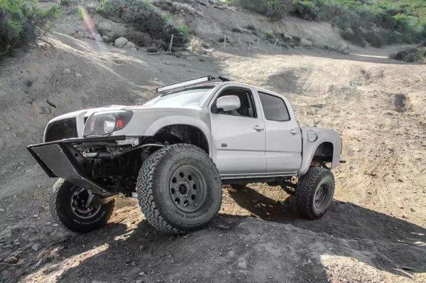

  17. Jan 3, 2014 at 9:32 AM
    #1037
    06HAOLE
    06HAOLE Well-Known Member
    Jan 4, 2008
    #4102
    3,190
    Fort Worth, TX
    2019 Ford Raptor
    That's an awesome picture. Truck looks sick
  18. Jan 3, 2014 at 2:07 PM
    #1038
    anthony250f
    Feb 18, 2012
    #73066
    16,772
    Anthony
    San Diego, CA
    I was up there Wednesday
