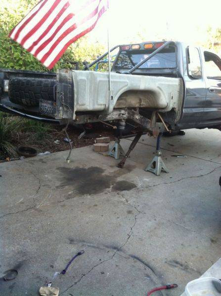

    Well the goal was back driving by July 1...but the new goal is august 1...still have to cut out the old motor mount purges and weld in the Dmz mounts,cam tab gussets, mount battery, weld all holes/cracks in the bed, bedliner it..install t100 axles 50t leafs 12" shackles and hydro bumps in the rear...I have new tie rods cv axles rotors lower ball joints to install too.

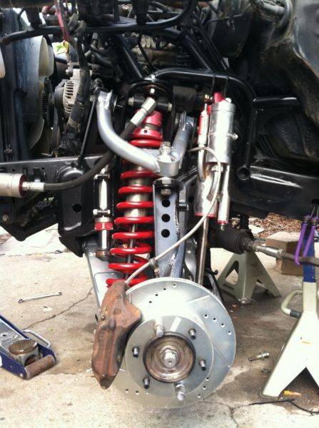

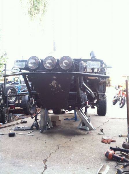

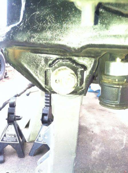

    got a TON of work done with the help on jordan and shawn...motor mounts are in and welded up...tc cam tab gussets are in...front diff is back in.

    Nice I got to get some of those dmz mounts I already have trail gears bomb proof motor mounts just need the dmz mounts to go along with it how bad was the install for the dmz motor mounts were you able to weld it up without removing the motor?
  9. Jul 13, 2014 at 12:29 AM
    #29
    anthony250f
    anthony250f [OP] Well-Known Member
    Feb 18, 2012
    #73066
    16,775
    Anthony
    San Diego, CA
    2008 dcsb trd offroad 4wd
    did not remove the motor but you do have to remove the front diff...its not to bad but heavy as fuck you can weld the sides and the bottom without pulling the motor...i didnt pull it...the fact that i have no core support made it easier to weld the tops..removing the old purches was kind of a bitch...sawzall and grinder for days

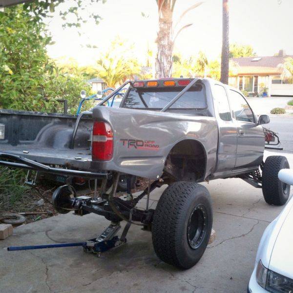

    moved on to the rear end today...also i noticed zero vibrations with the solid mounted trans and motor...was silent

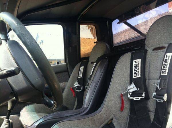

    interior is back together

    thanks! seems like its beeen forever but its all coming together... heres more porn..got the bumps mounted also...bumped and strpped at 17"
