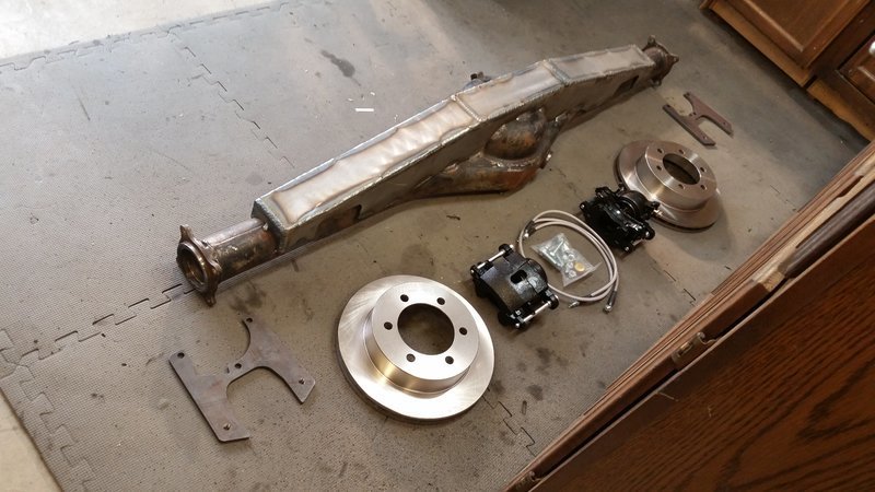

    Trail Gear disc set. Uses 91 S10 brake calipers and rotors with thick brackets and stainless lines. Was like $390 which is ok for an all new brake system. I had to get whole new drums and everything for the rear so I went this route being that I had to buy all new brakes anyway. Going to put my axle together this weekend.

    Nice setup. Is it all bolt on or do you need to weld in that caliper bracket?

    Yeah, looks cool. Hoping it all comes out right. Its bolt on

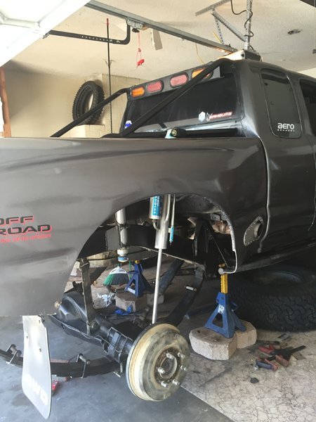

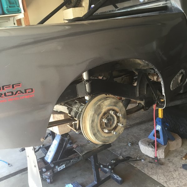

    More work in progress

    so you can cycle with 3 leafs lol

    Apparently. Didn't fee like dealing with the seized bolts right now

    haha ya worst part about all this LT has been taking apart the leafs haha.

    Yep! This is the second time I've had to do it lol

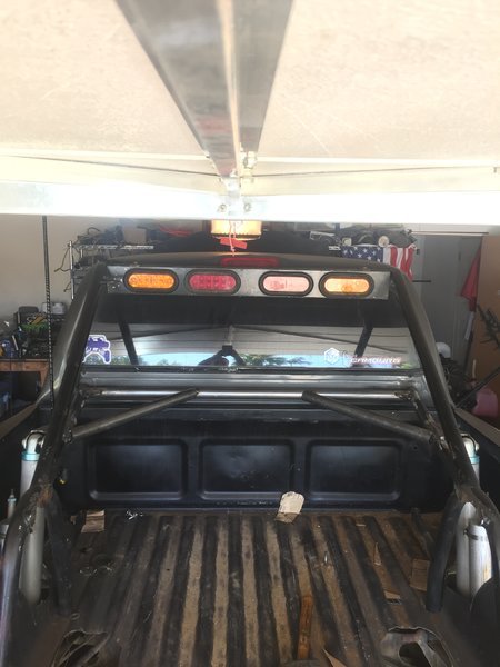

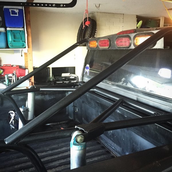

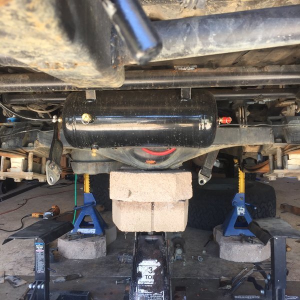

    Finished the bed cage
    -40, Cr250jumper, j0shu4 and 2 others like this.

    Nice man! Doesn't hit on the rails either? Let us know how much difference you notice between inside and outside the frame. I've heard it's more stable, which is definitely a good thing. Especially when my OE rearend bounces all over the place. I'm wondering the best way to mount the shocks onto my cage when they go outside. I see you kind of made an angled mount with a top gusset. Any other suggestions for a solid mount design to mount up the shocks on the outside like that?

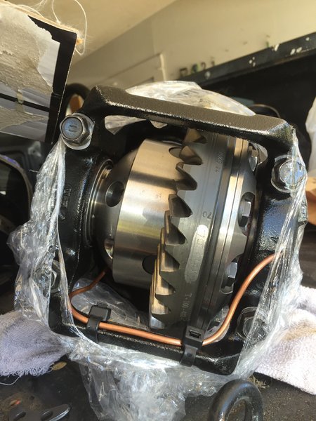

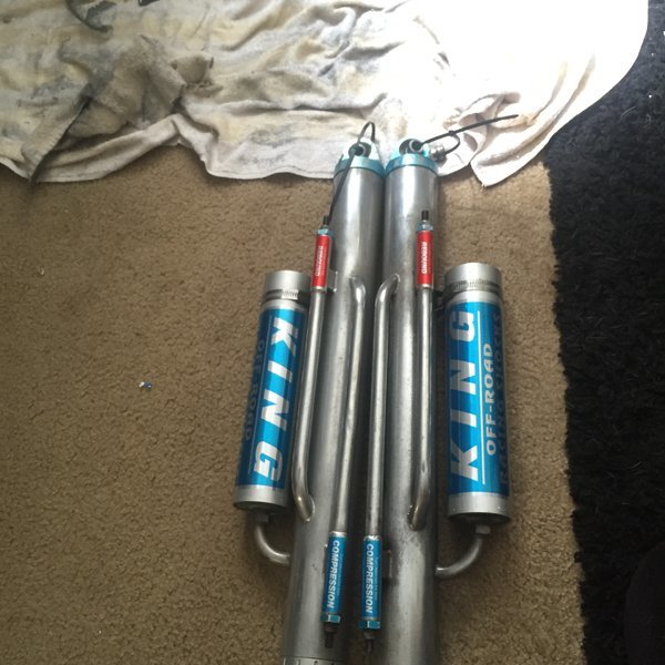

    Got my 3rd back
    06HAOLE, ChadsPride and DIRT YOTA like this.

    :woot:That rear setup is sweet
    When she gonna be jumping again?

    Hopefully soon
    Arb is in. Works great
