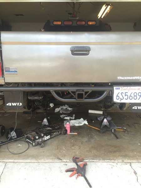

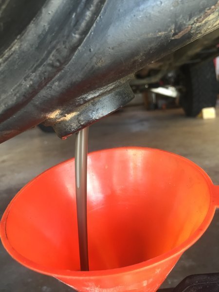

    Added a tube to the bumper. Oil looked like shit and odd noise in the rear so going to the shop today

    Oil should be dirty after first two changes if they are new gears. If it's noisy though..well..could be several things

    AAT looks good, oil....not so much.

    It isn't new gears only the Arb. Yeah it's like a rub/grinding sound and it sounds like it's rubbing those stupid baffles but I checked and they are installed correctly now

    The arb is NOT even close to the same as the stock carrier. My backlash was way off. You always have to reset the gears.
    Thus your shitty oil..
