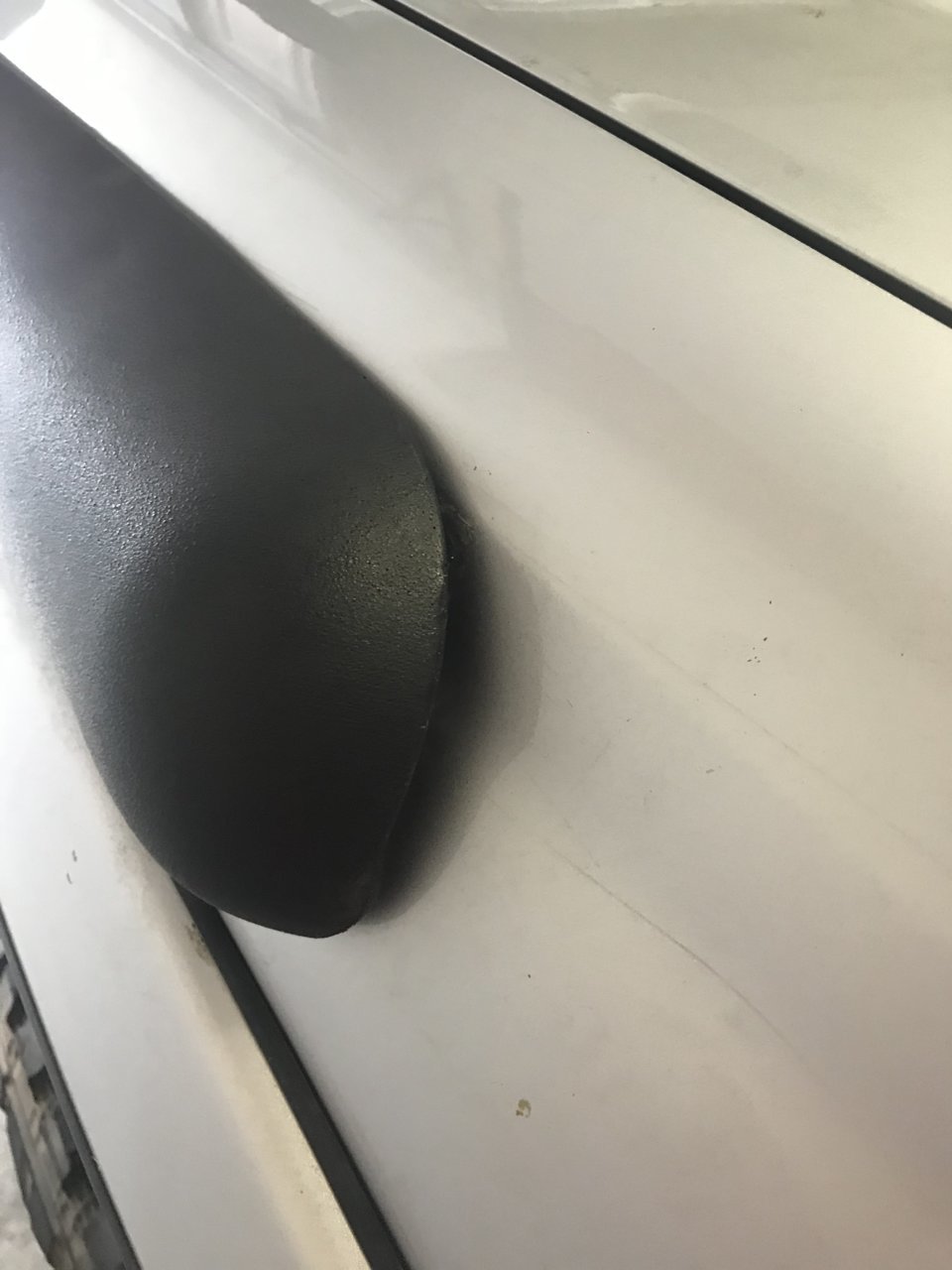

    It fits OK but there is a gap at the front.
    USPS decided to rape my package and caused a dent in it so I’m waiting for the new one before I proceed to get the figment better
    A lot of people fill this with rtv and it looks good. You don’t notice unless you are looking for it lol5BEAD7D4-2756-460C-AD06-CB0ED6D39EAC.jpg

    It looks like you could easily fill that with some sort of filler that would bond to the plastic - cover the fender with tape to " mold " it, sand it down nice and then coat the snorkel around the base of it with bedliner spray maybe ? Take a look at " Marine Tex " epoxy. When I worked in shops as a kid doing convertible chop tops on mini trucks we used Marine Tex to adhere the ABS plastic convertible top kit parts to the body panels. It dries rock hard but sands like butter.

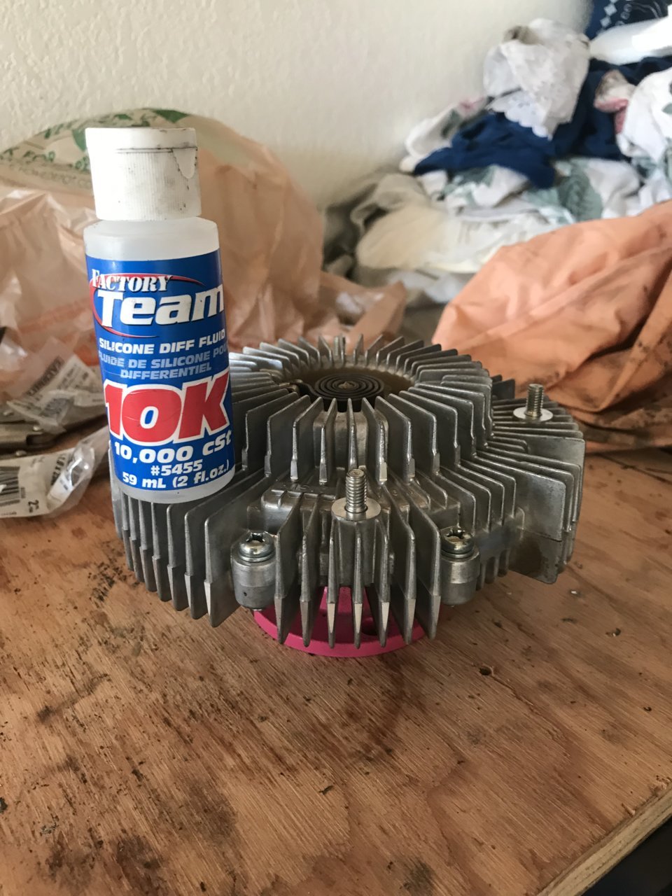

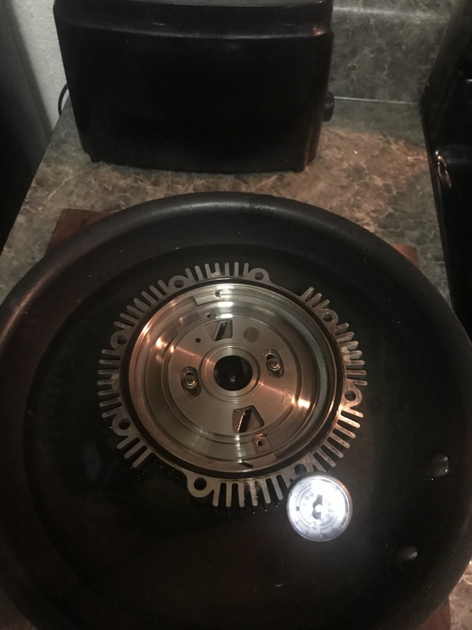

    Modded the fan clutch. Works much better now.
    We will see after I run a trail how much it helps in 4lo. Huge thanks to @Roostfactor and @loginfailed for this mod.

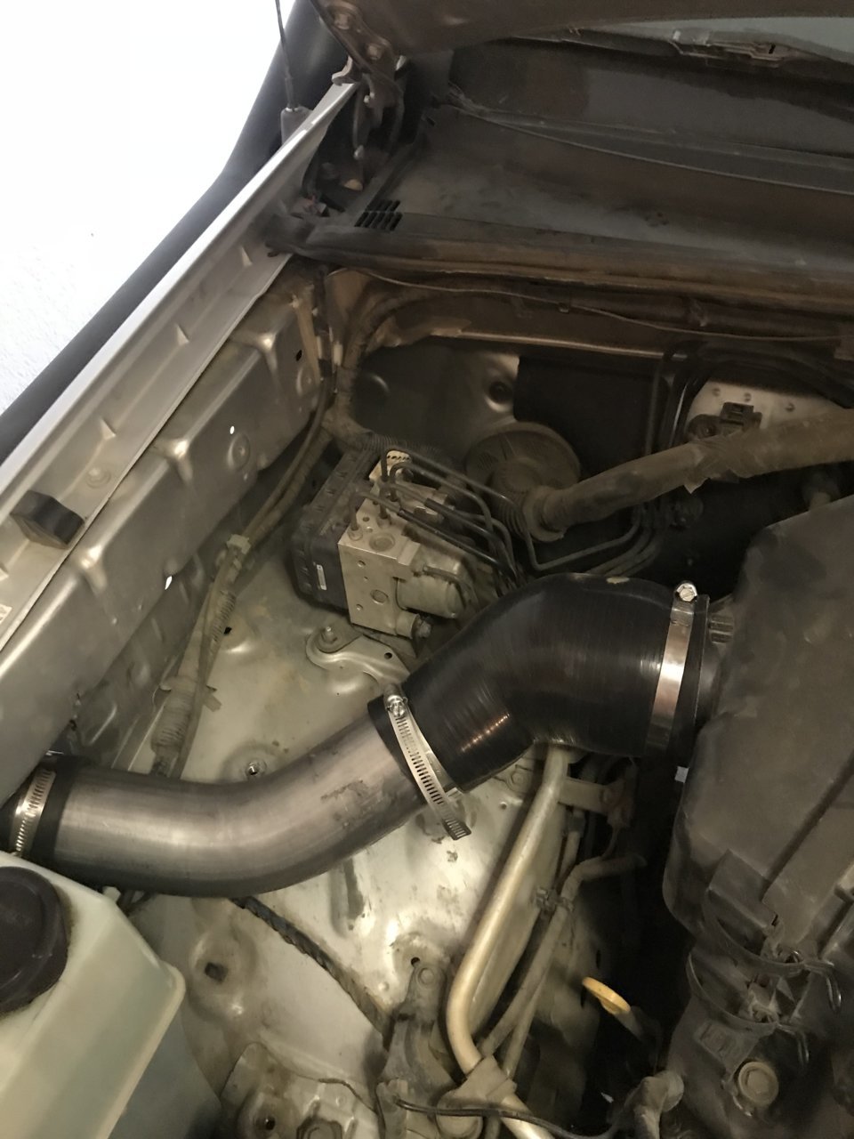

    Got the snorkel plumbed as well

    How did your fan clutch work on John Bull? Did your temps come down?
  13. Jun 6, 2018 at 10:53 AM

    Did you just swap to 10k fluid or did you change the temp it engauges at aswell?

    I did both

    Worked amazing
    Usually I would get over 220 but this time never go at over 200
