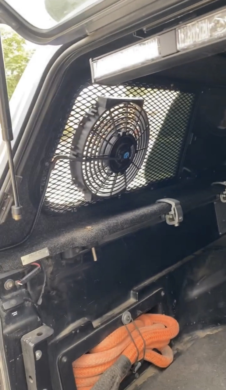

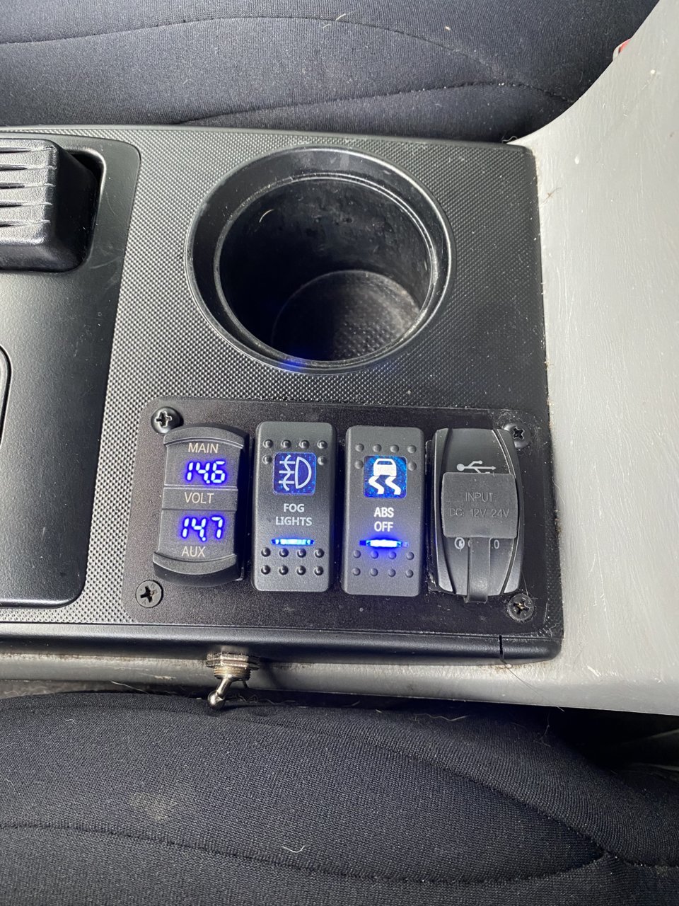

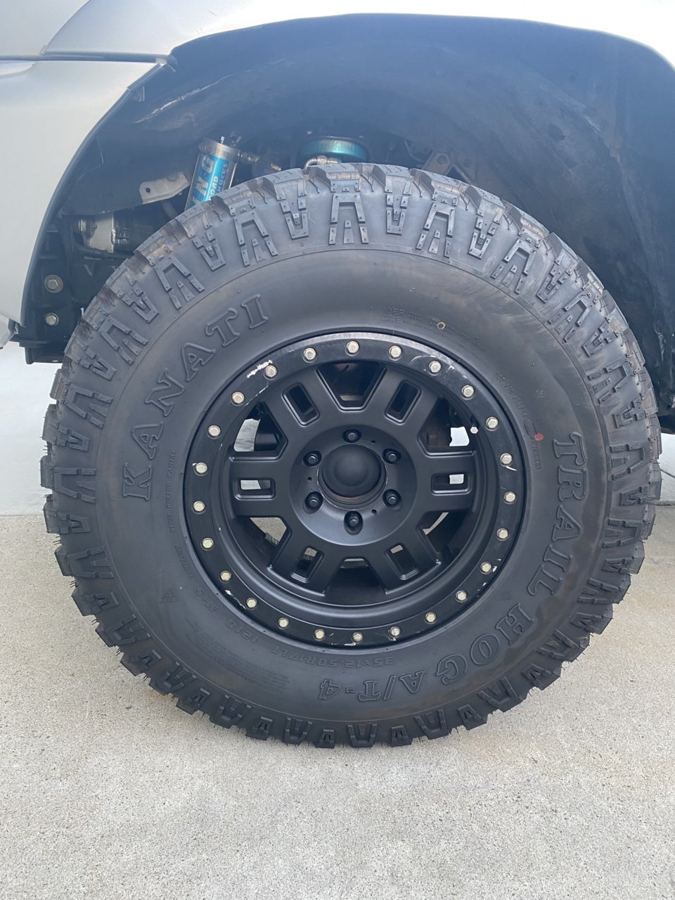

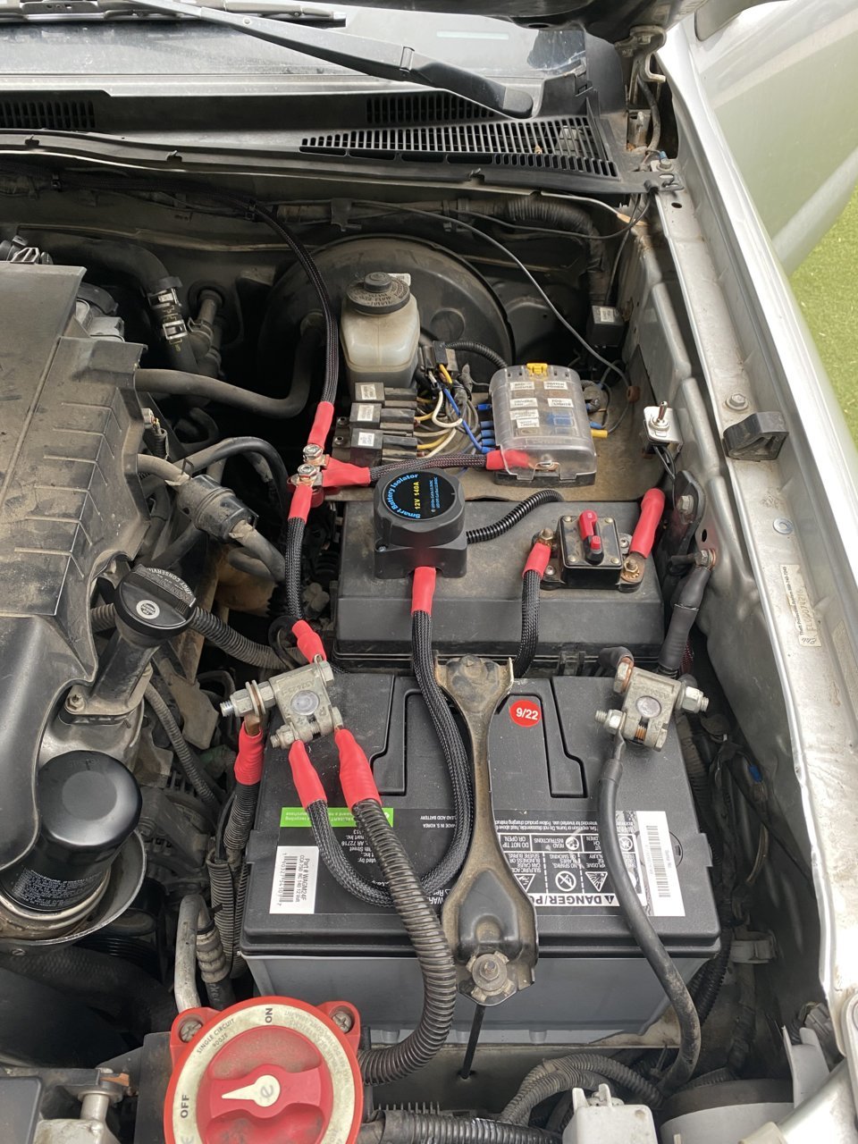

    New tires. Black wheels. Made metal window screens for the camper shell. Dual battery set up
    9BEC926E-5127-495E-94B2-F000AC9ABF37.jpg 6F507281-1A56-48E3-A06D-94DD37846FB9.jpg 786116E9-8186-4720-8228-DB7A866950E9.jpg 152D988E-45CB-42EE-9EB0-7CD0871A8C44.jpg BC2A463D-9FB7-498A-9AF0-735FA686BD98.jpg

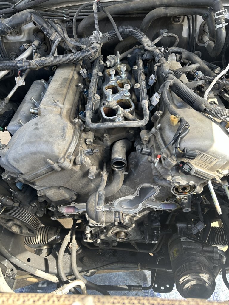

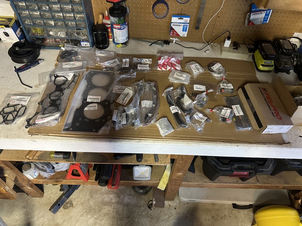

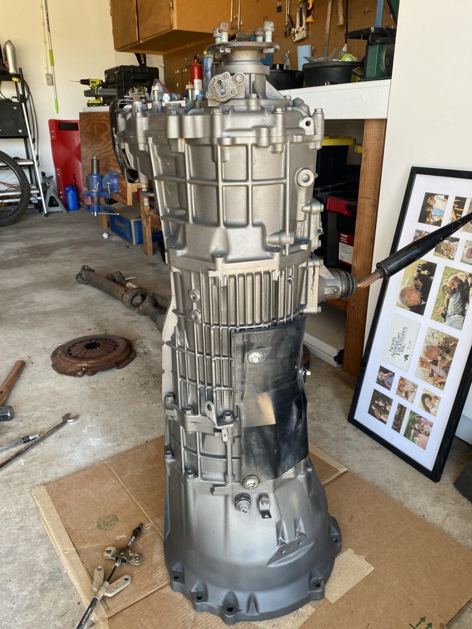

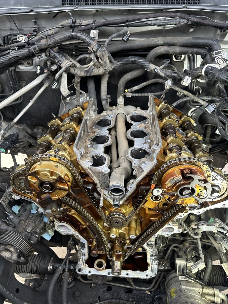

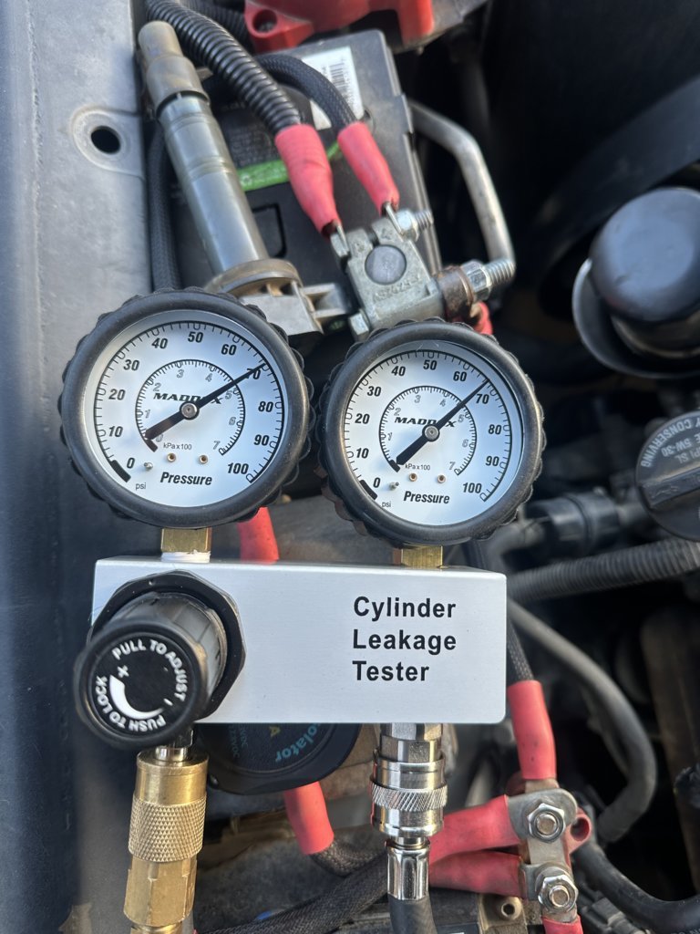

    About 265k on the truck and the head gasket blew.
    Shit ton of work but it’s slowly coming along. Replacing everything with OEM and all oem timing parts
    engine still shows excellent compression IMG_8929.jpg IMG_8613.jpg IMG_8727.jpg IMG_8906.jpg

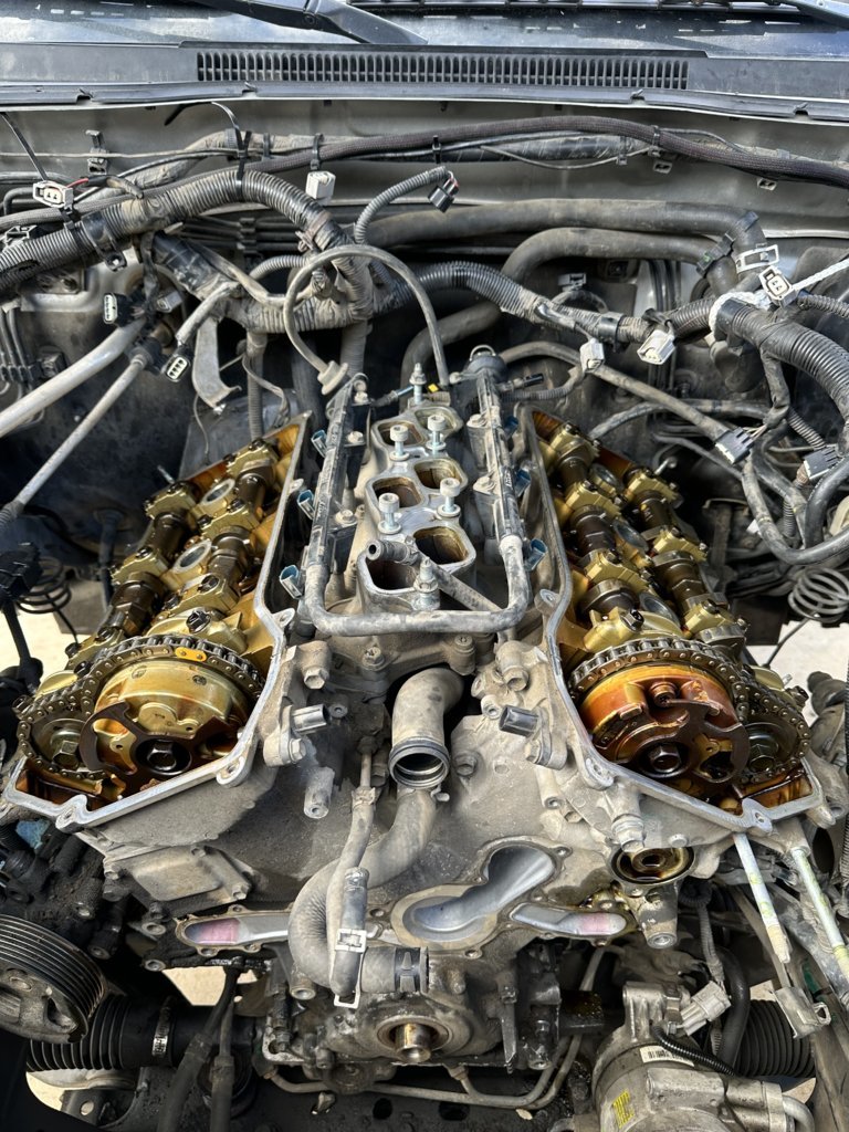

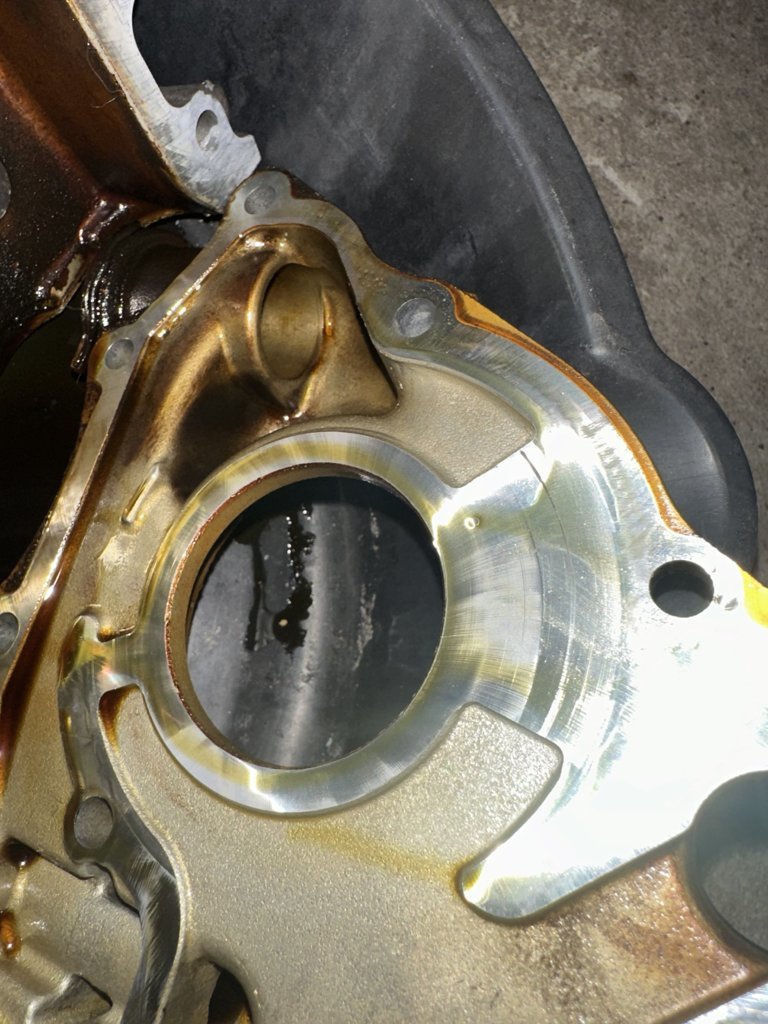

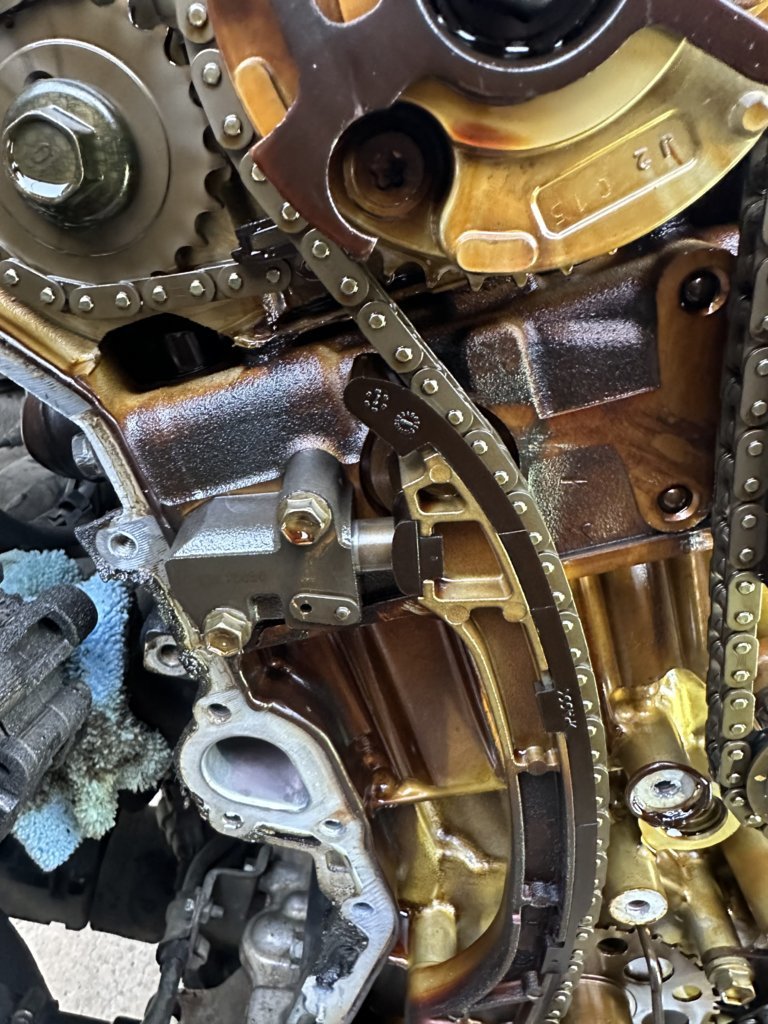

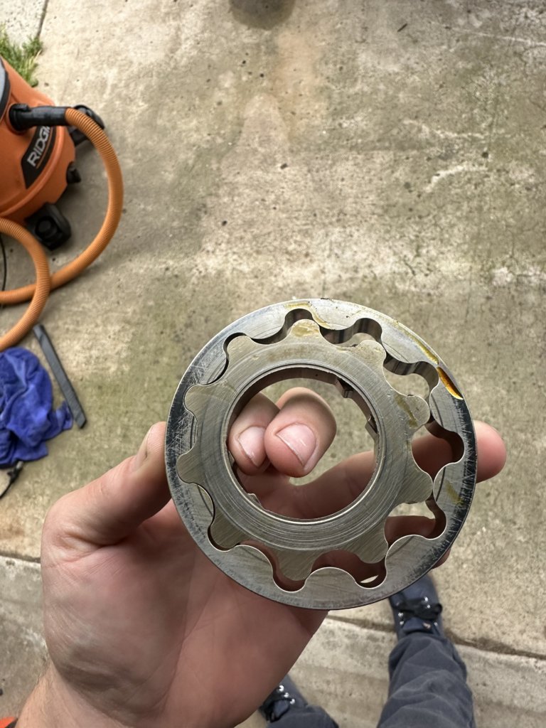

    Timing cover was pretty filthy but it cleaned up decently. Still determining if I want to replace the oil pump. The timing cover has very minor scoring

    Also got the exhaust manifolds removed. Surprisingly zero broken bolts or issues

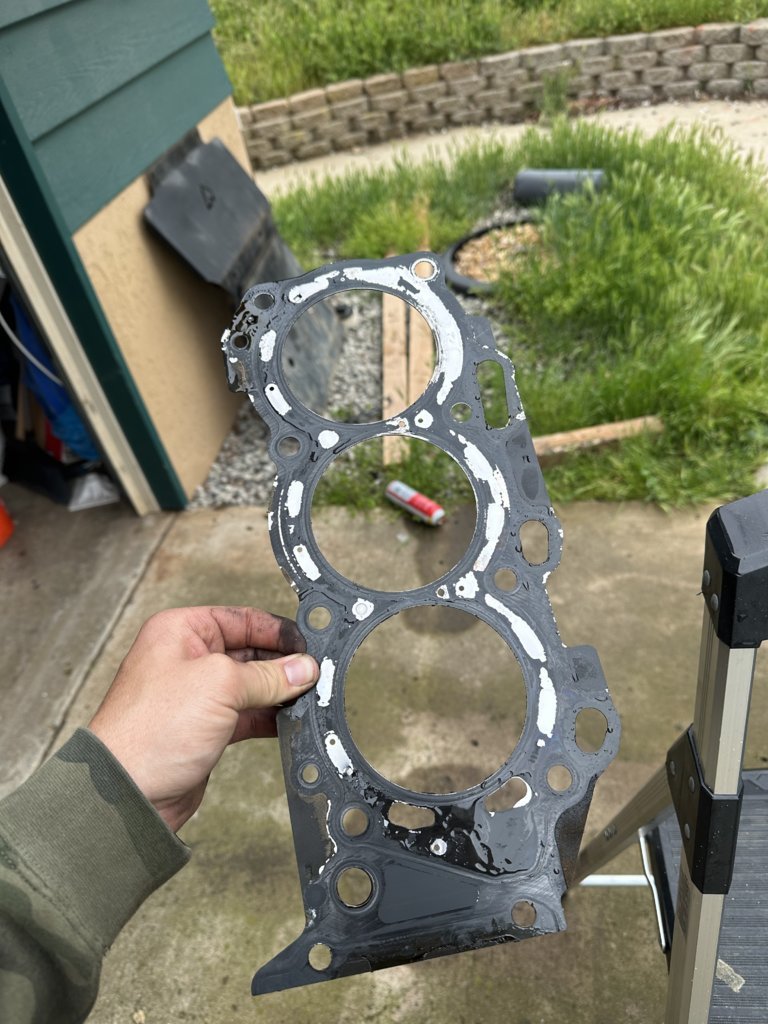

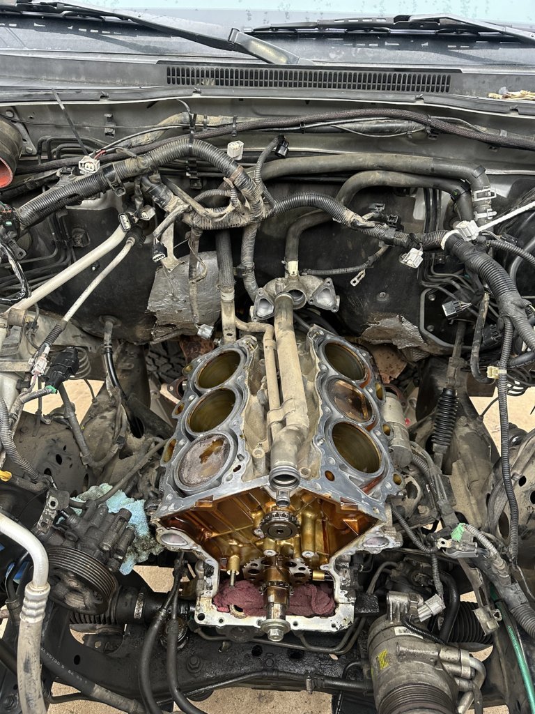

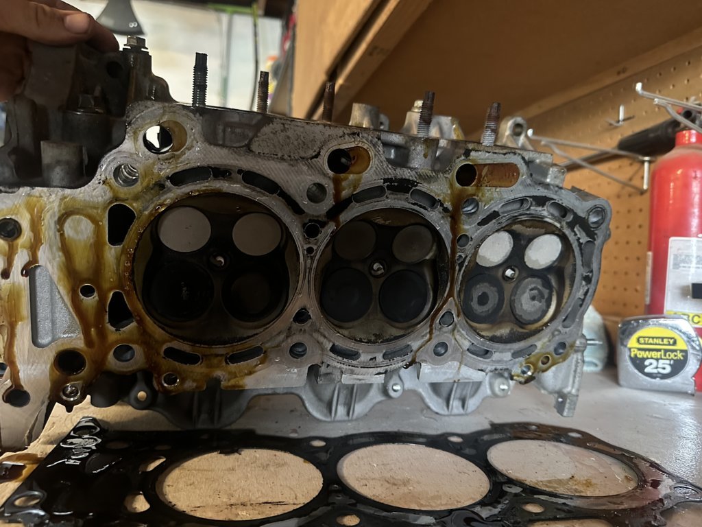

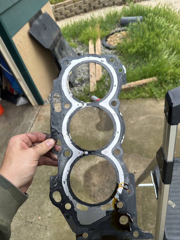

    2008 dcsb trd offroad 4wd

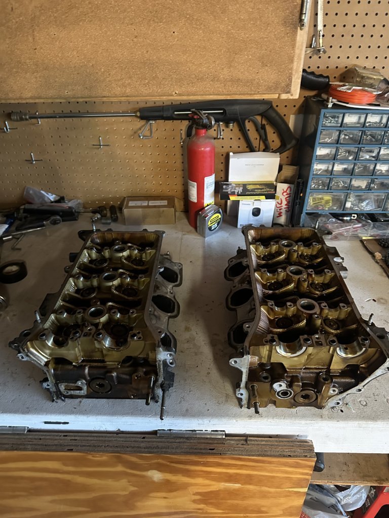

    Heads are off. I believe these gaskets definitely look blown but I’m no expert

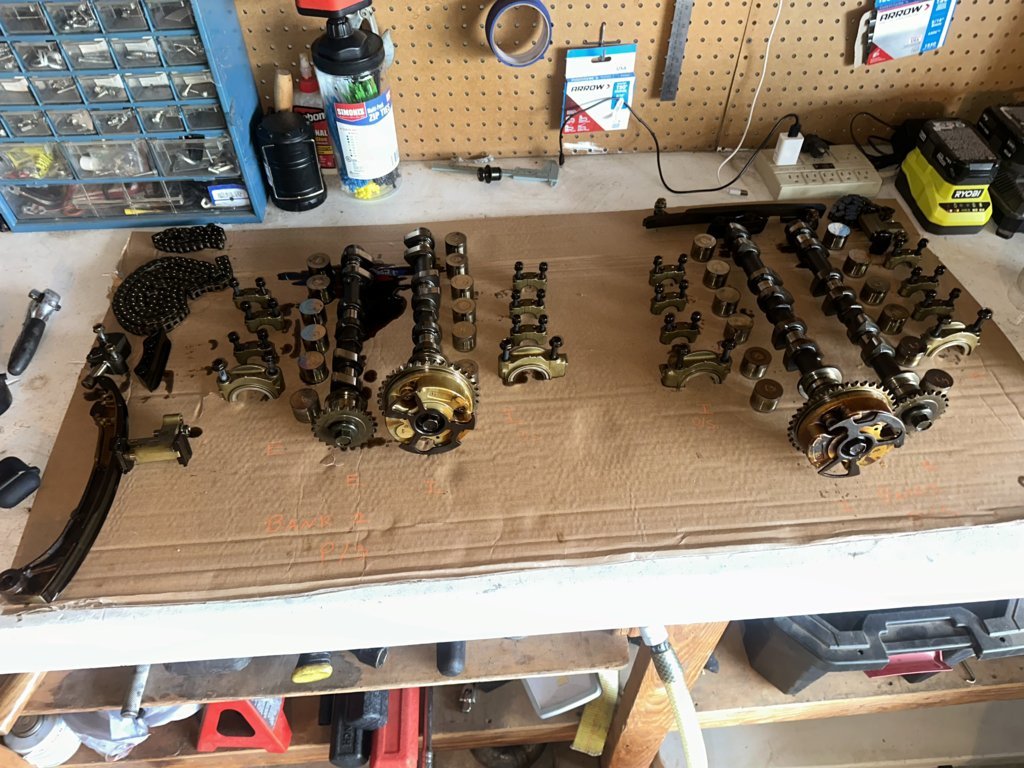

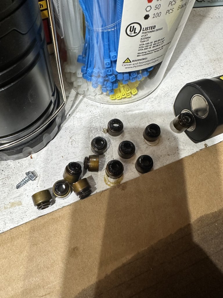

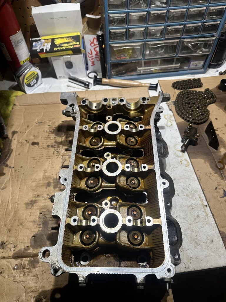

    Got one head done with cleaning the valves, lapping them, and installing new seals. Not hard especially with the lisle keeper installer/remover, just time consumingIMG_9078.jpg IMG_9079.jpg
