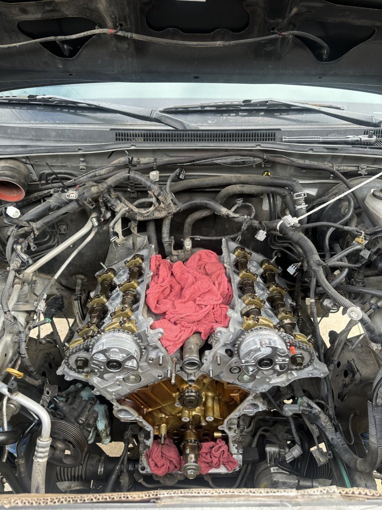

    2008 dcsb trd offroad 4wd

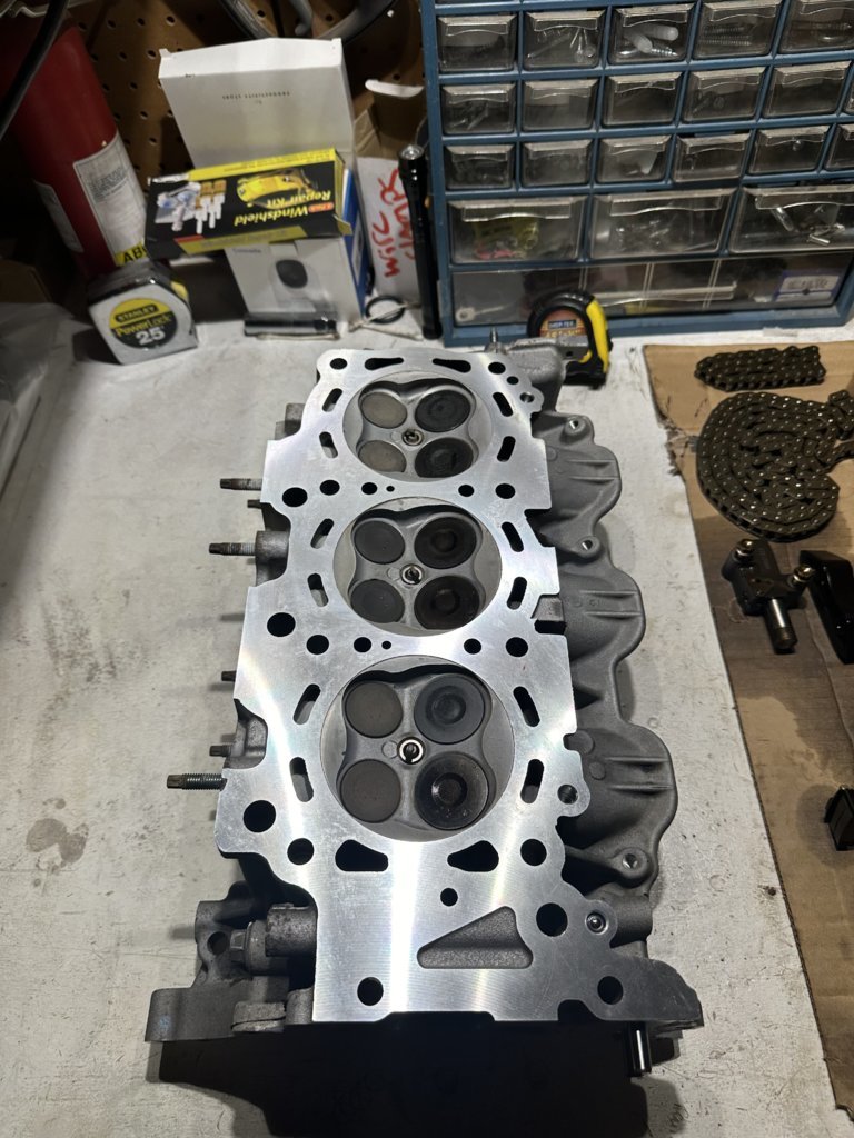

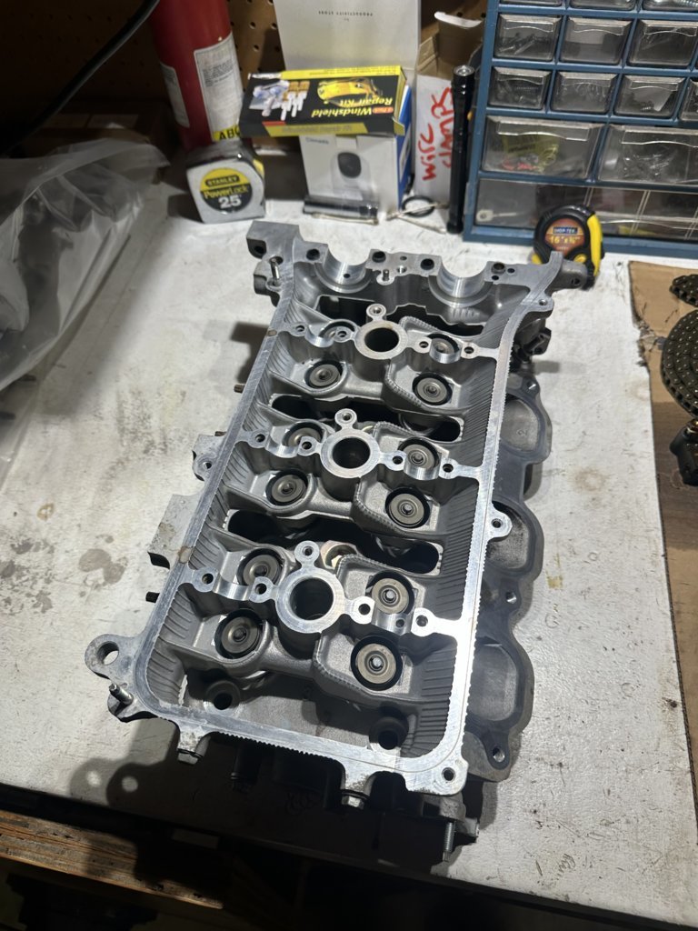

    0.004 off the heads ready to install

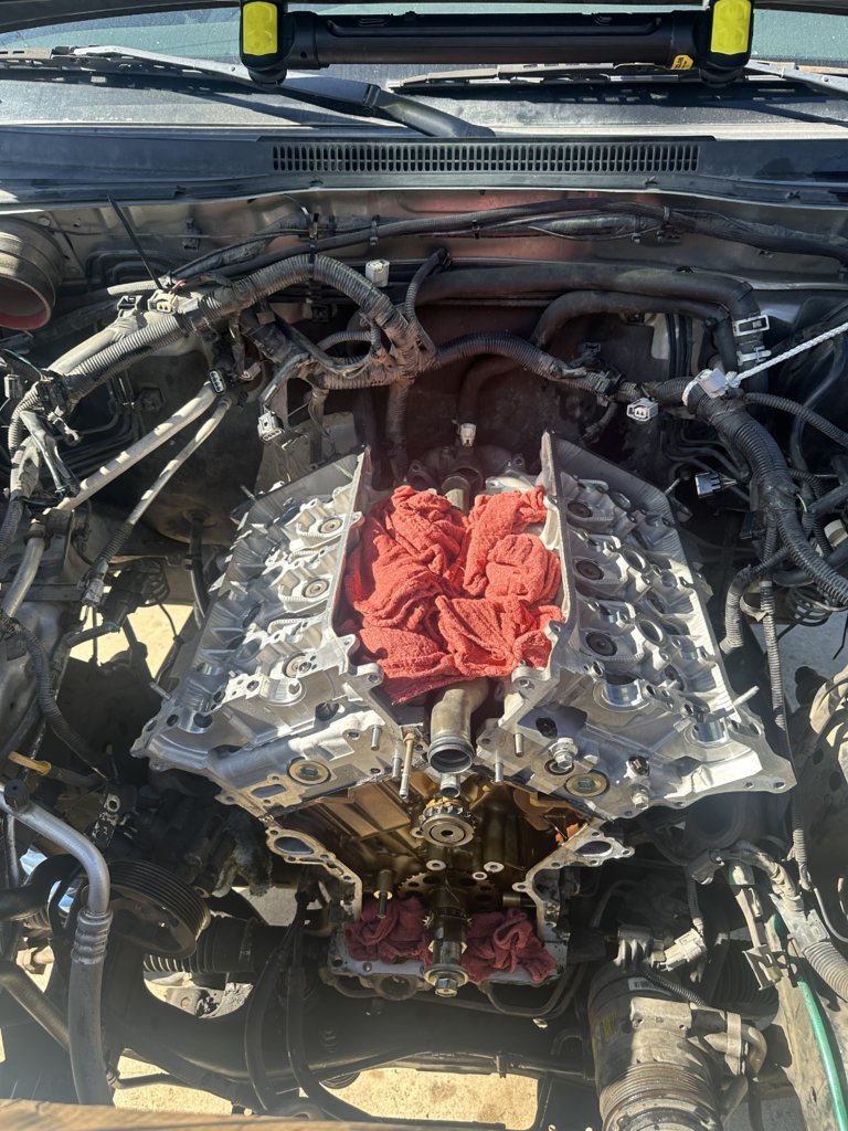

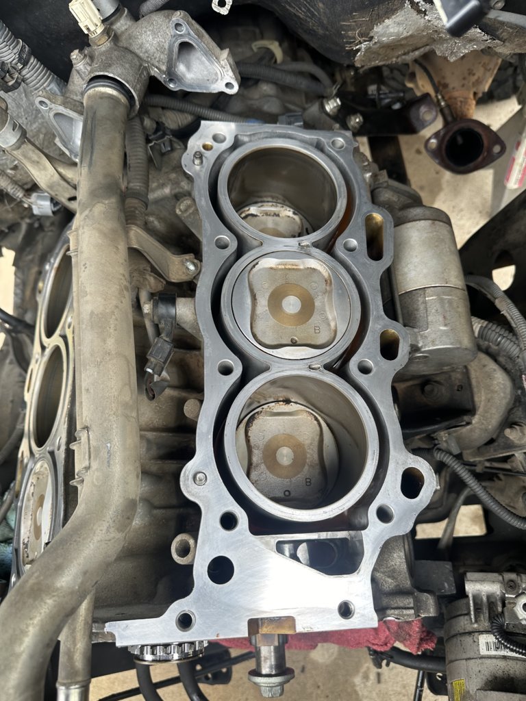

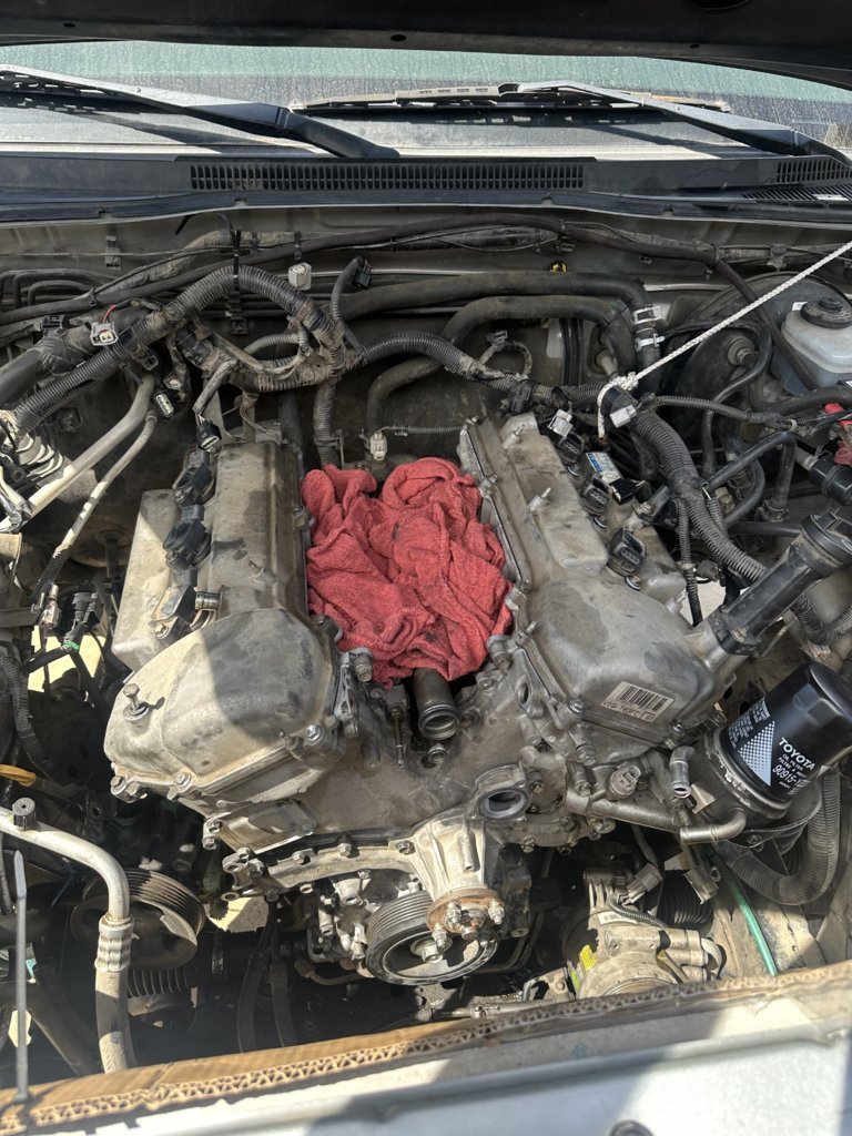

    IMG_9172.jpg Heads all torqued down….that was exhausting

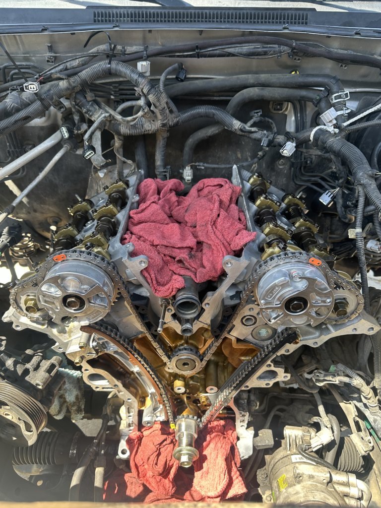

    Main timing chain on and everything lined up

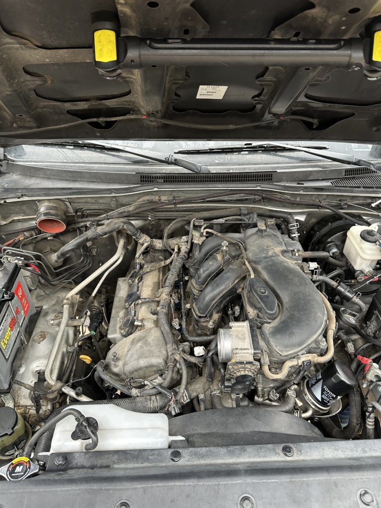

    Timing cover back on. What a PITA. Broke one bolt for the water pump and stripped two more for the valve covers…..this is why I don’t really use a torque wrench. Oh well used a thread chaser and a new bolt and they tightened up fine

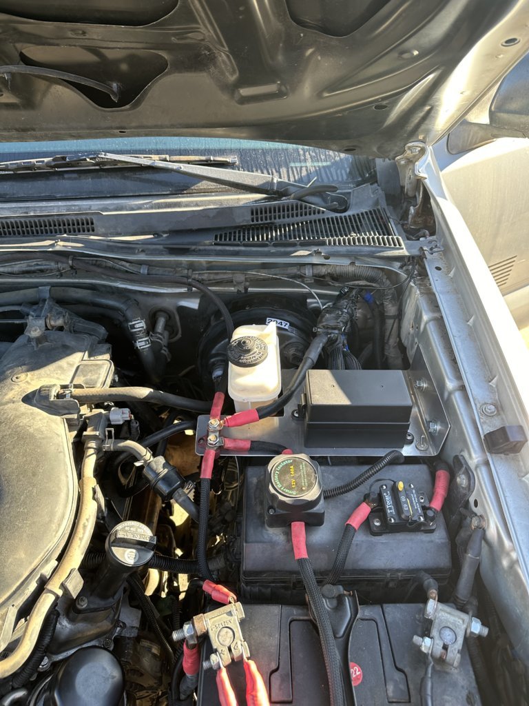

    Almost ready to start.

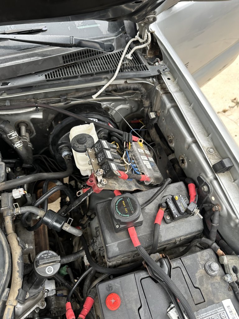

    The tundra booster/master is much larger so I need to re do all the aux fuse wiring/mount

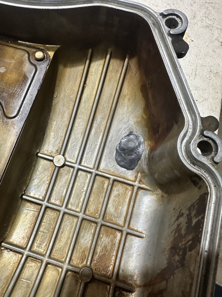

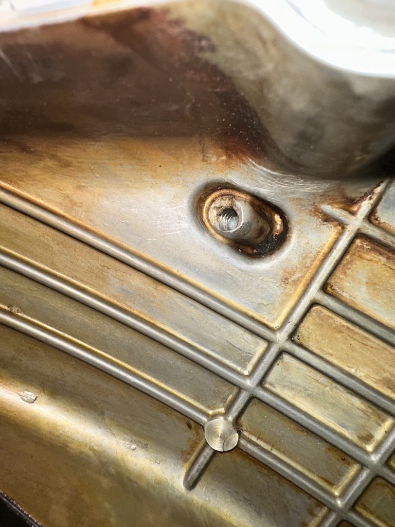

    Almost ready. New tundra master is in. At some point to long of a bolt went into the valve cover and broke the tip off. I helicoiled it and somehow the drill didn’t go completely straight. Used steel stick on it and it seems solid. Torqued to spec no problem. Hopefully it STAYS put lol

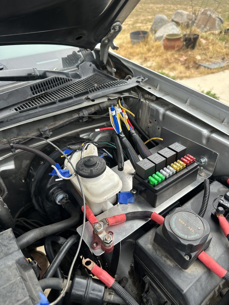

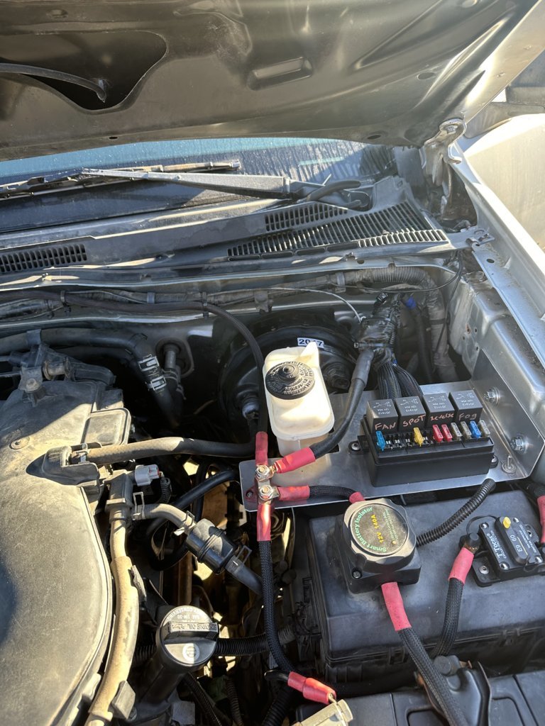

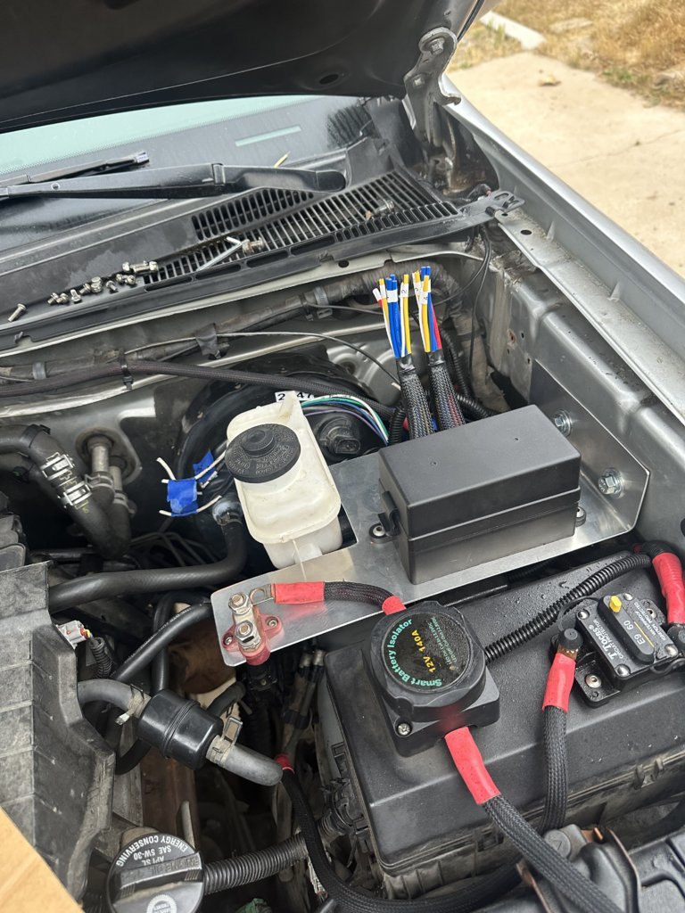

    Had to make a new fuse mount to fit the tundra master

    Fuse box done

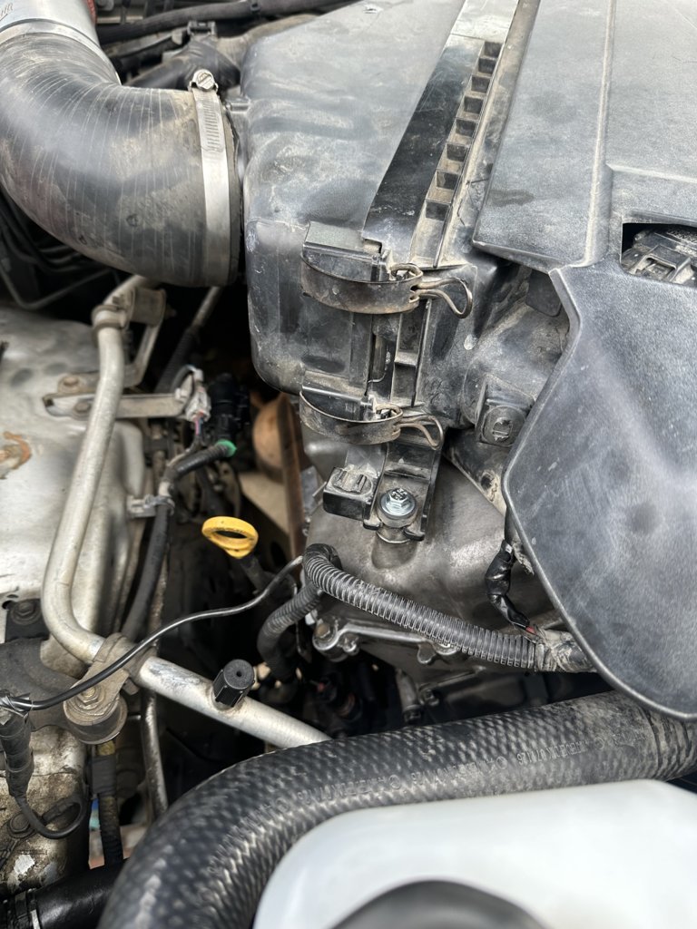

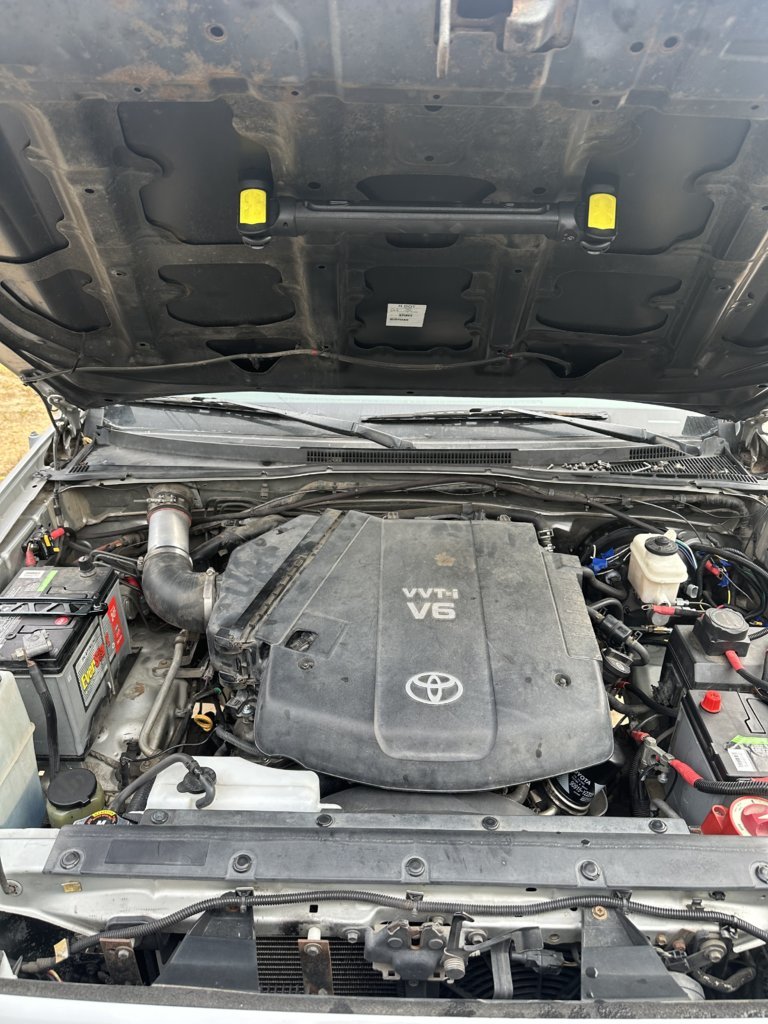

    Well the head gasket DIY if officially done. Truck is running GREAT. Coolant is suctioning properly from the res to the radiator unlike before.
    pulled the lower oil pan to clean it out. Pickup tube was pretty filthy. Removed the broken metal from the valve cover out of the pan as well. Put in a new valve cover from eBayIMG_9492.jpg

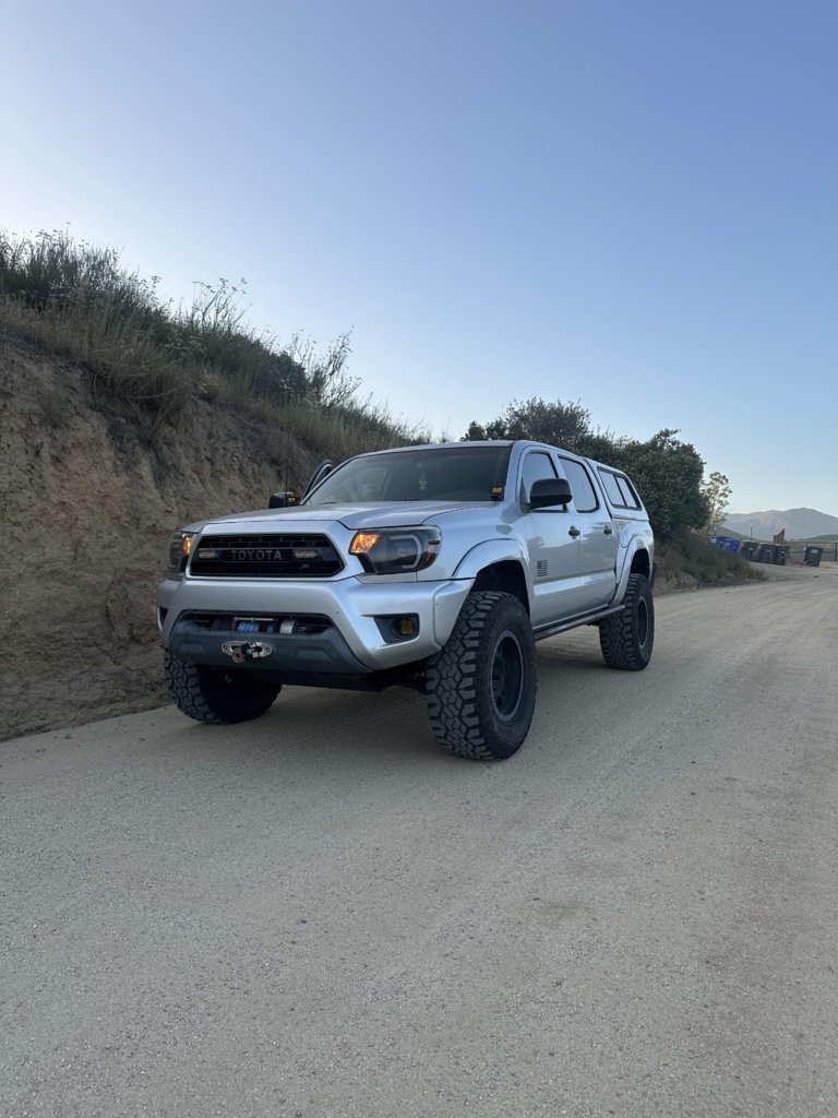

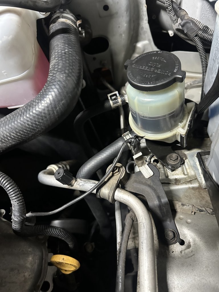

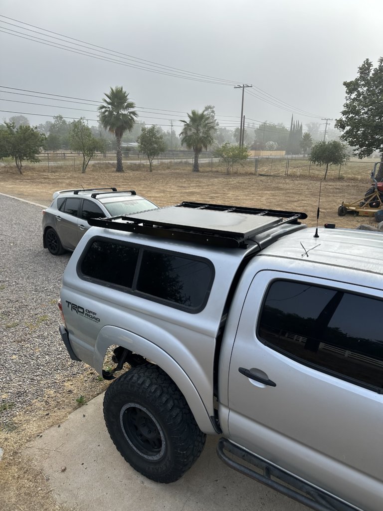

    Power steering hoses were leaking pretty bad. Replaced both lines and also put a PS resi off a 2023 taco. Also got the roof rack painted and mounted along with the solar panel
