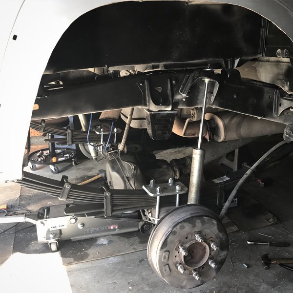

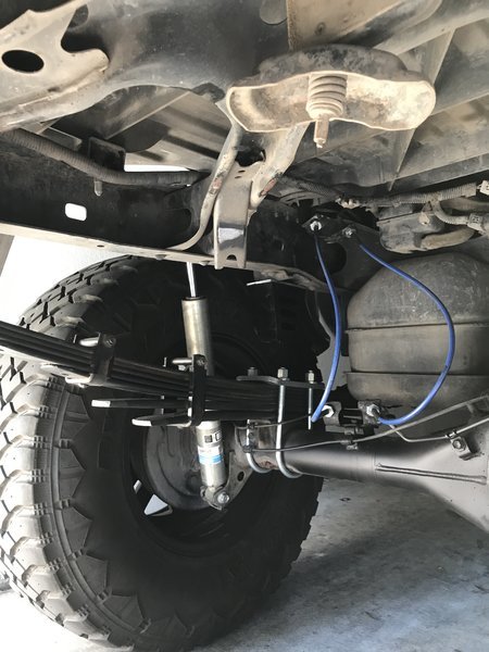

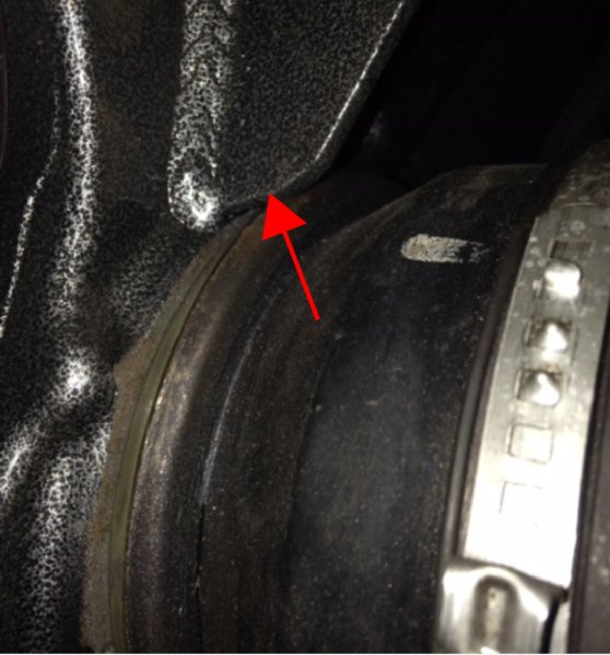

    80 what ?.... 80 turns with a 1/2" drive ratchet
    When you do your cam tab gussets come over to my house and borrow my Snap On spot weld drill bits, it will take 10 seconds per spot weld with them.
    watch out for this issue w/ your spindle gussets, with all of holes etc perfectly lined up the gusset interfered with my CV so I had to grind it a hair...after it was powder coated grrrr...
