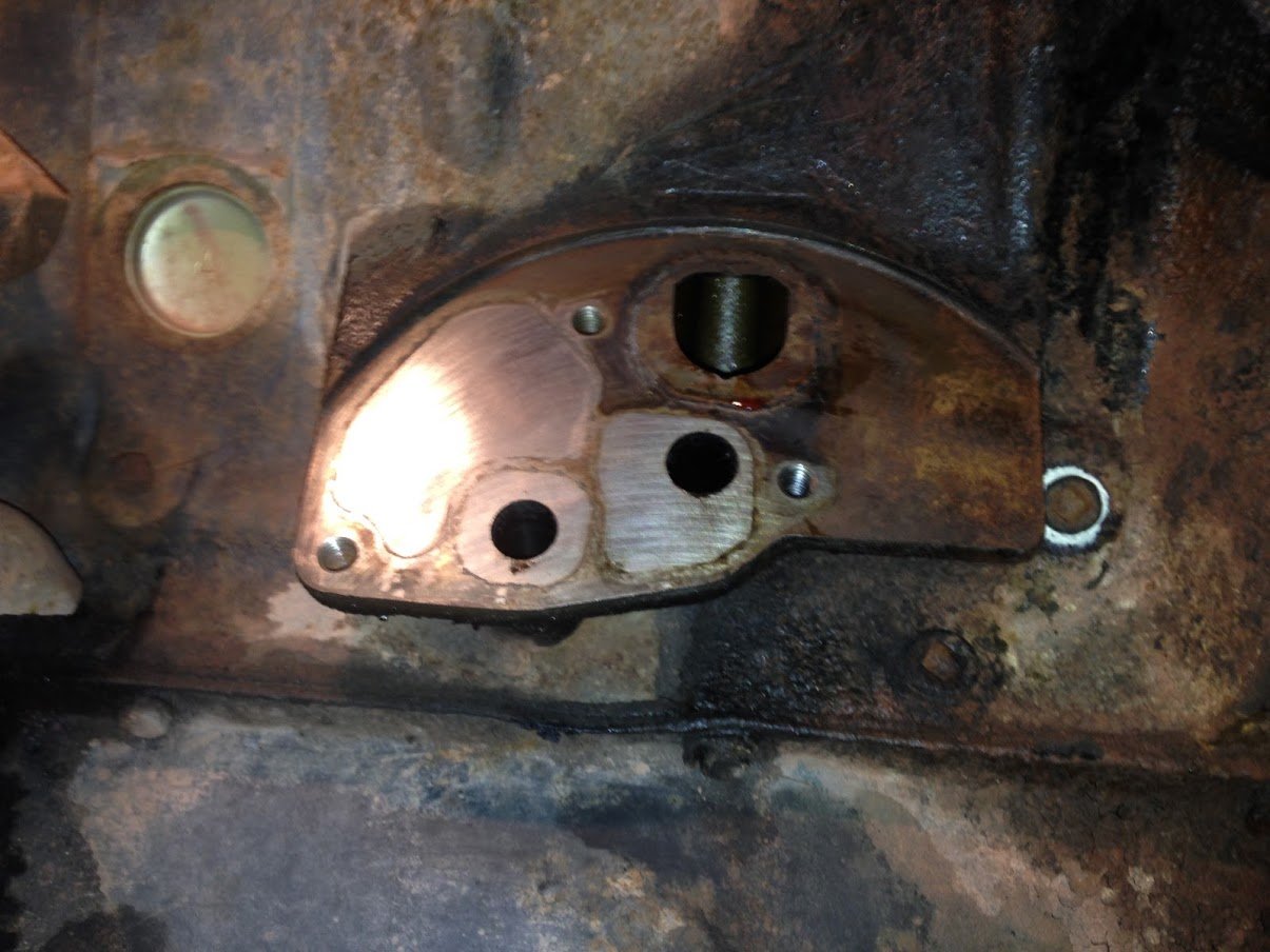

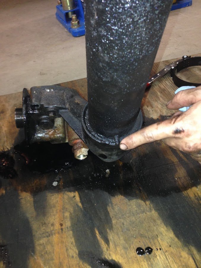

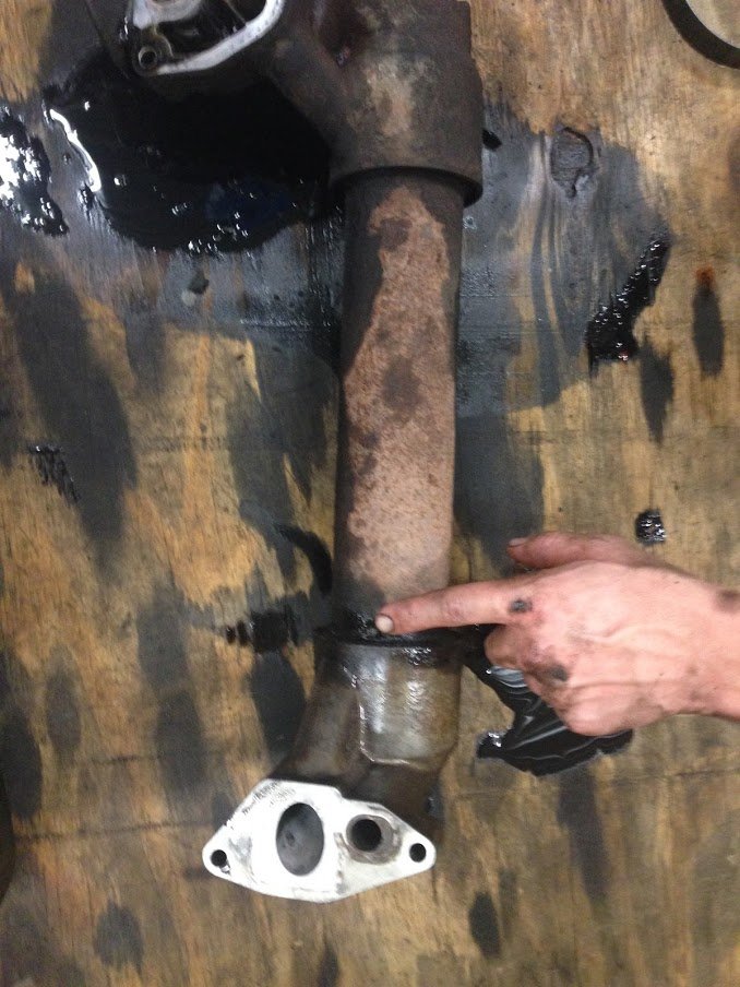

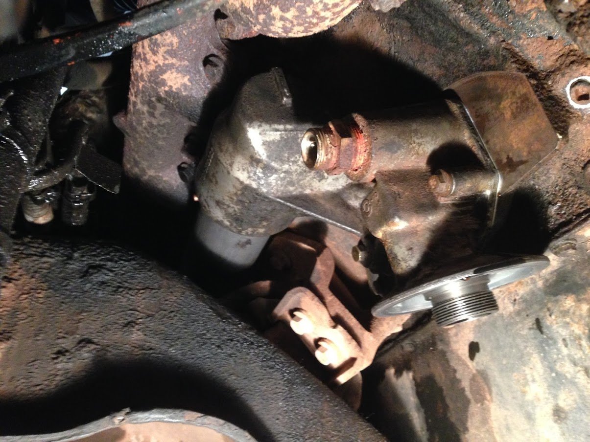

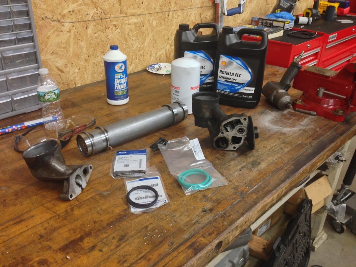

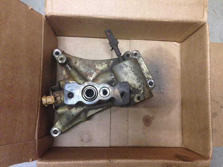

    Next job. If you've ever left your 7.3 out in the cold and went to start it and it shit's out oil all over the drivers side of the engine, then this fix is for you.
    Step 1
    Drain Oil and Coolant
    uxBdiNGd9lGZ5t_Dxm8k1CnrTMK6ICKDls-a4X3r_c4052f5e1525600f86bff5c70aecfa629c45545d.jpg

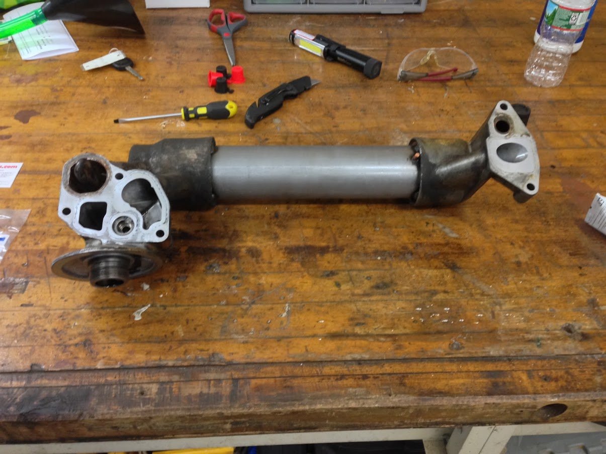

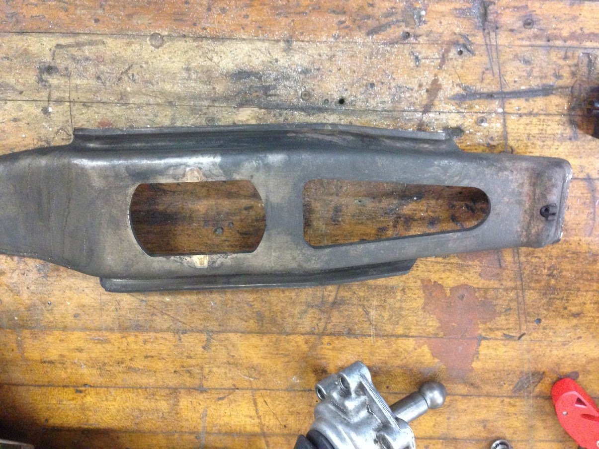

    Step 2
    Remove this oily sloppy gooey thingamajig
    RhKsUJlaCtIstpDBULlIcUHDyJtsde9-lodrVfcR_c8e80981f1362e8c2c7b20c054727d6bfe36ea7a.jpg
    Mg-UZlOxqejuGN3mFT7cL_Kx9Ah3qTaK-FNZ58_U_4771c2b39b15d124c3b1e9f23d8bc60f0ad5bc01.jpg

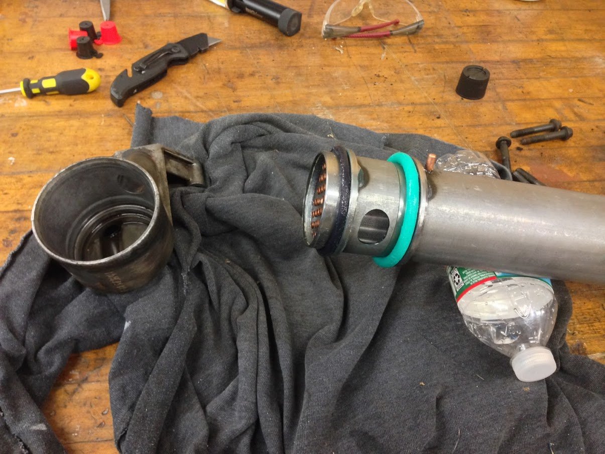

    step 3
    Clean up thingamajigs and get new gaskets and seals
    _OXUOl9chYT8f1BM0DEGuaQxzbmP64ljRIhvFjwG_8d6731b12e3c145c6439eecfdb98013970044259.jpg
    cG313me4fHOyYeP154zixEmw4sAzHuM7mTA3Mp65_e21e3cbc0c40631484148aed5b6564d7c6cbe3c9.jpg
    60W4YYcOg2UPP1Vyw7uhUVotJXyEATaCwvRz8UAk_3b3772e68f7609364c08bb33cf77c804b8f22a0e.jpg
    Step 4
    Assemble thingamajig
    Zj-UvWn0iezXPXFKxMGzHFCR44NKo476wDXNAw6S_c73dd73ad62081511cdc1474f5d7ba9ae0c2725b.jpg
    Step 5
    Clean up block real nice and good
    gsqe7wSO61o9kfvbnbGfT-w-JJJoB8J3IzOxmo6y_8cb0d5ab3e611e548c7de77132332b9529c66ea6.jpg
    Step 6
    Reinstall thingamajig back in truck
    4rcwiAxSAJxV2CSCBST6M2bGEaayPjn1gs_1o9jI_8d404fc997c9245e4458d28c0a0339498fe19594.jpg
    Step 7
    Refill coolant and oil, start truck and watch it billow out smoke and sputter for a few minutes while enjoying a cold beer knowing your truck has 1 less oil leak.

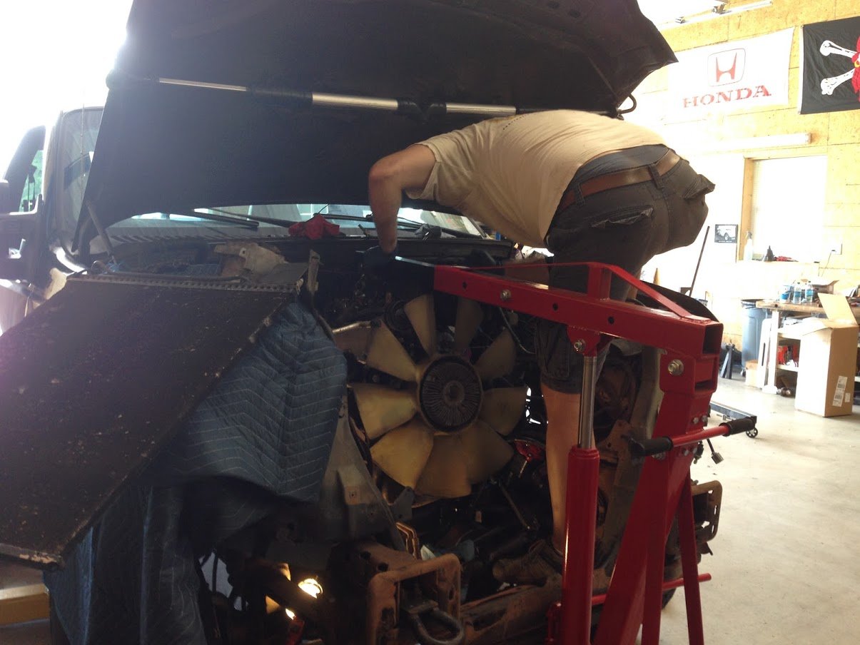

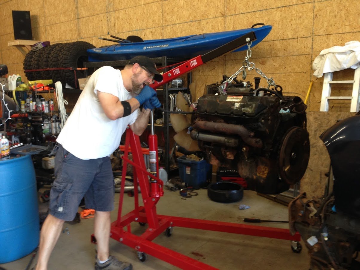

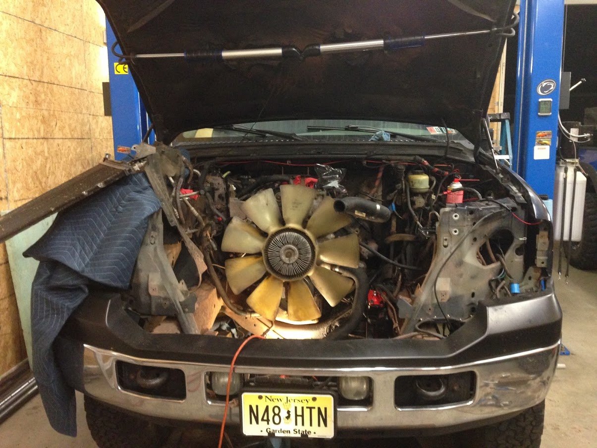

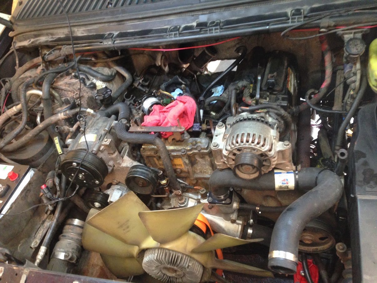

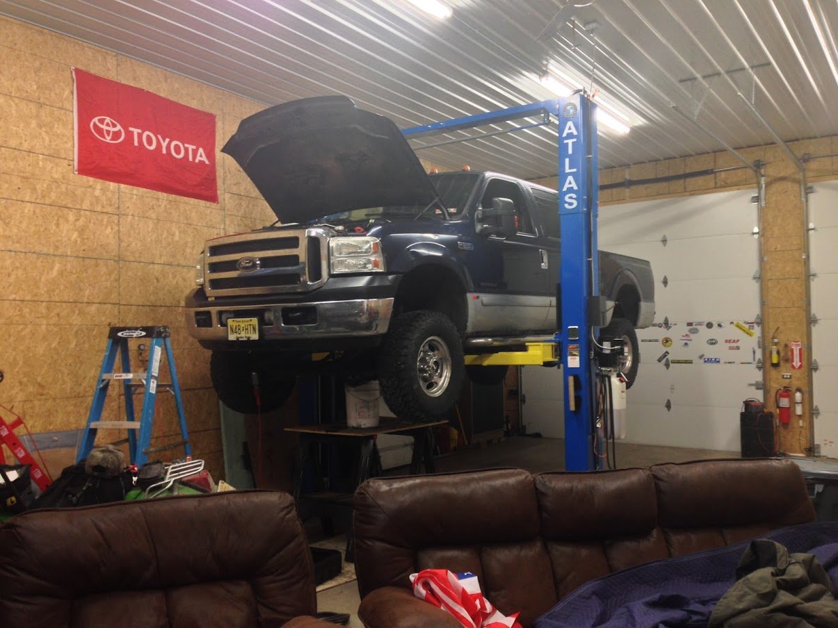

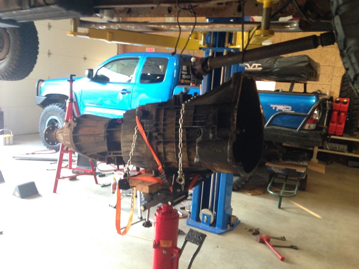

    Damn truck spends more time on the lift then on the road. Figured I'd go with a new clutch as the old one was beat. Previous owner tells me it was replaced "not long ago", whatever that means. :bananadead:
    Simple, easy, couple of bolts, what could go wrong?!
    2QfCBJpYSGKQqVFWAmUKuhI-XSvcdA0rqU57K9b3_2394f686c357e6f68cb87acbe99892a53ad92ded.jpg
    HPgivdddUgu1DzlujjCAhXU4hWl5Be_MlCpJva6z_327b17cae28edacfc827328380b1f96c382714d8.jpg

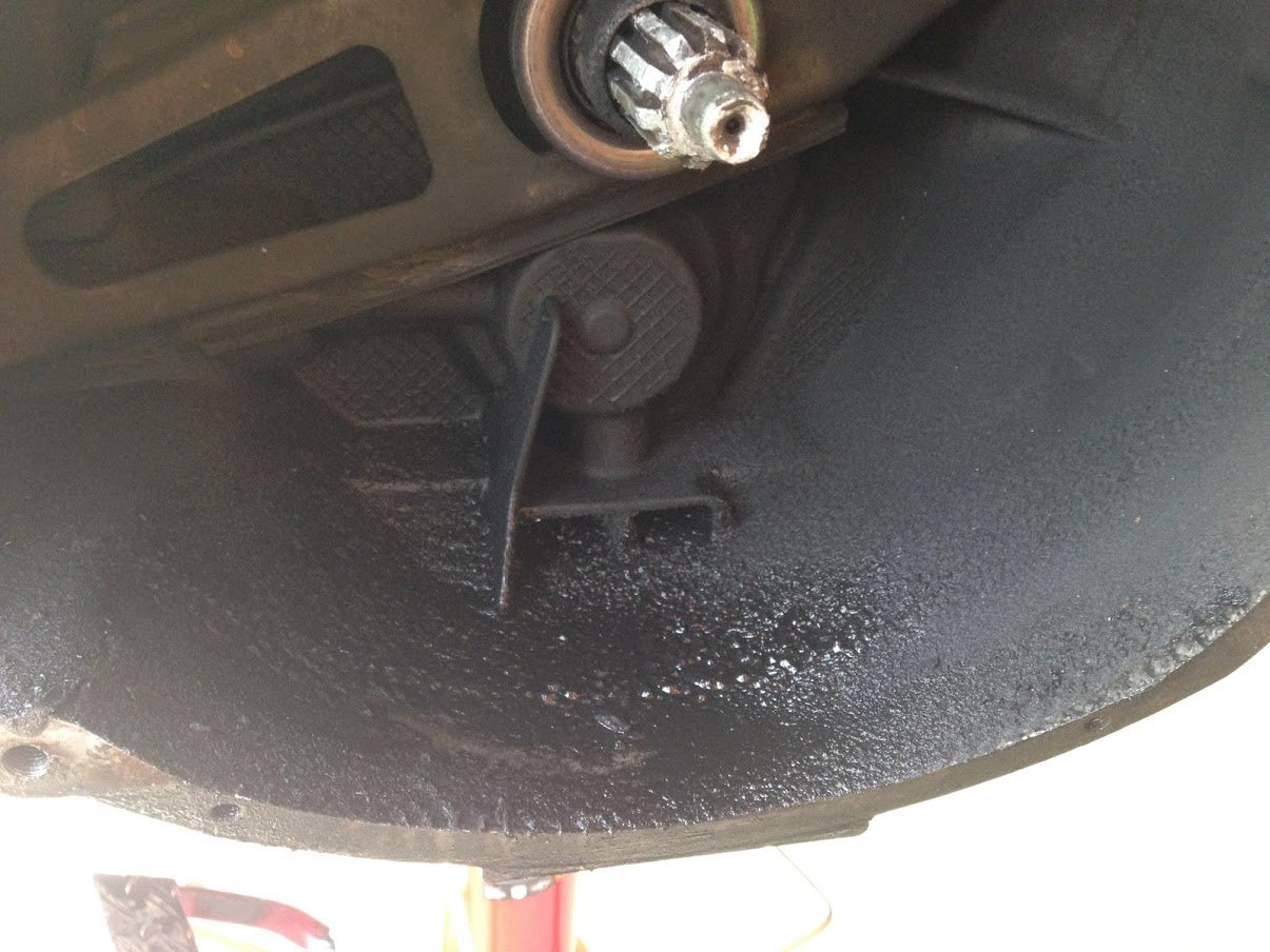

    What the shit is this black gold in my bell housing?
    0FVj3MAeQpV_T8LvwEXNh4IvCpCJxdUWmXhGELTO_01d321343d69afbf9c8b9fab55db0908550a214d.jpg
    This calls for further investigation
    _SK_m7gd3MI4FLfgwsP784PB2DlhSRS9YtWxlMJu_91b3e6f7acc7aada99299d3f36a60102a980215d.jpg
    1l_u_MIkCcoTQIsrdg042sO521cWYMEswCrxzee3_3d56ce51d1f4fe5f27cf341a9494be5626638e51.jpg
    Where did this come from?
    ZEHyvi8NWnVn-y_7PjC_mFEiSLrAe9U1_Yfrey35_8430adfaee4640ab6abb224a4314d489d456c676.jpg
    Making lots of reverse progress
    ojzdeQmAXSRO4LViWKxq2pp_pz5T_7KzugYhbTAU_e9e5eec49b22c0aaf7f162935dd1c61281c61901.jpg
    Had to call up my top shop hand @HomerTaco for some helps at this point
    CepzxQV5idfL-8zhcYEft1CUHhjy8tT4k2SxZAeG_b35676e3b139f1b138334d95134e0a2e22831595.jpg
    Blowing on the engine for good luck?
    jns1-Wpi_dswzYgaMJlR-UEqxk8sn3t_GgOk1YRj_1c52be2d78de83e1203df11701755ba73507fd3d.jpg
    9032kSnOXsGUJSS5BZOBbK0YilbJh7Iutd4tDbGR_116ce04473b31c05cfc1887d595a04204292b7f9.jpg
    Well shit where do we go from here, scrap pile?
    9q5RcV9p1sh_FL_FTNzMlersngYAnKNVOyD29hTx_7165ad2681beed49ade0dd532d9577d94ee7e483.jpg
    Biscuits, TacoFMS and HomerTaco like this.

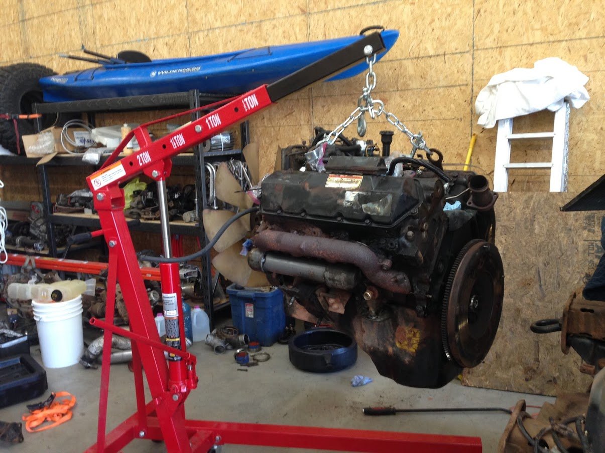

    Herculiner Hootus

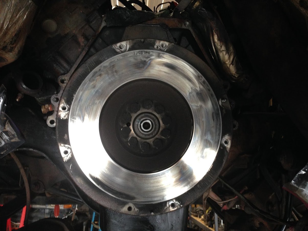

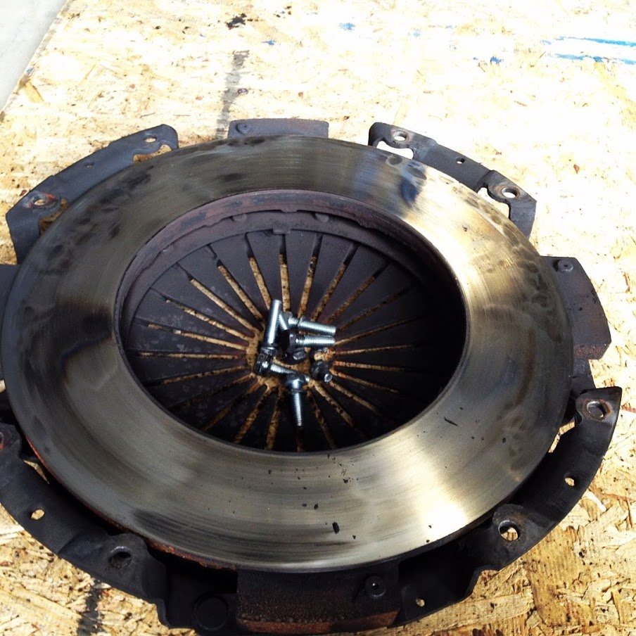

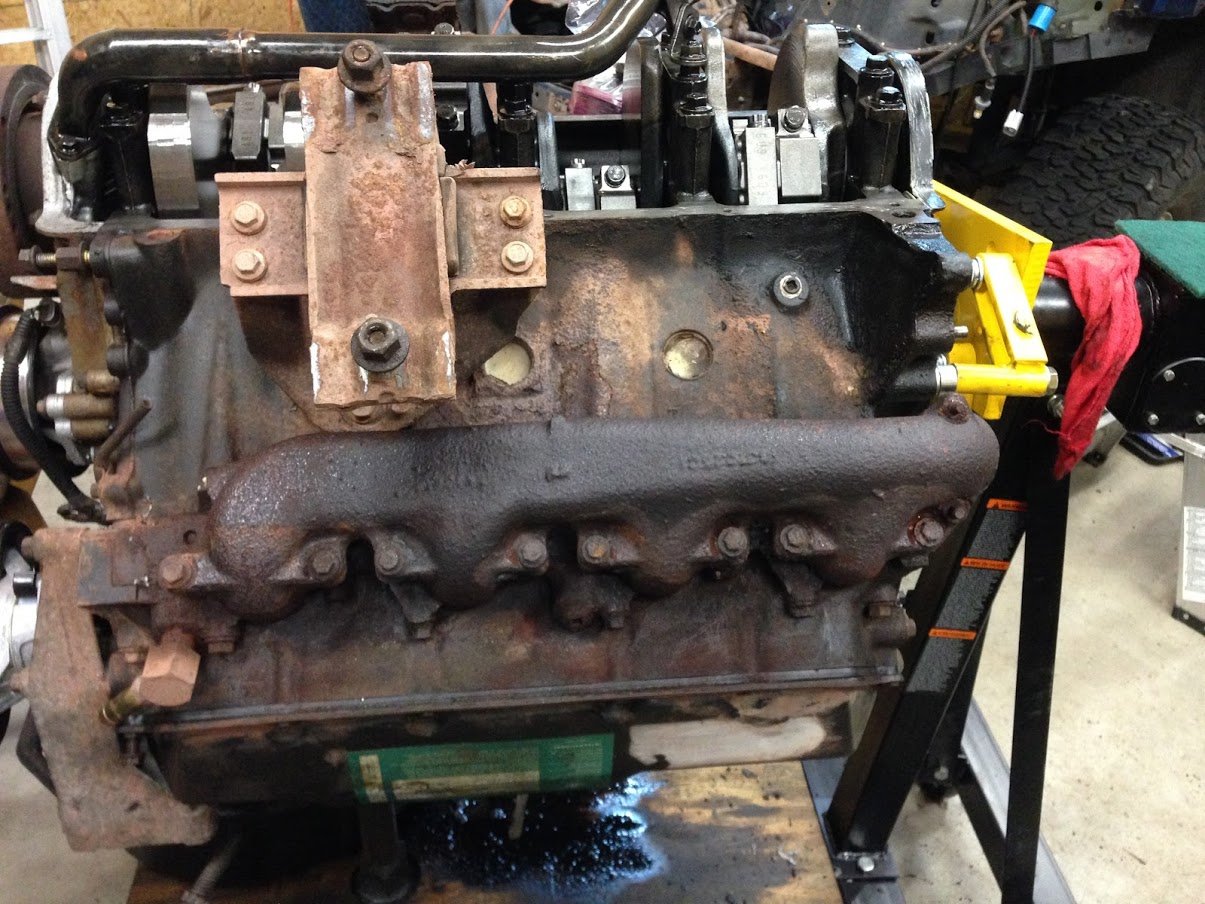

    Oh bugger, here's a beat flywheel if I've ever seen one
    0NMKgca_qp1xlqRtVLYXwTs_8jL9zcfGttpVLzt7_b773313bfa12db9b5619eaa5164a4c37df422e05.jpg

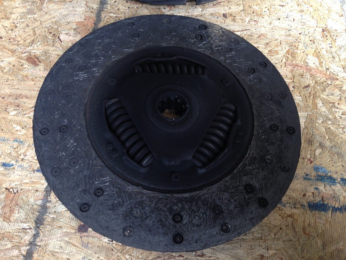

    Clutch disc and pressure plate are beat too
    cMgfOJEHhc8lPSD7BOe8xZyg50qTIdMd0VRtQeLG_0df78fec6a31bbc19d990e2cd45a6bad66cffbd5.jpg
    oJhufXDeinfGeG6de_Q-KogJzZZIsTwBEQv5MOxI_a3f602d0548cd4563111d038b02de47b221f084a.jpg

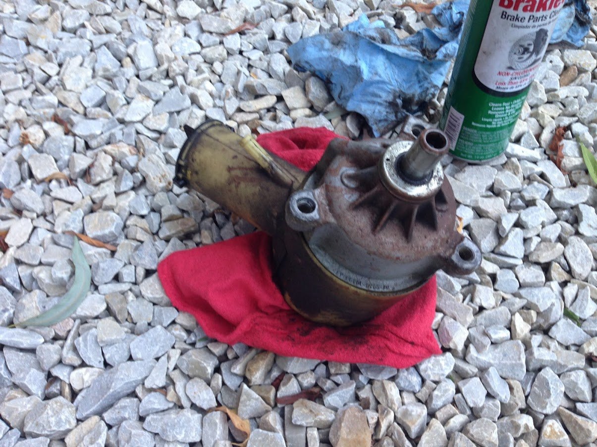

    Power steering pump has seen some better days as well
    Ig9UmGiBtS1cbzFRKK5AKsl9RPxnX7iCP39f4i7C_a8c0d7a9736aa0fac1578d4c4a426272f309d520.jpg

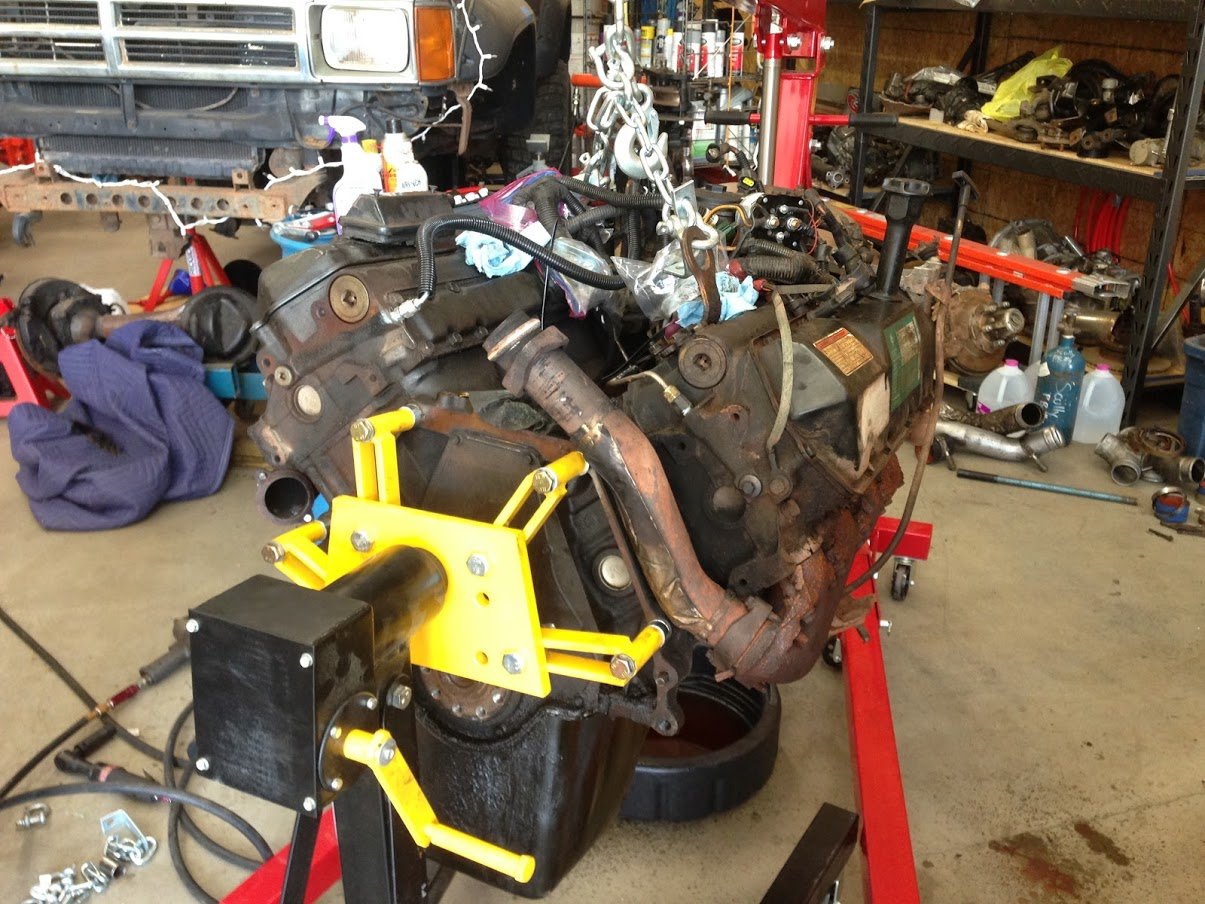

    All set up on the rotisserie

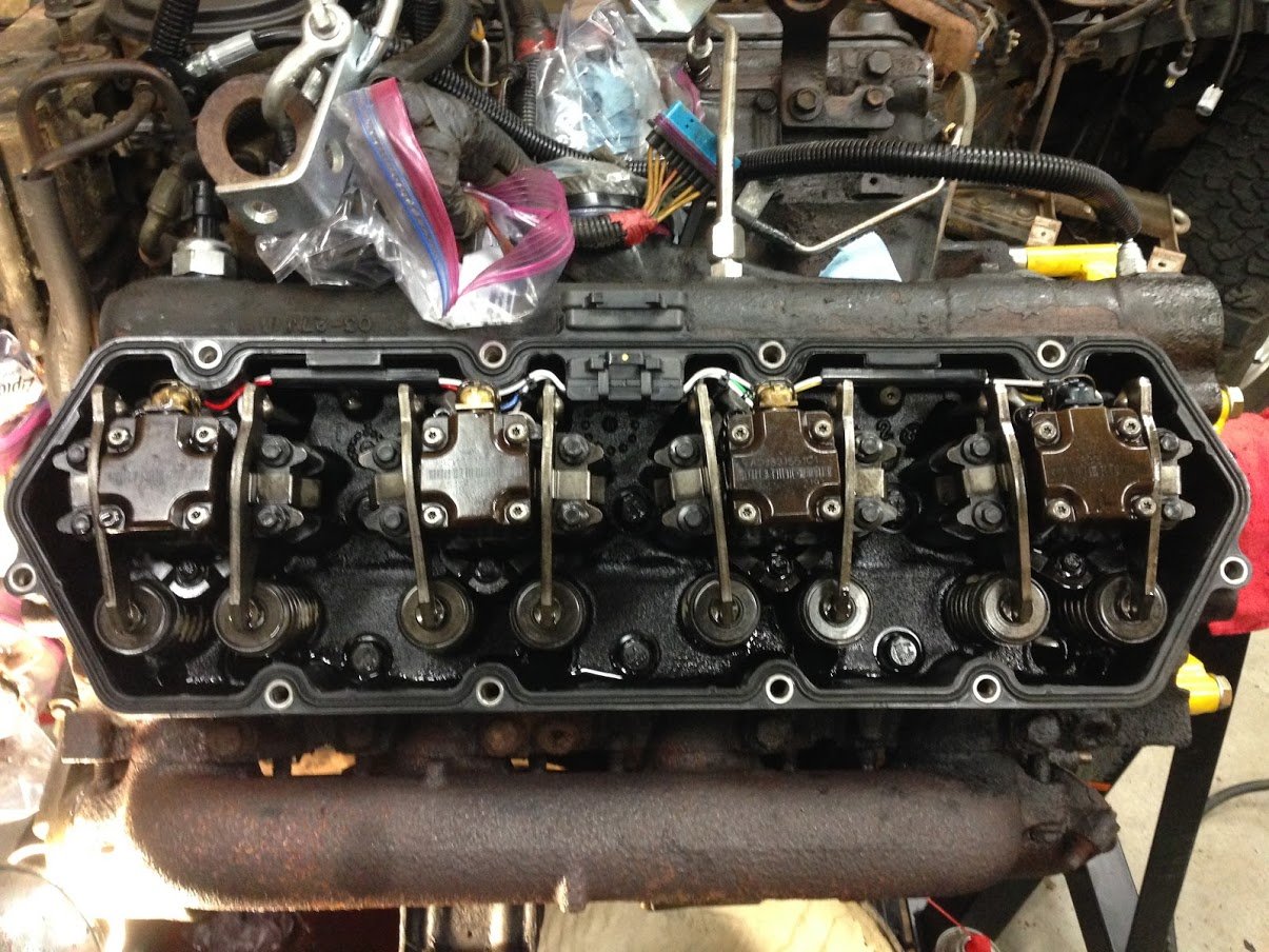

    qc4mUpGNL8gKq4CWdAIj0_dORIgRLwbpEAykWsMl_a9a9d41d3bc0afc328b9aa768918512f0e40fd21.jpg

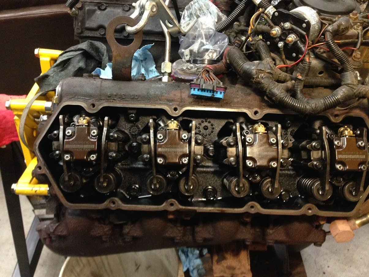

    Top end looks good for 1/4 million miles!B3tTosWLBgMZHRmBkuuxRZNe9oqv2NFCCAp5Px9j_52ead3ef6b4d2dda26f0b1ecd2c39a313e6bc75d.jpg
    a867RPVWVhk_wOzrBXkprgxcPWpuU-Ex0cXGGFEi_81f424892e9ddd8f9623ce33bc474286f3856fdb.jpg

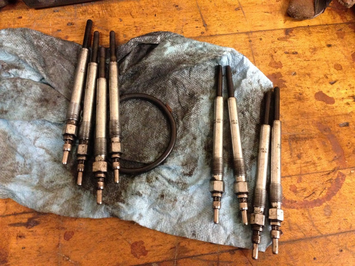

    Old glowplugs are out, 3 of them on passenger side were open circuit and 2 on the driver side were loose at the valve cover harness, no wonder it never started in the winter :rolleyes:
    rXGe_BJ2dxTZm4mylEKjVH4jnpaljMgaii5bkBCh_c3859ec31ef432a4f08fab09fcdafbff523fa7ab.jpg

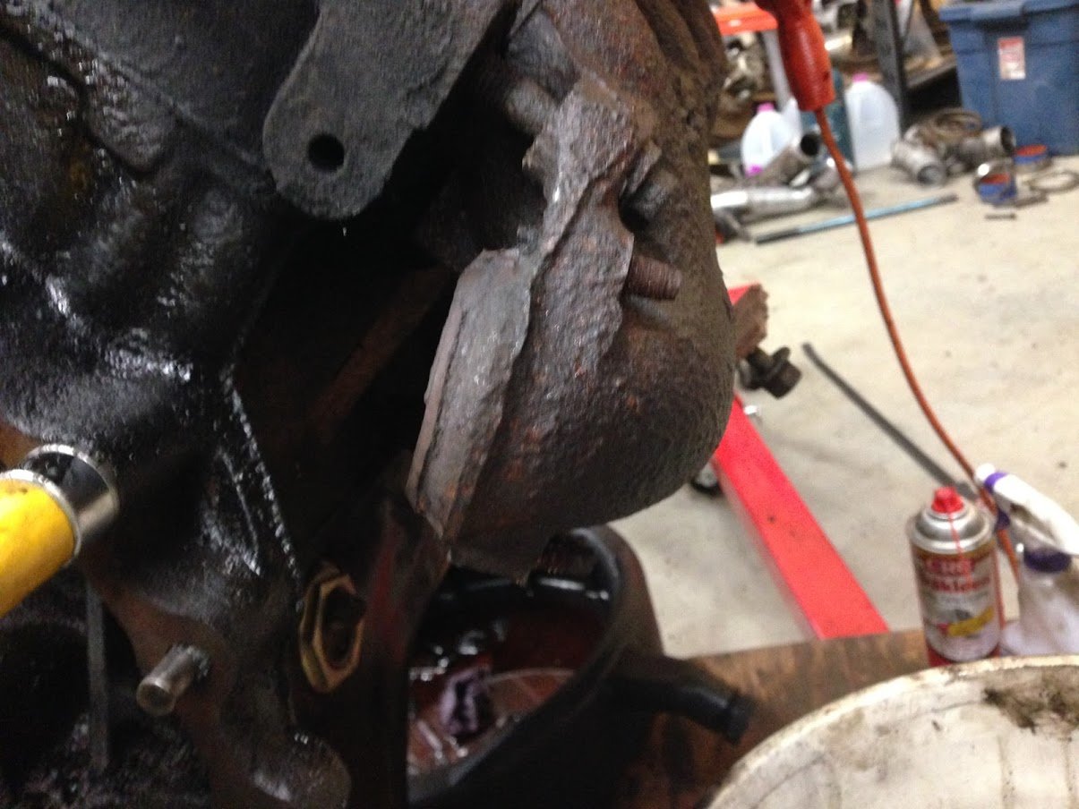

    The exhaust manifold bolts are just a little rusty
    8qheKuOIfe87ihj8z_rUQ-VAFeXE69-soW25bPbo_bfef4f54be9e98d922278081def70a96b5e1769a.jpg
    IZ_dZJzBtzoFUBQI25pwlakMxlTgEIwfpDTkhG0j_246ef429828096ddd325a3f3db6417ca6682c7d0.jpg
    dXF6mFUmuw7utKkgTYVFlThTTVzk91rnM-ZArj26_be5d6e87c238b42c57b1a43c2293e98a89685e4d.jpg

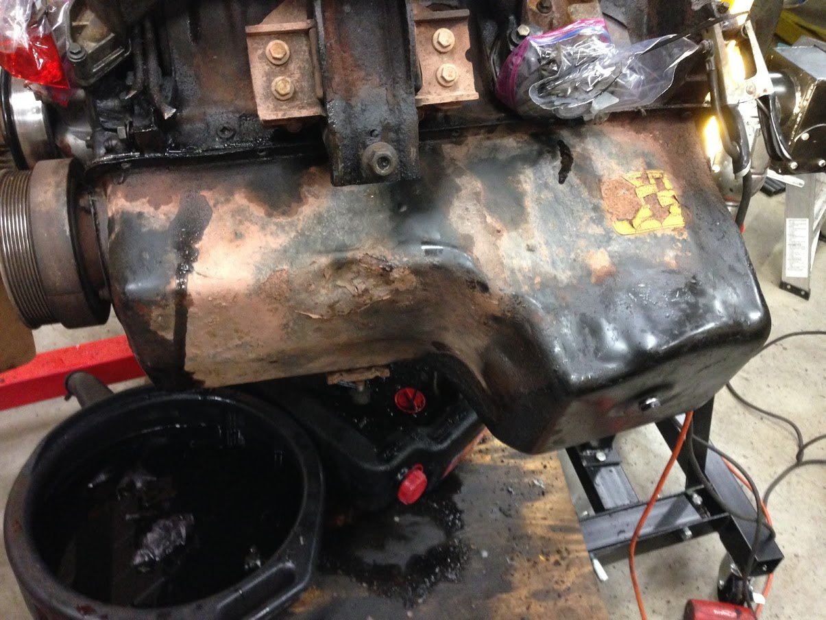

    Oil leaking like a bitch and looking like it's ready to give way to rust any second, a common problem on the factory pans for the 7.3s
    _g56p6XK5eJ2711CWuZsDTdX-u0ZlbaY1uFot7gz_7c790b65c8f386423f8c474a55f69280414c6243.jpg

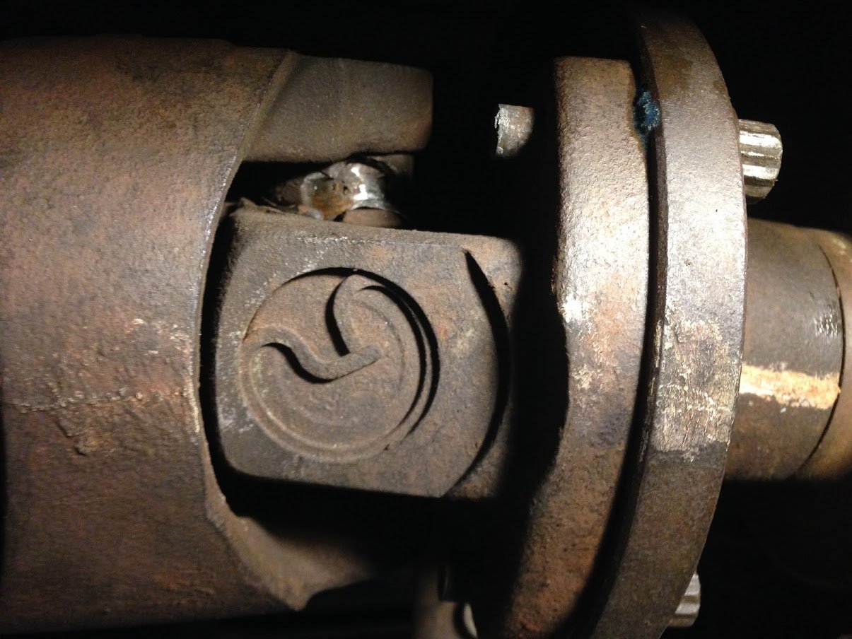

    That u-joint looks healthy :eek:
    ZGPvmB22RGf0SliTosYl98SGnMg0WcyavJ4Fx3oh_606ae39973360784e4bb51a103d0e878e28a5664.jpg

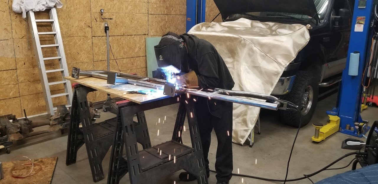

    Take a break from diesel soot to weld up some sliders
    ntlUBe-DTNmSAiMfd32depOgj6_NGc5IutluC-xC_c6a9c4c1bde6fb9db4654837bbc61f2be97ba3ec.jpg

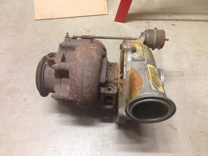

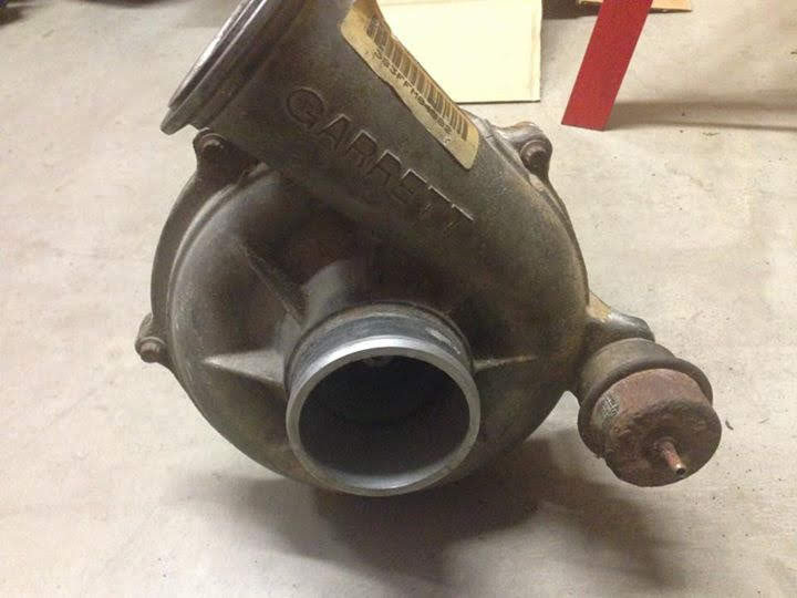

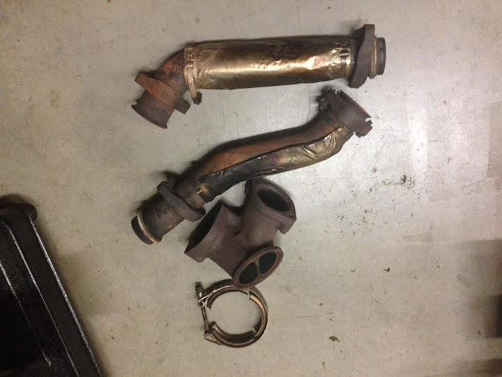

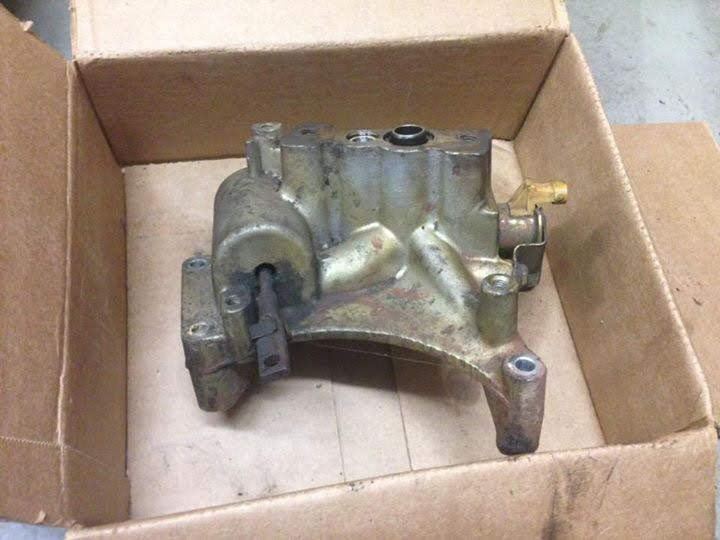

    If anyone wants old parts let me know otherwise they go to the scrap pile
    stock up pipes
    gMMhSN_2vKS5Zt-Zi_5li_ufaqxn8gPH3dETsUDo_1bfdbd7747b1deb0515e0fa4d30d0c8ffbb7d4cc.jpg
    GTP38 in good shape no play in the shaft (that's what she said)
    t3_3yodbeRetSCBtSOFT0Kg4Ttvj6-UL-IYR7q8A_24450bf8596339ac216c02e13f4234ab77ec8fae.jpg
    0ZpDqEu60WFKPFVCeFE3xgN5Hr3RWpwo7qcRv1x5_02eb16d35cd83c38150b7416f2d08ff71467e56b.jpg
    EBPV turbo pedestal, no leaky
    Q-KcpFjOHREBbcpqfhr2iT60k4ByBPkM9DAtsoII_76e4964e206b1da512f8bbcaf3c5308cc47734fc.jpg

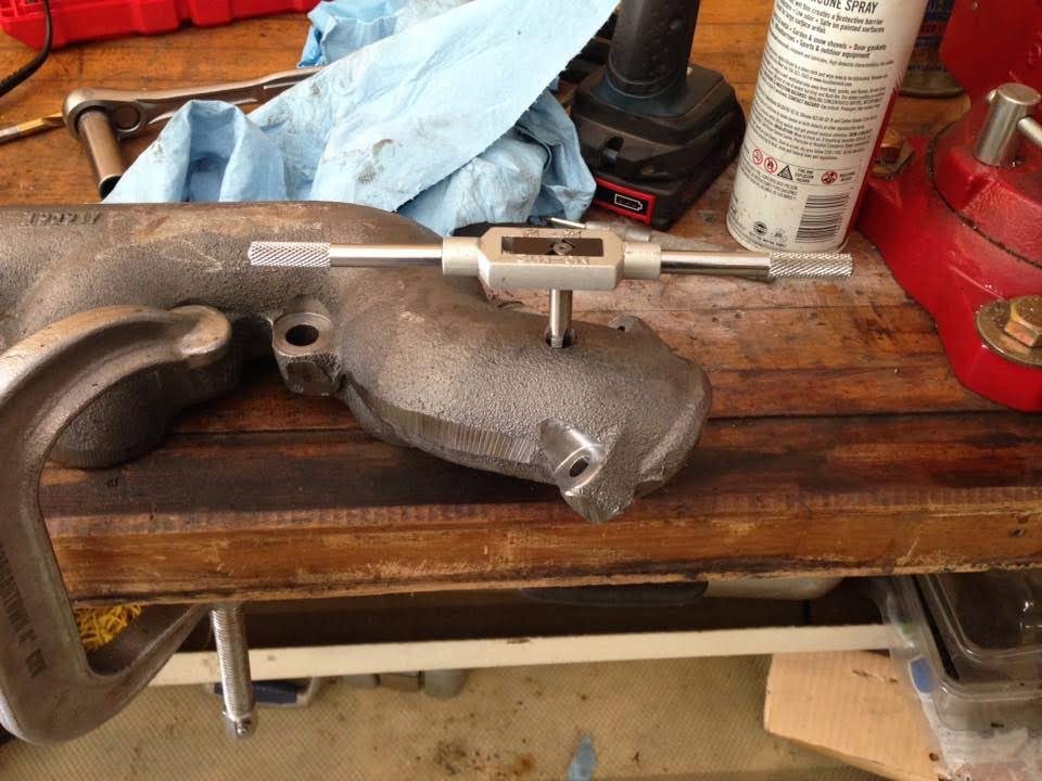

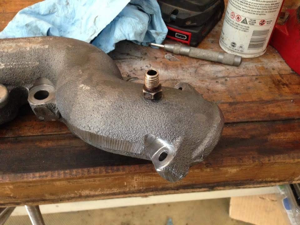

    I drilled and taped new manifold for EGT probe
    GZeo07PomzWFbsGk2wy_YKBL1QtVIriELB7slg6q_6bce76b9fcae55c5698407a1fe181667ff1dcb20.jpg
    LNsW7VDn04wTnM7EJ-AHVkdI33zUyZ4kNDF78grg_4d74c02afb49c6b0449303c2f5cb7c2c293c8710.jpg

    If you’re going to scrap them otherwise. I’d take the GTP38 and pedestal.
  20. Oct 9, 2018 at 3:09 AM
    #40
    6 gearT444E
    6 gearT444E [OP] Certified Electron Pusher
    Feb 3, 2018
    #243372
    7,798
    Deep South
    Herculiner Hootus
    shipping might kill the deal, if you really want it let me know. These bastards are heavy
