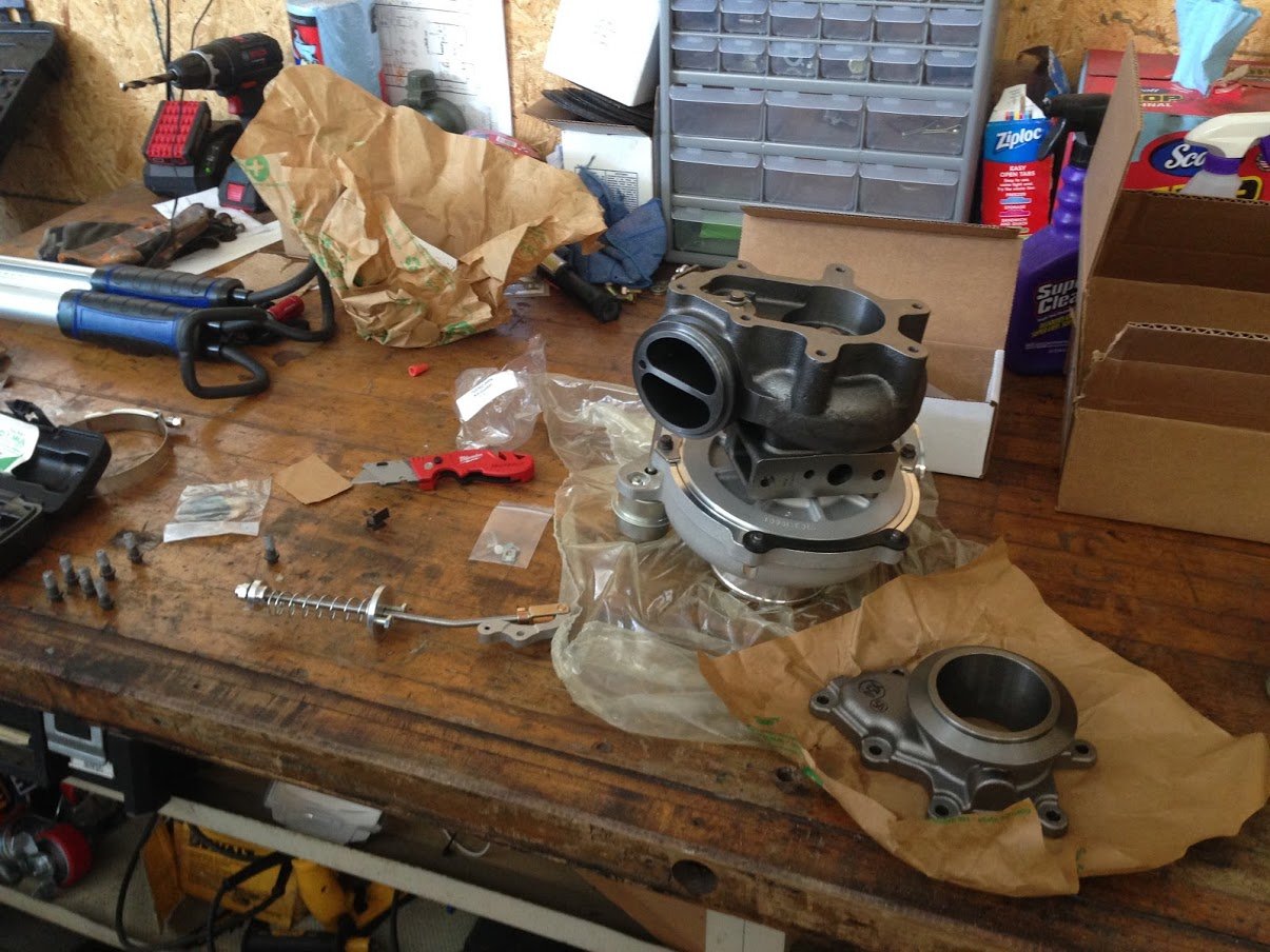

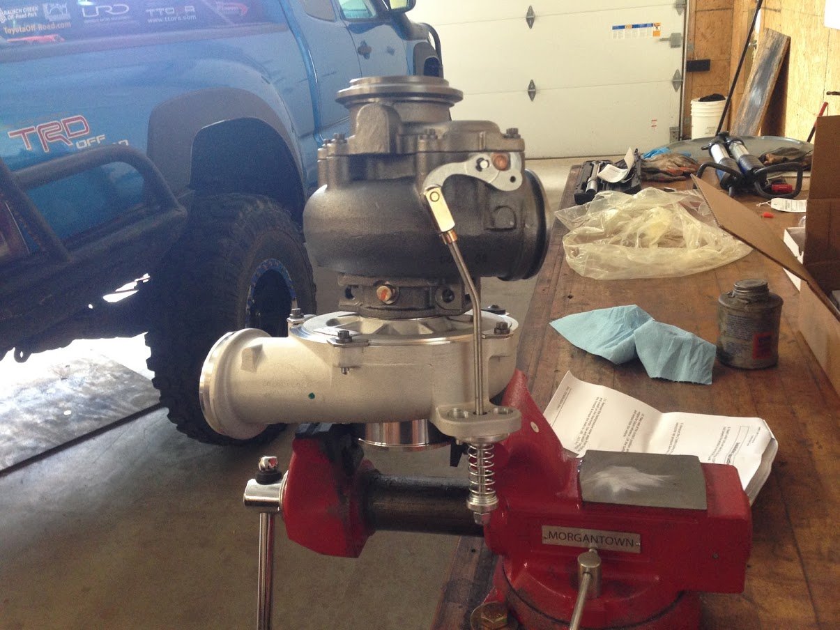

    Shiny new parts getting ready to be installed.
    GTP38R with high flow outlet, and EBPV pedestal delete
    WuMi2LH5Ubl5cm69VlHJF58tJ_6K2J5qhqbiPMS1_489197f21c7c6c4d1963a2ba3e5031ce4c56f52f.jpg
    High flow outlet installed, along with turbo-master wastegate
    ecW7h9MIiMu6jFYsmxwC11hwWW6POSjehyfCK34W_4817cba945a376e252163fe9869743d3947c75b8.jpg

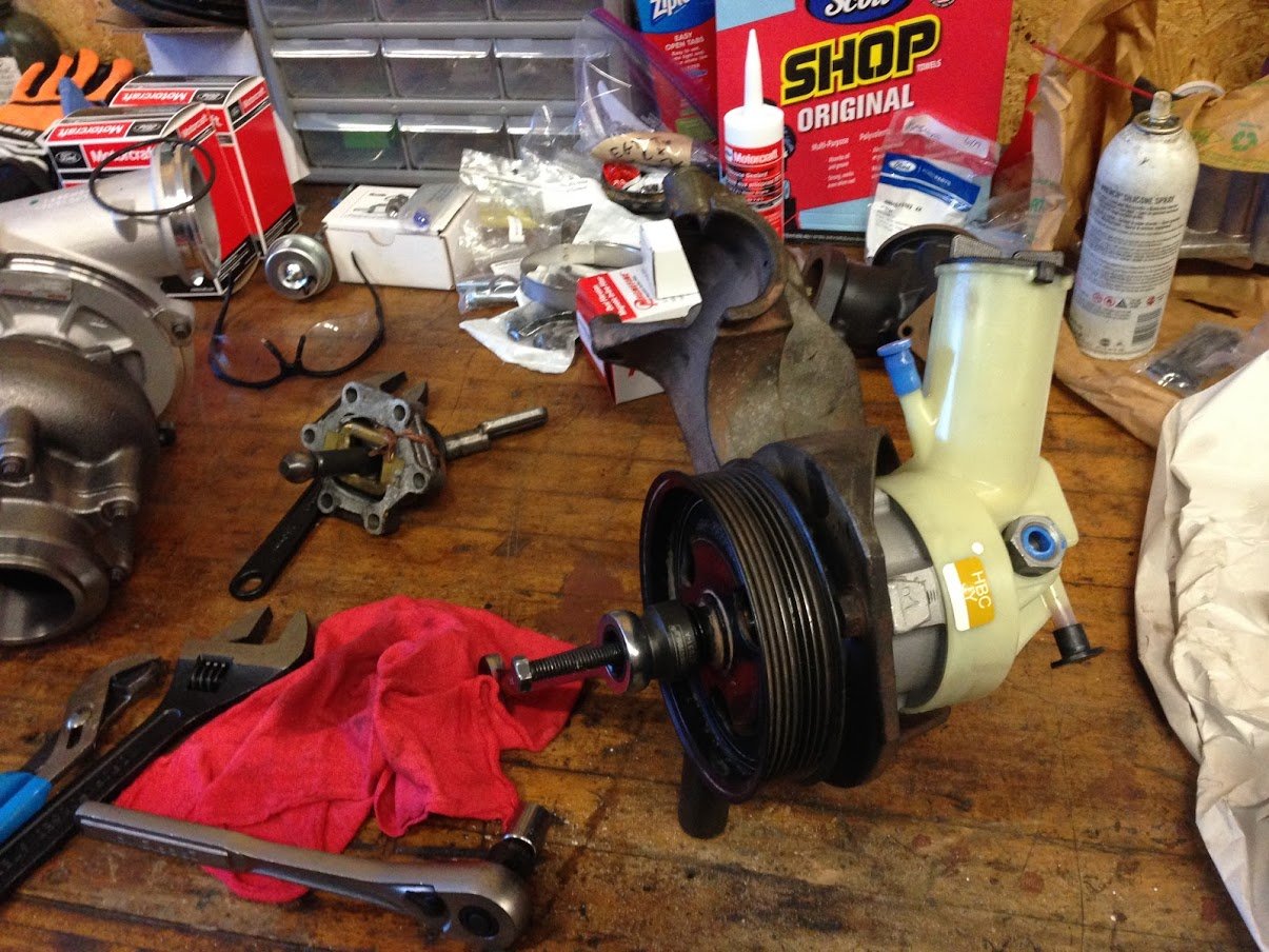

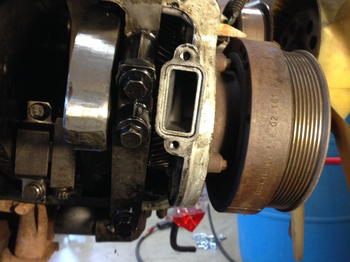

    Pressing on pulley to new PS pump
    tvUDDbXFuQZAZ22V9DLnDci8yA0PDzofg6pp32aY_0abd37212bb583a21701b72a048d8d6b7008244b.jpg

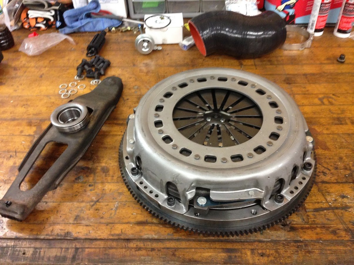

    New clutch fork pivot stud
    cBIiUmsH69XnfsYcdkwFw-OO3r4kr-rdQ6sjwdMU_109c682f227707232dba405749943925896460f1.jpg
    New release bearing
    fJrg3clNCp02ieM3YBAQaQUl0UtB8eayyWSxU7O7_29ecf466e4a33b6d8204ccb949992b5d73d352ab.jpg

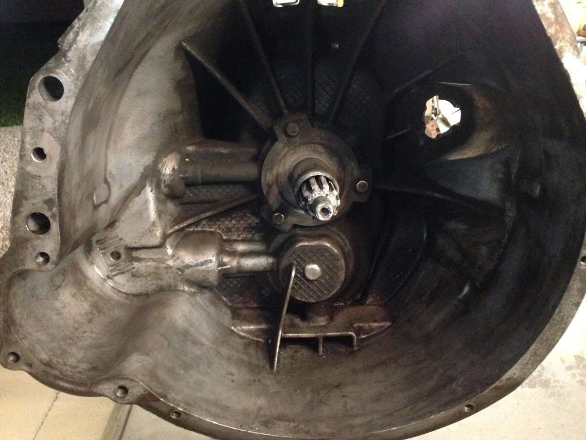

    Bellhousing cleaned up a bit :)
    6q4WxkK_2LrhMTnEoA57z6hxrJRnl43vNdB7Oxlv_1a3995fd41f9706d07df5932b755cd8330228d6d.jpg

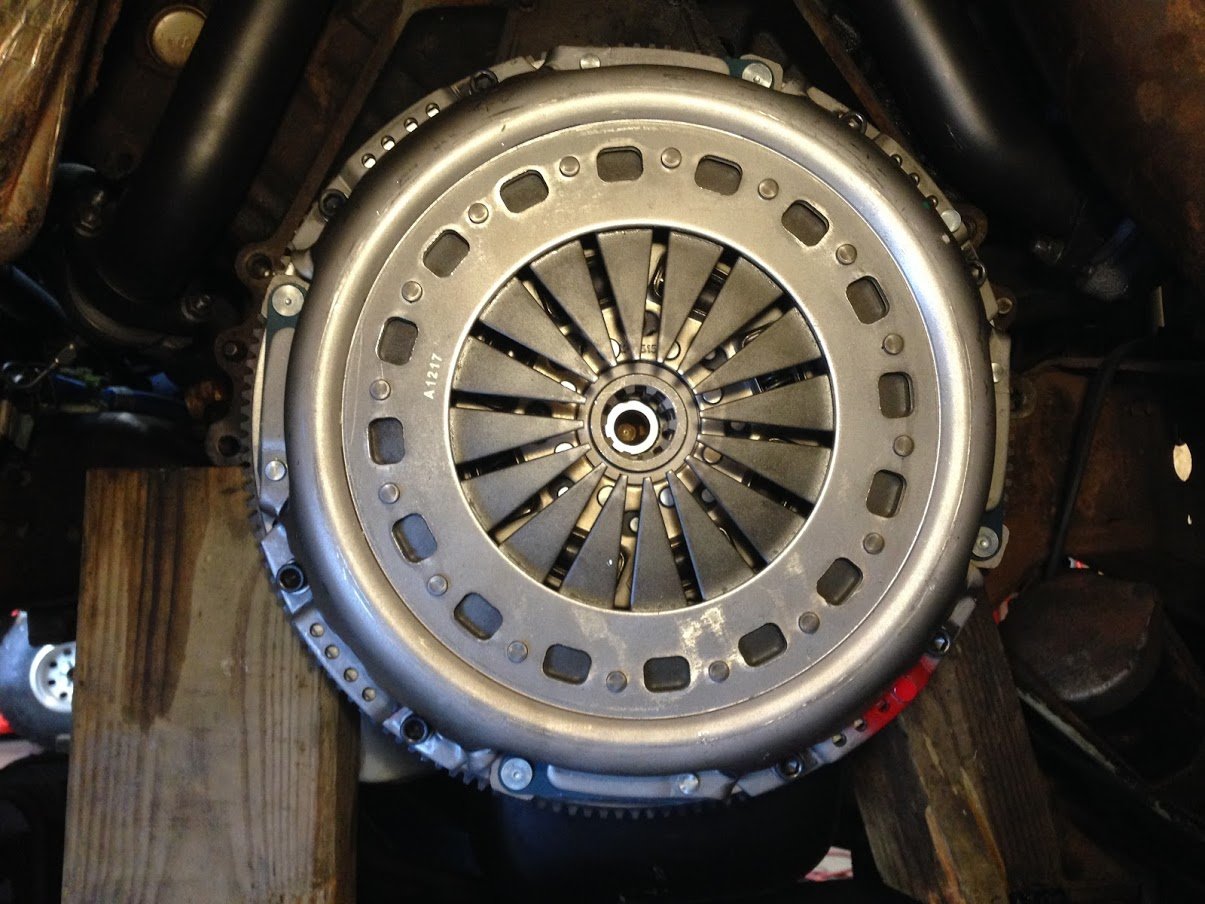

    The new goods, South bend dual disc organic clutch
    jN_B7vbKXag8q8ofZyuD6rkvIOOFsC2S6XORNBne_bc23455003b253e55ca4831724f5f011603f0b03.jpg
    3Kej2zMStXZSQAdGdTJv0lYTGJVCia2sXKNA8PGE_96f56d8ab1c374b469e8a3e0ae73063c3ee57901.jpg
    I'm super impressed with the south bend clutch, the quality and customer service is outstanding. Packaging was great too, this clutch setup weighs 120 lbs according to the shipping label and it came completely in tact, although my UPS guy probably hates me :rofl:

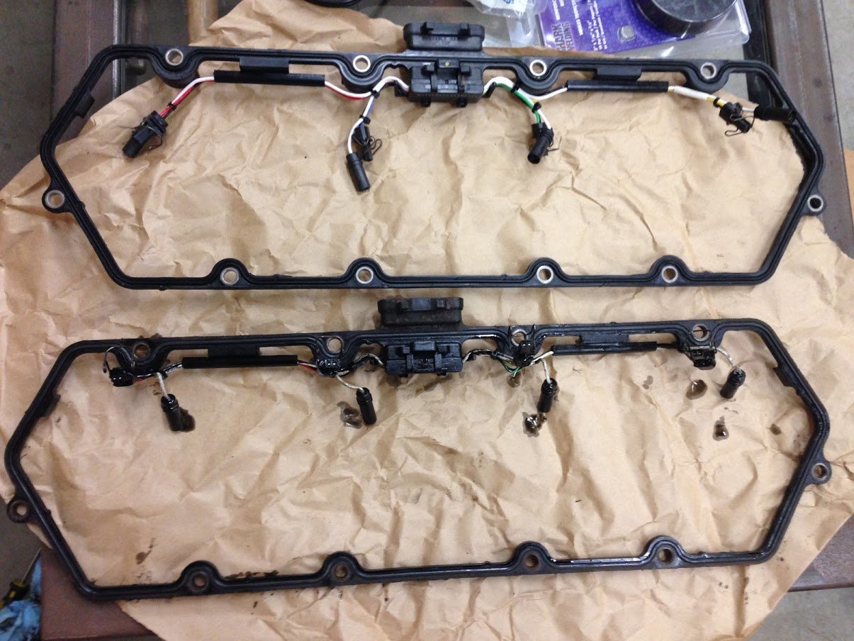

    Moar new parts. Updated UCVH and valve cover gaskets. New harness has better clip retainers than the original one which should keep the plugs from backing out like they are known for doing over time

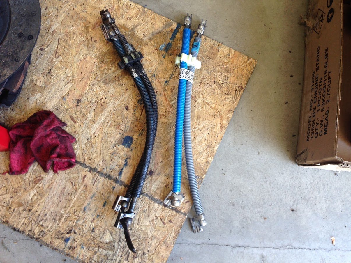

    Replaced the lower flex supply and return fuel lines, old fuel lines were seized in the quick disconnect fitting so I had to cut the lines to remove the engine. These bastards were expensive
    gUVtP65ytnnI1vRNSISuWJjoy2UBzhmtWfnnvVKV_b93fe14cab278e52c8d6faff0d0c1a97bc894a02.jpg

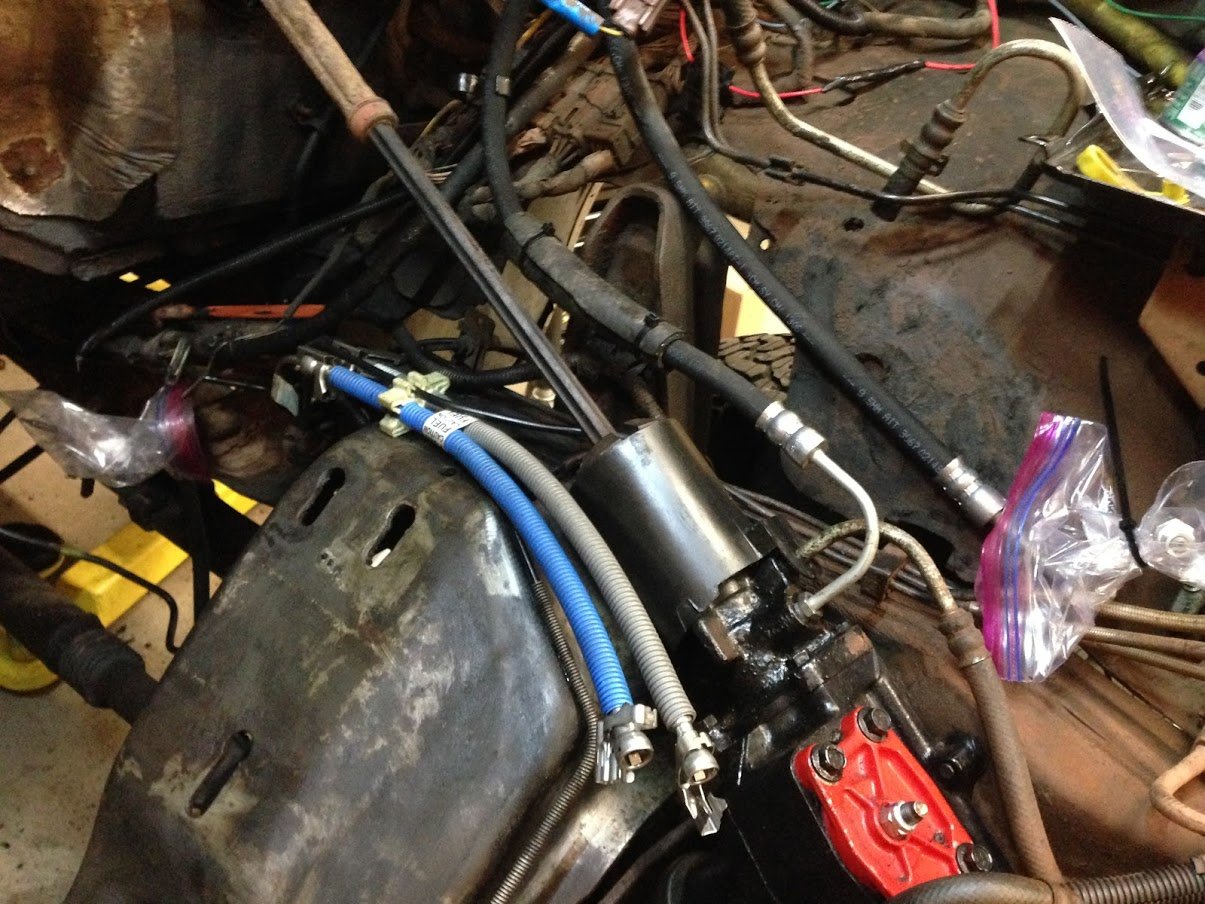

    Replaced both high pressure hydro boost lines, these are known to leak as well so after a 1/4 million miles I figured it was worth the investment. These lines are also used for the braking system as well as the power steering since the vacuum system is alot smaller than a gas vehicle
    Here's removing the old lines
    qJi_uV5v6J5UruyyPgLfjkAQ_5PPAzX_LIuOOfwK_aa97f5096f373a2c70d3cff84ee16e1ea53ef35d.jpg
    New lines, sleeved with a coolant hose to prevent wearing a hole when rubbing on the shock tower (another known issue on the 7.3s)
    P5SLIKkvrg7ep5vmOsWd9YXu5lRIYIVXnCJ7Iviu_fa62a99d9130eedaf22fe7183e24eb764e33ce38.jpg

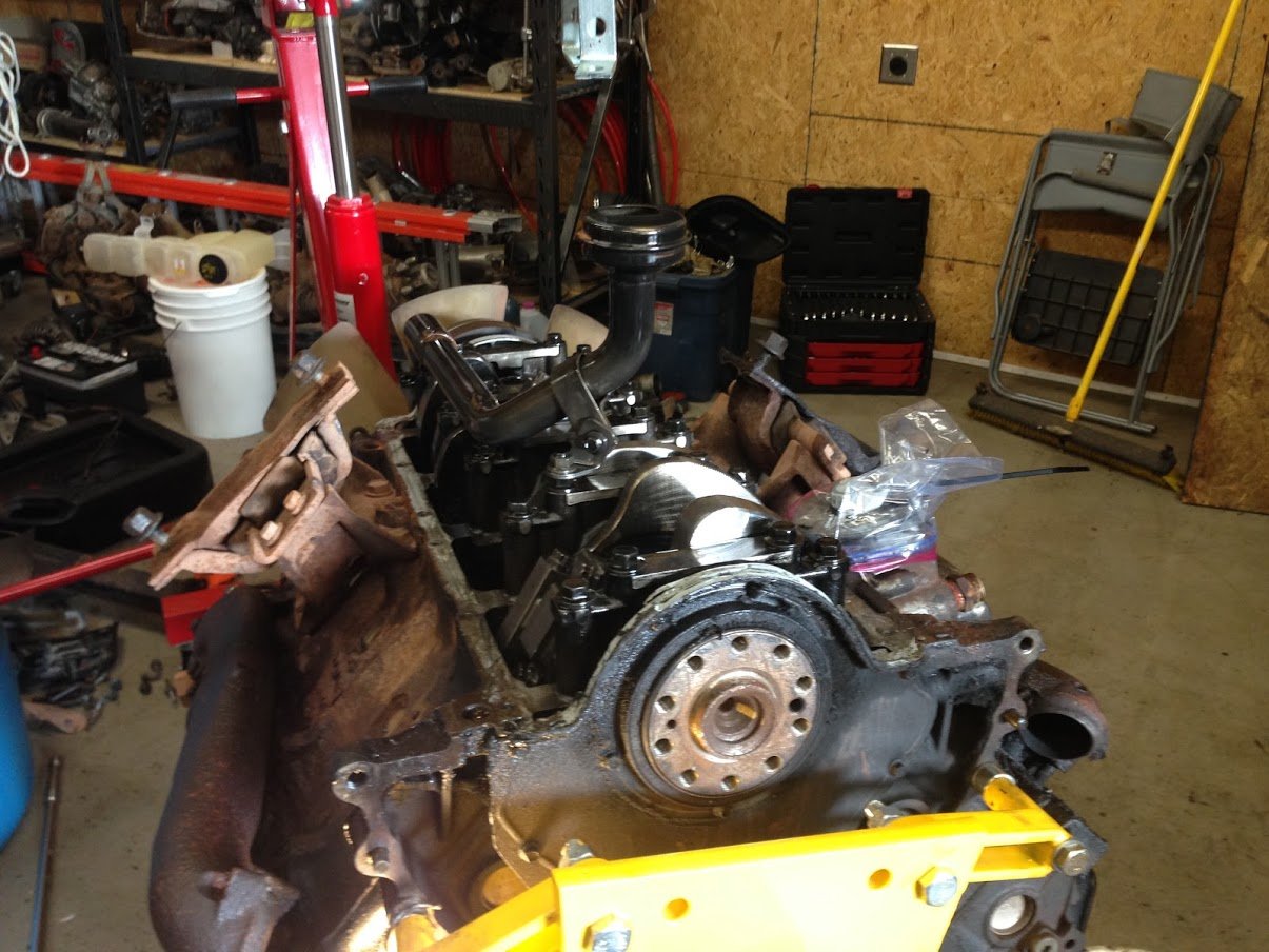

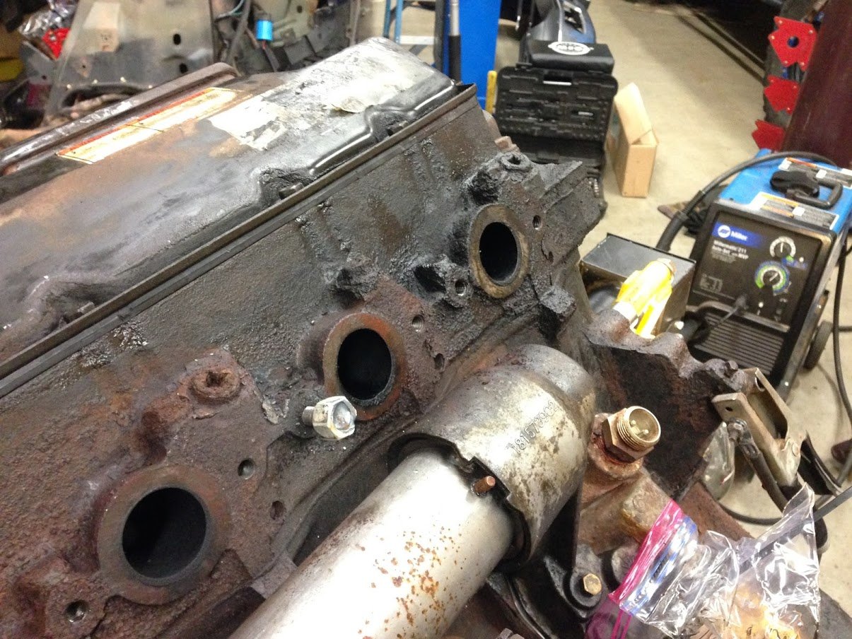

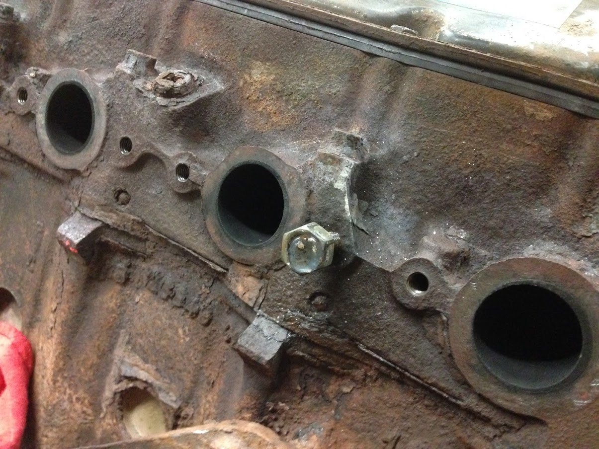

    Removed the old manifolds, of course no good deed goes unpunished. Two of the studs broke off, nothing a little migmonkey like myself can't fix. Weld a 3/4" grade 8 nut to the stud and the heat breaks free the stud, then zip it out with the impact. Passenger size broken stud
    LsJcyh8gccKhsl2rFC6n0vtEkEkyfxZWPq9HkBFM_0aae3920bfb92067ba19f6c295944e648cccbd78.jpg
    Driver side
    _jekjsyNu0LugCdP_pgXdQDfePHTJ5wlKZH_FyLU_3d61440316fc5557d2c72cec0b157066989f5eb0.jpg

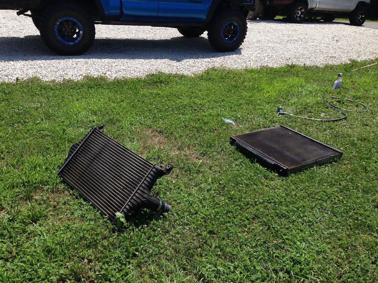

    Also took the opportunity to clean the radiator and intercooler, there was all kinds of crap plugged up in the fins
    2q5IV1V6W-c6yVcjfdFmv1cAnkTlOrbqVO4YXP1L_a30490b6a08577e39acc24f449a59fa36dc3c6ec.jpg

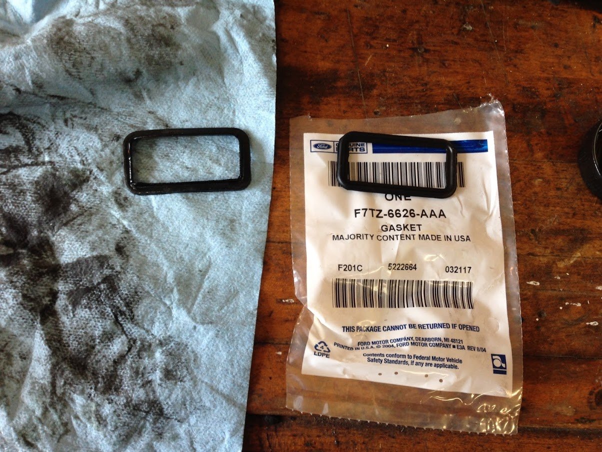

    New and old FoMoCo gasket
    VAU7Ozyqdf3i3-V09OXWMT59_0viJOQAgj6cJ_dy_0d892f4fa59f3877ce3dbd084d603e054ca07c2c.jpg

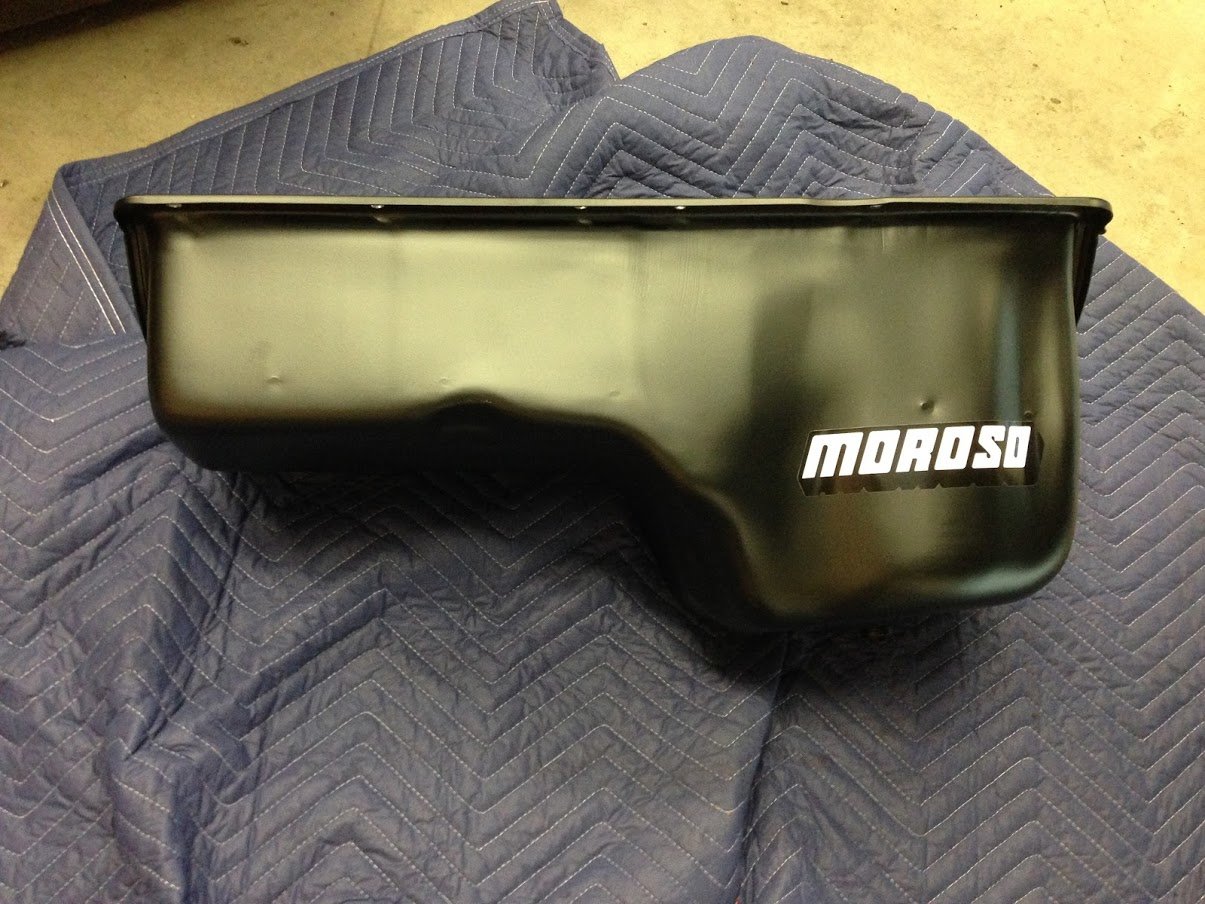

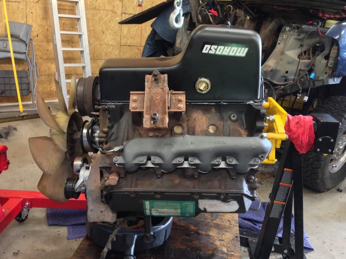

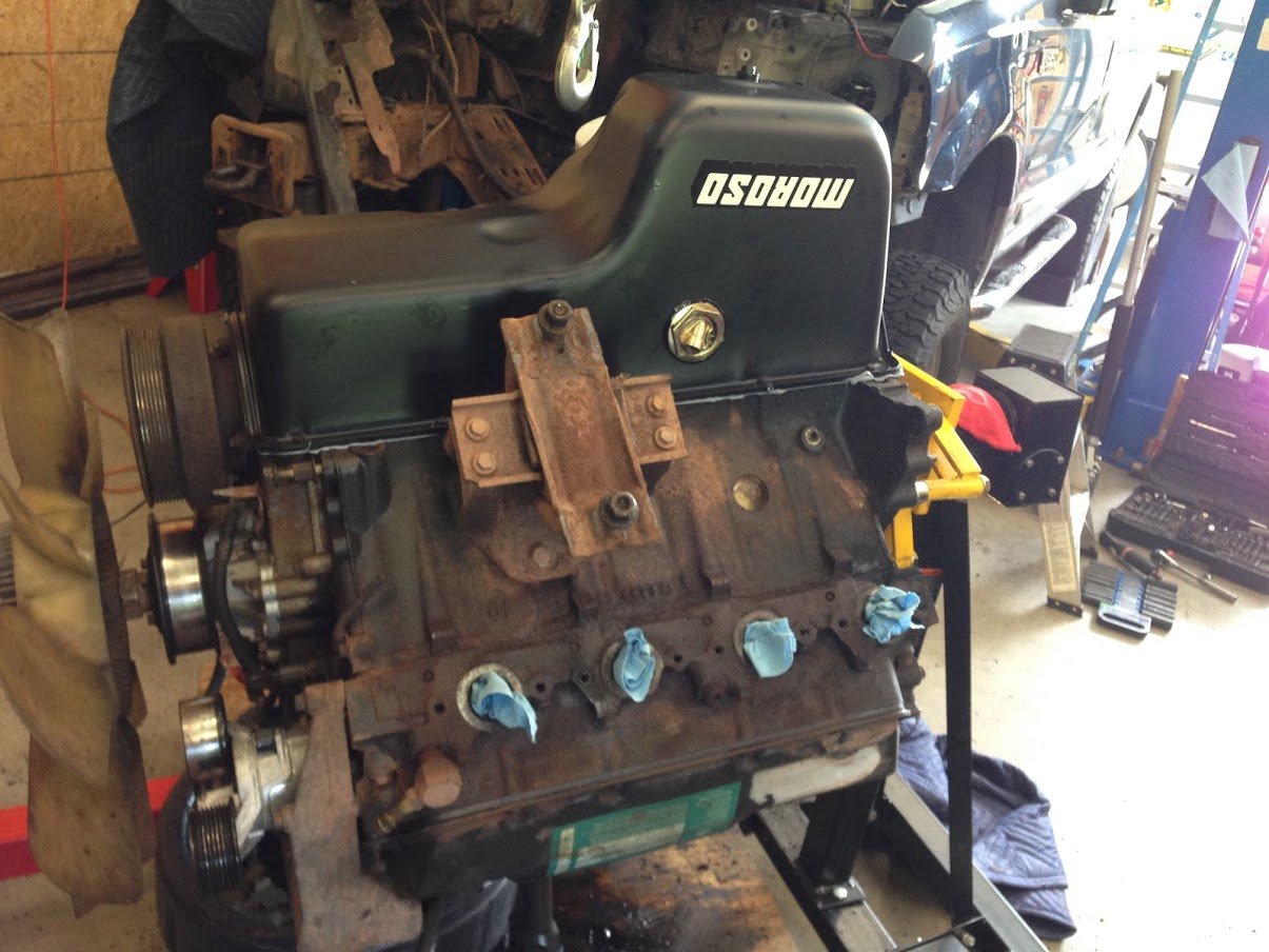

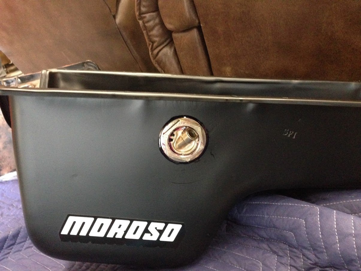

    New Moroso oil pan. Went with them over OEM due to the fact that the OEM pans were known to rust out over time and the Moroso pan has a better zinc coating and powdercoating, plus it is a little thicker guage steel over the OEM pan.
    5OOhkBLn-CkIPI-471iJKRNM6igPiq3ecLlqKbwf_1b041b8ac86edc2583beb52fd32a1d061da10ddb.jpg

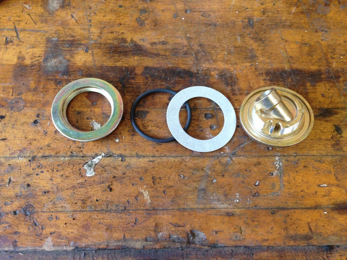

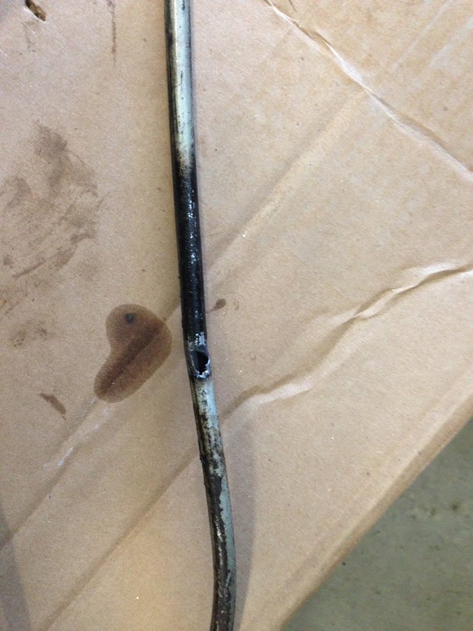

    New oil dipstick tube adapter hardware and soft goods to replace the swollen o-ring in the old pan.
    OWXOI93D2A6BszM_KxkJM-xcxoI3DaUpfK2Xn99r_8fabcf12561b12f8d61af66bf7df84a48ceb5ba9.jpg
    Here you can see the previous owner also tightened down on the adapter nut too hard and bowed out the inside threaded portion, hence the whole new hardware.
    Fpx3hi8S_aH1pryXfHaKyP1BPD-NdIha3b6MwX_C_d1139a3f5e78aa03b55faa2a22a2e2d2256222c6.jpg

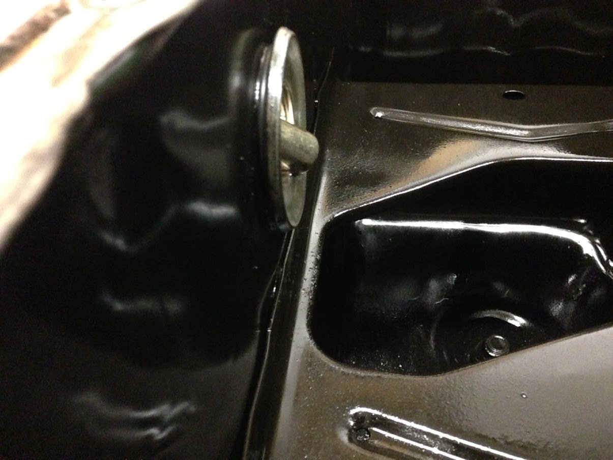

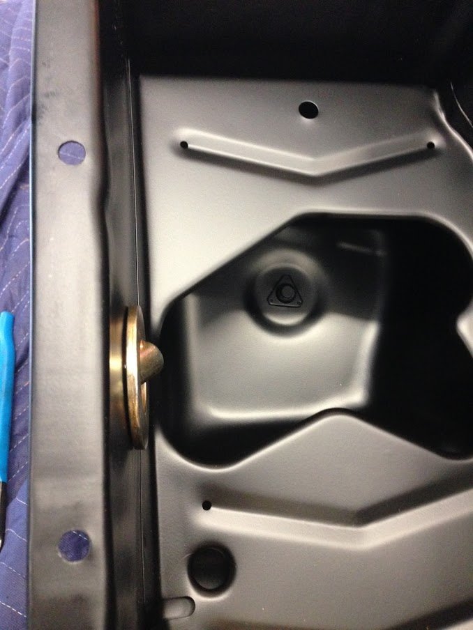

    New threaded adapter installed, you can see a nice sealing surface inside the pan
    h_J8S04iZ-_NcHESOMKn9hnuKEpvBfYaE0Wmo7bh_83a13c049ad4ba688b3c91b6b8f8948cfa9dac08.jpg
    New dipstick tube adapter installed and torqued, added loctite 515 to prevent any possible leaks
    hcdr6vexuiug15dlmlv5YrB3_JVOMAFraa6ETixU_333245c8d80cda48c623c45efd47d388888d8a4d.jpg

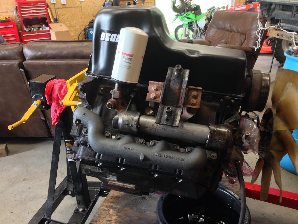

    New pan RTVd back on the block and torqued down
    bCPAWHUbq96hcU3TzlYXP1eM_eYtZRsGR-YLiMcG_d101ba55d4f7b70d666c5705429987c0075b8073.jpg
    lOEzDlF4eHIzzSOmOdRyxQ2nF-P1BL3rNiswTFfu_e877ea767740d5013610c08b149478868ad6c2bf.jpg

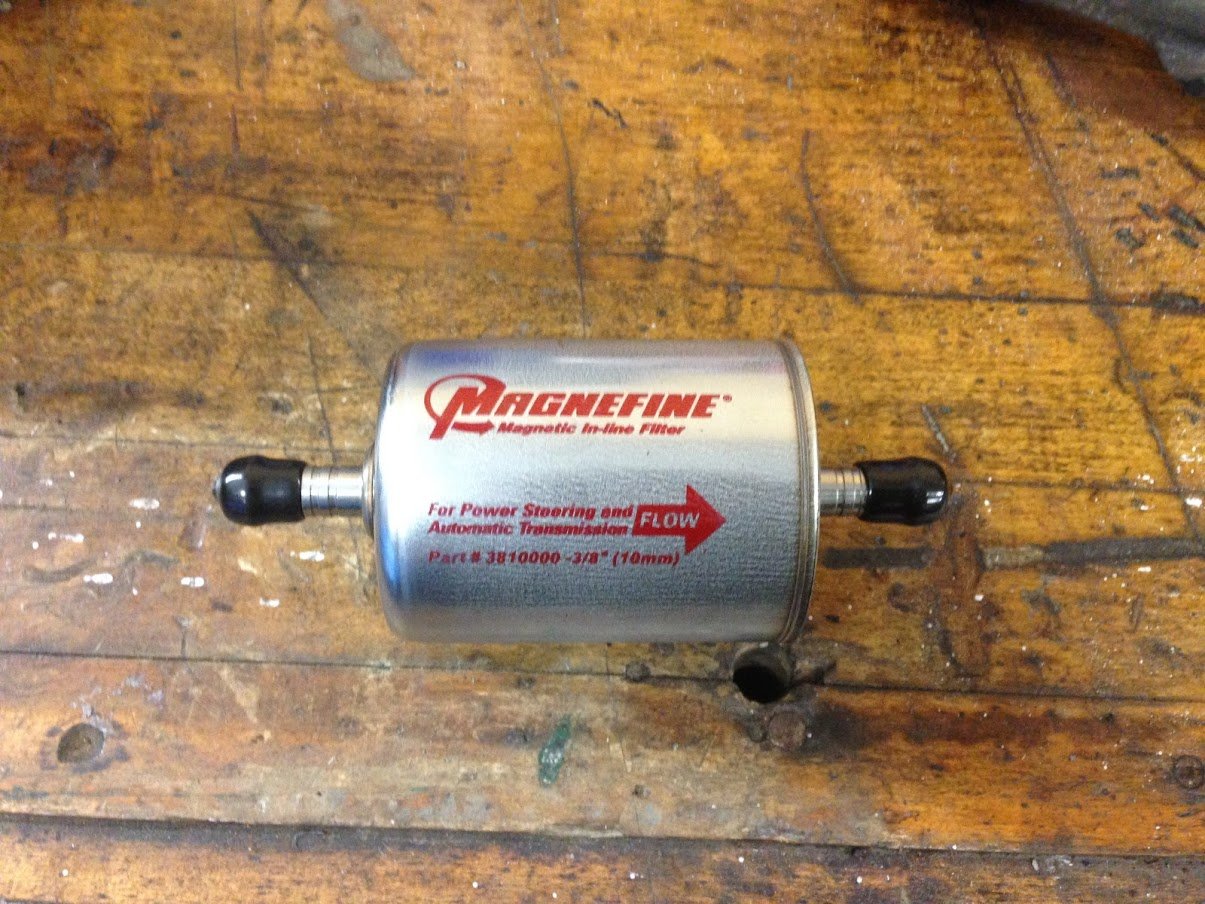

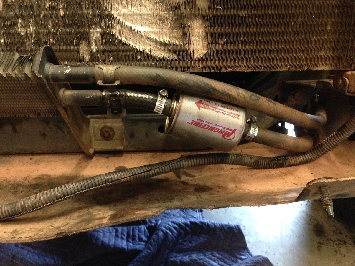

    Picked up one of these thingies in an attempt to lengthen the life of the PS pump and red head steering box
    xTQSGYnoRGP-4t8muVR5Xpbn-oBptN5ScjDKOtyD_c47c57c26dca1c7351cac562f0dff397ccc308cd.jpg
    Installed between the PS box outlet and cooler inlet
    TozLaE5v43903u2kMfWLKvYQ9SUpTo0uslYESjFG_4dbe604a4c6e8846df80b31355b135c439d7dfc4.jpg

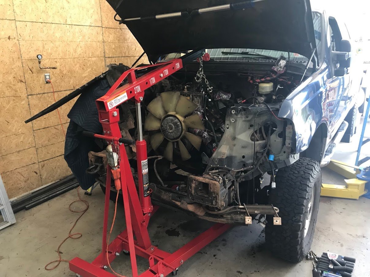

    Had sommore help from @HomerTaco to land the engine back in the truck, easier said than done. A little tough because of where the balance point of the engine vs. how much space you have by the firewall/cowl area to lower it. Ford wants you to remove the cab to remove the engine, yeah that wasn't happenin lol
    H6NPqwoTpU9rHjgOMzskPSg3omY42LfhRVP9j1gC_91d0e38bcf6f8ce27f0c33cc3a7ca5d1494aec69.jpg

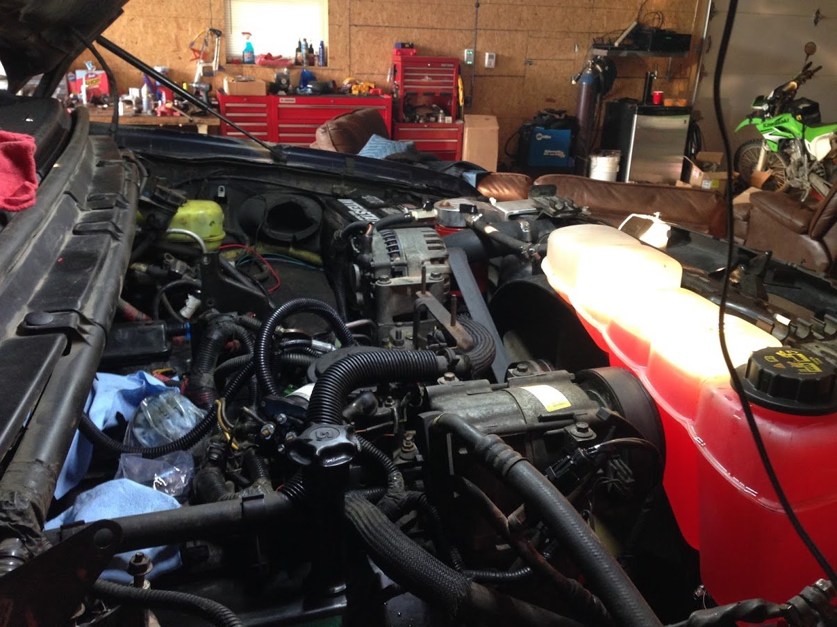

    Alternator, A/C compressor, power steering pump and serpentine belt re-connected and the engine filled back up with ELC coolant (8 gallons worth! :eek:)
    BRuvNgZyAlw77IBaqBrYVB6sA_aVvGySe3zpRkqp_bb59b938c1f35599b9a8bdd739e33f20004f2dcd.jpg

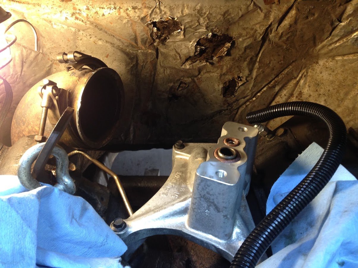

    New Garrett non-EBPV turbo pedestal installed
    ajk_1KBJT7bd1yNCXVclSW88gjulzwJW1Cng0gM0_55e1dbdfba9cdfb6de044ff217478b563fc028a9.jpg

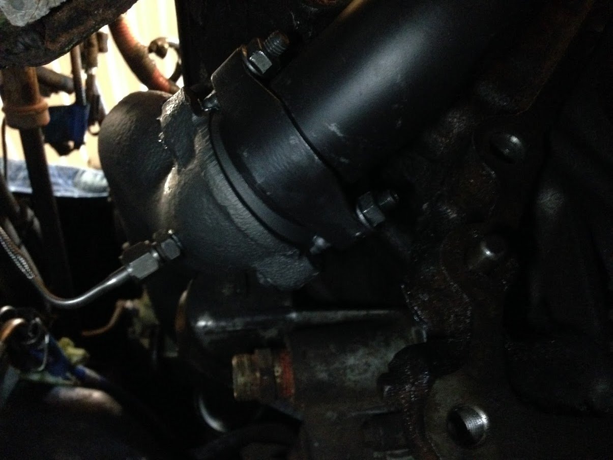

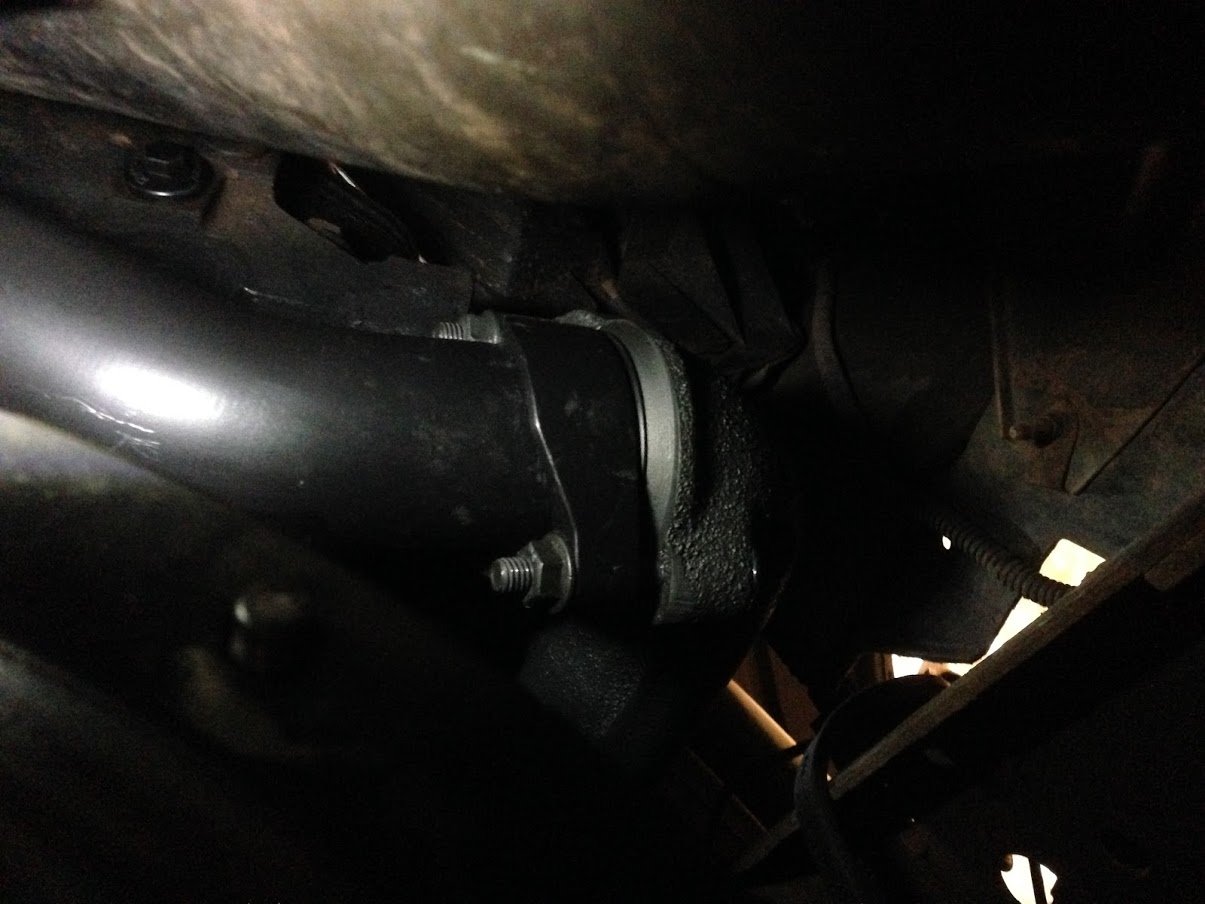

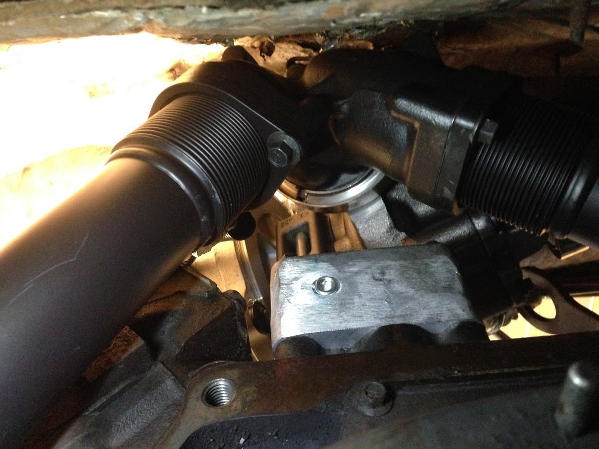

    Some ceramic coated international bellowed up-pipes installed as well, and re-connected the EGT probe. MUCH easier to put these in before the transmission is in the truck
    fnHiIQ7dEde1DN23wSBzxhX8eJNLSibG77oY4Rkq_6364c69f29e35233af4df3778c8286fb5773258b.jpg
    AFlMXyNhclo56oX1PI_4d5owHxNuj-ZWeIx1wCC5_86a89705ba0c7a6ca556954975a07ae1efec4f5b.jpg
    gikLbbsZ5ER-Wztzz-j_j5TiR0_rj8_0DLoVduB4_206b99f7995cdff16bb82ebef65fd16e19d89401.jpg

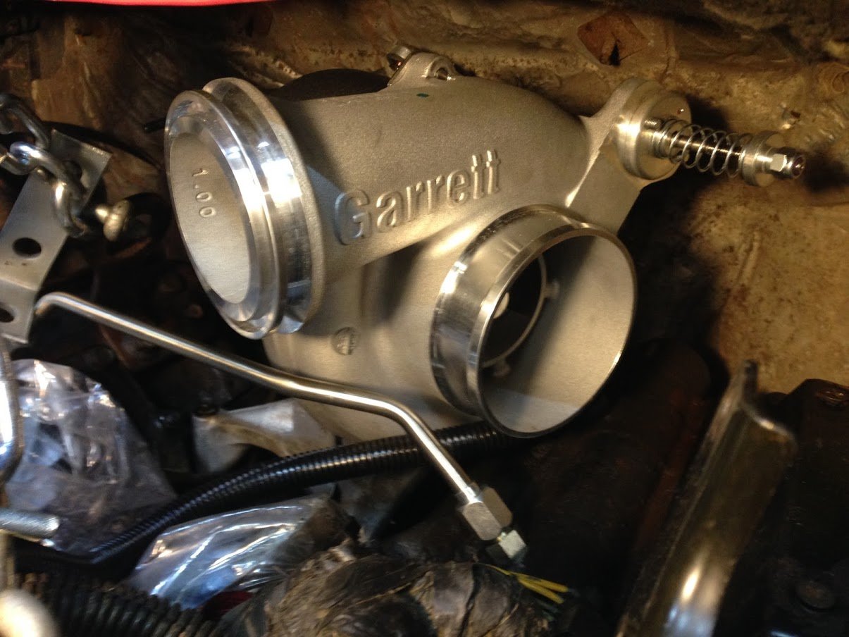

    Re-installed the high pressure oil crossover and brand new GTP38R installed and torqued down :spending:
    56tjov6F74i2VL17ddwS-XBlzA0E3l4-WZ5U6QLl_821c3f7b556314b94b3288906af3d6ba1d50461f.jpg

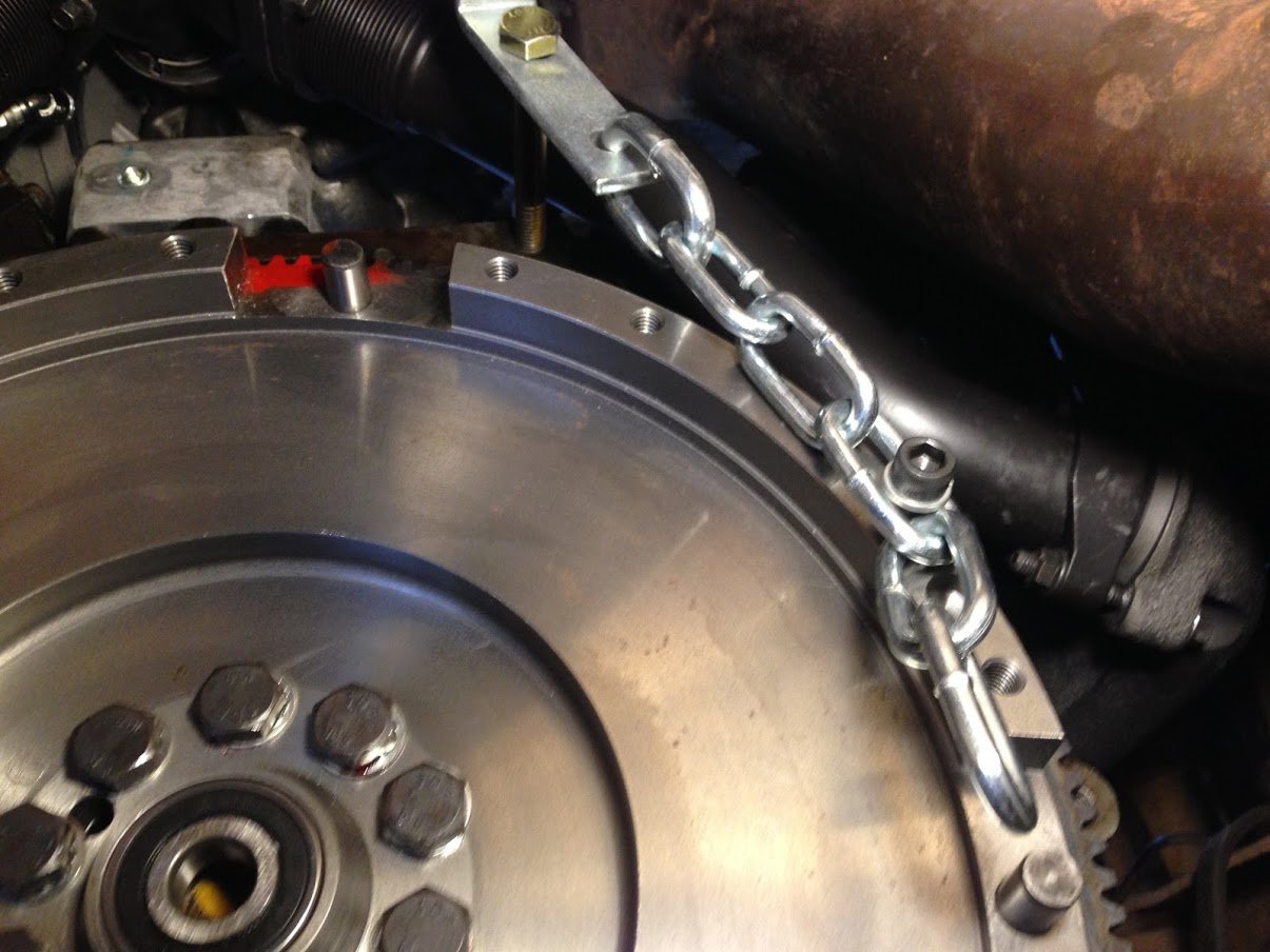

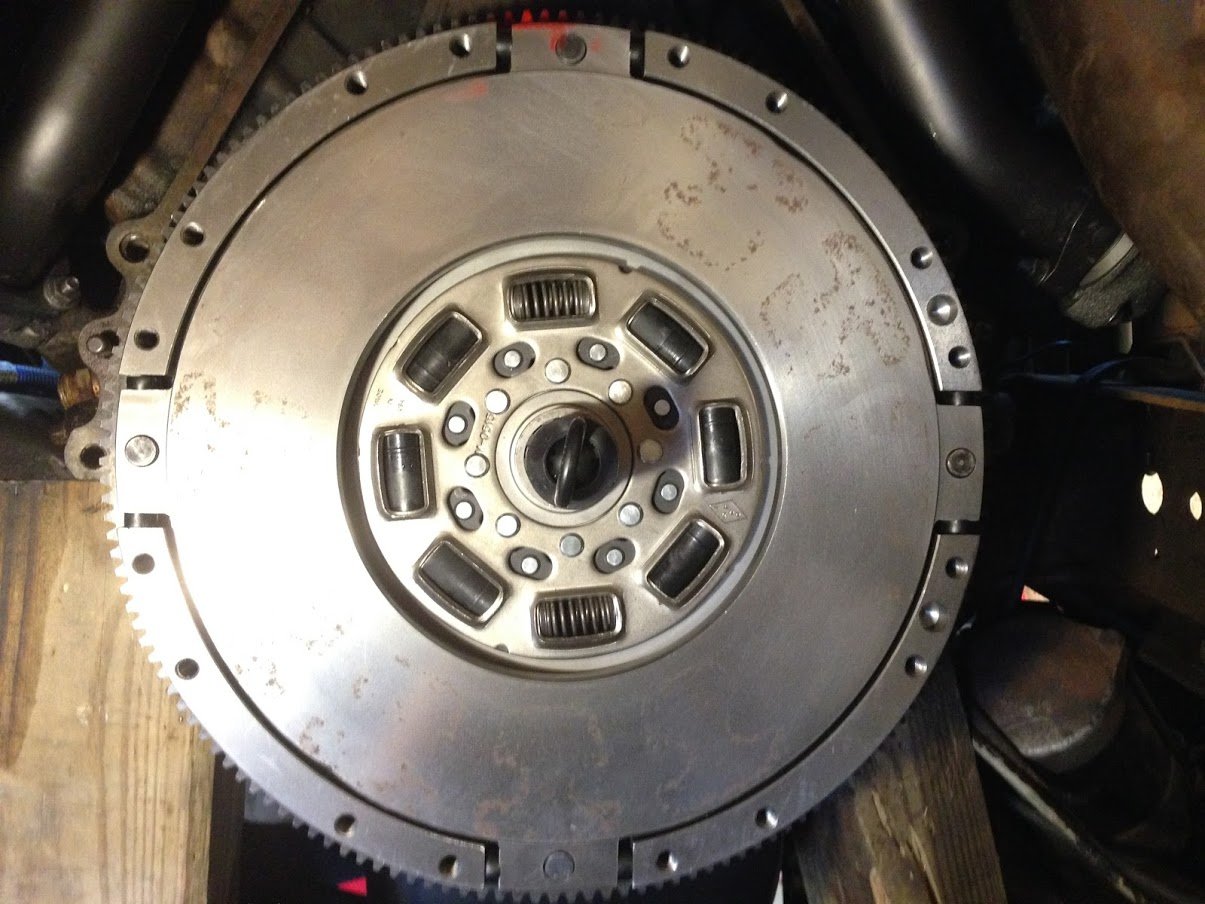

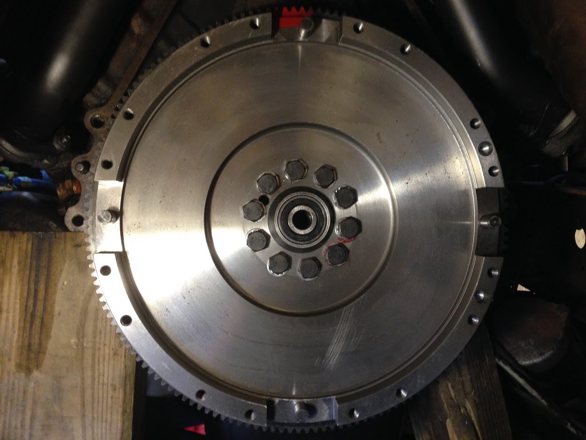

    Flywheel installed, bolts red-loctited and torqued to spec
    veDSXkJSRGjQGVu4K8_u7ZIgTbcnXWEZEuTm8r15_1cedd14eb8645ecc38632830733dc87ffc668d21.jpg
    Tip when installing flywheel solo, chain the flywheel to the engine block using a transmission bolt and pressure plate bolt so it won't spin :)
    G85RVCUeuv-U-TbkW7Zv66M7l91nKAzMQLMgDVtO_9c5ac2c2c1167cc7da0c798325fdbb298cfcf60f.jpg

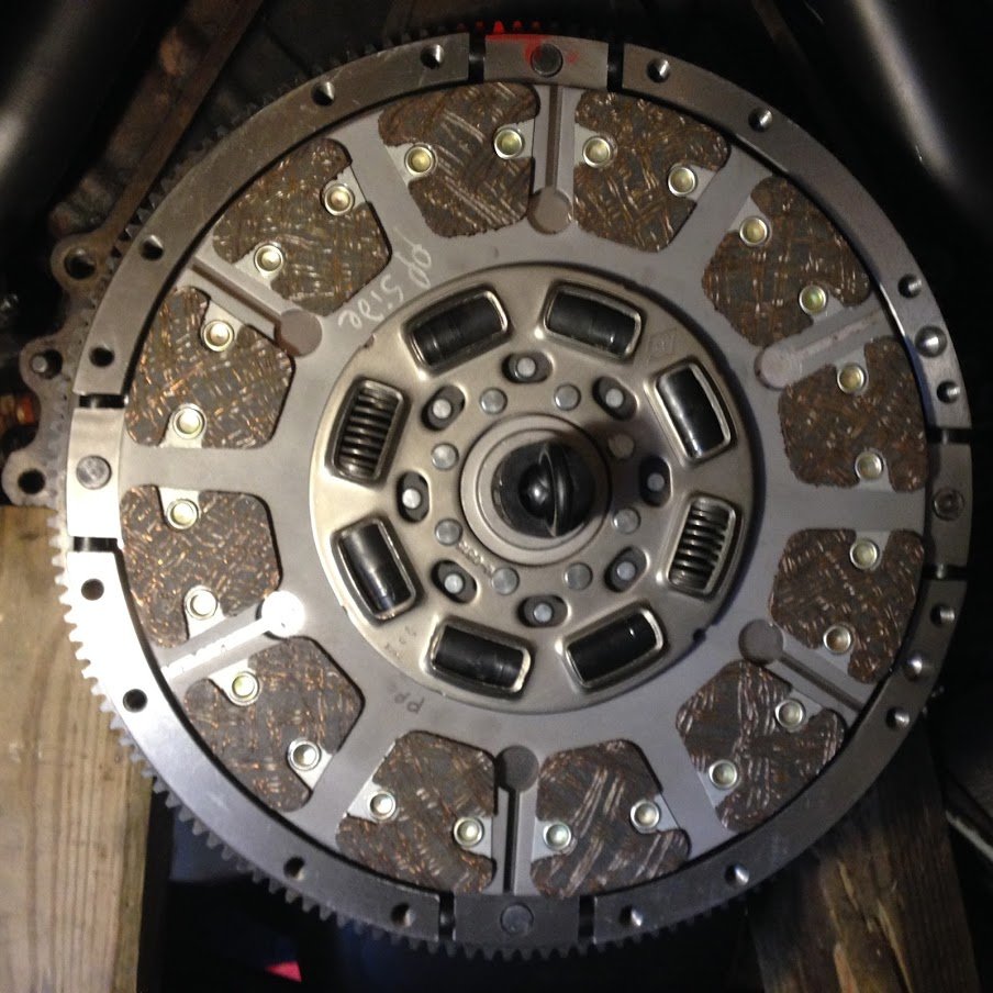

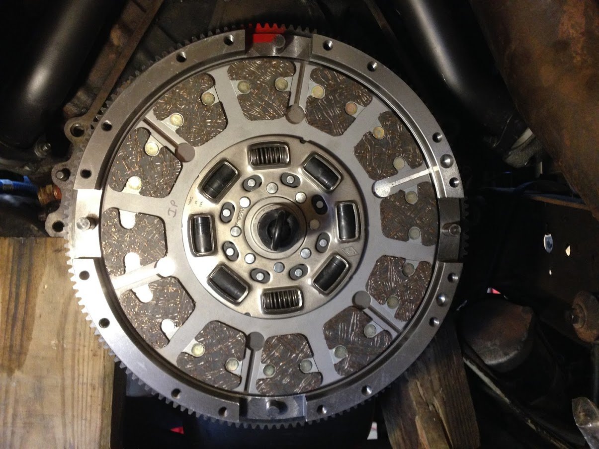

    First clutch disc installed
    SCh7O23DA_e4ifq-huEZmyVZpiBTTjgGgT6GX4Qp_5a8496414410194411bf59de798791801d1d9c1c.jpg
    Intermediate plate
    GtzXICY0Gq0cr5fYD4pwwvi3SVqnoOSAnPbF3jwX_230130cfb8ecd8c36be88d5b045d96ace94b7729.jpg
    Outer clutch disc installed
    _SOaSz-bnTRXwcgjamUQlBDVWxRn-ULBgGftZ1U0_f9958ed1cceda0411abbcb692d3946482e91c992.jpg
    Pressure plate installed and torqued to spec
    wdBXajvbr4p6T_2sSr2-nl1j9nuDE2QT_Su6Xte4_a12c86fa62e54df0112a0bfc4ff14c54af61a071.jpg

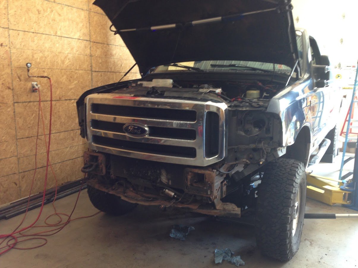

    Core support and front header panel and grill are back in
    NVzGyTzyurod_9eVocilvGRuUVYJuVqiA1T01vJE_bffa622378d9fe01c9381c3fe422fb8ce4030646.jpg

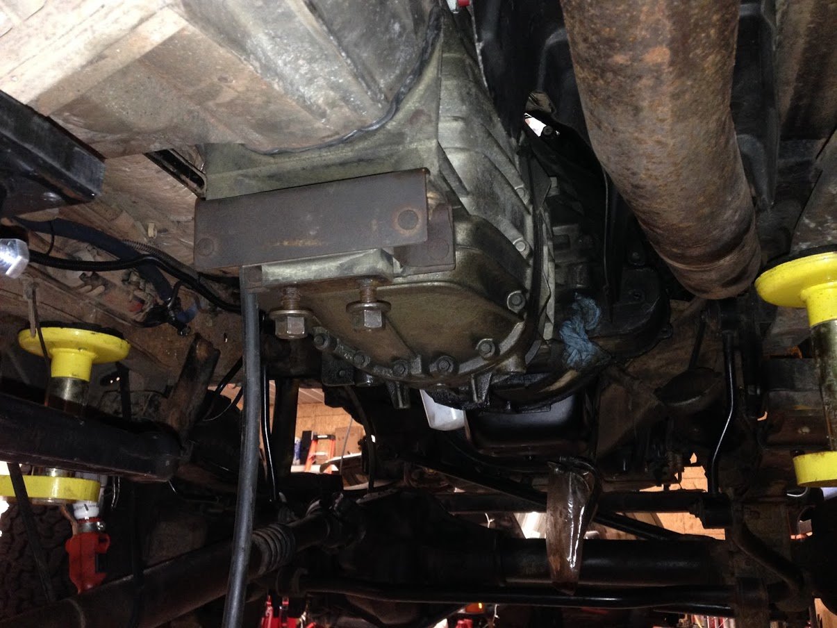

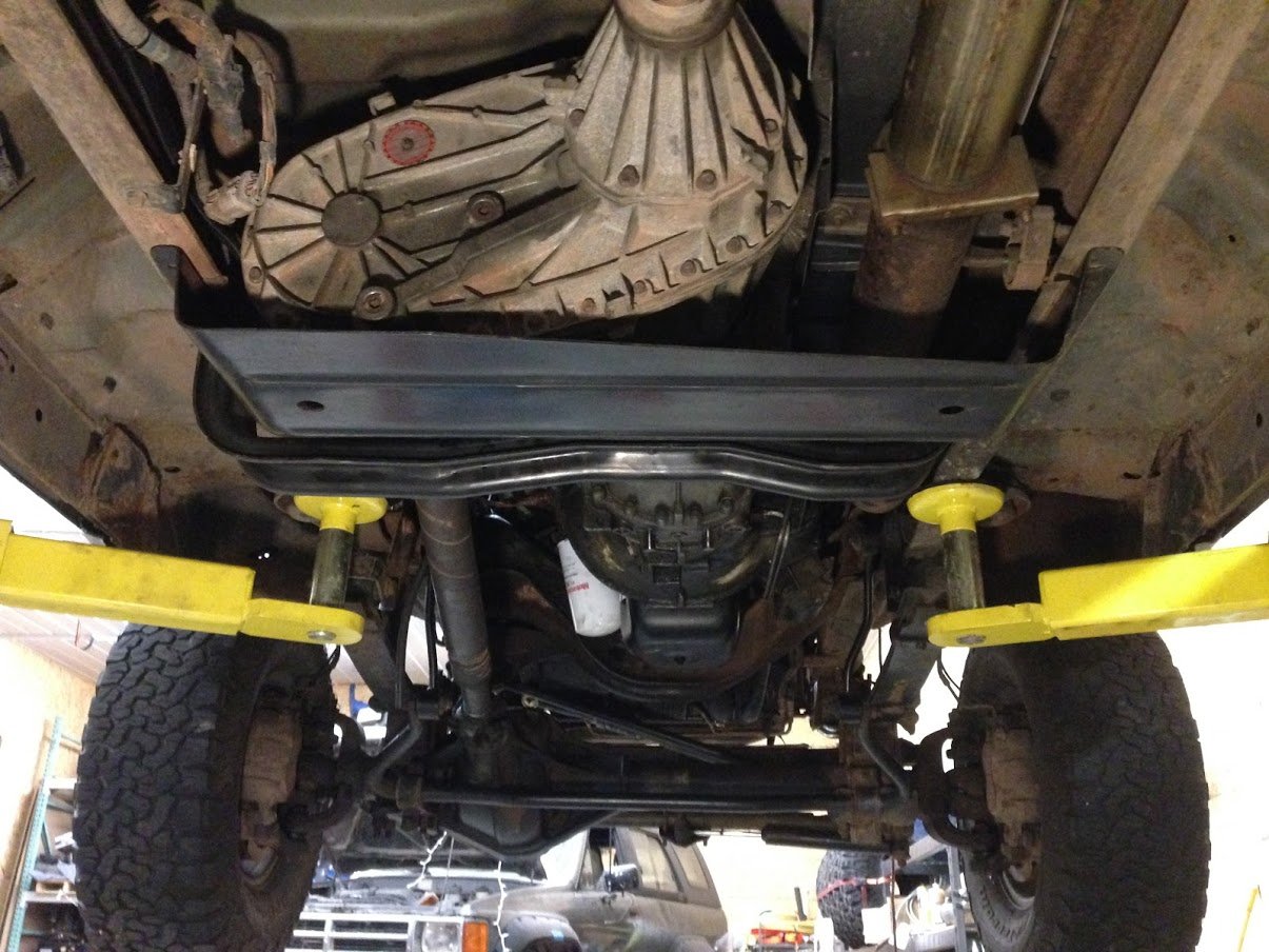

    Tranny stabbin
    TXvNszy5oV9Of_6vpuUhT_uYbTQLO1l-aThAkQUq_c76fed318dd6e387d0239a8b2620e020280b7239.jpg
    Crossmember and skidplate put back on
    bhJU2uZ1XdpkllEK3XfQPmkAI7_0tvmlu7wzV2gL_20c54967ea8603b2b3a99a53a8fa9196e138e191.jpg

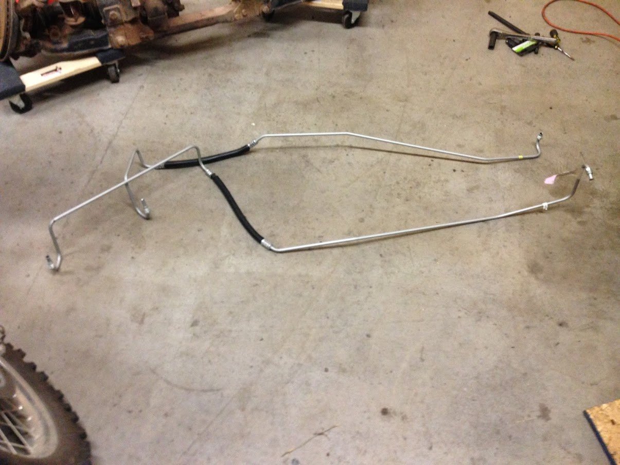

    New transmission cooler lines, fucked up a little and installed the old ones too close to the starter bolt due to missing a clip for them and they moved a bit on me :anonymous:
    Oops
    Dfldp27uBsqWhAfGas0R2mKZUlWDDXMy52pXp1GT_2119b23f79e8a312efc10b312024cf0c1e90f1a0.jpg
    New lines
    gtVU5F0UAbJkCziU6sGJdjsB3k932YAq-UqvDIrw_0c59fcb169d746faca608af7a9e9db0c61c070b2.jpg

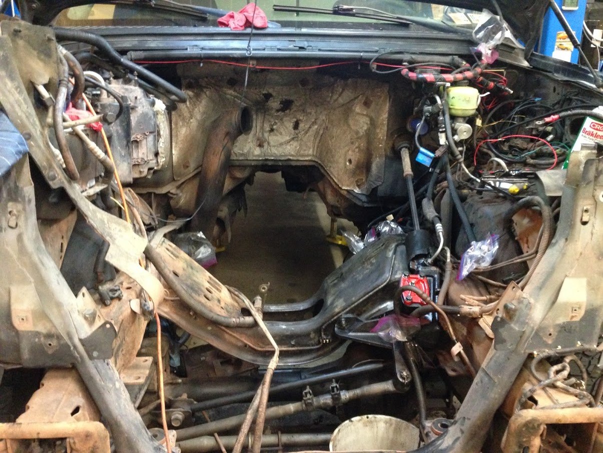

    Sleeved with some rubber tubing to prevent future contact

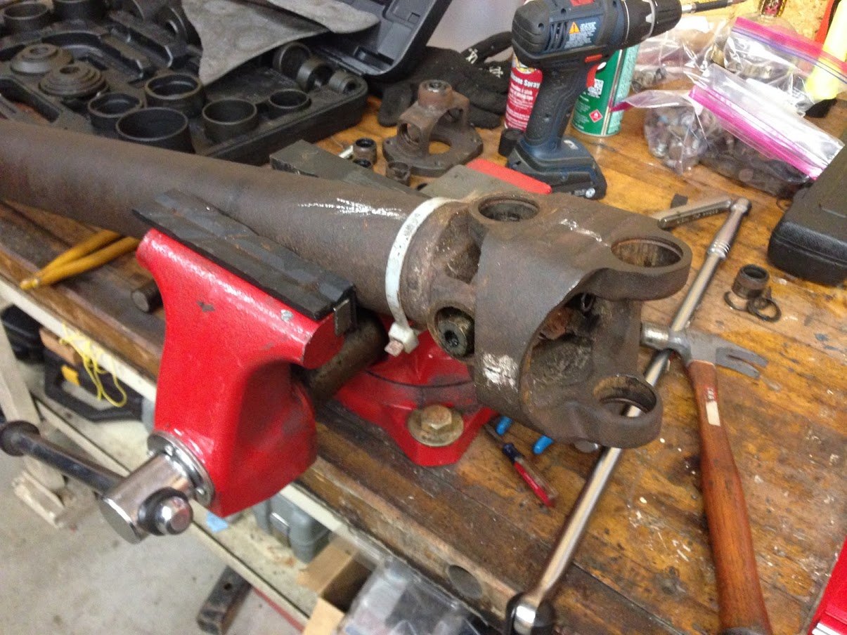

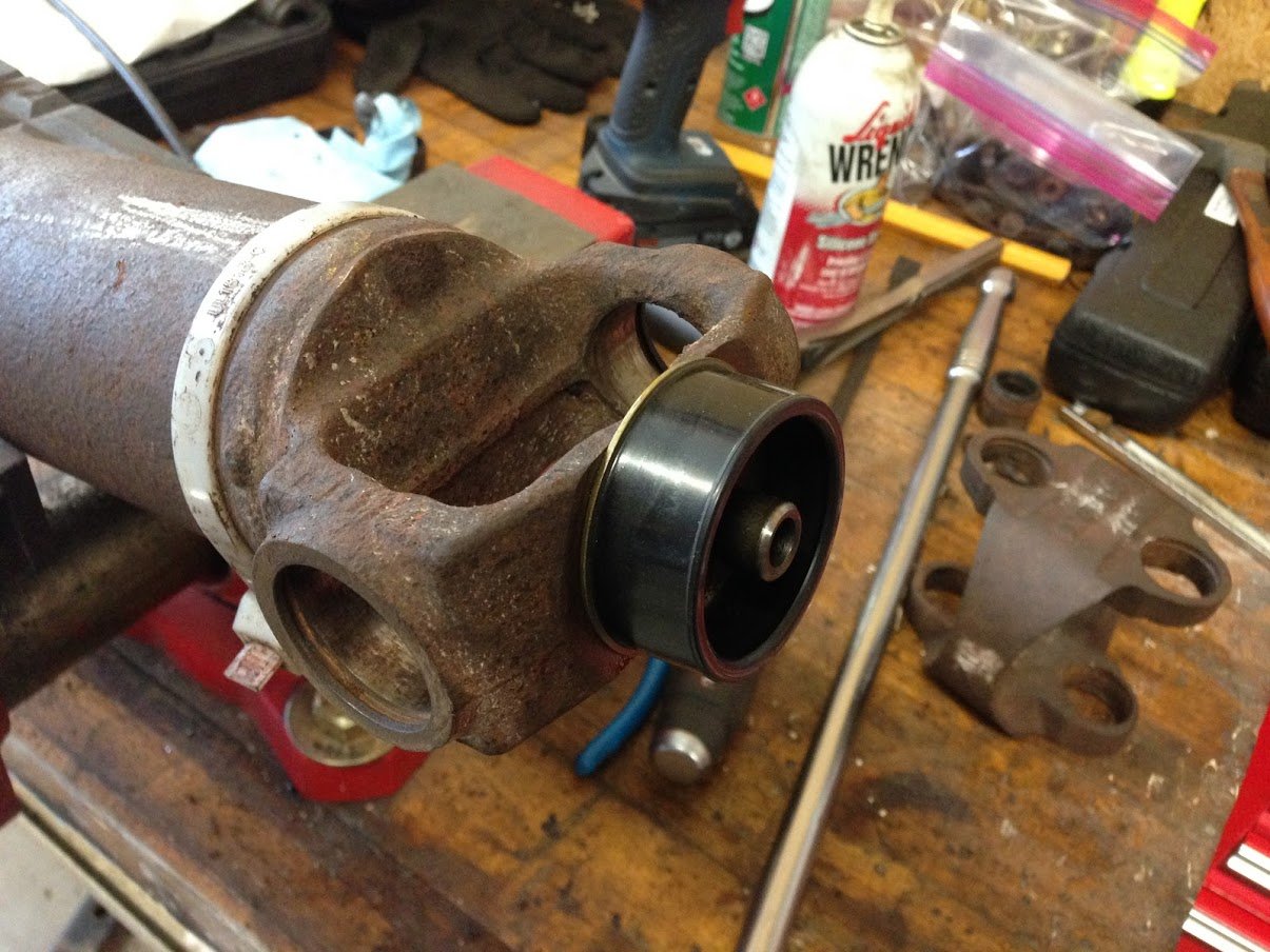

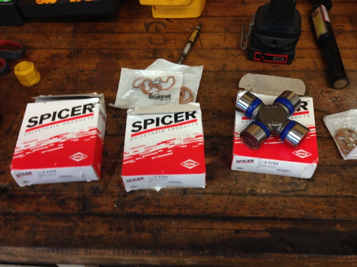

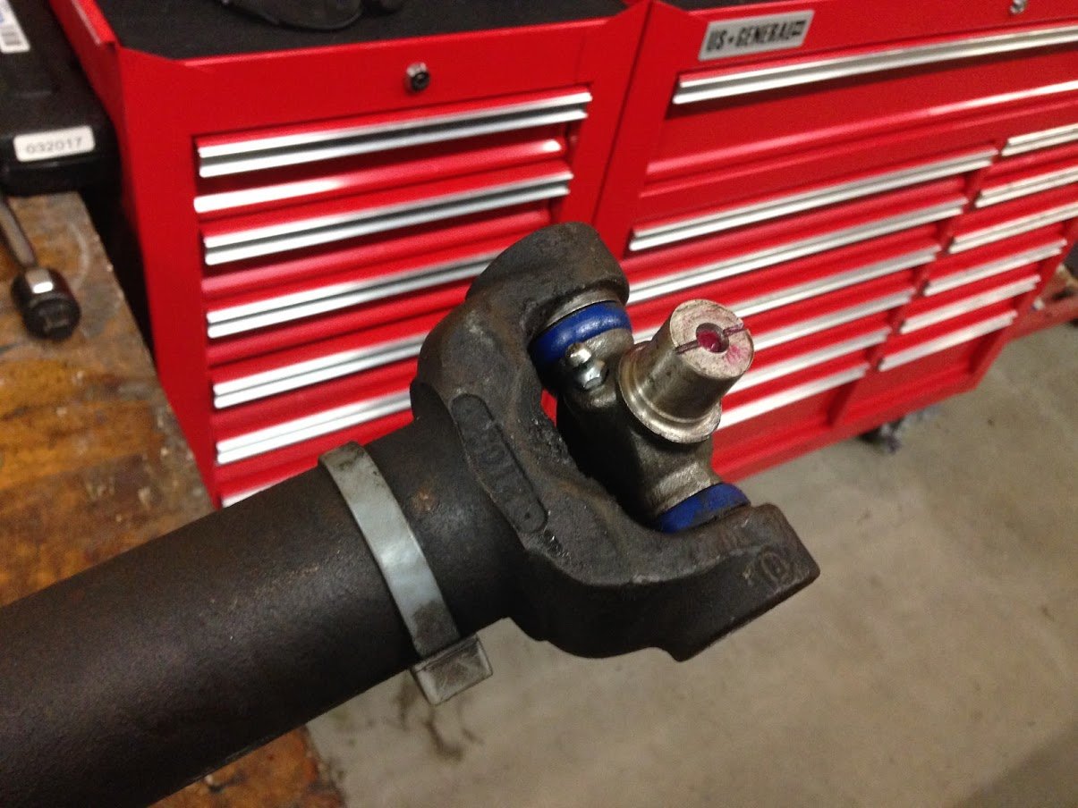

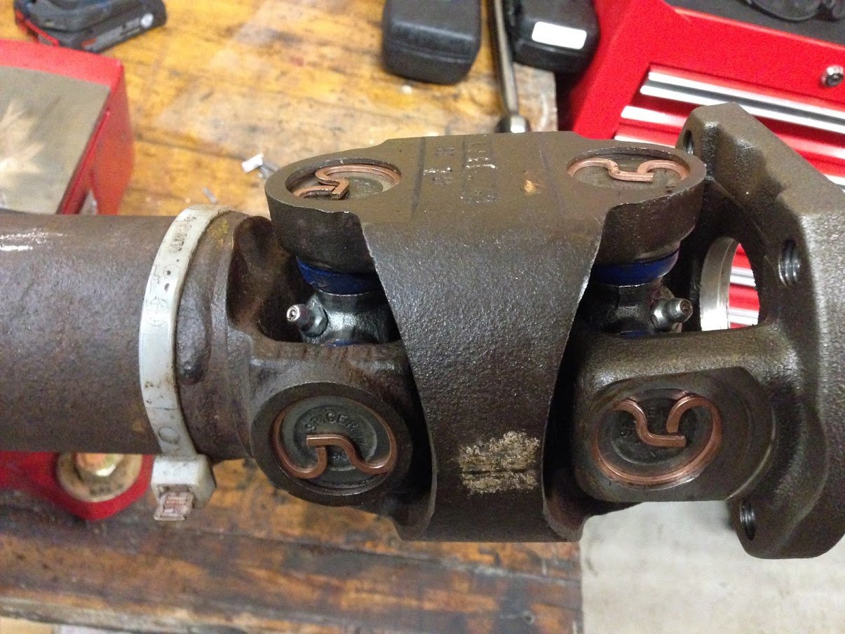

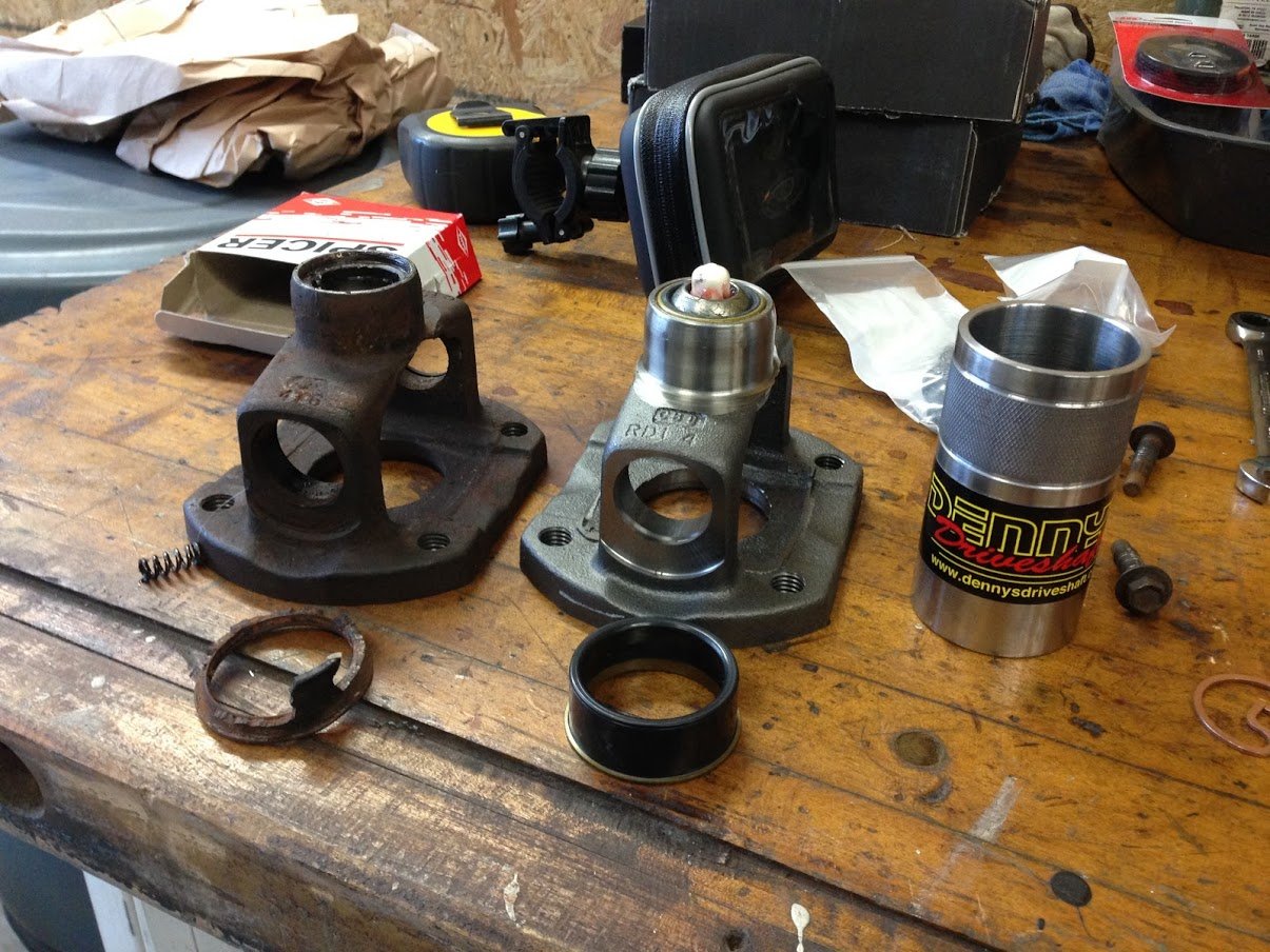

    Replaced all the u-joints on the front shaft
    -FCKEEeAHvAwSX9H8NMciZq_WuPB2Ms3HKvhyryc_cfa67ddcc5dbdc542b29477b10612c8993c3ab00.jpg
    Double cardan fun :rolleyes:
    c0UDCLMv_IibI6dBIqTLXZg4Kgfg-A7HhzDfz-6E_924df0abf27886306b9bcd39b4bc8aa984de6661.jpg

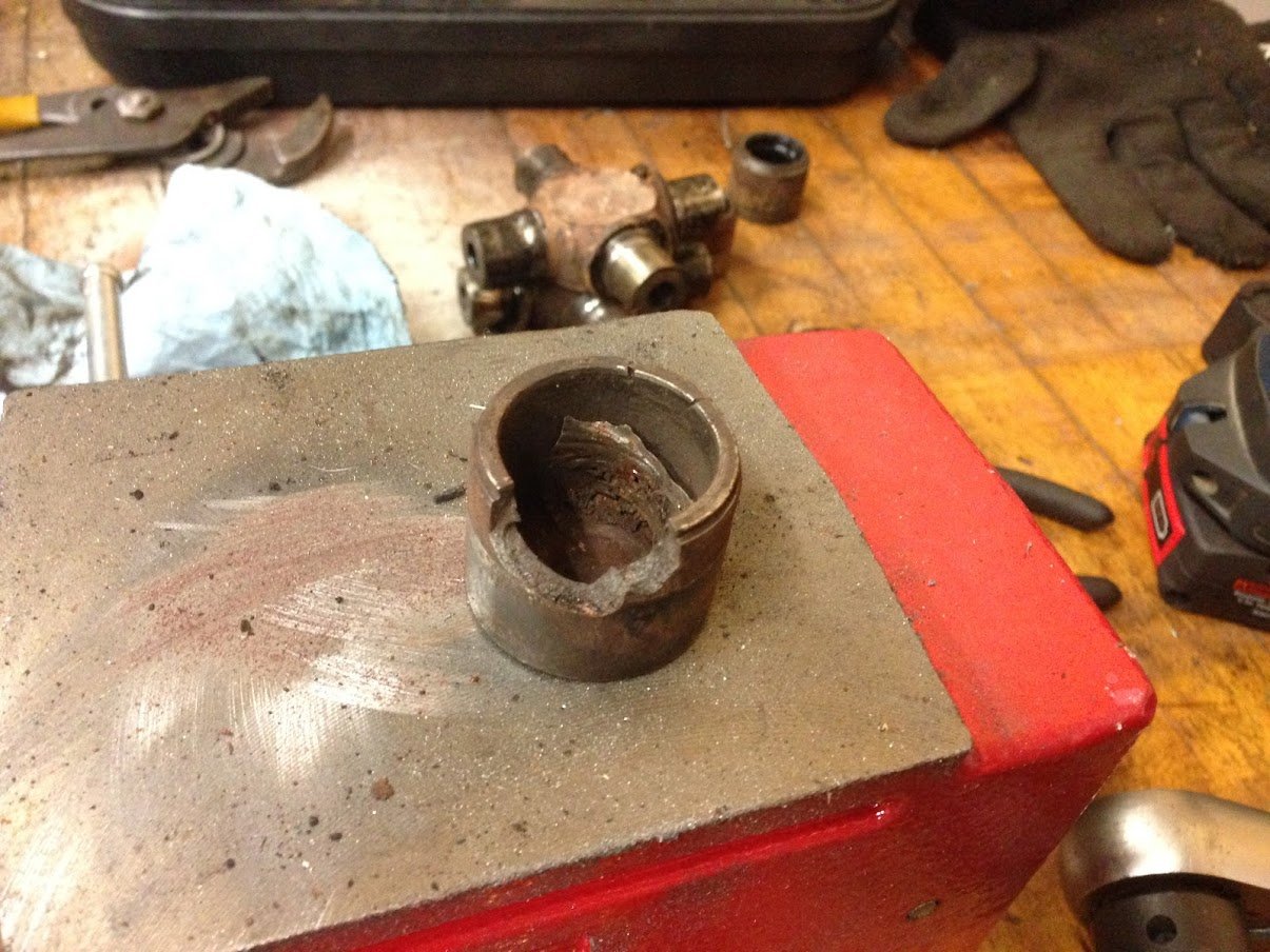

    HDh8aabzcXqrEYKXHFe1A0beVx3Gtf_vfwmIhXEE_3702430250b6991e775f734a45938fd1ef3e77fb.jpg

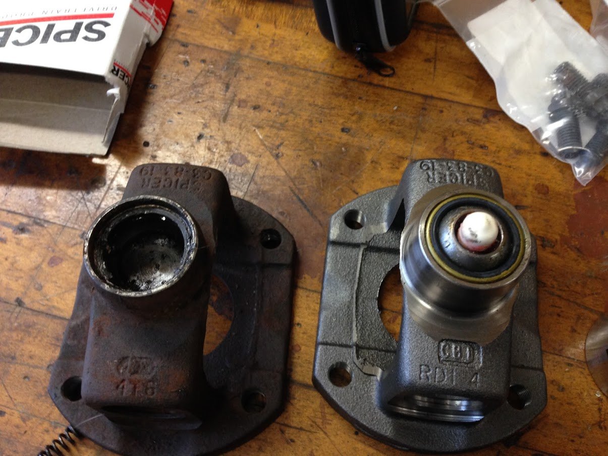

    Old cap that was busted, no needle bearings were left in that one o_O
    3xOH2mc7XFLt_-z7HznoXC0RmOMk2bZKo1nTGxiP_31343a06a0a9ed636a902a79726b8fa013781552.jpg

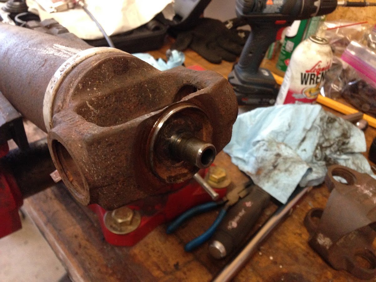

    Seal for the CV ball was also toast
    WeXClmGcEA-ECav9HRpXhW_IJgjm12ODkhAUZZTz_62a5508aaa37a1711f9403218d65dd81d7b14120.jpg
    The new goods, ordered a whole new flange with CV ball already pressed into the flange yoke and a new spring as well so I didn't have to fuck with it. Wasn't that much more than just ordering the CV ball rebuild kit to begin with so that's a win win
    rbWkEtFYYKeHxSZjXr5_YO2JZf0jGXHC4w3t3BlN_53551081253632509cbfb25b5011aa3629f4b5f2.jpg
    PNgU_6kiUhKKQjecWfTT3XB-bw9lBtmuM7u4DUPa_9154016748b0c8a11a70b89e3c6709b4b685f1e7.jpg
    Cleaned up the seal seating surface on the ball stud yoke
    4xSBTRAFsdf5AvoY-AOVApM_AsWYCyLjQrQcQlfV_057d9fca7b4f59c62ae5035d199e386575dcfd3a.jpg
    New seal pressed on
    vabHW8N4GwMADgDppB3zM8Mxbn7Ln4qVXrs3sQ66_28f3c6561e6dc4c4d1e7b1bb431c4771b1a3c1ca.jpg
    Double cardan u-joints all pressed back together. Easier said that done, need 3 hands and alot of curse words :rofl:
    VaqGNL3EN3j06tzRuEIDxzrrI5j-3kDxm2w_fniI_96a803839c75d83e215656c99bec1137adf929ad.jpg
    Differential end u-joint pressed in and ready to install in the truck with new caps and strap kit.
    ib3rTZue0Px7BwQ5E-XvRyaaygpdg_l4ERTr6_I8_f659f3daacbe6d7f0ea42bf61bb32e9411122318.jpg

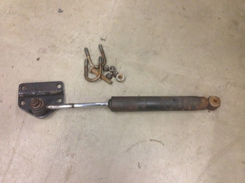

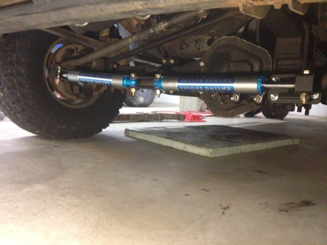

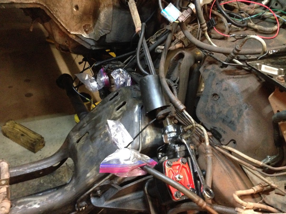

    While I was out in the shop tonight I finally decided to fix up the Ford steering for good, ditched the old stabilizer in favor for a dual mounted king bling :D
    The PMF kit seemed to be the best quality. The packaging and powder coating finish was also very good, and one of the only kits I've seen that mounted each stabilizer eye in a dual sheer design.
    Say goodbye to the stock 17 year old leaking stabilizer, don't think it was really doing much anyway :rofl:
    This should help dampen out any of the road bumps, the steering feedback seemed to have gotten a bit worse once I went to 35's so hopefully I can take it for a test drive and I'm sure there will be a noticeable difference :)
