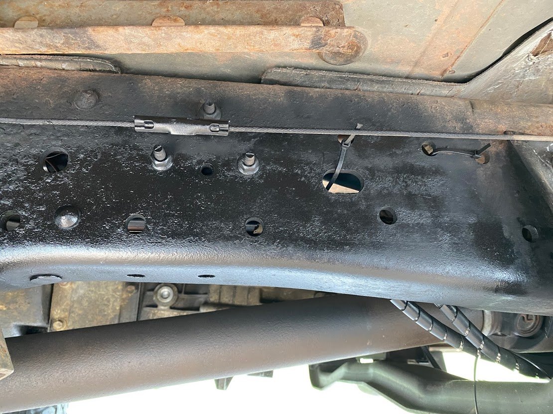

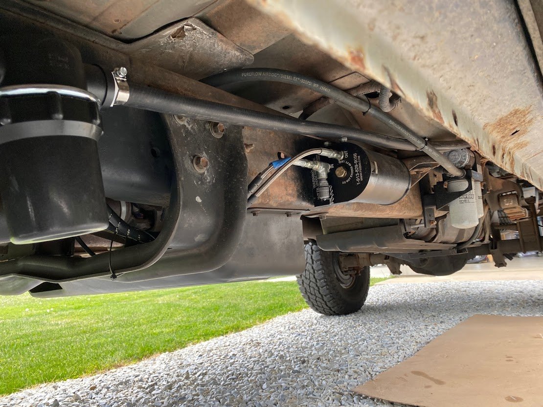

    Installed some split loom on the wire going to the fuel pressure sender. If you've never used one of these little tools I suggest you get one, they make installing a breeze. I think there are free files available you can print one yourself if you have a 3D printer

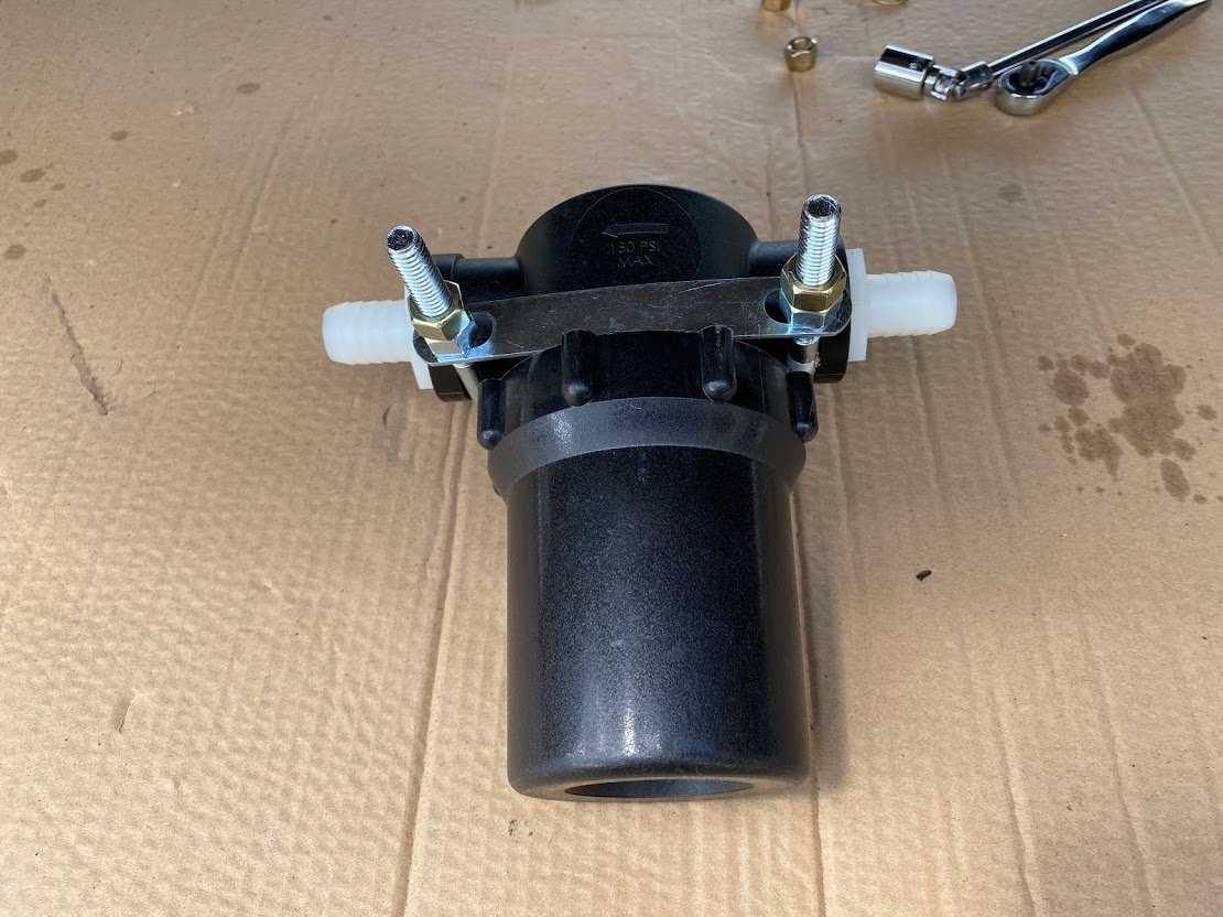

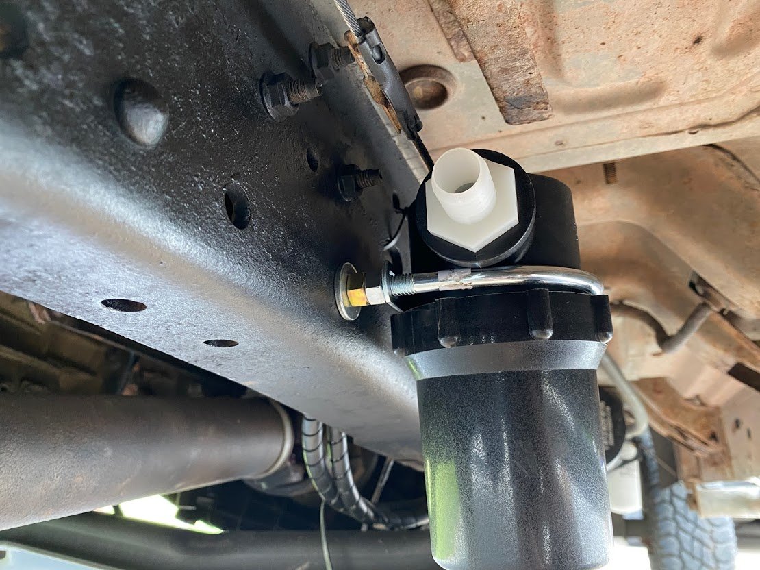

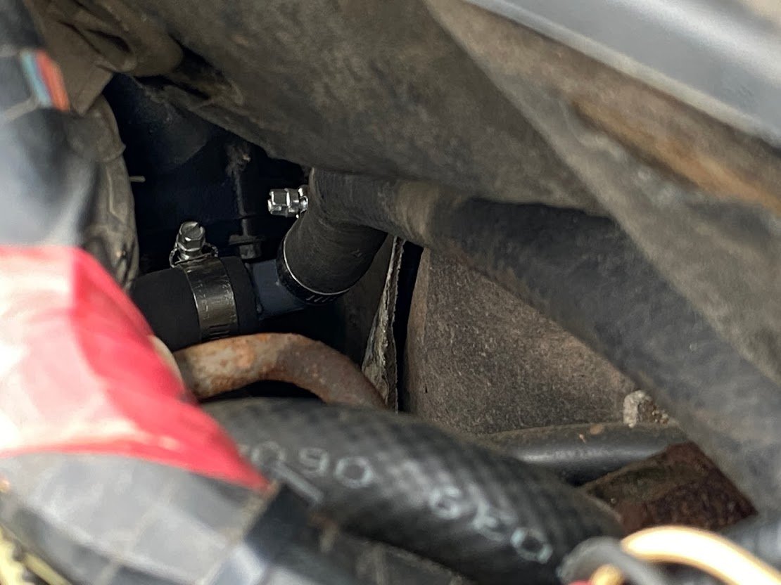

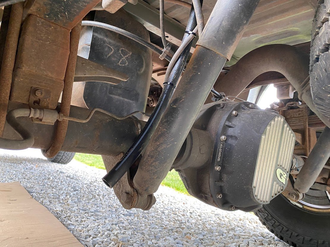

    I relocated my CCV to the back of the axle, was tired of smelling the fumes up by the cab. Ran it through a small filter used for sprayers that I found at TSC, seems to work pretty well. Used some existing holes on the frame that lined up exactly with the u-bolt. It's not 100% level but that's fine by me, no making brackets or drilling into the frame required. Put a "T" off the doghouse and routed above the brake booster, then down the drivers frame rail. Used about 18' of 3/4" heater hose and various fittings and reducers, my nose will be happy not smelling the crankcase fumes at stop lights now :)

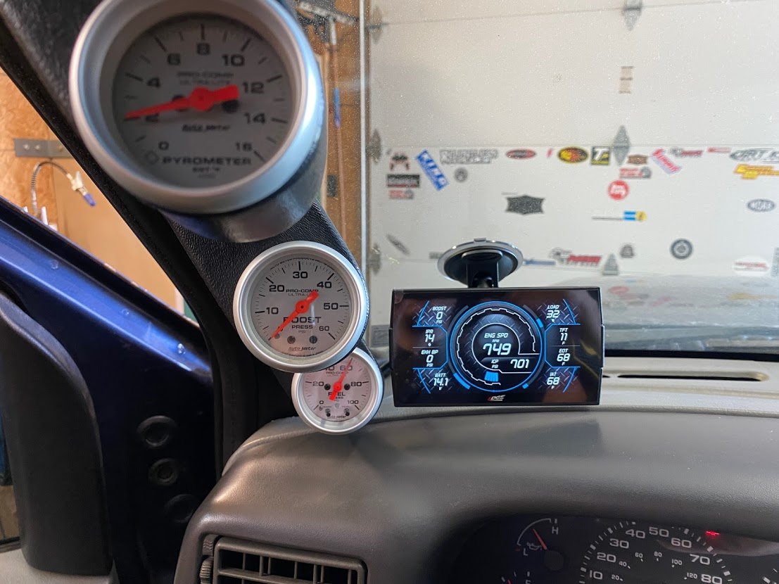

    I got the Edge hooked up and cable routed behind the dash today, I've been mucking with the different pages and options to see what I'm going to want to leave up to be most useful to me. I like being able to monitor the IPR duty cycle and ICP pressure, in case there is issue with it, and having EOT and ECT rather than just the dummy needle on the dash.

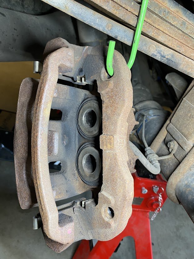

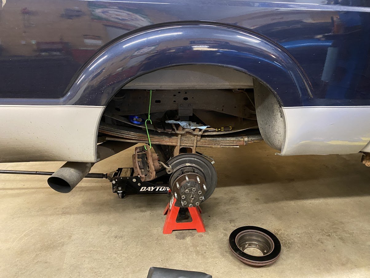

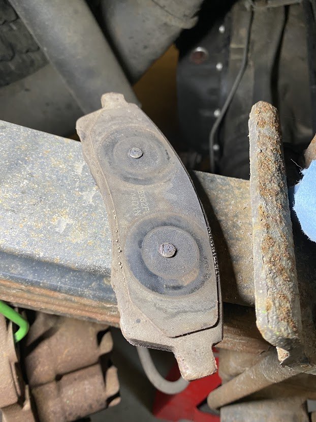

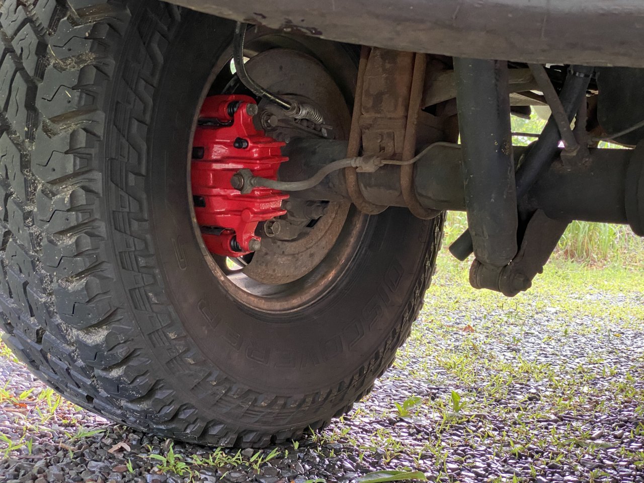

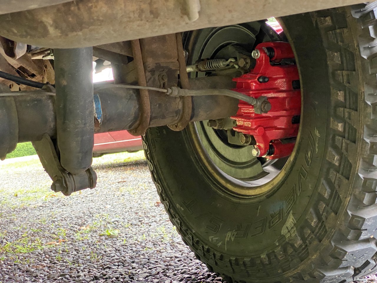

    Went to pick up a load of firewood yesterday and the right rear wheel starting smoking like crazy, limped home and found I have a seized caliper. Ordered a set of powerstop caliper/pad/rotor kit for the rear, should be in later this week. The rear 10.5 axle is known for having issues with calipers, so I guess consider me a statistic of that. Pads still had plenty of life left but figured I'd just replace all with new so I have a good baseline, as I'm not sure how old the originals were.

    At least the Ferd has rear disc brakes unlike some other truck I know. :rant:

    You’ll get good at changing calipers. I think I changed all 4 on my f250 twice in the 100k miles I had it

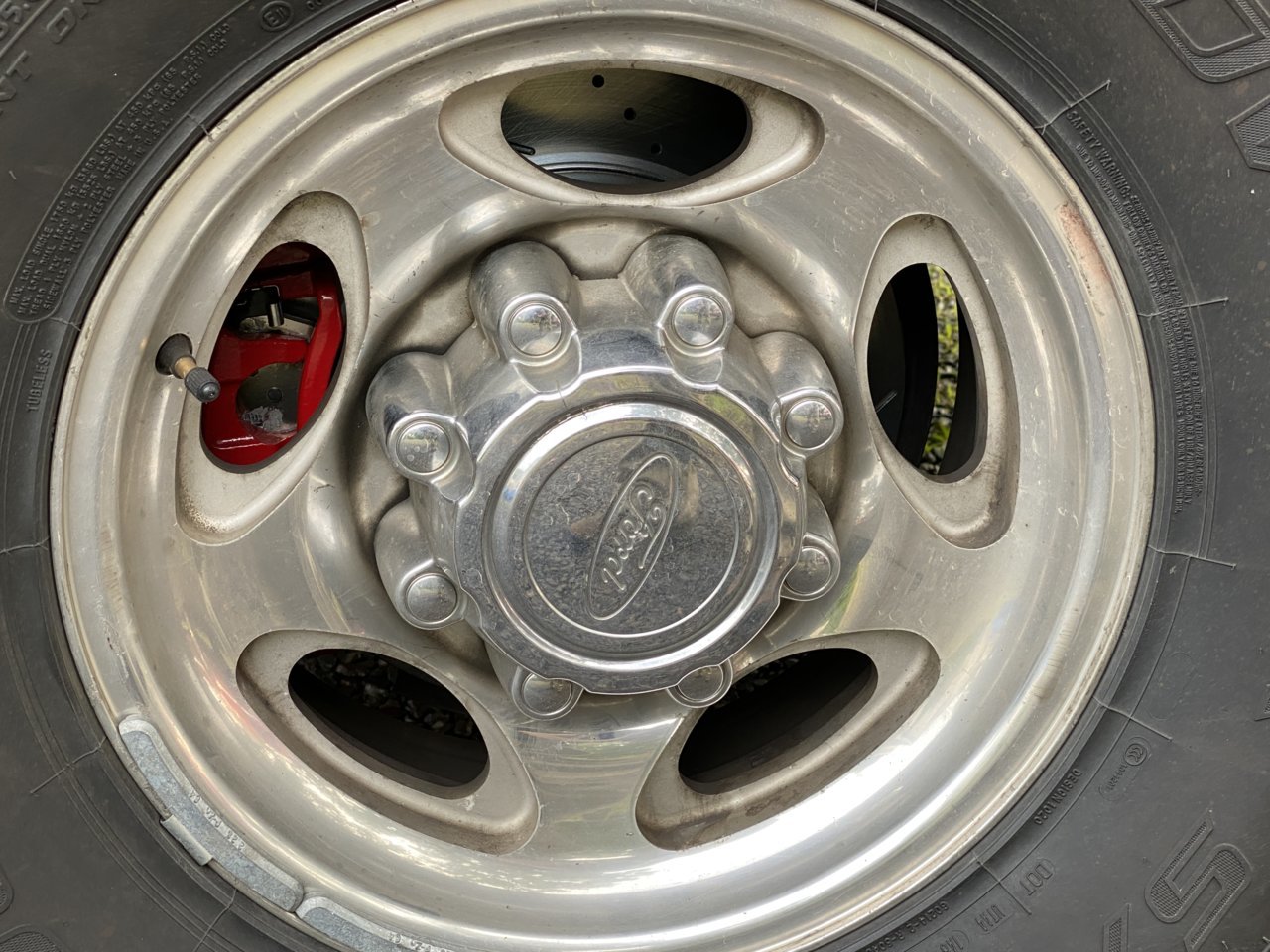

    Brakes are installed, back in business
    During install noticed that both slide pins on one of the new calipers were bent, some idiot must have dropped it at the factory. Ended up reusing my old slide pins on one side, not a huge deal and I’ll send rock auto an email maybe they’ll give me some money back, not hopeful that will happen though :rolleyes:

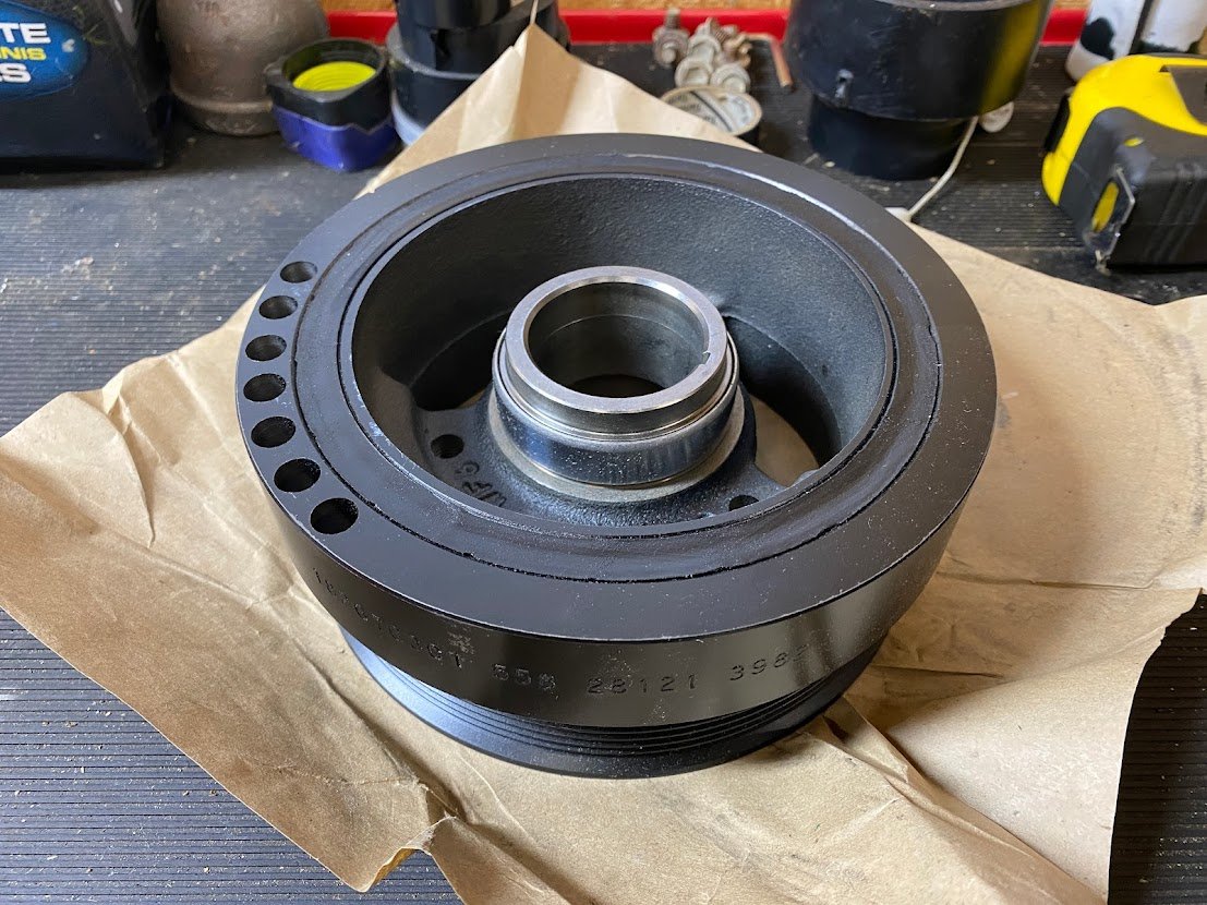

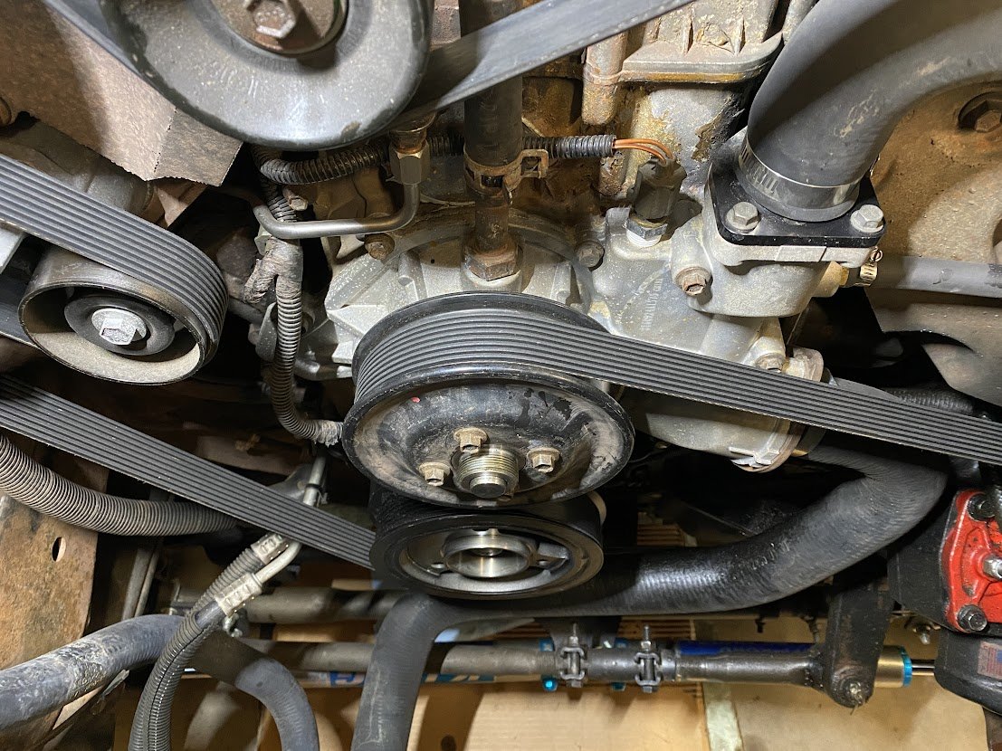

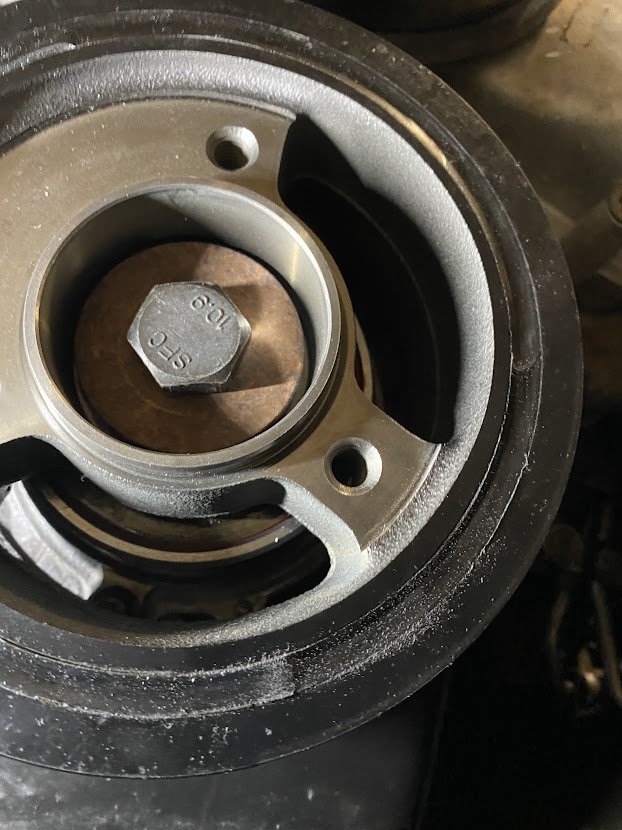

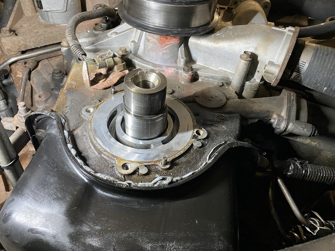

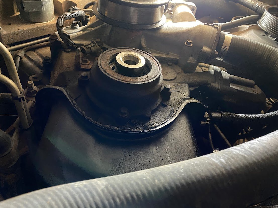

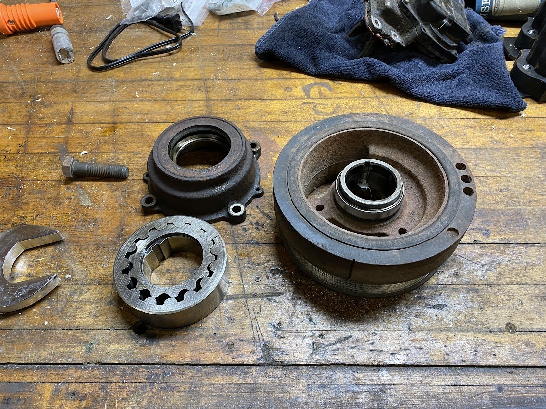

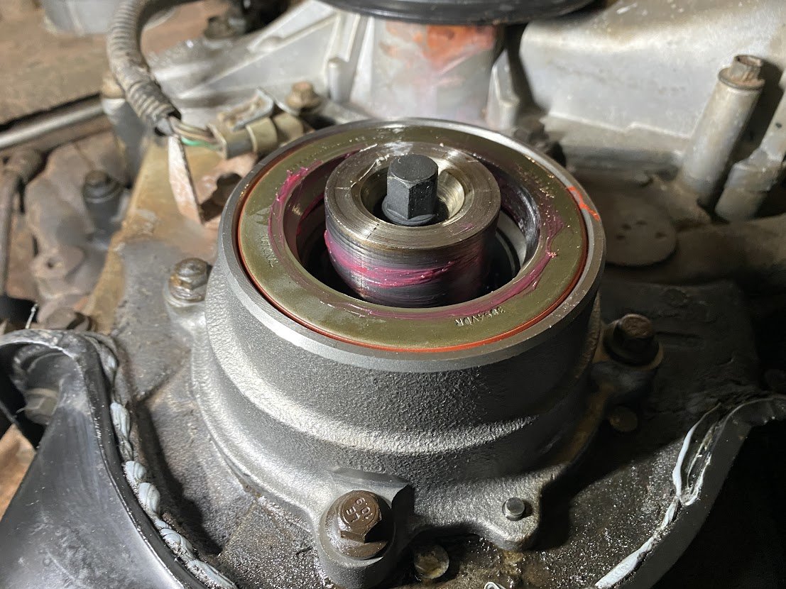

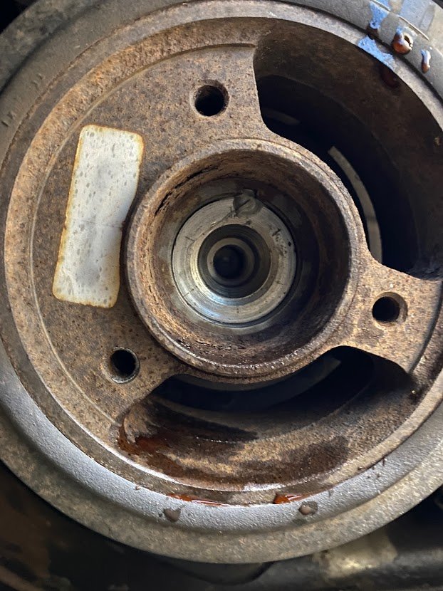

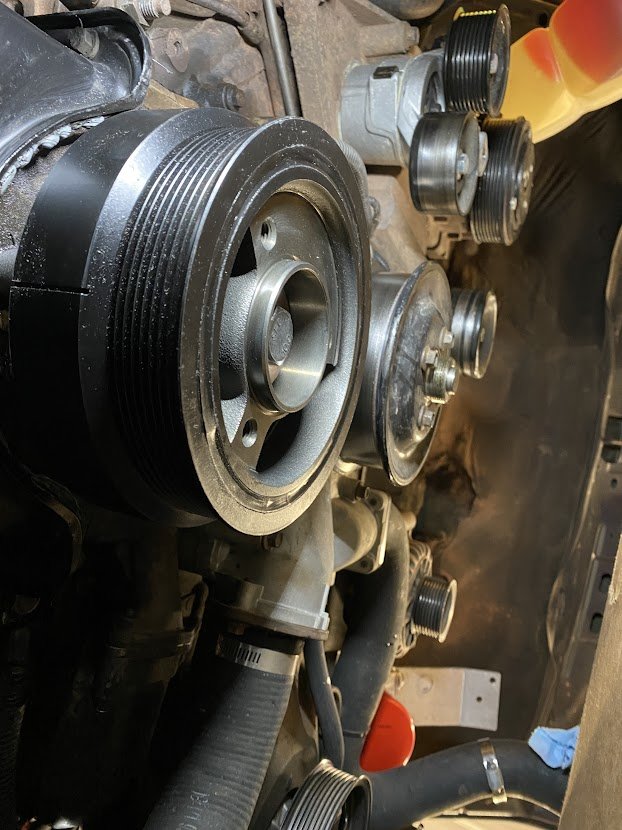

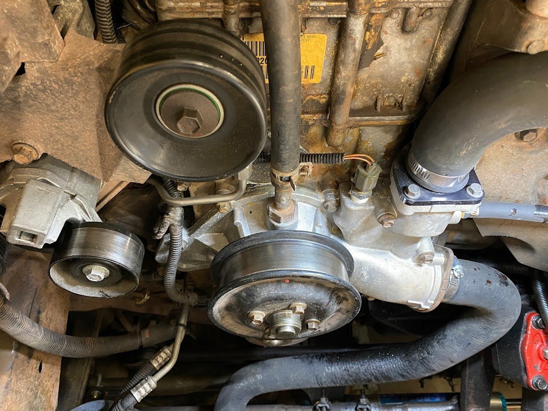

    Well I finally got around to changing the LPOP and front crank seal, everything fired back up ok I'll keep my fingers crossed no leaks.
    Crank bolt removed, keyway was RTV'd from the factory so luckily that didn't pop out when I pulled the HB.
    HB removed, old oil pump full of wonderful dirty diesel oil
    Old oil pump removed and sealing surface cleaned up

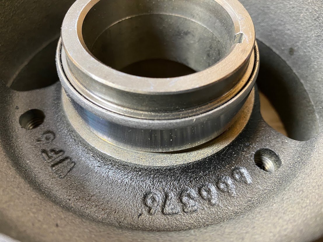

    While I was at it I just went ahead and put on a new HB, it also came with the wear ring pressed on which was an added bonus
    Old LPOP and HB

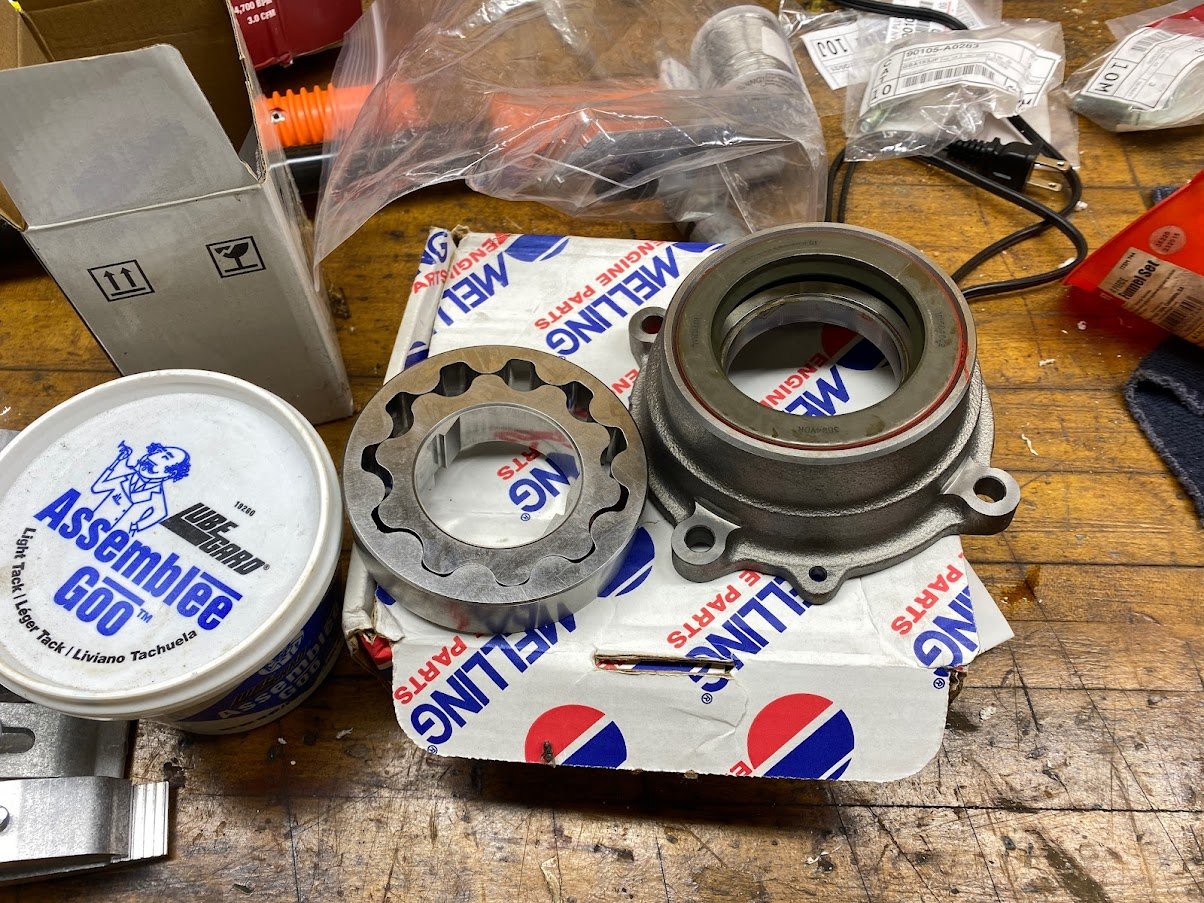

    New Melling M208 oil pump with seal that comes pressed in. Melling is supposedly higher flow than stock and is a 10 tooth pump vs. stock which is 14.
    New pump torqued down on the timing cover and seal lip greased
    New HB pressed on and torqued to 212 ft. lbs, that was fun. 6 speed makes easy work to keep the crankshaft locked :)
    A dab of RTV added to the back of the washer per the WSM
    Everything reassembled minus the fan and shroud

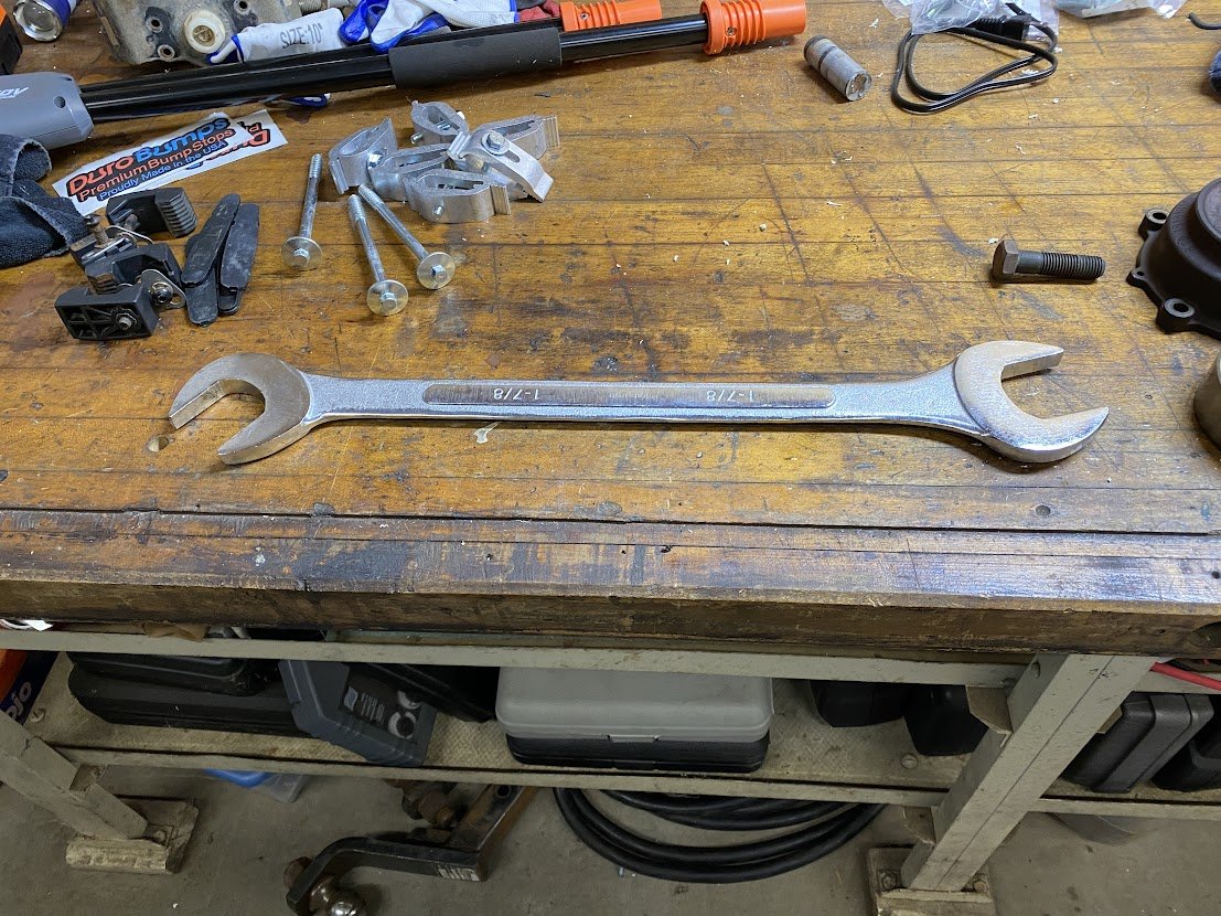

    The cheap ass fan clutch rental tool bent on me so I borrowed my buddies 1-7/8" wrench to tighten the fan on the water pump
    I also picked up a Tonneau cover from FB market place for half price of new, a Truxedo Lo Pro. I'm digging the extra dry storage and it rolls up easy and doesn't hinder any bed storage if I need to have the bed open.
    That's all for today, time to rest up and take a shower :D
