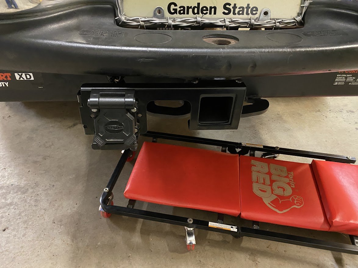

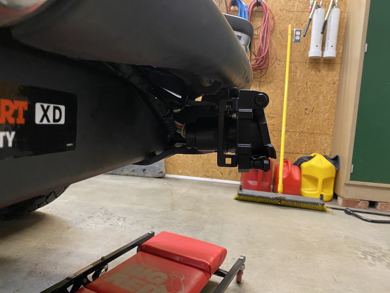

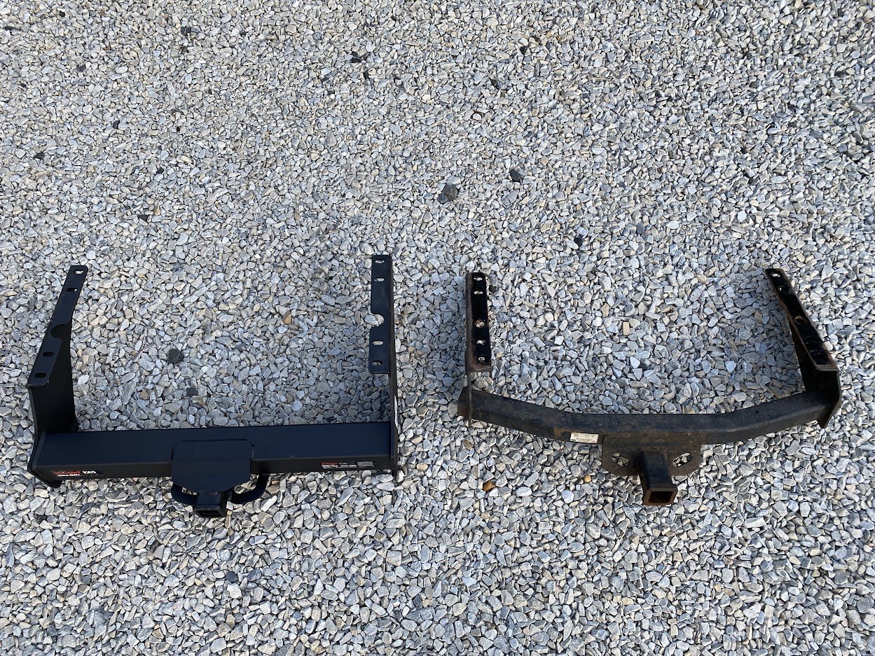

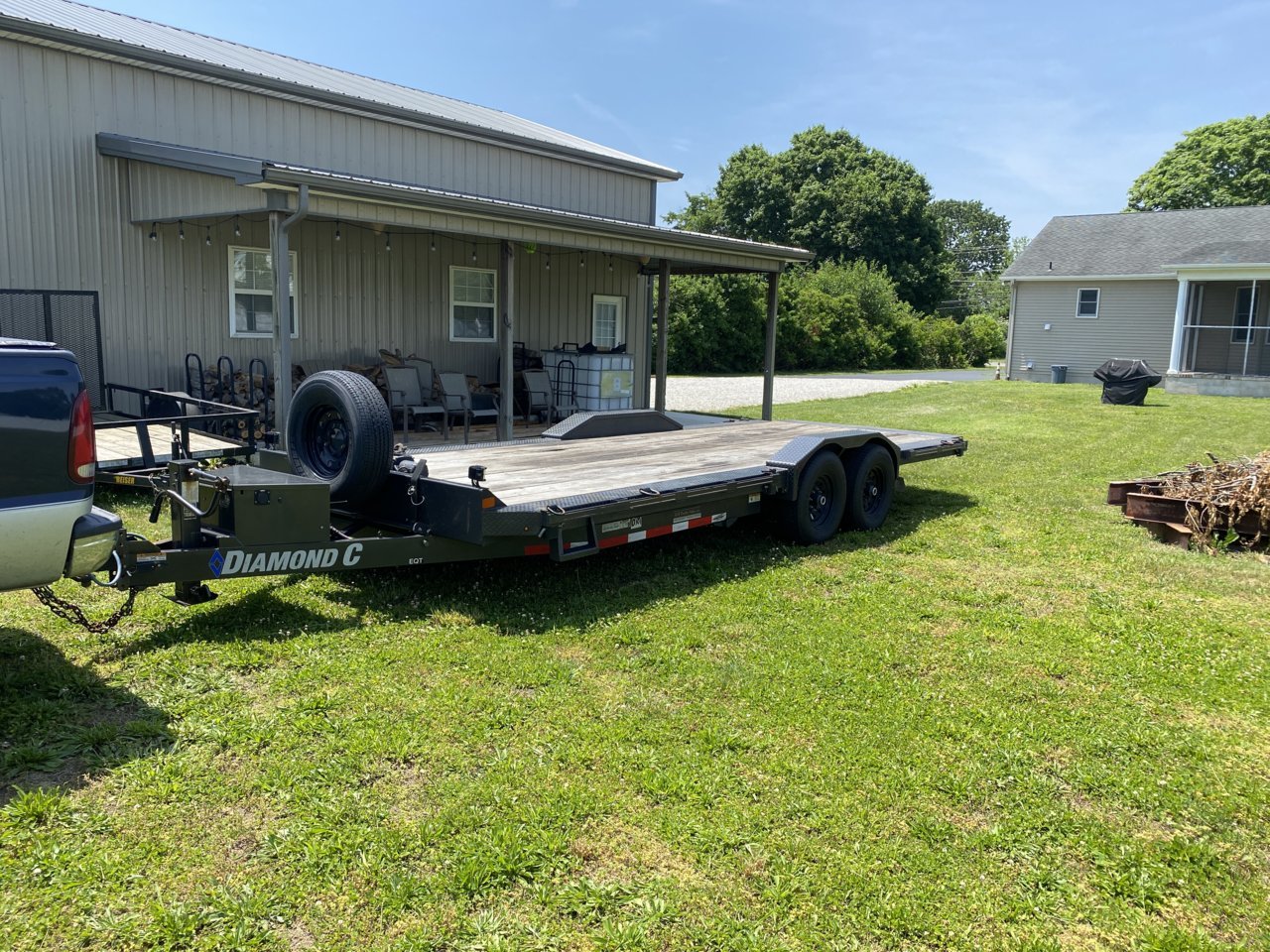

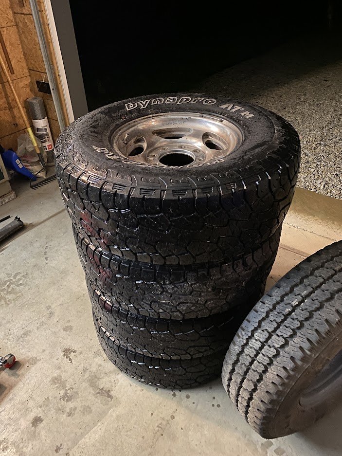

    Installed a Curt class V hitch in place of the stock, this bitch is rated for 17k lbs. Had to relocate the trailer harness as well. Picked up a spare set of wheels/tires from a CL ad for cheap because my spare is rusted to hell LOL.

    Here is the OEM vs the new

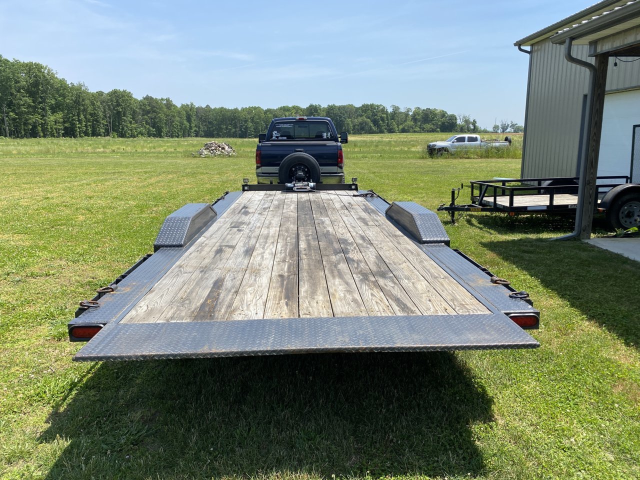

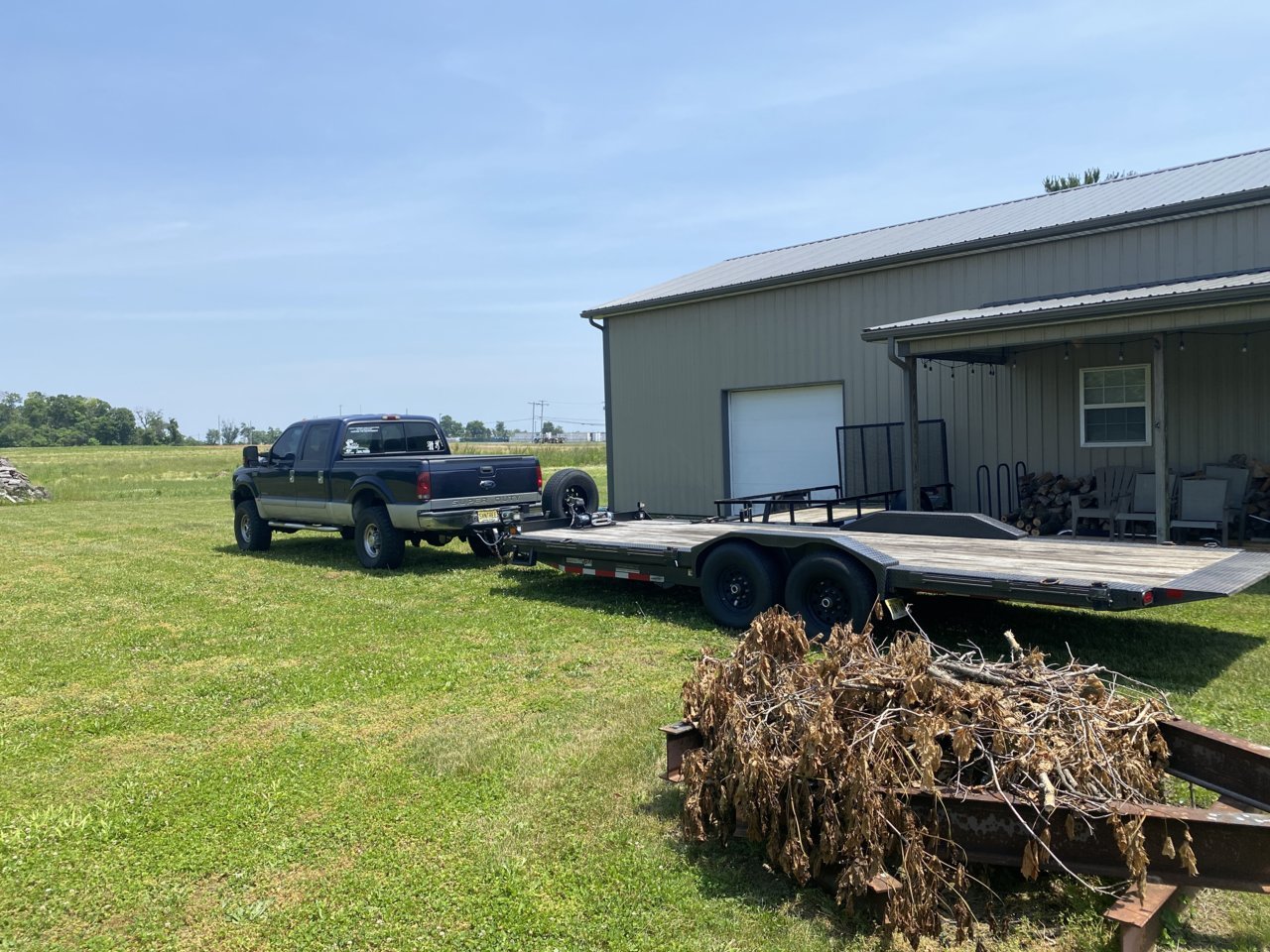

    What a nice looking Super Duty. Looking at the work list and then scrolling down to one of the side view pics of it towing the tandem trailer with the (Kubota?) loader on board, the first word that came to my mind was: "Sleeper". You'd never know that all those goodies were just below the surface, and it's an oil burner too.

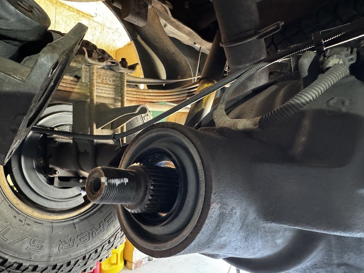

    Haven't updated this in a while but got a few new things done.

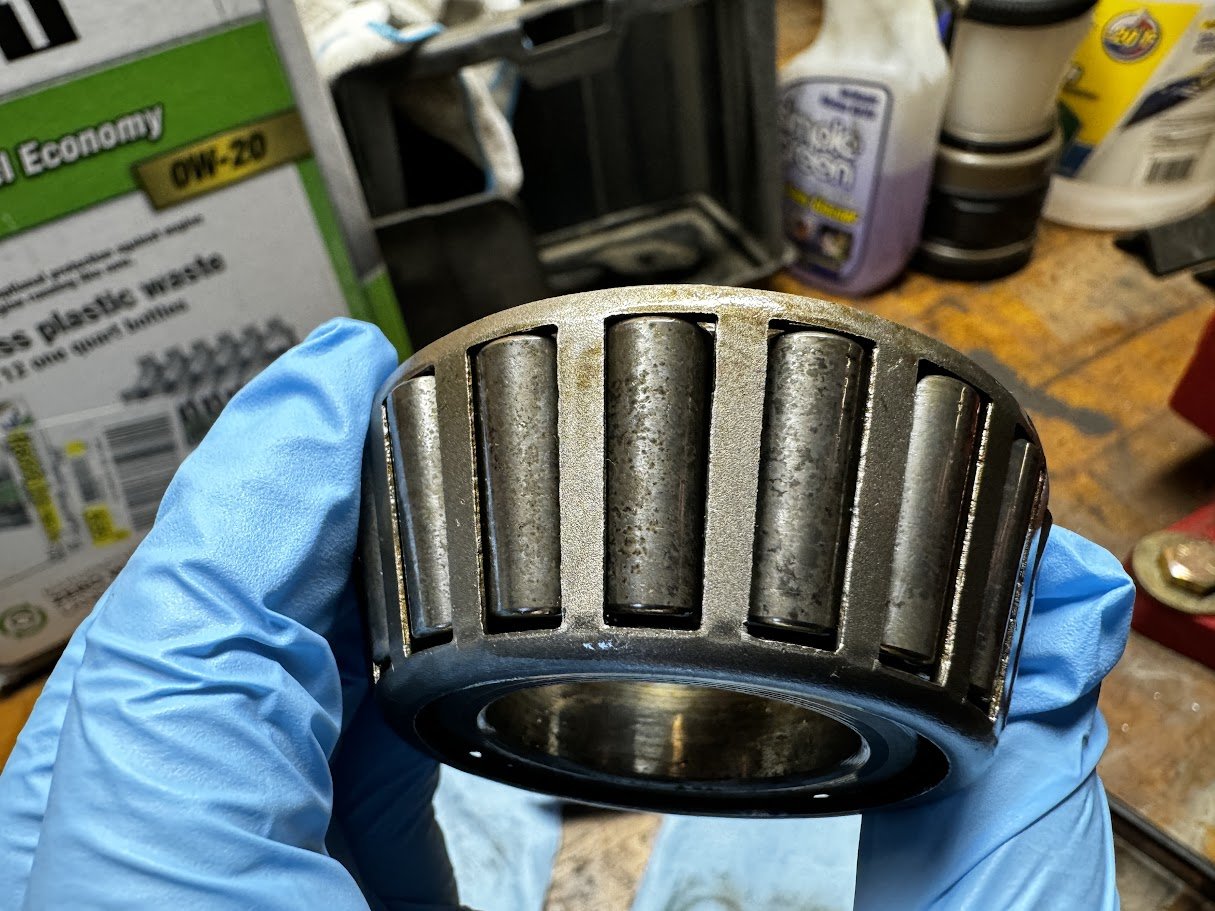

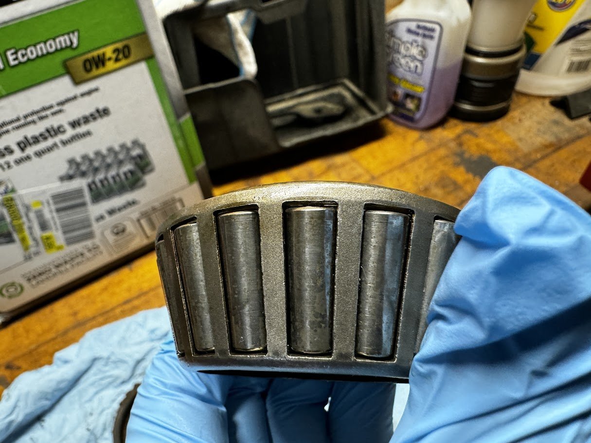

    Pinion seal was leaking so I pulled the flange, pinion nut seemed a bit loose so I replaced the seal and tightened the pinion nut an extra half turn. Hopefully that'll keep it going for a while before the rear diff might need a rebuild.
    pinion outboard bearing showed some minor signs of pitting
    Pinion flange had a small groove where the seal rides but not bad for 257k miles, I cleaned it up with some scotch bright and ran it!

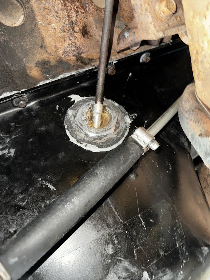

    Fixed the oil pan dipstick tube which started leaking again, the OEM o-ring design really does bring the suck. I tried this repair, and so far seems good.
    https://73dipstick.com/index.html

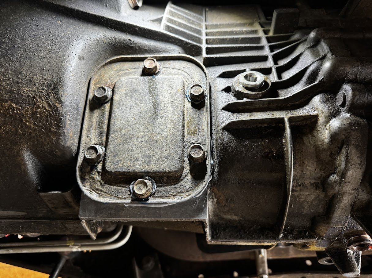

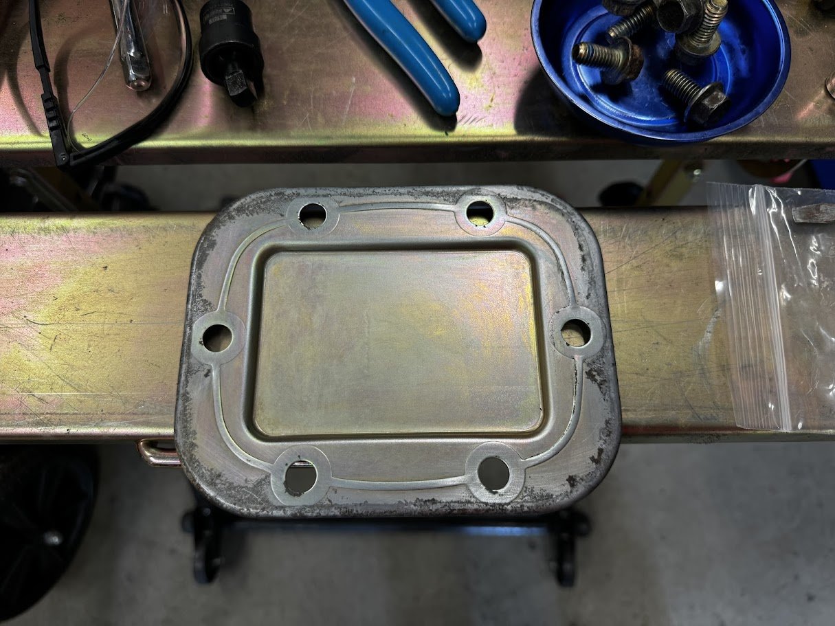

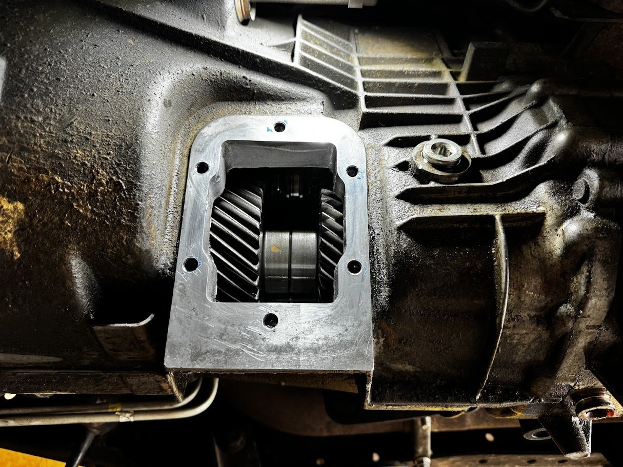

    PTO cover was leaking a little bit too so I drained the trans, removed and cleaned up the cover/trans sealing surface and re-sealed.

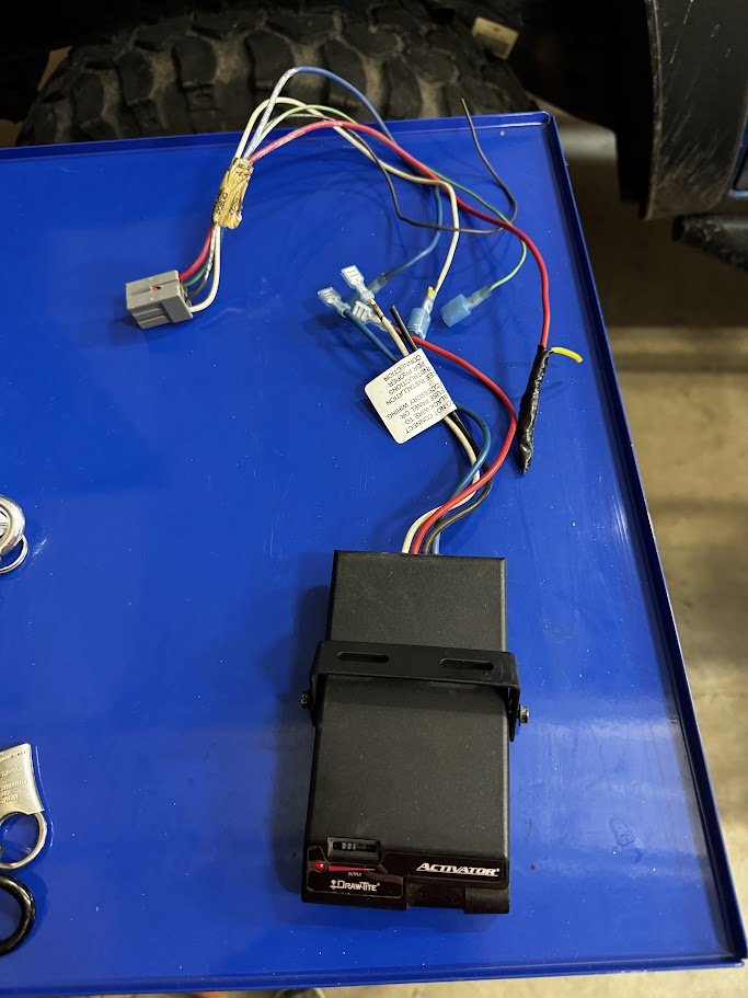

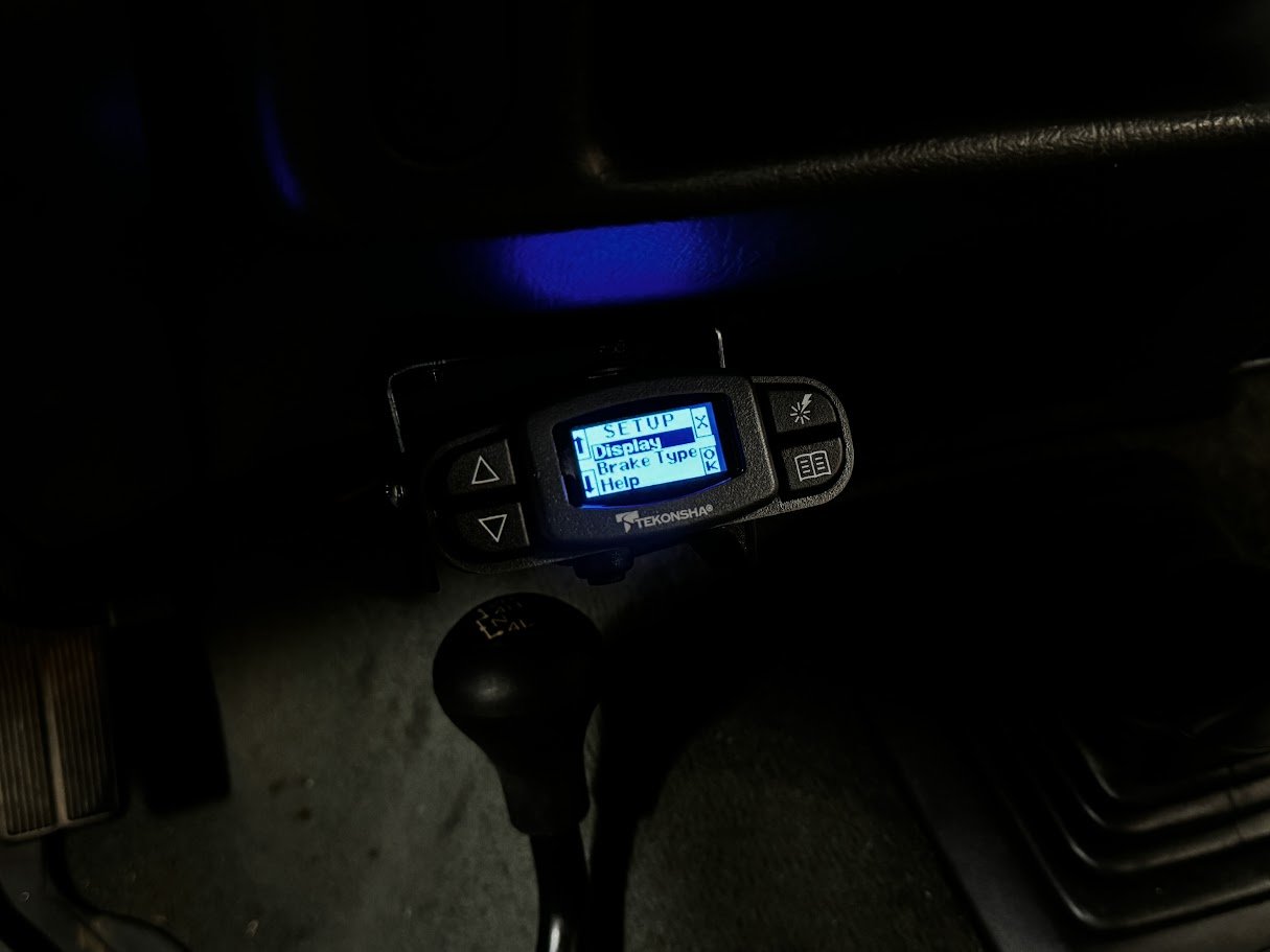

    Replaced the old brake controller with a Prodigy P3
    Old wiring the previous owner did was kind of janky, I used the tekonsha to ford adapter so there were no splices involved it's a nice connector from the oem brake controller harness.

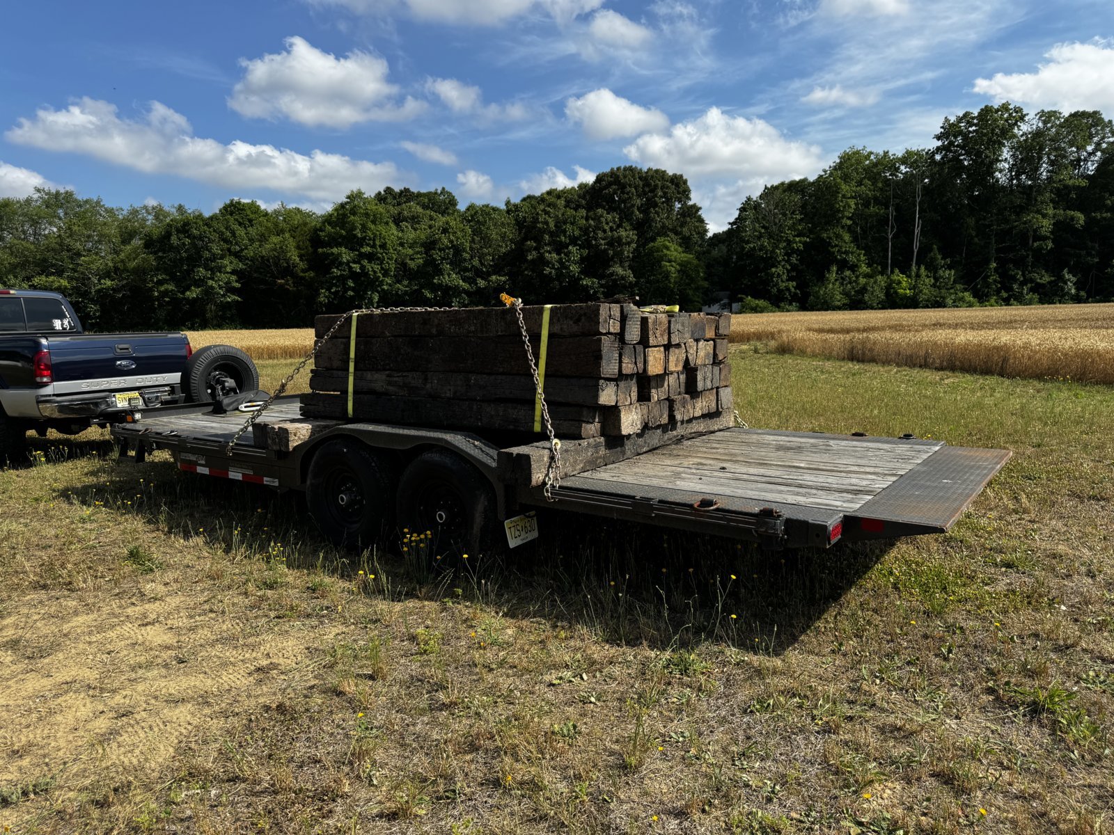

    5500 lbs of RR ties. that’ll do , that’ll do

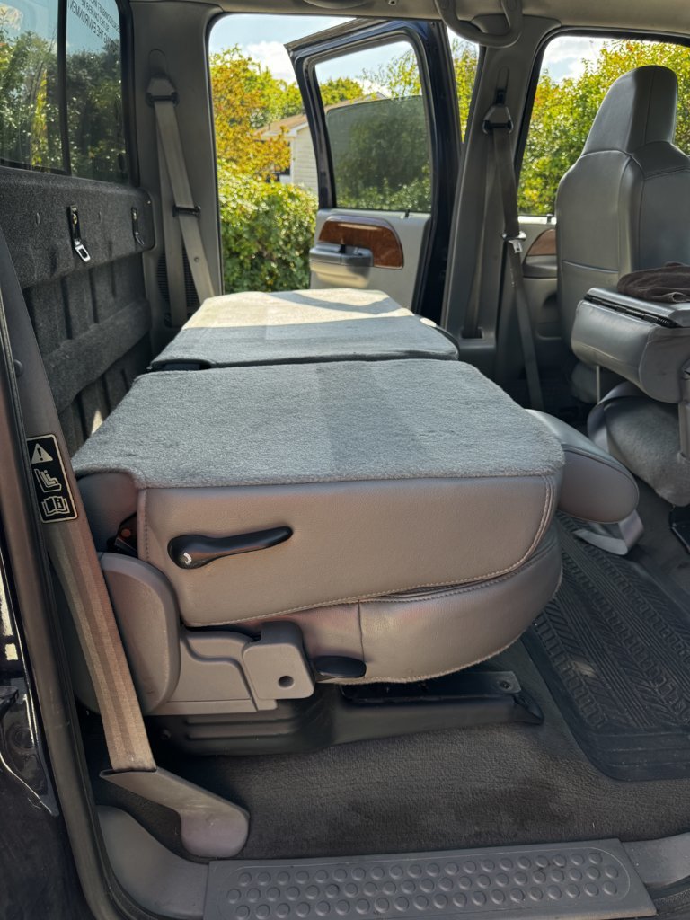

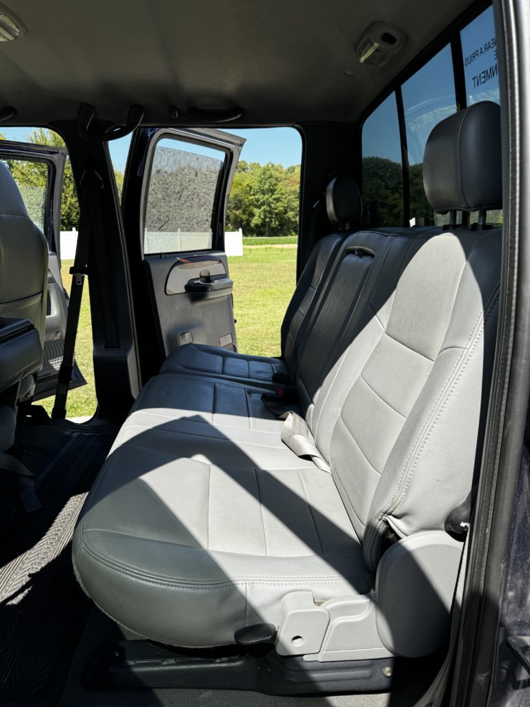

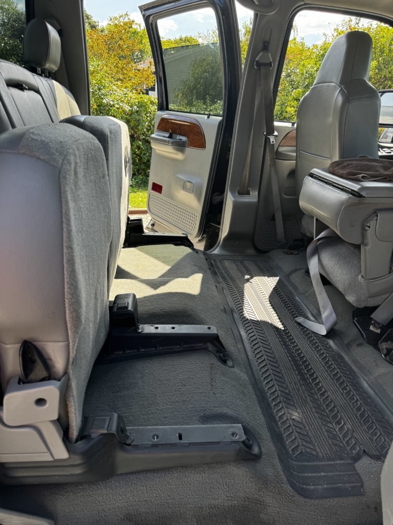

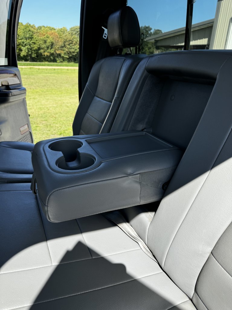

    Swapped out my bench seat with one from an 06 model, this one is split 60-40 and has seats that flip up and down to be completely flat, whereas the old one only did a partial degree flip down on the back portion. It's a nice upgrade. I also have a metal grate that installs and gives you a platform underneath. I had to hit that with a coat of paint and waiting for it to dry.

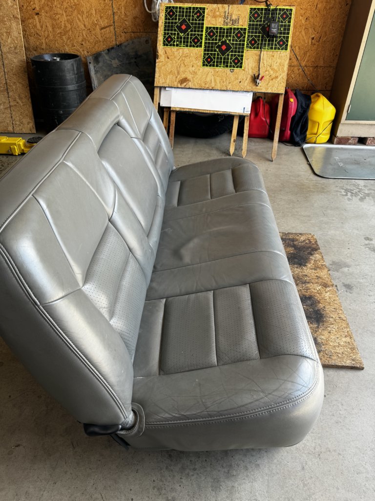

    Here is the old seat as reference
    The Hunter likes this.
