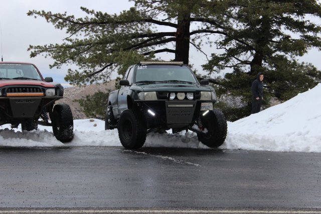

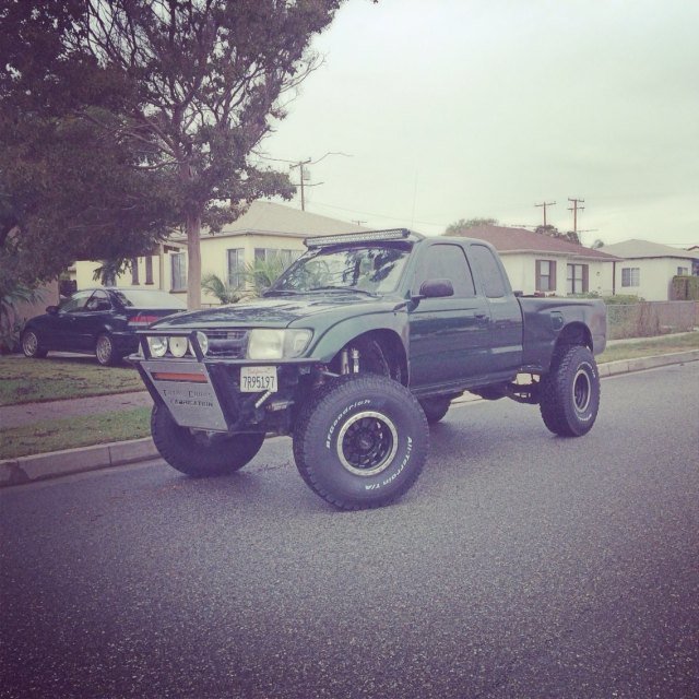

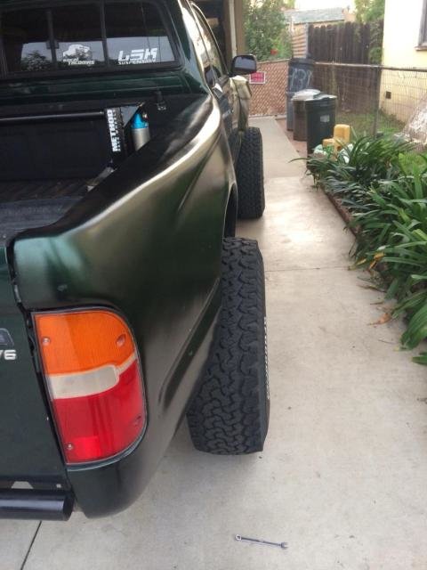

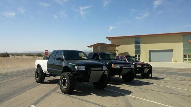

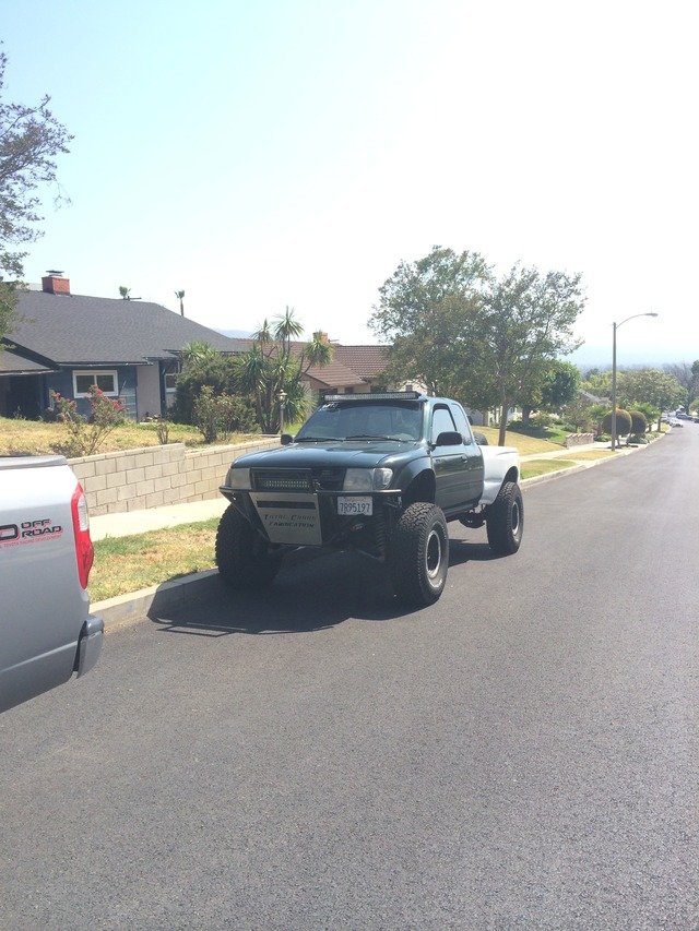

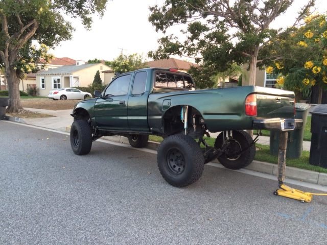

    Here it is..
    Current of Aug 2017
    10688015_754976091217464_615273040200385_0720b1602aebbb193a0ef9fb51abc0f48fb792ba.jpg
    10896423_769233149791758_822512637525800_a8957c11c2c3cfecc9084960942ed2bdfb726ebe.jpg
    10873473_769234239791649_955288866612785_918a2acf9e5426ffa223b7522dc302c07f9016bd.jpg
    All work is done by myself and help of LSK Suspension, I work there aswell.

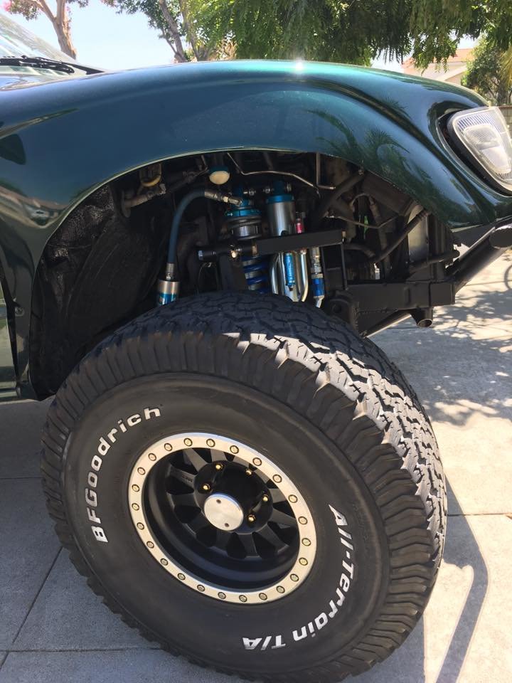

    Add ons....
    Front:
    Total Chaos 3.5" Long travel Kit
    Total Chaos Steering Bushings
    Heimed Steering
    Fully boxed stock Spindle
    SAW 2.5x8" Coilover
    Fox Triple Bypass 2.5x10"
    Custom Shock Hoop
    Daystar Poly Bumps
    LSK Bumper Front

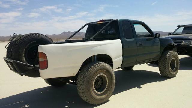

    Rear:
    50T Leaf Springs
    King 2.5x16" Triple Bypasses
    SAW 2.0x2" Bumps
    Total Chaos 12" Shackles
    Custom made Shock towers
    Rear Suspension cycles roughly 18" of travel
    Custom rear bumper
    Bed Liner
    Method Double Standard 15x8" Wheels
    BFG All terrains 35x12.5x15
    Toyota T100 third member geared 4.70
    Glassworks Fiberglass all around
    Beard Bucket Seats
    Modded Air intake with AFE Filter
    Spintech Muffler and Resonator
    42" Double Row Cree LED bar
    21" Cree Single Row bar
    Three Hella 500's Hid Modded

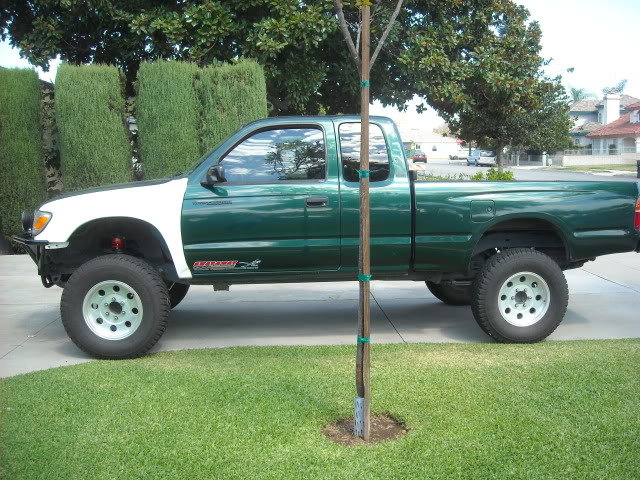

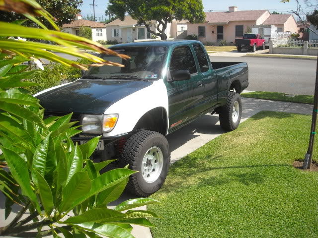

    Bought the truck in June of 2010 a couple weeks before i finished Highschool for
    $5000, with 174k Miles. Basically no mods what so ever , except Newer Trd Sport wheels which were on Bald Tires and a Rhino Bedliner.
    1999 Tacoma Prerunner V6
    Automatic, 2 Wheel Drive , Non Trd.
    Here is what it looked like stock, the day i brought it home
    First Mod was Stereo , Everything i bought was Budget prices and used. I got a Kenwood stereo, 800 watt amp, and a Jl Audio Sub 12" , I custom made a box for it to fit in the back inbetween the two seats, also as a arm rest.
    Dont have pics right now, ill get some tomorow.
    My next mod was Painting the wheels black, so i painted them using Duplicolor wheel paint satin Black.
    Shortly after i added a lightbar on the front, which was a mistake i should have never got it.
    A little after that i added , window tint, and rancho shocks with a 2.5" spacer lift up front. Yes all this on budget, $16 window tint precut off ebay installed by a friend. And the lift and shocks off craigs for $60 bucks installed myself. Sometime after aswell i added a Flowmaster 40 , for $40 bucks lol.

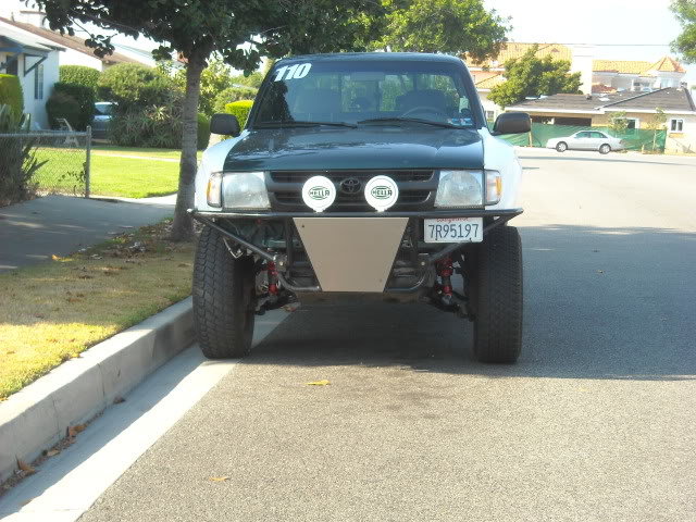

    Then after that me and my friend built a tube bumper for myself which he designed off Solidworks, which came out to $70 or so in materials.
    Some time passed and i needed tires badly, so i found a set of Eagle alloys wheels and Goodyear tires 265/75/16 with 80 percent tread for $380 off craigslist.
    Added led lights for turn signals becuase the front bumper is gone,
    Also got some Plasti Dip and covered the emblems and grill, I also added some cheap rancho shocks i got off craigslist too.
    After some trips out offroading and in the desert knew i needed to redo the suspension. So i got a pair of Add a leafs off a member here for $20 bucks.
    I knew i had to get better shocks , somehow i found some Fabtech "yes i know they suck but they are just as good as fox , etc" Shocks for up to about 3" of lift for $45 bucks off craigslist in Georgia, one needed to be rebuilt , so i bought them and rebuilt the shock. Which these are 2.25 nitrogen charged, huge 7/8" shaft.
    Truck sat like a stinkbug , high in the rear for a little bit, about a month or so when i knew i had to do something to the front.
    I searched and searched and found some Racerunner coilovers 2.0's on craigslist for $200 needing to be rebuilt, off a lady about 1 15 minutes away from me. So i took a drive down there which took 2 hours in traffic trying to get them before 4 o clock before the next potential buyer was going to get them, i got them and took them home and rebuilt them, the seller gave me a gallon of oil and seal kit.
    And cranked them up to about 3"
    Next, i got some Hella 500ff', and converted them to Hid. I knew i wanted to get fiberglass , for my future Long travel. So i got some Glassworks 3.5" fenders for $140 , and running some 1.5" wheel spacers. And added a dust light. Also added cheap air horns, Deckplate mod.
    As far as Maintence parts added, I have added new oxygen sensor, timing belt, water pump, thermostat, tranny mount, carrier bearing, air filter, two core radiator,
    And recently installed Total Chaos Steering rack bushings.
    I think i have about a little over $4000 into it now.
    Thats it for now. Thanks for looking.

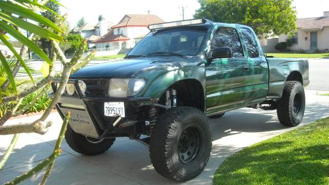

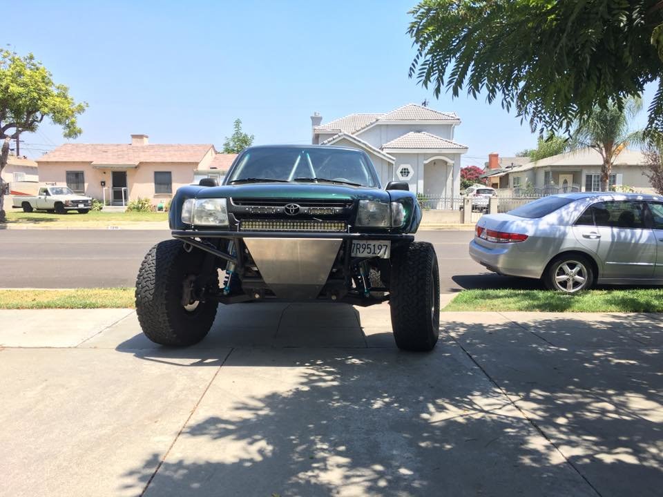

    Recent Pics.

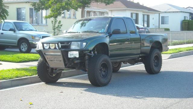

    Updated Pics

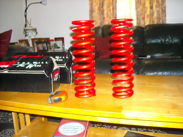

    Used coils Thanks to NVDeserted!
    13" 650# Coils.
