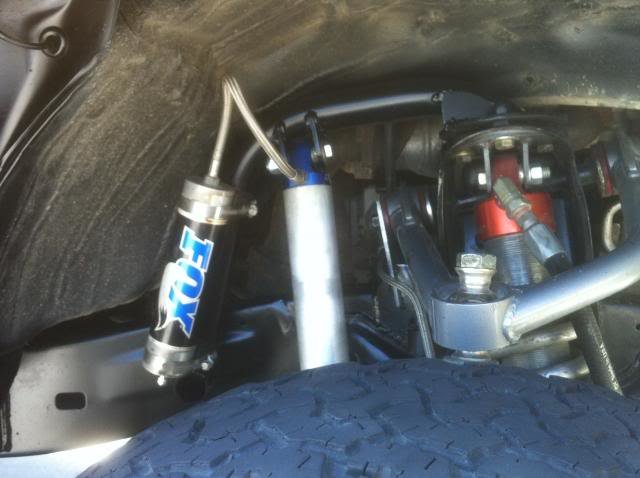

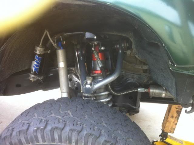

    For a hundred bucks, i guess not lol. Its a 8.5" stroke perfect size, I already mounted and cycled them made clearance for future 2.5 SAW three tubes will bolt right in.

    Already did a street test and wow way more added dampening, street ride is a bit more stiff but its not bad, I already played with valving a bit, now gotta test. Feels like its time to go faster!

    Yup, like they were never even offroaded, seals are all good, and oil is clean, I went out tested them and noticed it was wayy to stiff in the big whoops, so I revalved them already and ready to go test.

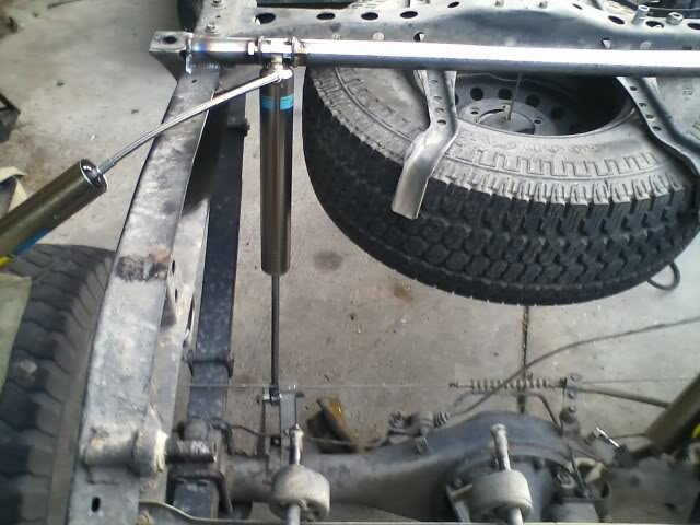

    Hey- when you welded your rear cross member to the frame, did you cut the tube to give it a flat surface? Also, it looks like you welded some kind of end cap to it, right?

    cut it to size weld on some angle to plug the end then weld the angle to the frame :cool:

    Nope, just cut it to width of frame, weld up all bottom side, then at the ends I welded a light tab for added gusset haha.

    So you welded it to the top of the frame but didn't cut the tube, right? I thought for sure you cut the tube to make it flat on top of the frame.

    Nope just welded the tube to frame on both sides and welded the 1/4" tab to the side and to the frame,its been holding strong for a while now!
