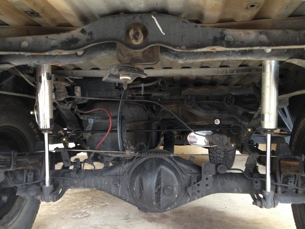

    Hey Anthony-
    Did you have to remove your bumper with you removed your bed?
    I'm going to be running 10" Fox shocks and I'm curious what you think about this set up? I think the 10" Fox shocks are two inches shorter than yours as far as extension. I'm wondering if this might be to high? I'm going to be using the same lower mounts as this truck and not as low as yours.

    No i didnt, and that looks good, setup looks fine you want a little more uptravel than downtravel.

    I agree on the up travel but the shock looks like it's almost at full extension & doesn't have much room for down travel.

    It will still extend off the travel and droop from shackle combined.

    Hey Anthony, ride height are your shocks sitting at? What's your up and down travel?

    Lol Sorry i forgot to reply. About 6" of travel at ride hieght. And about 5" about inches of down travel.

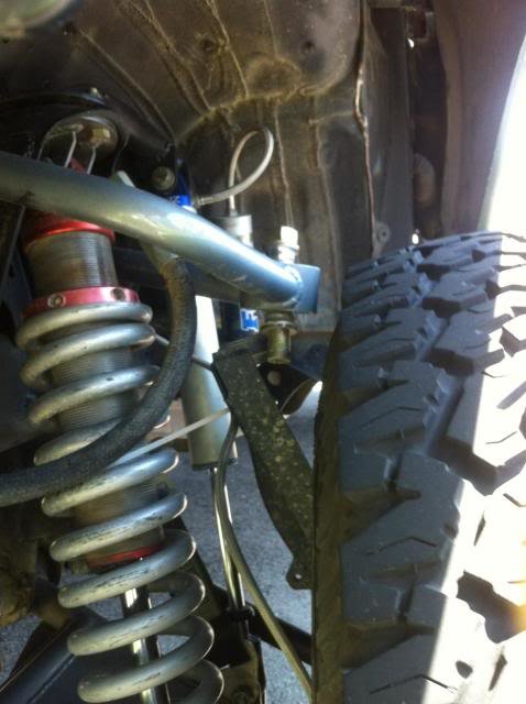

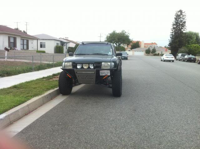

    Updatesss....... 40" Led bar on top. And Going to have hopefully some new small upgrades . Including new hardware as my spindle bolts broke driving on the street.

    dude, come on, better pictures of bar!! looks good though. what bolts broke exactly?

    LSK Race Kit, King Shocks, Methods, Glassworks, Baja Designs, Built by myself.
    lol sorry, this one... haha
    Sheared in half probably of age and abuse.

    that couldve been bad if you were flying down the desert. hope you changed both sides out.

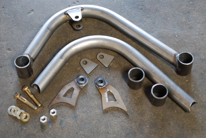

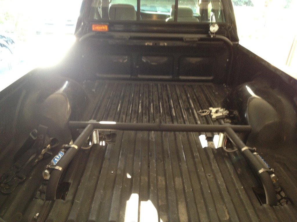

    Hmm, i'll have to hit you up when I build my rear. I was thinking of going with Solo motorsports WIY shock hoop kit... what do you think are the advantages/disadvantages of this location over yours?

    how is there room outside of the frame rails for shocks on a 1st gen?

    Im pretty sure someone asked that awhile ago and its cause its mis labeled on the website and is actually for 2 gens

    the picture is definitely not a 2nd gen

    There's room...
