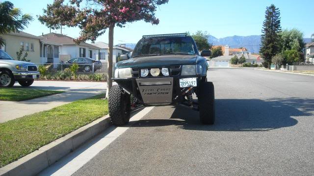

    Granted that's the opposite side of the one the kit is pictured in. the shock goes in front of the axle so in my pictures it would go on the right side

    you will 90% positive rub the shock during articulation.
    def wont fit a bypass!

    Hmmm so how does that shock relocate kit work then? Bigger wheel spacers? :notsure:

    maybe this ^^
    i have seen people put their shocks outside the frame rails with a tundy or t100 axle and still have to notch their frame to get them to not rub during articulation.
    with a smooth body, spacers, and the right back spacing im sure you could make it work.

    Also that is a 2.0 shock

    It will fit. Ive seen it done. Those pics are of a first gen. The truck ive seen it done had I think 1.5" wheel spacers running 2.0 bypass. It was the owner Of Total Chaos his truck.

    That will work using a 1.5" wheel spacer. Advantages looks better,and able to run shocks at better angles, and more stablility. Downside shock rub if any.

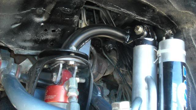

    Updates. Fox 2.5x10" Triple Bypasses installed up front. More pics..

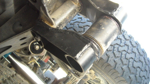

    Can you take a picture of your limit straps and how they're set up. I wanna see how you mounted them.

    Here you go... Not that great but.. Its welded buttom of frame to top center of axle

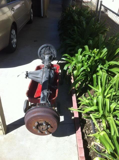

    LSK Race Kit, King Shocks, Methods, Glassworks, Baja Designs, Built by myself.
    Got the Tundra axle..

    i like the radio flyer stand lol

    lol Shits heavy.
