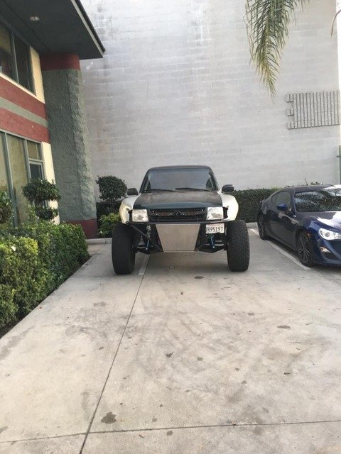

    Update on the truck as it sat for 6 weeks getting a new front end..
    New Front Kit
    Boxed Upper and Lower, fully fabbed Spindle, Dana 44 Hubs , Oem Brake system, 1.5 Uniball lower and 1" Upper, Wide upper arm for two shocks "2.5 Coilover and 3.0 Bypass. 2.0 Hydro Bumps Off the Spindle.
    10" Length Shocks.
    Engine cage
    6" Glassworks Fenders.

  16. Jan 16, 2017 at 7:26 PM
    #476
    orbot
    orbot Well-Known Member
    Jun 24, 2011
    #58782
    1,144
    sweet, who's front end is that?
