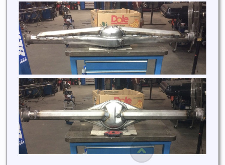

    9" that was fit to it. took quite a bit of work.

    Hey, I’m getting ready to order that same truss for the tundra axle, what perches and brake line tabs did you use? Actually if you have any tips on installing the truss I’d love to hear it.. thanks!

    It took some time to make it fit, had to movk it up and cut fit and grind and add material too. Didnt fit close at all. But in the end it was worth it. Brake tabs are just oem ones cut off. Perches are ruffstuff

    Thanks man. I was thinking of going this route to hopefully make the fit easier…174F4196-2340-449F-8AD4-E2A762D59657.jpg
