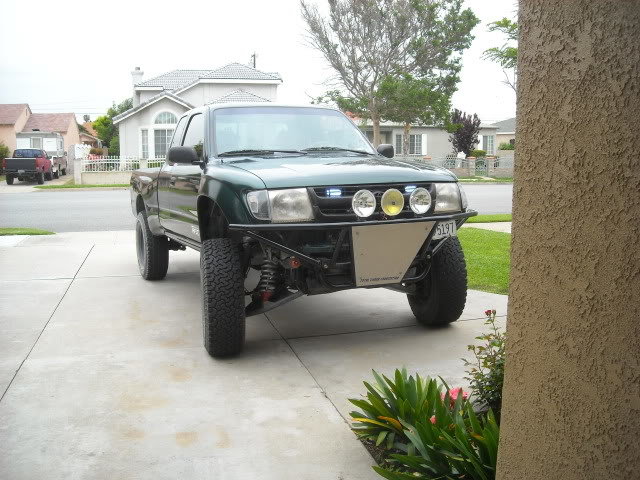

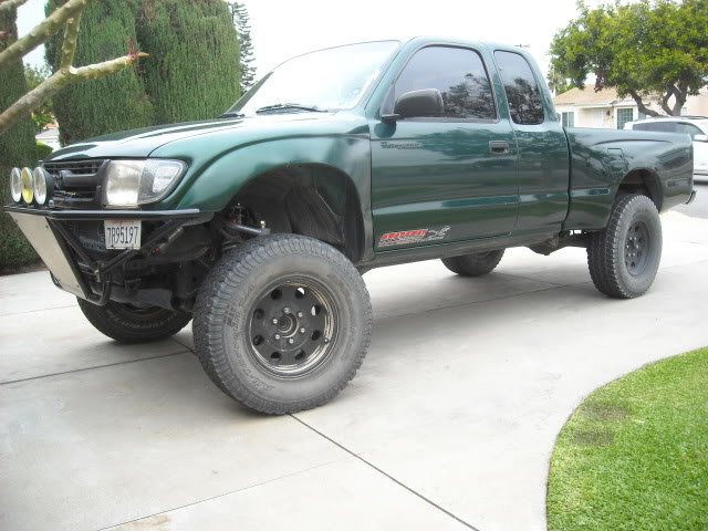

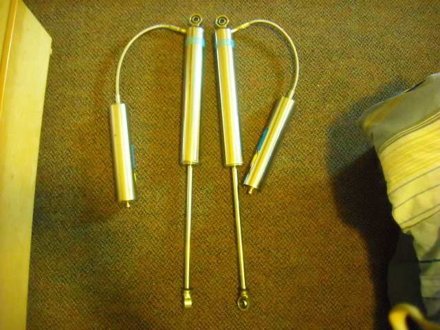

    Updates , Bilstein 7100"s 12" Short Bodies bought off a member on here. Sold the Fabtechs to a member on here. And added some flashing leds in the grill. pulled the bedsides about an inch or more.

    dang how u gonna fit those shocks under the bed? put more angle on the mounts?

    Yeah, gonna mount them as high up as possible, then if needed low off the axle, keeping it as vertical as possible.

    how long extended and collapsed are those 12in shocks? cause there short body right?

    16" compressed , 28 extended yes

    ya mines a 10in travel fox 2.0 and i think its 16 collapsed and 26ext. ur gonna have to have a pretty agressive angle. mines on the stock mounts:eek: cant go wheeling yet:mad: but im buildin mini shock hoops through the bed and mount them there

    I dont think so, i plan on mouting them really low if needed. Oh ok cool .

    ya i thought about lowering it down further, like instead of the stock mounts., i would make a extended mount of the axle that stuck almost as low as the bottom of the pumpkin. but i dont want to hit it on shit so idk:confused:

    Yeah i see what you mean, I dont plan on driving in areas of too much rocks, if so trying to stay away, and making the lower mounts really heavy duty.
