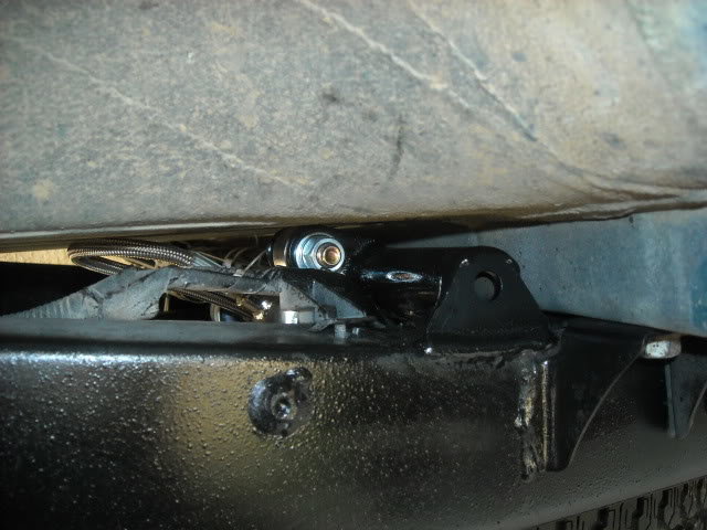

    This is how mine are, very close to the Total Chaos shock mounts

    hows it working for u so far? cause if i do that, then the shock hoops may not be needed:D

    Pretty good, they are beefy and you would have a hard time breaking them

    do you factor in that extra leverage when valving? I bet the shock get hot faster like that, or I may be wrong

    Dont think so, a shock works best i think at a 1:1 ratio,

    im saying how its extended from the axle, when the axle twists thru the cycle, the twisting will be magnified thru the leverage of that shock mount.

    ahh i see, not sure.

    I havent valved them yet but thats a good question. I bought them from DTF and they were valved for the truck he had them on. They seem pretty close, no bucking or anything through some pretty deep whoops, but I am definitely going to valve them down the road. They do get hotter than the fronts but on a similar length run with Paden they were about the same temp as his rear triples

    i would think that it should follow the same path as it would if it were close to the axle.

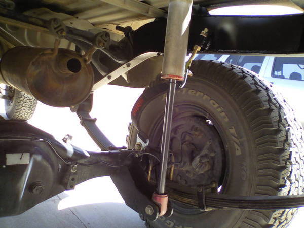

    Bumpstops will be installed later in the week.

    nice what angle did the shocks end up mounted at?

    damm looks great! i need to hurry up and get mine done!:eek:

    About 12 degrees i think. Ill find out after, too lazy to check hah.

    very nice! how much travel?

    are you planning of different shackles?
