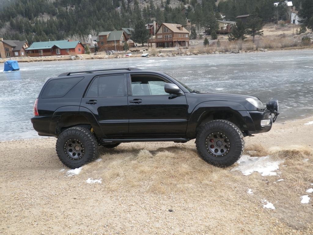

    Just put 7069's on my truck 2 weeks ago.

    04 SR5 4Runner
    King/Dirt King

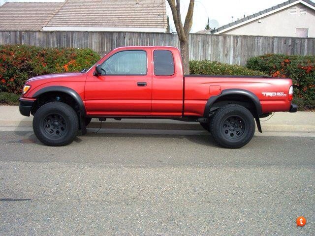

    2002 Toyota Tacoma SR5 TRD 3.4L 4X4 V6
    A lift, some wheels, some tires, some performance, some cosmetic and then audio.
    7069's no center caps:
