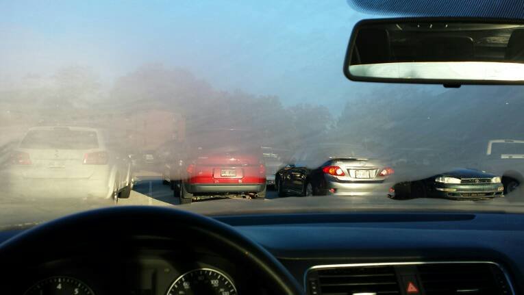

    My girlfriend has a 2013 Volkswagen Jetta, and she has had a bad problem about her windows fogging up. I was wondering what a good product people use for this is.

    Seriously, though, the best way to prevent fogging is to minimize the amount of moisture in the vehicle. Maybe she needs to do a better job of kicking the snow/water off her boots in the winter? If she has carpeted floor mats, take them out of the car and let them air dry in the house for a couple of days. On a dry sunny day, maybe try opening all the windows and parking the car in the sun, if that's an option.
    She should keep her windows as clean as possible, too. Clean glass doesn't fog as fast as glass covered in dust/road grime.

  10. Nov 10, 2014 at 8:02 PM
    CW1027
    CW1027 [OP] Well-Known Member
    Aug 20, 2014
    #136599
    102
    Clayton
    Georgia
    2013 Prerunner Texas Edition
    The defroster only makes it worse. She has about a 25 minute drive to school twice a week. She ran the defrost the entire way, and it looked like this db1bfcd81fda0a94ae63c6f1ca62e412_813ef67d020c6d18da75fda1186220e8772e1d75.jpg.

    Damnit beat me to it. I got rainx anti fog solution and no more foggy fucks.

    instead of heat use AC

    There is moisture in the car somewhere. You have to get it out.

    Check the in cabin filter for the AC. If its clogged, it will recirculate the cabin air causing moisture to build up.

    Run the AC, it will clear up the fog in seconds. You don't have to run it on cold either, it will still be effective with warm air coming out.
