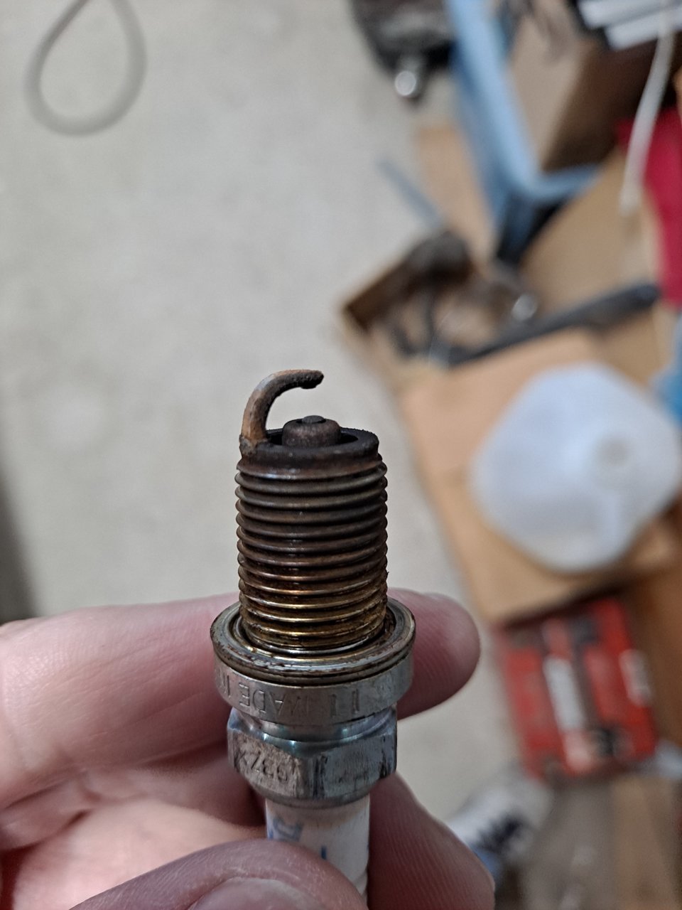

    So the counter to that is, the threads have to be in perfect condition for dry torque.
    Many plugs I pull have rust from moisture, or blowby. So the dab of anti seize allows for better turning motion. No manual addresses corrosion, they all assume perfect and new.
    Thread chasing then installing new clean plugs is more ideal, but a little overkill, and the anti seize can help resist future corrosion.
    When I skip the anti seize on a slight corroded thread you can actually feel it torque too soon.

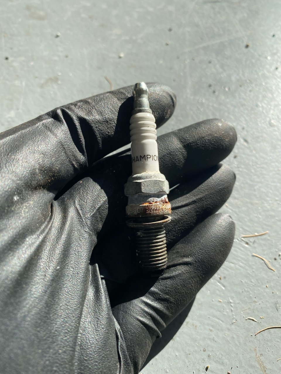

    Pulled this from one of my bikes this weekend. No anti seize was used when I placed it years ago and despite corrosion on it, it came right out. Affirms no need to add any.
    mattleg and Speedbird like this.

    That's very mild corrosion, this pic is typical on Toyotas where I am. I stole this pic. I'm in a winter dry prairie region.
    This indicates moisture, exhaust gas leak and corrosion, see how the threads are rusty top to bottom.
    That corrosion is still in the cylinder head threads.
    You can chase them but its far from ideal, or you can simply dab a little antiseize in and it will add a tiny coat of lubricant.
    It's 100% not required, but its just a suggestion.
    Manufacturers expect everything to be factory clean and clearances perfect.

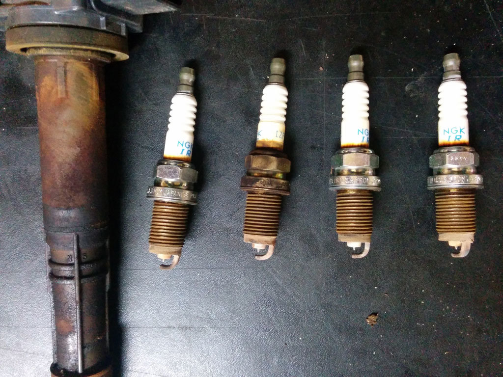

    I changed plugs on an 18 year old Hyundai a few months ago, they were the original plugs and this was the best of the 6.

    Not seeing any corrosion. I see plugs with typical combustion product deposits; one with a leaking gasket (loose?) allowing combustion leakage into the plug well. Clean those with solvent and a brass wire brush next time, you will most likely find the factory plating intact.
    Edit: The darkness of the insulator, that's corona staining, which is normal.

    So that is corrosion, though above the gasket only. Normal for a motorcycle plug as they are often exposed to water being kicked up right into the engine from the front tire.
