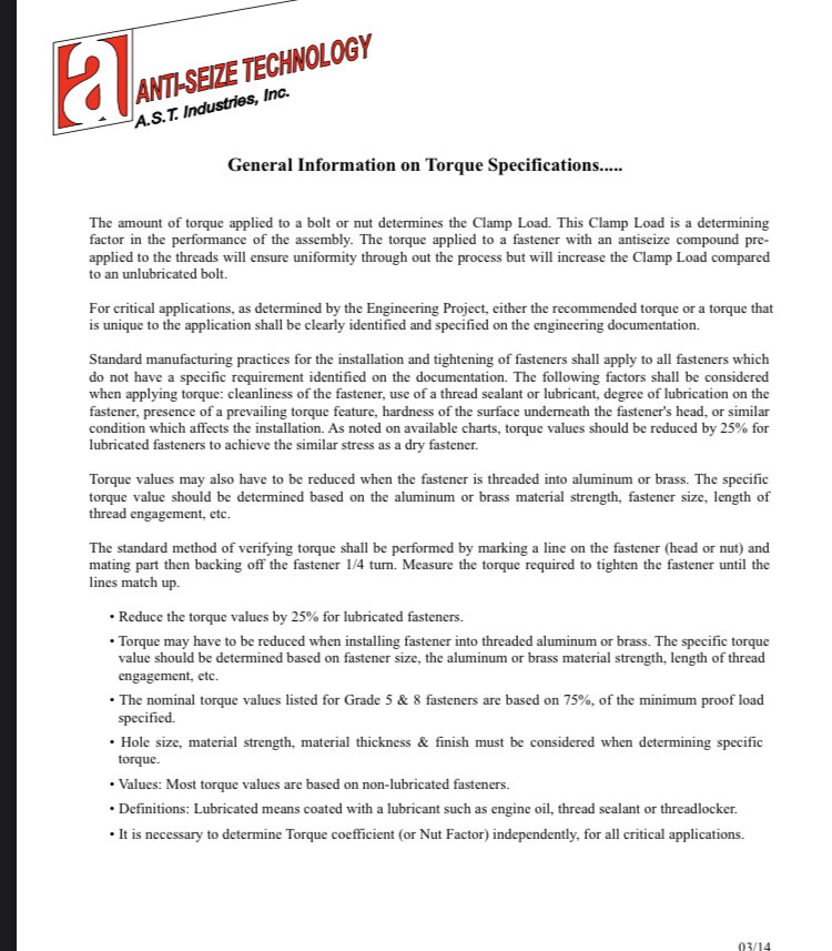

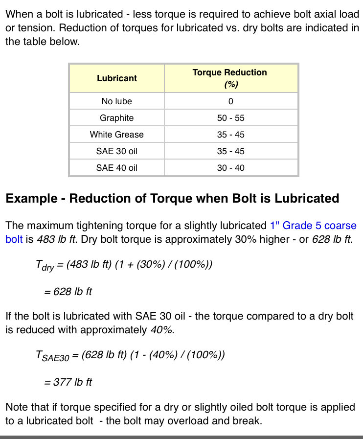

    Seems like a 25% reduction is a safe bet for a bolt lubricated with anti-seize. If the OEM Manual calls for 100 foot-lbs, go with-75 foot lbs, etc.
    Some resources:
    shakerhood likes this.

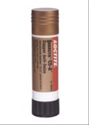

  18. Nov 8, 2019 at 3:58 PM
    #38
    Tacorific
    Tacorific Well-Known Member
    Nov 10, 2018
    #272222
    571
    John
    NE Iowa
    Barcelona Red 2018 SR5 I4 4X4
    Torque Pro, LED Map & Dome lights, Westin Hitch, Ride Rite Air bags with Daystar perches, Utility Package Rear Cab Panel
    Steel on steel: Fel-Pro C5-A
    Aluminum on steel, or aluminum on aluminum: Permatex Silver
