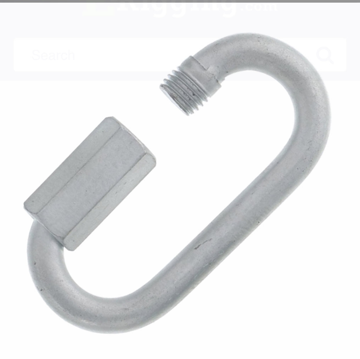

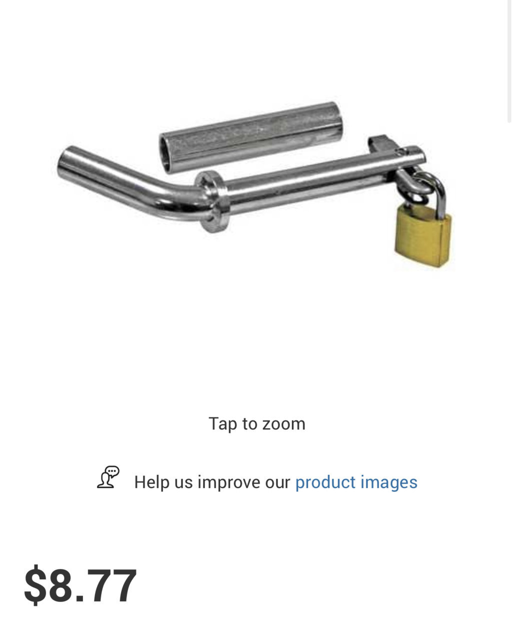

    $10 solution I’ve been using for years: go get a locking receiver pin + plus a little Quick Link (to use instead of a padlock that you might lose the key to).
    I tighten the quick link with some pliers I keep under my back seat. Makes it hard enough that it keeps bored kids from walking off with it, but still easy to remove when I need to.

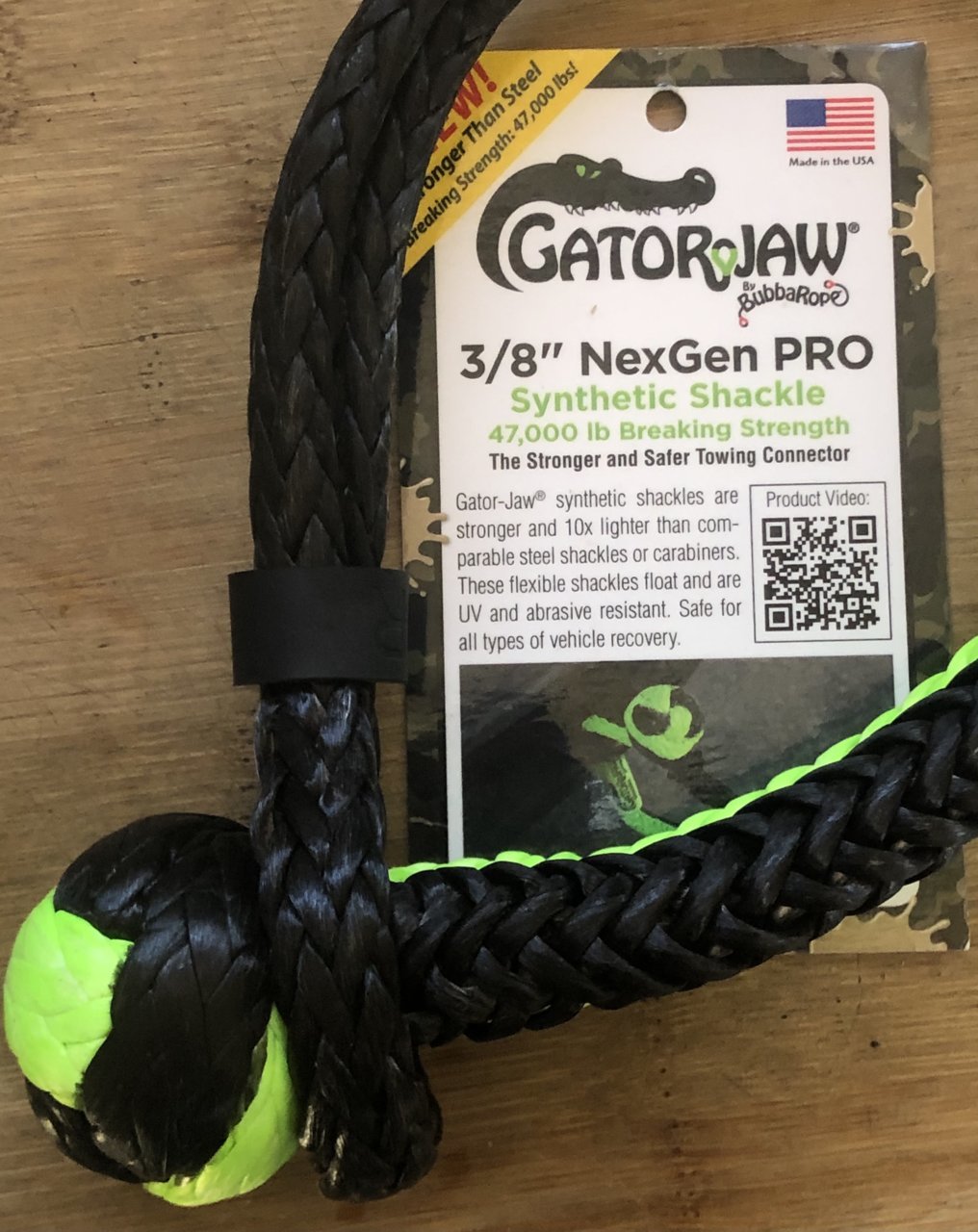

    Update:
    Now 3/8” soft shackles are reaching 47,000 lbs breaking strength :eek:
