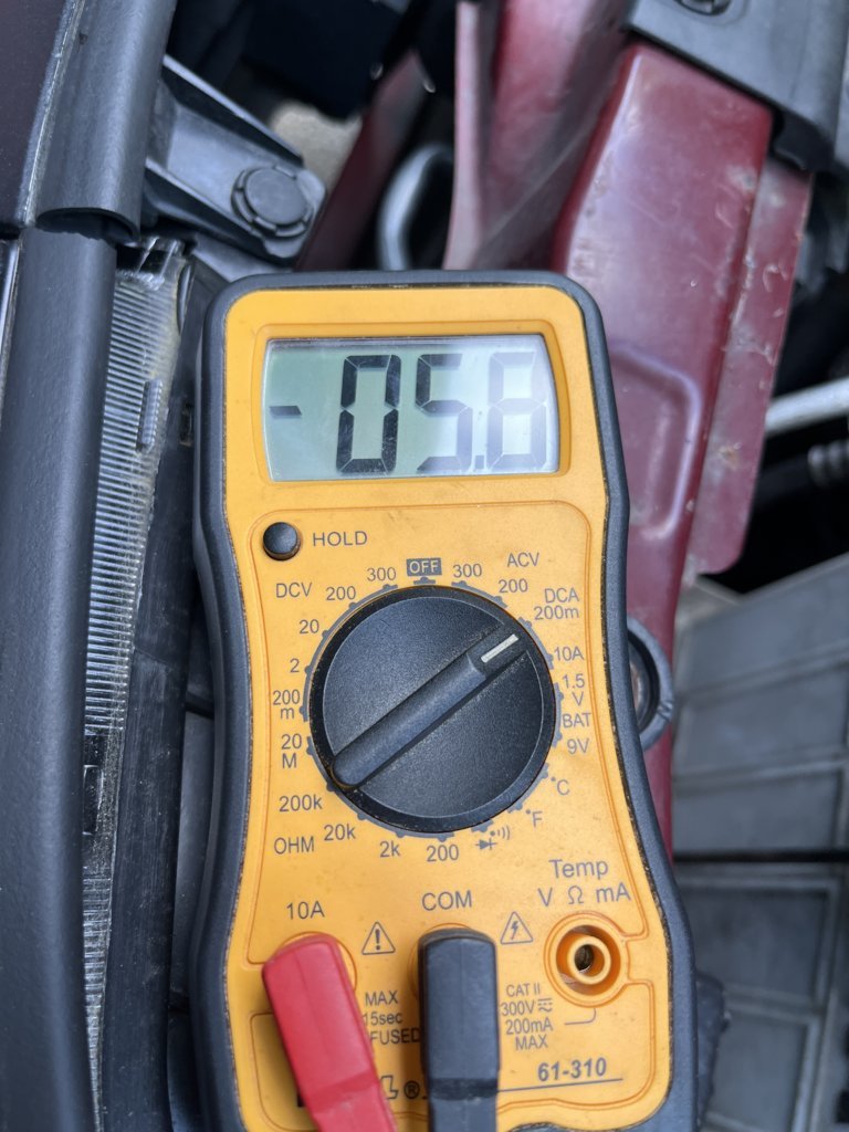

    So that’s 5.9 mA?

    I think so but set your meter to the 10A scale and make sure.

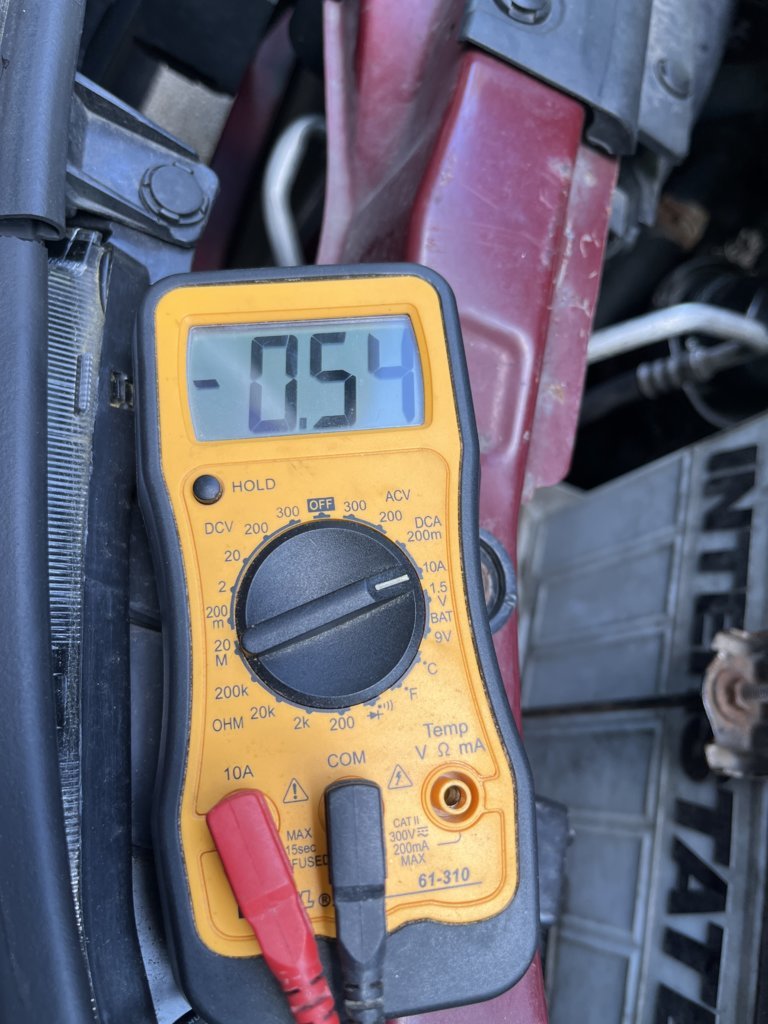

    On the 10A scale I get 0.54

    So it looks like you have about half an amp or 540mA

    Yes. And you’re saying that’s waaaaaay more than I should have.

    Yea that's more than a bulb but give a few min and see if it drops, I just checked mine and it takes about 2 min to drop below 100mA.

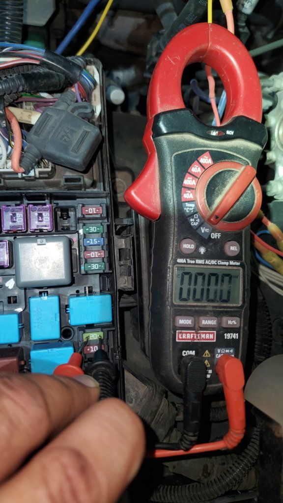

    You can try the ECU-B first but beyond that a better way is to check voltage drop on each fuse.
    The best way to do that is set your meter and leads to volts DC on the lowest scale (so 2v on yours) and put the leads across the 2 teat terminals on the fuse, if it doesnt read 0 there is current going through the fuse if that makes sense.

    Took reading when removed the ECU-B fuse and it dropped almost in half. But that would still leave a pretty significant draw still in addition. when you say check voltage across the fuse, do you mean the fuse itself, or pull the fuse out and test the socket?

    You test across the test terminals on the fuse with it installed.

    Ok. So wasn’t DMM ‍♂️. But you got me onto something. The only two fuses (at least the plug ones…I didn’t mess with the big blocky ones), I get approx 500 mA when testing parasitic in series with terminal and cable. When I remove the ECU-B fuse it cuts it in half. When I further remove the ALT-S fuse it goes to 30 ma. I found the ALT-s fuse and ECU-B fuse reading around 2.3 millivolts with the fuse test you had me do.

    So the alternator is pooched and we have at least one other module staying awake.

    Alternator voltage sense, it only feeds the regulator in the alternator so I guess the regulator got fried. You can put the fuse back in and unplug the alternator to confirm.
