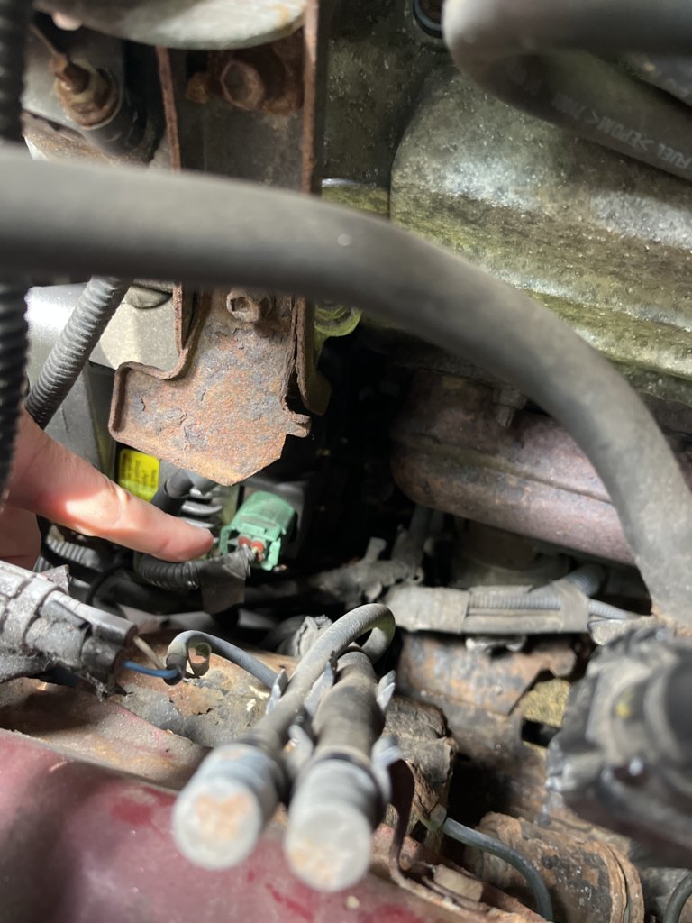

    Is this what I unplug?

    Yes.

    Ok. Separate component but part of the alternator. Meaning not another part next to it.

    Correct.

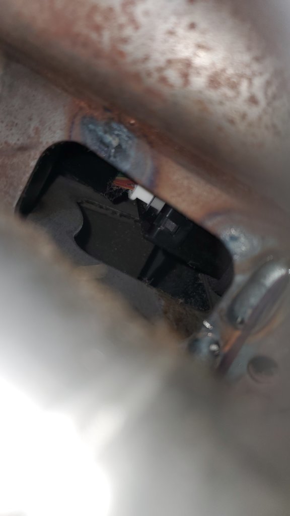

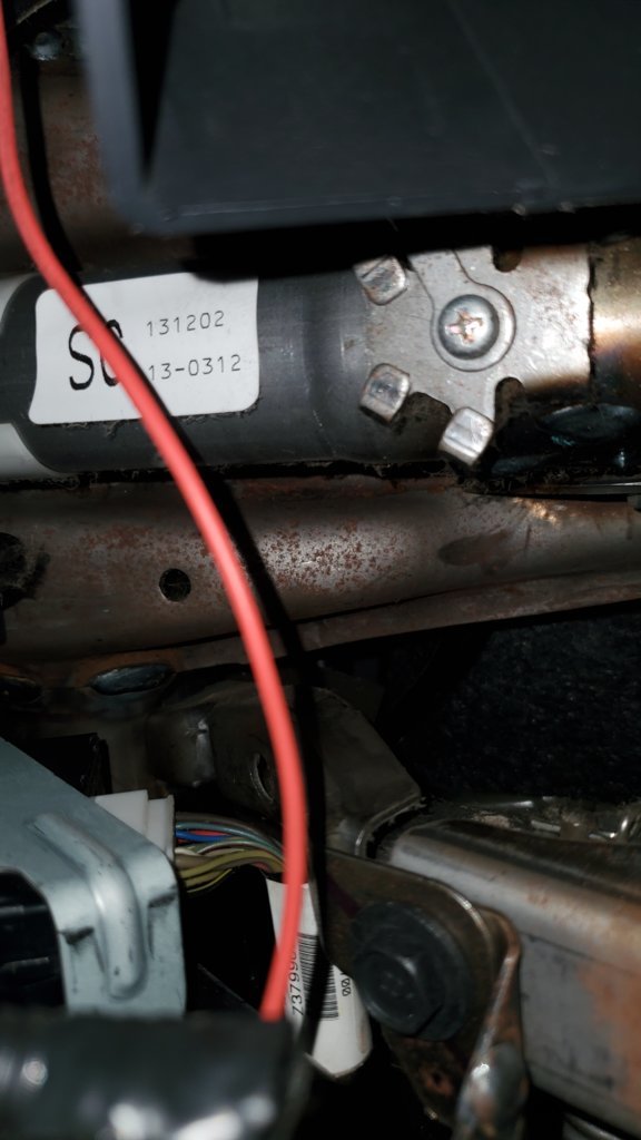

    I mean the Transponder Key ECU is the most likely suspect being the security light is staying on.
    I found it on mine, it's directly above the steering column.
    It may be possible to reach in there and unplug it with something but plugging it back in would be a chore and removing it looks like a job.
    If you look up from the bottom right above the steering shaft theres a small hole you can see it through.

    I tried to get a picture of it but it's pretty hard.
