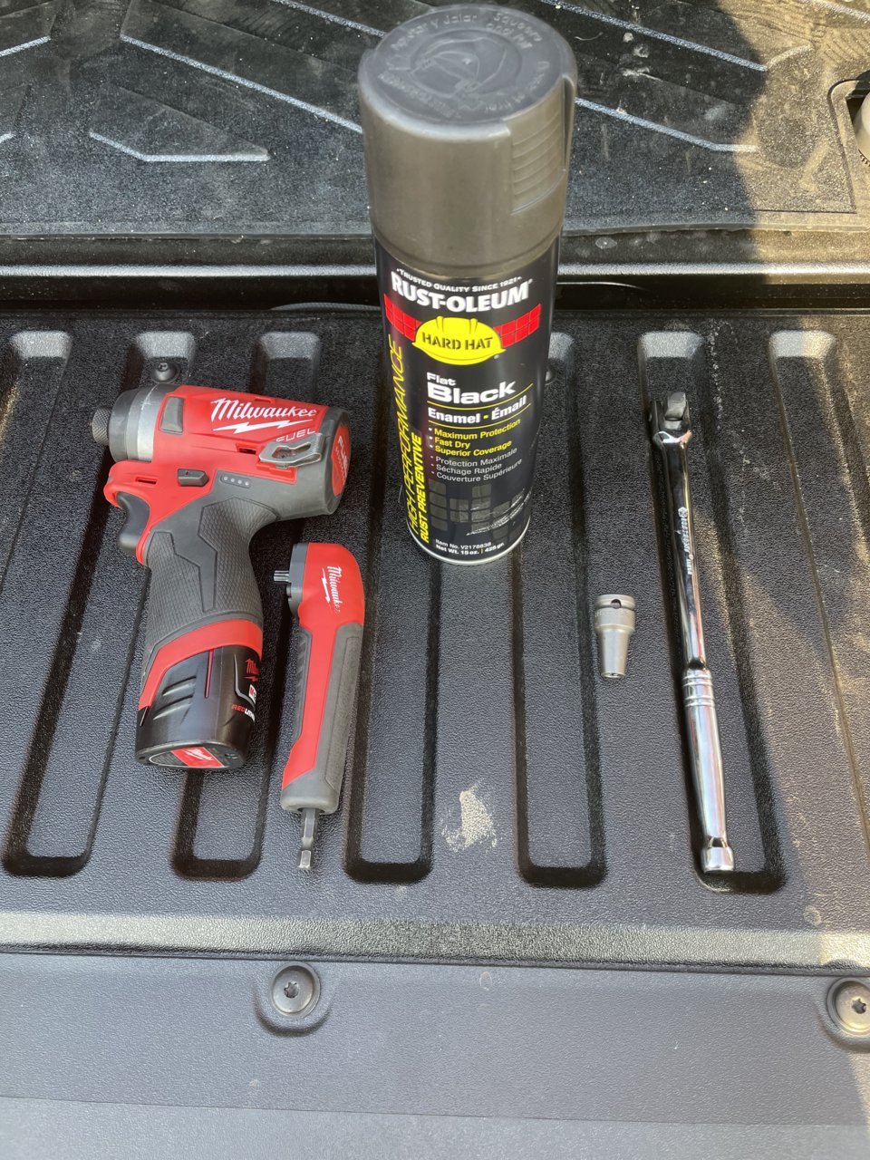

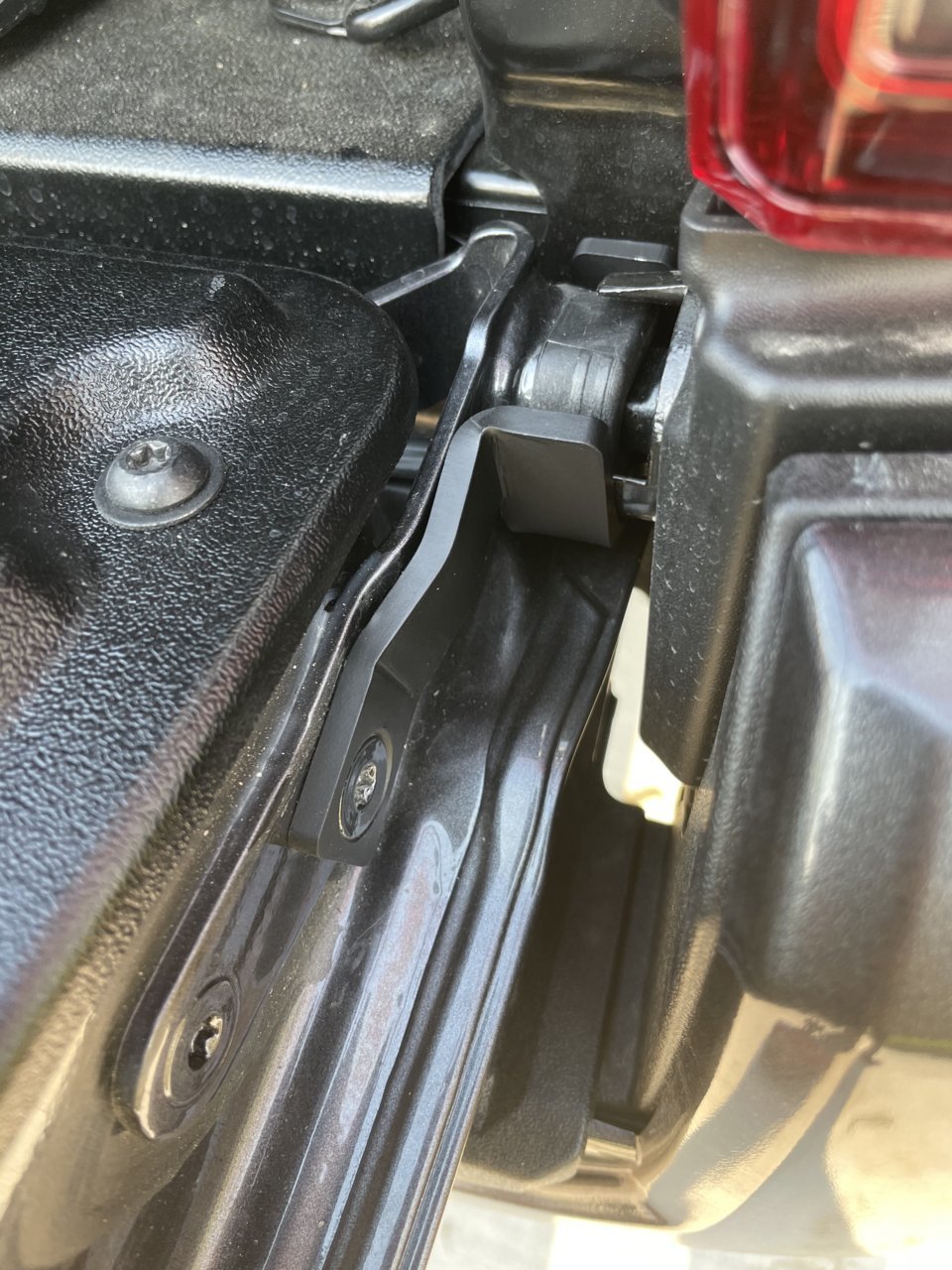

    Got my bracket in today.
    Unfortunately I got an almost welded T40 bolt from the factory.
    First attempt was with my Milwaukee M12 Fuel impact and a right angle adapter (didn’t take the tailgate off) but it wasn’t moving.
    Second attempt was a 3/8 breaker bar with a 1/4 screw bit adapter while holding the tailgate at a 45 degree angle and I managed to break it free.
    Went back to the Milwaukee to finish driving it off. Slid the bracket in and started the bolt by hand, tightened with the Milwaukee again.
    used some rust-oleum flat black rattle can paint.
    Sorry mods, I posted on the 2nd gen thread by error, Delete if needed. This is a 3rd gen bracket also made by the OP. GREAT MATERIALS AND FIT!
    Edit: DO NOT LET THE T40 HEX BIT JUMP OR YOU WILL STRIP THE BOLT. I kept a lot of pressure near the head as I was breaking it free with both the impact and the breaker bar, not a single jump.

    Is it on upside down? Looks different from the original post.

    It goes in this way for 3rd gen, OP has it on 2nd gen
    edit: woops looks like I came back to the 2nd gen thread. Sorry!
