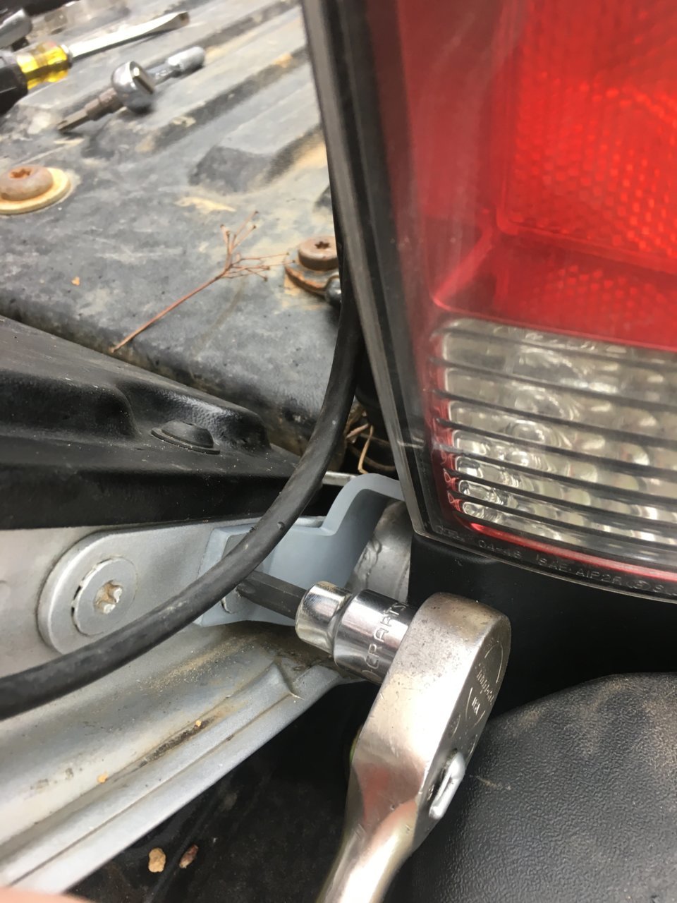

    Got mine today, looks solid as a tank and the steel is much thicker than expected. Do we only need one of them to protect the tailgate from theft? Or should I have ordered two?

    Left hinge is a full cup. You're good.

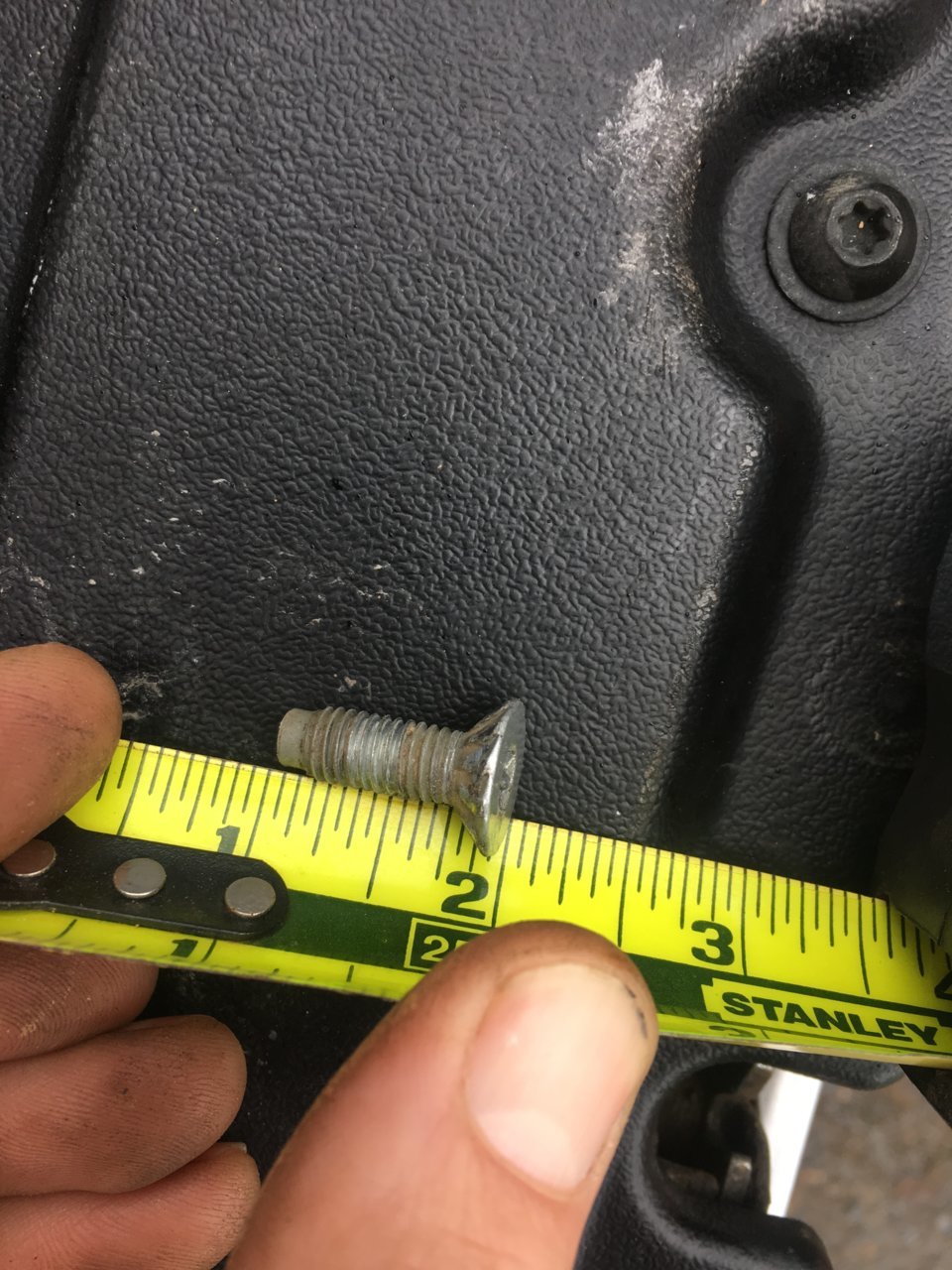

    Bolt size is a 1” long M8 1.25 if anyone can find a security bolt

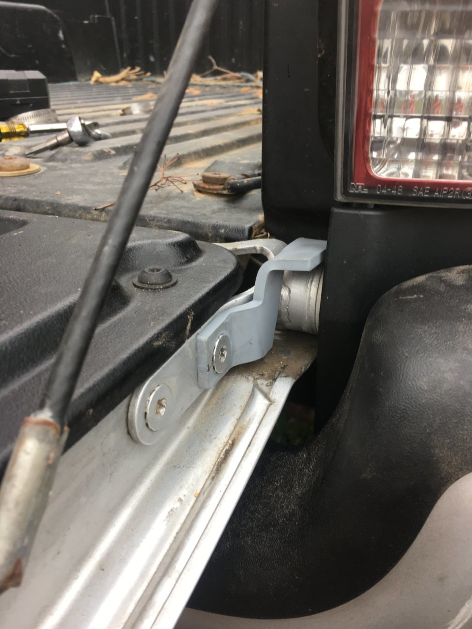

    Super easy to install and looks good. Left mine primer grey. WAY more secure than a band clamp.

    Nice looks good

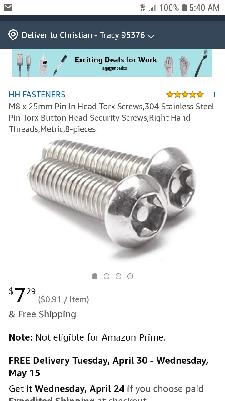

    I used this one, Amazon is your friend.Screenshot_20190415-054049_Samsung Internet.jpg

    what size torx are you using? just got mine & need to get around to putting this thing on

    The factory one is a T40

    Are these the bolts I will need for a 2014?

    U can use the factory one, just unscrew it, slip device on, put screw back on. Or yes u can use the security screw but u have to have the bit for it as well, the screw is an m8 x 1.25
