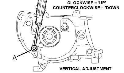

    No need for a PDF.
    1 - Park on a level surface 20ft away from a flat wall.
    2 - Measure from the ground to the focal point of the reflector (center of the lamp or glare shield)
    3 - Put a piece of tape on the wall at that height.
    4 - Turn on the lights, and adjust until the lower cutoff is 2.1 inches below the reference line.
    If you have trouble seeing the cutoff, unplug or hang a hat over one of the lights while you work on the other one.
    On the Tacoma, the top adjuster with the hinged cap is for horizontal. The other adjuster, down lower in a "channel" of sorts is vertical. You'll need a fairly long crosspoint screwdriver.

    I found the lights shinning into the back of smaller cars, so I lowered
    them on my 2012 4X4.
    When I did a Google search on how to adjust the headlight there was just
    baloney. Upon second look found the adjustment on the lower outside
    part of the assembly - 8mm nut. Moving the window washer reservoir
    made it easier on the right side.
