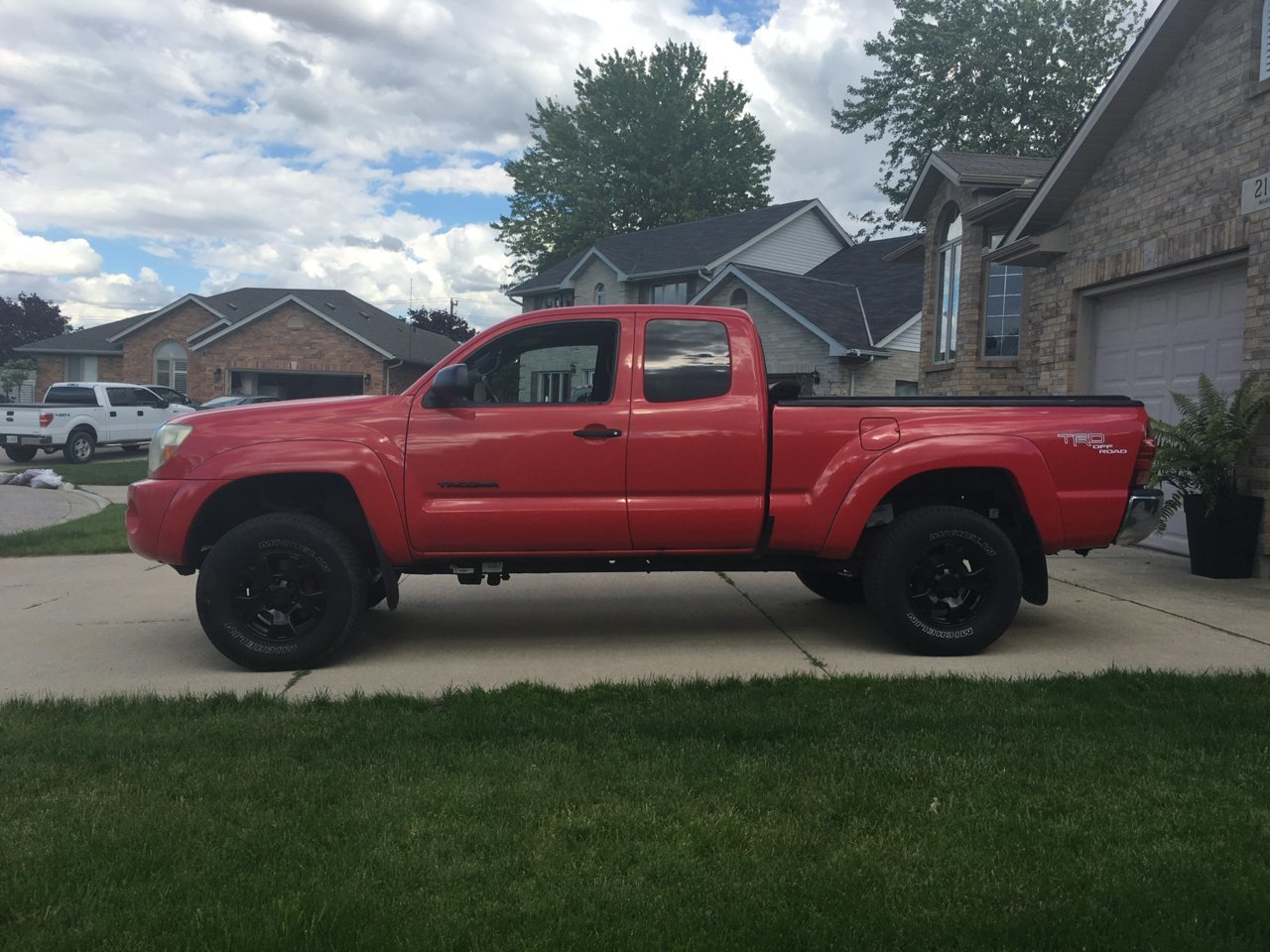

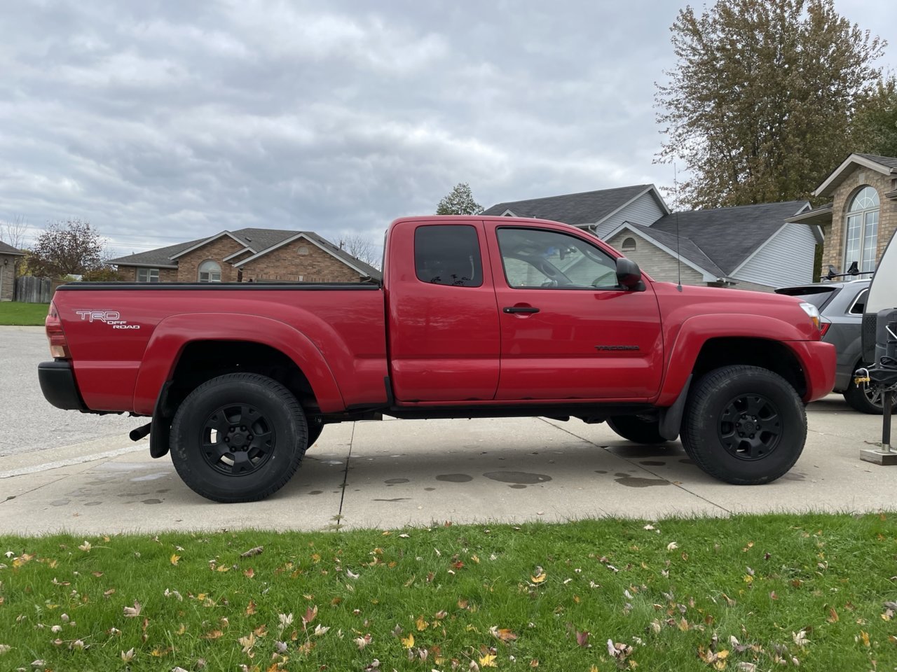

    So I initially had Bilstein 5100’s set at 1.75” in the front, and the TSB springs in the back. I felt it was MAYBE level, but seemed a touch nose high. And then if I put anything more than 50lbs in the bed she was definitely nose high. Then I bought a trailer and the tongue weight made it even worse.
    I then upgraded my leafs to OME medium duty, and it’s perfect for me. Tiny bit of rake normally, and is perfectly level when I tow or have a load in the back.
    To each his own, but I didn’t like the look in the first pic, and am much happier with my front at 1.75” and OME medium packs in the back:
    1.75” up front and TSB leafs:
    1.75” in front and OME medium leafs:

    Sorry just noticed you’re a 3rd gen. so not apples to apples. But maybe it’ll still help

    For me, it was a bit of an evolution. But personally, I’m very happy with the Old Man Emu Medium Duty springs in the back. The Heavy duty would have been more height than I needed.
