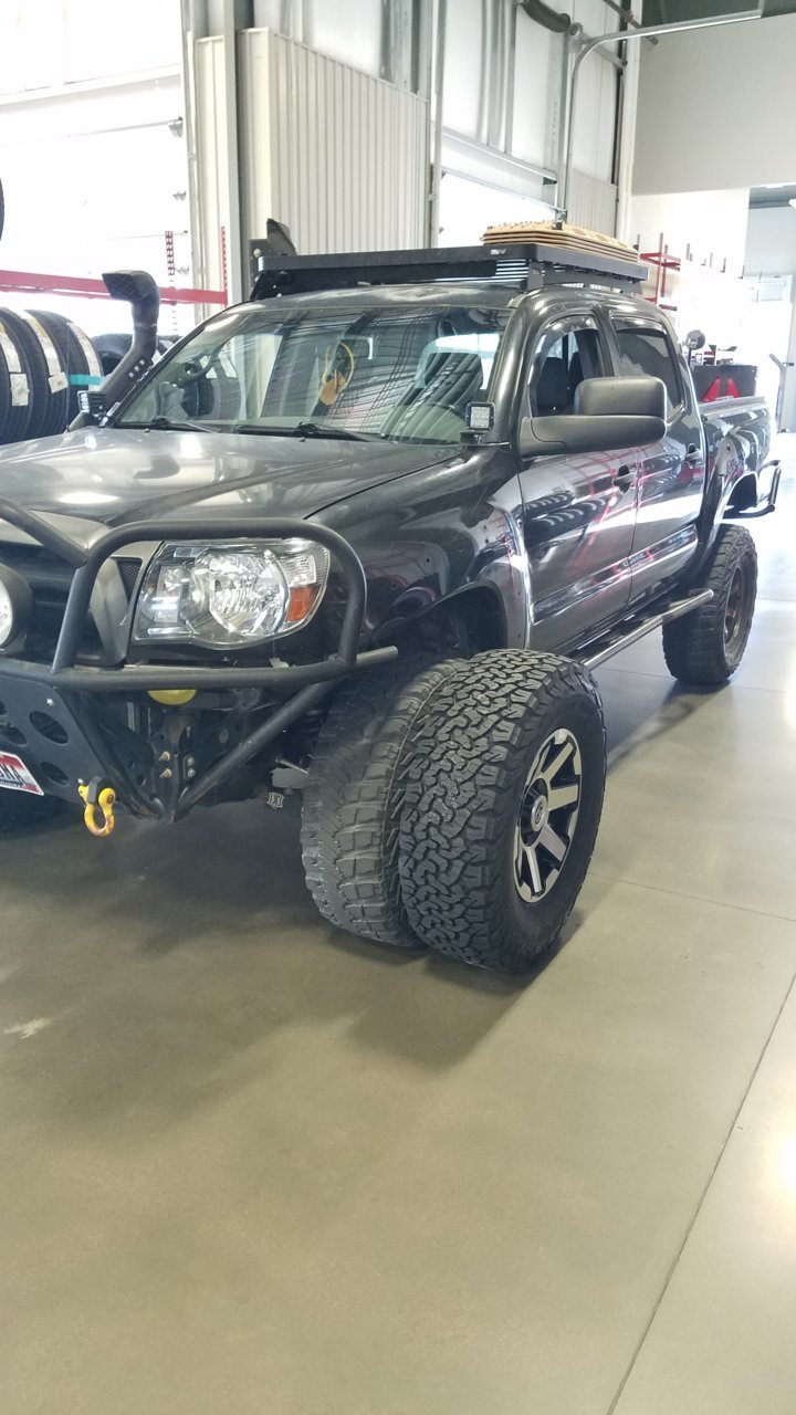

    Comparison pic's. 285/75R16 MT/R, 34x10.50R17 KO2, and a 255/85R16 KM2 wore out. 20180109_180252.jpg 20180109_180610.jpg

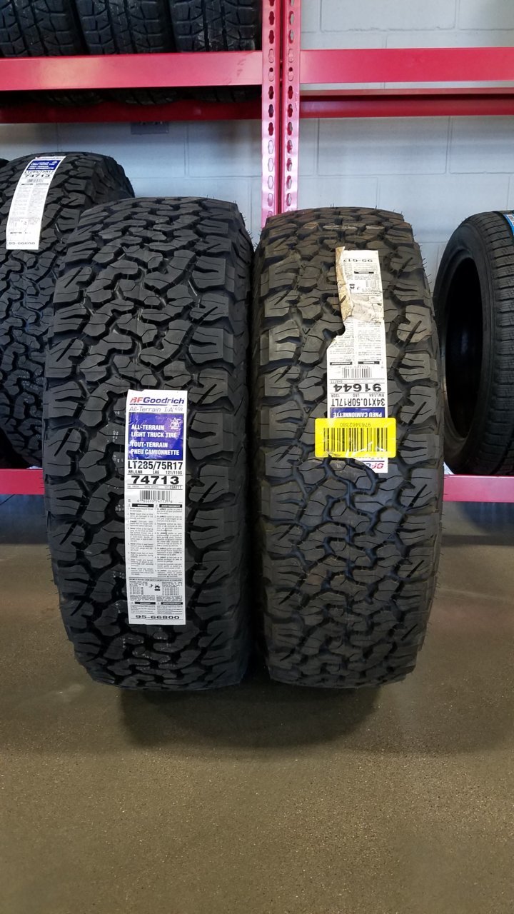

    And a 34x10.50R17 and a 285/75R17. Which is over $50 a tire less.

    The 285 75 17 dwarfs it!

    Yes and the 285/75R17 versus the 285/75R16 is a big difference. More than an inch.

    How the hell? The 285/75/17 shouldn't be bigger. I mean, the 34 isn't QUITE 34 but it's at least close. That would make the 285 BIGGER than 34" which it's not supposed to be. That's odd.

    285/75R17 is a 34" tire.

    According to BFG's tape measure the 34x10.50R17 is 33.5" and the 285/75R17 is 33.9". By my tape measure they are 33" and 33 3/8" respectively.

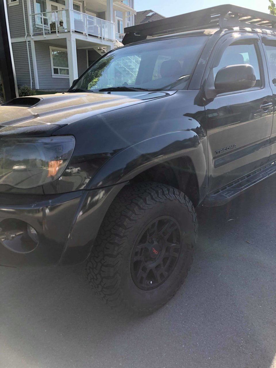

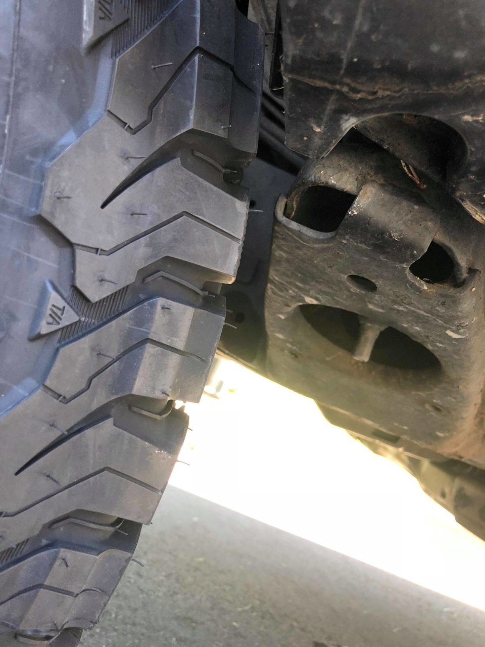

    Hey guys, currently getting these tires mounted as we speak, but the shop is quite hesitant that there is going to be too much rubbing, however I have assured them that after a proper alignment it should be fine. Should I assume I will need to take it in for a CMC after I get these back? 2008 Doublecab, LR UCA, Bilstein 5100's with OME 885 coils.

    With almost 4 degrees of caster I have had no need for the CMC - and I've stuffed them pretty hard. I did however have to do a lot of 'molding' to the fender liners, and cut some plastic from the fender corners.
    LR UCA's.

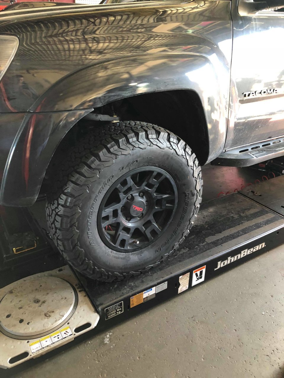

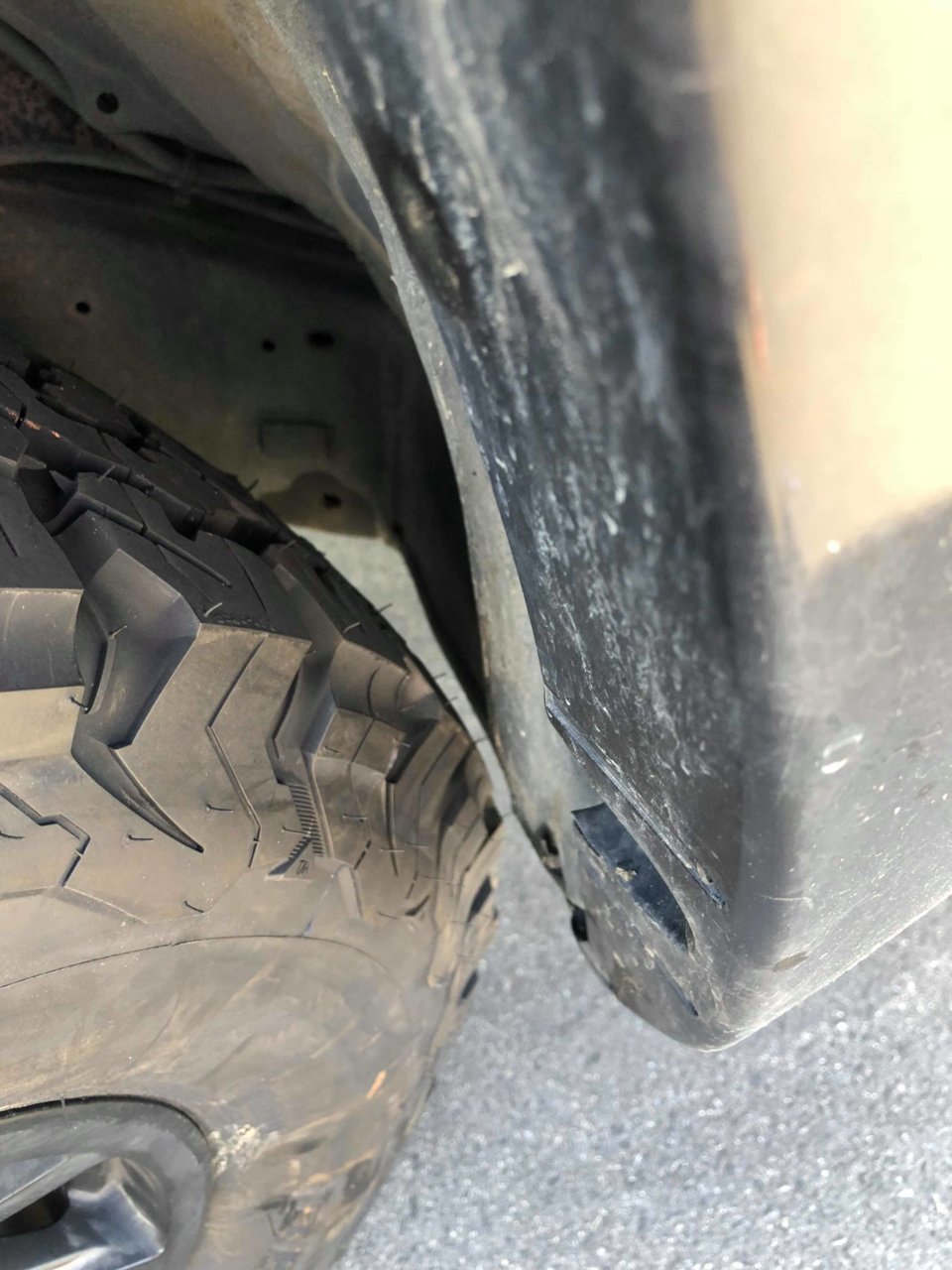

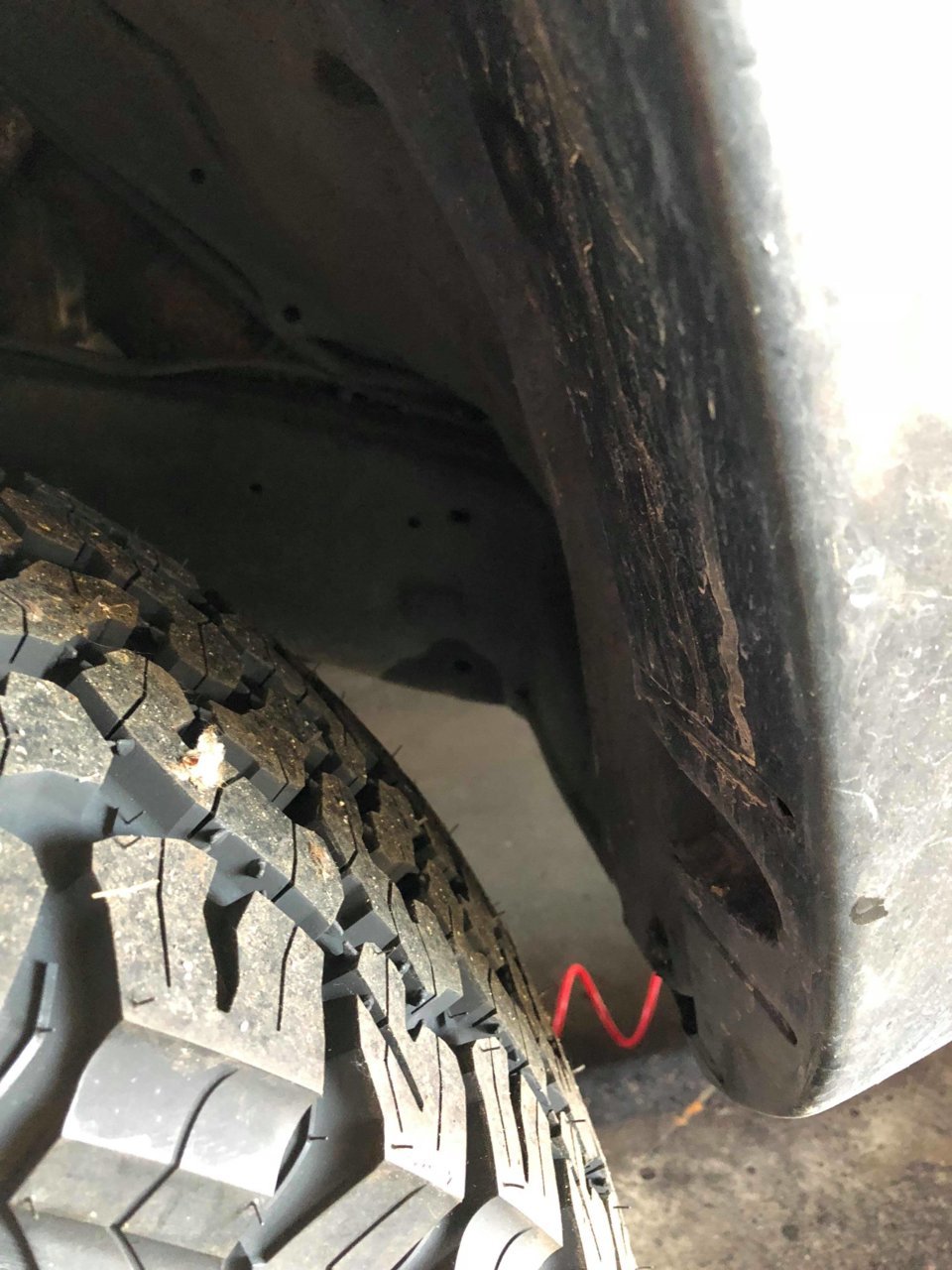

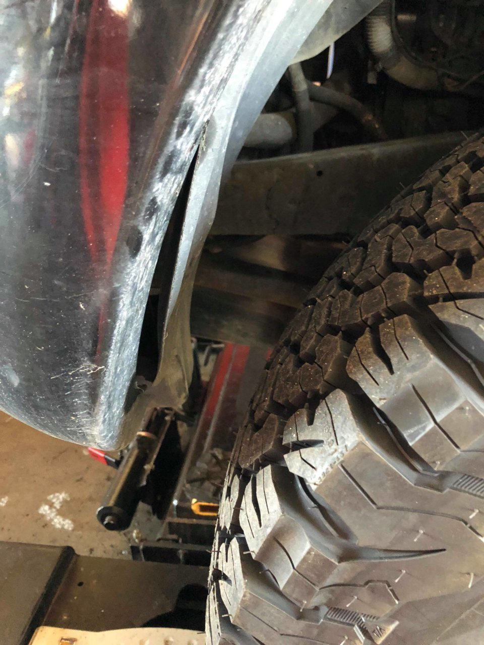

    Got my truck back today after a lengthy alignment. They had to max out the caster on my upper control arms to get them to fit, and right now they just barely clear at full lock. Haven't decided whether or not to get the CMC done yet. So far driving on the road I have had no rubbing. Going to try to take it out this weekend and see how she does off road.
