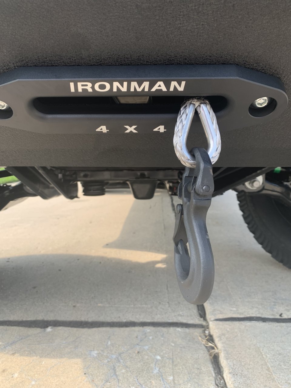

    Yes, I installed this bumper myself. I love it! I kept the light bar off because I have a limited and it got in the way of the front camera. I was going to put a caliraised hidden light bar there anyway but the disengage switch on the winch is a tad too high for that. Otherwise, the bumper is awesome. No cutting needed at all. The body lines don’t line up perfectly and it takes a bit of time to get it in the perfect position where it isn’t rubbing any of the plastic bumper of the truck. Holds my 12,000 winch just fine! The angle also had me worried…I’ve ready a few things about the bumper getting bent because the angle was too steep. I’ll most likely cut the “DV8” logo out of the front and out the fairlead there. It will fit perfectly!!! Hope this helps…

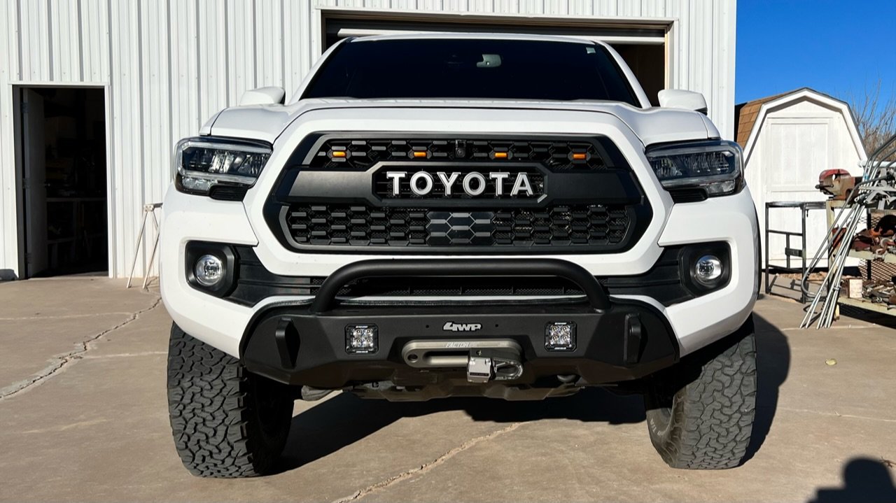

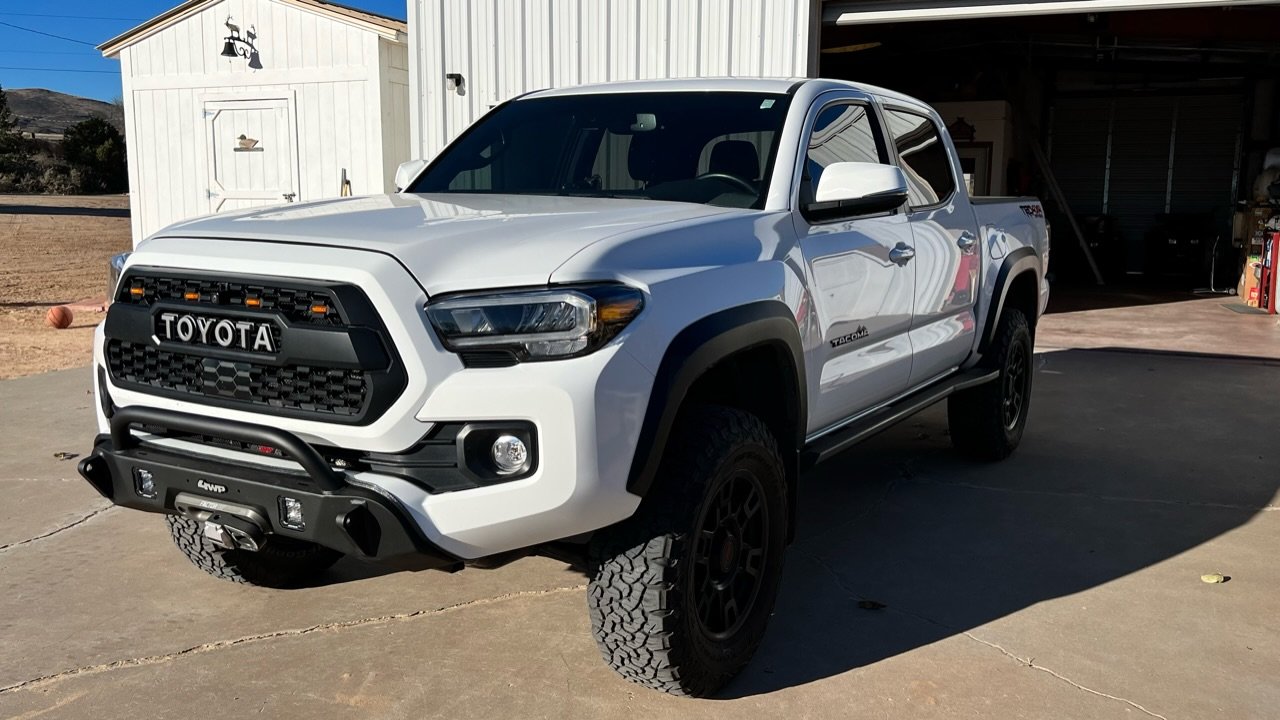

    I just installed the 4wp bumper with a Warn VR Evo 10-S winch. Not a terrible install, it was easier than most. I had to do a bit more cutting than the instructions said on the metal front trim brace to keep from having to relocate the winch control box, and grind out the bottom of the fairlead hole to prevent cable rub on the steel bumper’s edge. I am overall very pleased with the final result.
