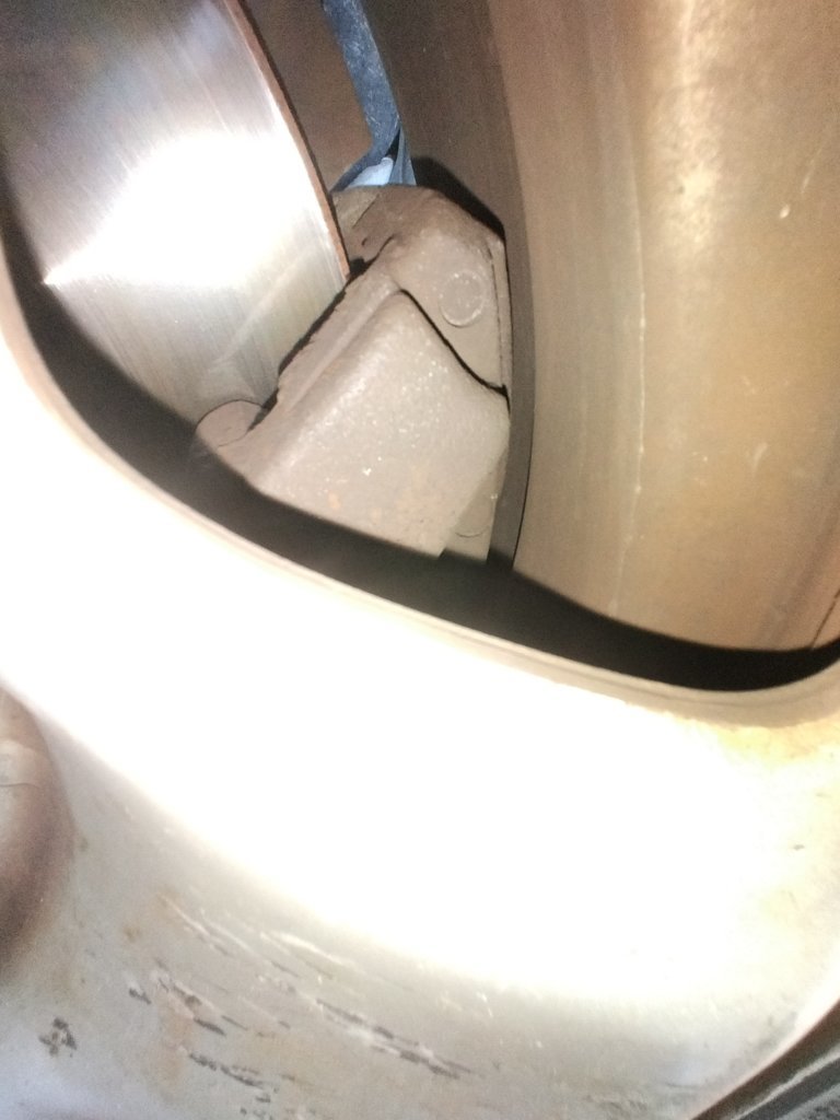

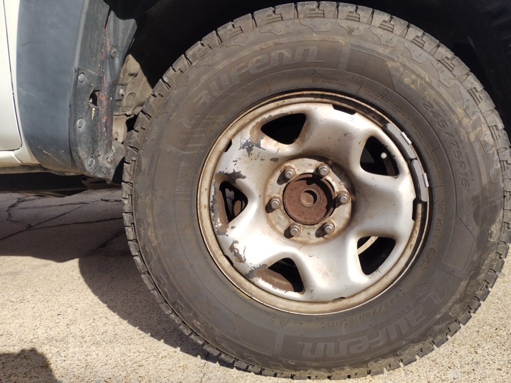

    These are my stock 16 in wheels. I have no idea if they're +30 or what exactly. Not sure what these wheels are called either but they have a lip kind of in middle of them instead of being completely flat on the inside.
    I will go measure how much space i have now with my stock calipers on. 4Runner calipers i would expect to stick out closer to the wheel though otherwise how would the 4Runner caliper be able to use a bigger rotor ?

    in that case I’d recommend you ask in the 4runner BBK or research
    If 4Runner calipers is the way you plan on going
    if spacers clear it
    I’m under the assumption 16” to 17” is to change the diameter to clear and not width/offset but not 100% sure the reality.
    if that is the case, new tires can be sold. Wheels can be sold.
    #1 you can still run regular brakes or semi upgraded for now.
    I am still on stock calipers with added weight and 35’s. It’s not the best but it works.
    never mind. Those wheels. Lauffen tires?
    But talking about bigger brakes
    With small tires
    Not sure about that.
    those are not clear a brake wheels.
    And those are I don’t care about my life tires.

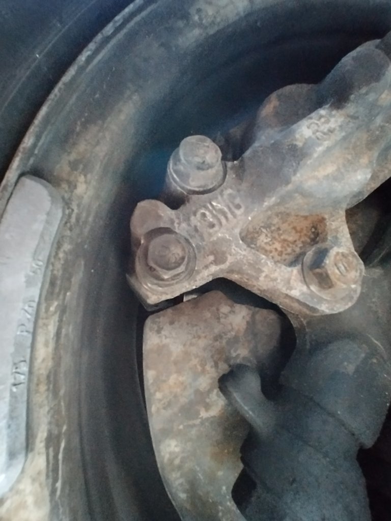

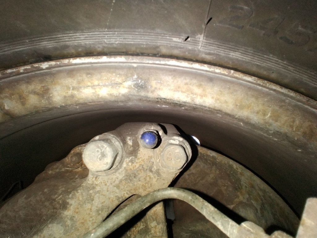

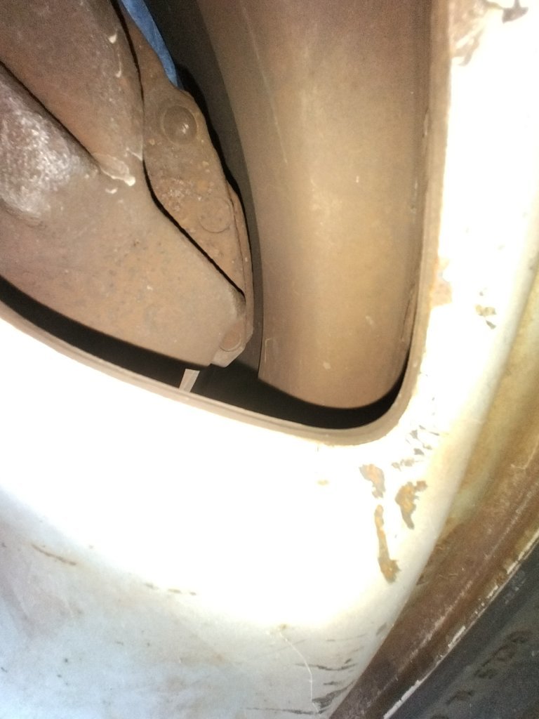

    While the clearance right now with stock calipers is close its closest where the lip is closer to the spokes of the wheel.
    I think this is why one member said he could have used 1.25 in wheel spacers and been ok because the outside of the caliper gets close to the lip near the spokes.
    However on the back side at the bottom and top of the caliper there is maybe 3/8 in space. On the front side there looks to be about only 1/4 in space between the lip of the wheel and the caliper though.
    Might just try to fit one on and if it doesn't work return it. Even if fit was not perfect I wonder if the caliper could be grinded on to make it fit.
