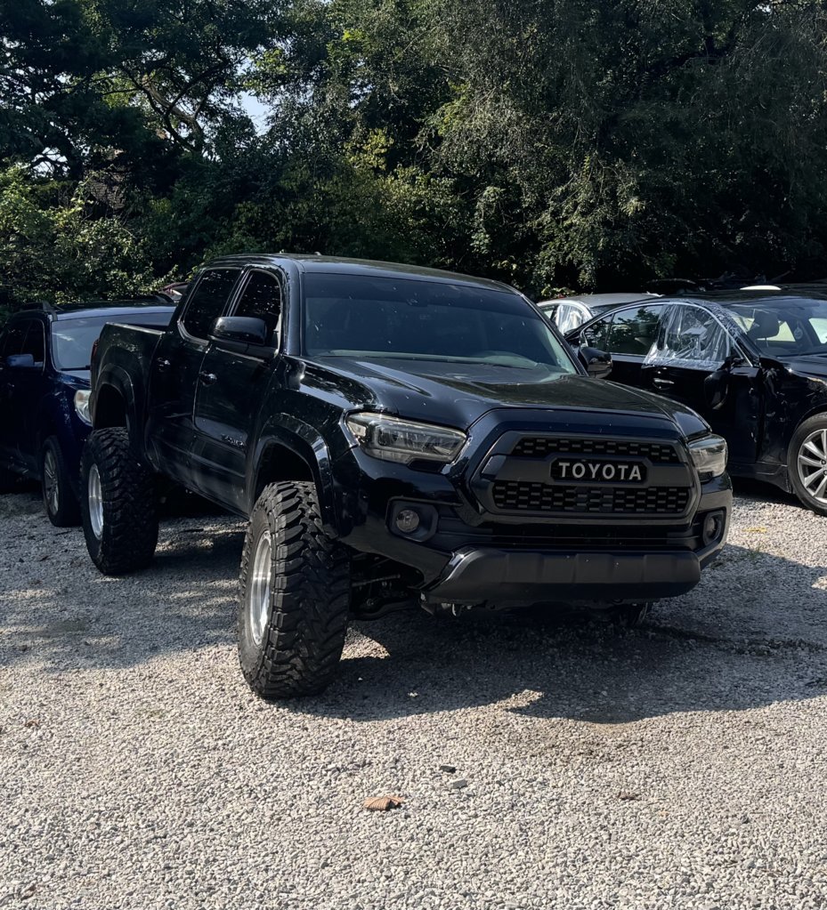

    I think you're missing a lot of people's points, based on your picture your tires are likely the weakest point of your braking system. Assuming your brake system functions properly, no matter how big of brakes you "upgrade" to, you're not really gonna stop any faster. The brakes rely on friction between the tires and the road surface to slow the truck down, so if you have cheap tires with sub par traction, you're just gonna be sliding and engaging ABS. If you aren't locking up your tires/engaging ABS then push the pedal down harder until you do. If you can't, then you probably have a brake system issue. Start with fresh fluid, then maybe pads, etc.
