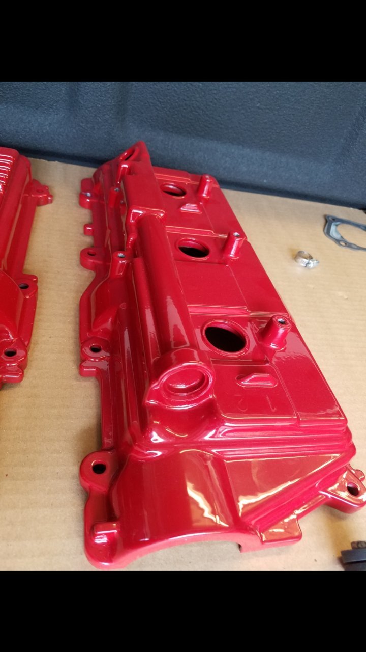

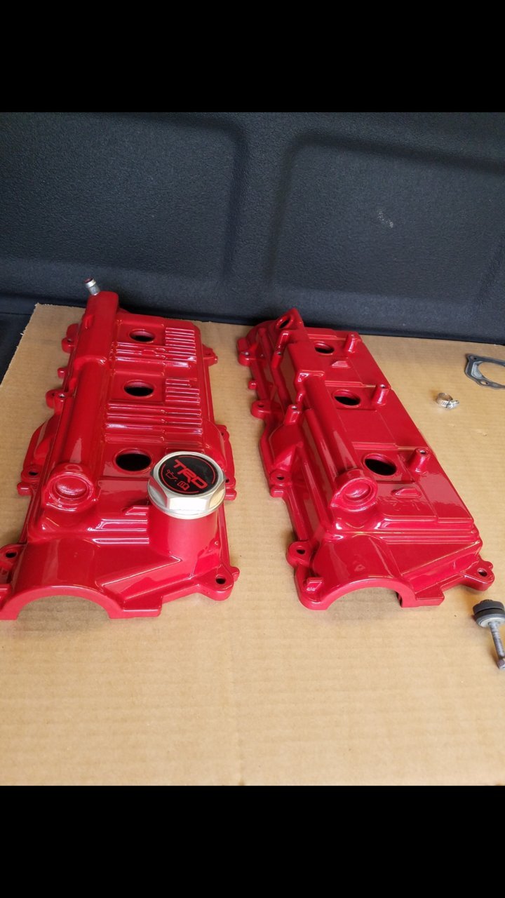

    I’m in the process doing this but with the 3.4,
    I did pull the injectors and sent them in to be serviced.
    It’s a slow process and a good portion of my time was cleaning all the parts.
    Cam seal locations,
    Half moons and location
    Valve covers degreased
    Removing all the old gasket material.
    Replace whatever you can if it has a lot of miles,
    So much easier to do that now.
    I decided to have the valve covers painted while I’m waiting for the injectors to come back.
    LCE has new painted covers for the 4 bangers
    akrinar[OP] and gogrizgo01 like this.
