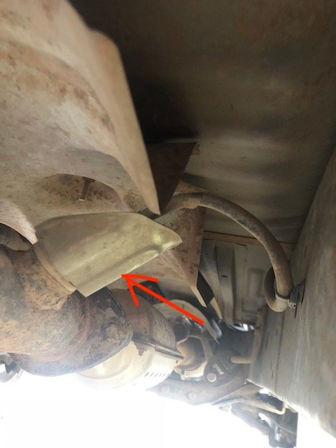

    Well, Amazon did it again. I typed in exactly what I wanted and they sent me the wrong part. I should have done a little more research to ensure I got what I wanted.
    Anyway, I thought I ordered the upstream 02 sensor (Denso 234-9001) but I ordered the downstream sensor (Denso 234-4189). I thought no big deal, my truck has 172,000 miles on it so while I'm waiting on the upstream sensor to arrive I'll change the downstream one. It's not that easy.
    I found where it goes into the truck and plugs in under the seat. However, I cannot for the life of me see a way to get to the bolts due to a cover over the sensor. I thought it was a 12mm but maybe it's stripped? And if its stripped or rusted I see no way in getting it off without cutting involved. I searched on youtube and the forum and couldn't find a write up for this particular one.
    Also, is it even necessary to change the downstream sensor?
    Here's a picture of the cover over the sensor.

    Bend it away. If it breaks no biggie. Most don't have that shield anymore.
    Heat the nuts red hot with a propane torch and use channel lock players to remove the rounded off nuts. Take your time. Works every time.

    The nuts are a special nut and soft. They were like $6.00 each. Get 3 Incase you drop one and can’t find it like I did. I changed mine on my 2002 and it wasn’t that hard to do. I don’t recall the shield being a issue but it’s been a couple years since I did it.

    I cut that little shield with my angle grinder about 3/4 of the way so I could move it aside. Then just bent it back into place

    I recently changed mine on my 02, didn't have a problem getting a socket in there and taking the nuts off intact. Guess I was lucky.

    Dude, super easy with a 1/4" or 3/8 stubby ratchet. I think I used a 1/4"... Get a deep socket and slips right over the nuts and off it comes. I had zero issues and bent or destroyed nothing. I hit it with some penetrating oil after a drive and let it cool a bit. I don't even know if that was necessary. Both sensors came right off super easy. I cleaned the gasket mating surfaces and voila.

    I forgot I used to have that shield. I remember it being a pita to change the o2 sensor because of it. I just cut it off.
