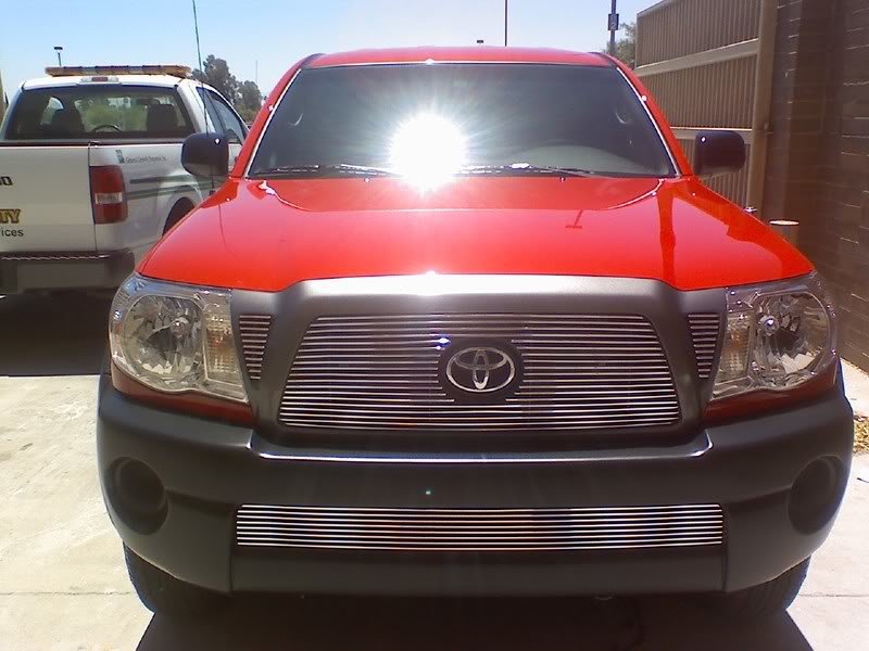

    As you can see below... I have no fog lamps on my truck. I was wondering if anyone has advice on a good set of fog lights, that might have nice "close to OEM" switch that will fit in the switch panel? Some pics would be nice if you have them. And maybe a rough estimate on price.

    Piaa lights are really good quality. I would go with the 4" Piaa 510 series. They are metal with real glass lens. Made in Japan, not China like most lights are. They are expensive but well worth it. The wiring harness and swith that come with them are also real high quality.

    I just added OEM fog lights to my brand new 08 double cab Taco. It is so easy, my Obama supporting neighbor coud have done it! My Taco was pre-wired and the harness is easily visible from underneath in the general proximity of the fog light holes. The first item to check is that your Taco is pre-wired. If so, all you need is around $350.00 and about 15 minutes.
    Step 1 after removing the insert hole cover from the bumper is to simply line up the retainer clip on the fog light assemble with the retainer hole and push in from the front of the bumper. Both lights can be installed in 5 minutes easily. The plastic tape like material that holds the harness can be easily cut with clippers/small scissors and the wire harness plug clips on to the light bulb plug. It is easy to remove the light bulb from the fog light assembly, so if you have difficulty seeing, or have huge hands, then simply remove the bulb from the fog light assembly, plug it into the harness and re-insert the bulb in the fog light assembly. Both driver and passenger sides are identical.
    Second step is to insert the relay for the fog light. The relay box is located on the inside of the engine compartment on the drivers side, right above the front wheel. The box is a plastic black box with a latch on one side and two clips on the other. Remove the cover and on the inside of the cover there is a template showing exactly where the fog light relay goes.Align the blades and plug in the relay. Another 5 minutes if you are not concentrating.
    The third step is the most senitive since, if you slip you could scar the plastic around the dashboard where the new switch will be installed. The fog light switch goes in the slot closest to the driver side door. If you are not sure where it is, the owners manual shows you. The existing blank cover can be easily worked out of the hole with a very small screw driver or sharp pointed object. Simply work the blank out a little at a time by using the sharp object to gently pry the cover out from the top and bottom of the blank. In other words, stick the sharp object into the switch cover blank that slightly protrudes from the dashboard and pry it out a little at a time. Repeat from the top and bottom and be careful not to poke your self or scar the dash board. It may sound more difficult than it really is. Once you have the blank cover removed, the wiring plug that connects to the switch is attached to the blank and is removed and plugged directly on the OEM switch.
    I thought about taking pictures, but that would have taken longer than installing the lights, relay, and switch.
    The parts that you will need are:
    Qty (2) 81210-AA030 Fog Light Assemblies $143.00 each
    Qty (1) 90080-87010 Relay $16.81
    Qty (1) 84160-04010 Fog Lamp Switch $34.75
    I bought the parts from 1sttoyotaparts.com, paid a little extra and received them 2nd day.
    I like the OEM solution since it is easy to install, looks great, and the lights are adjustable up or down so you do not inadvertantly blind someone with a mis-aligned light beam.
