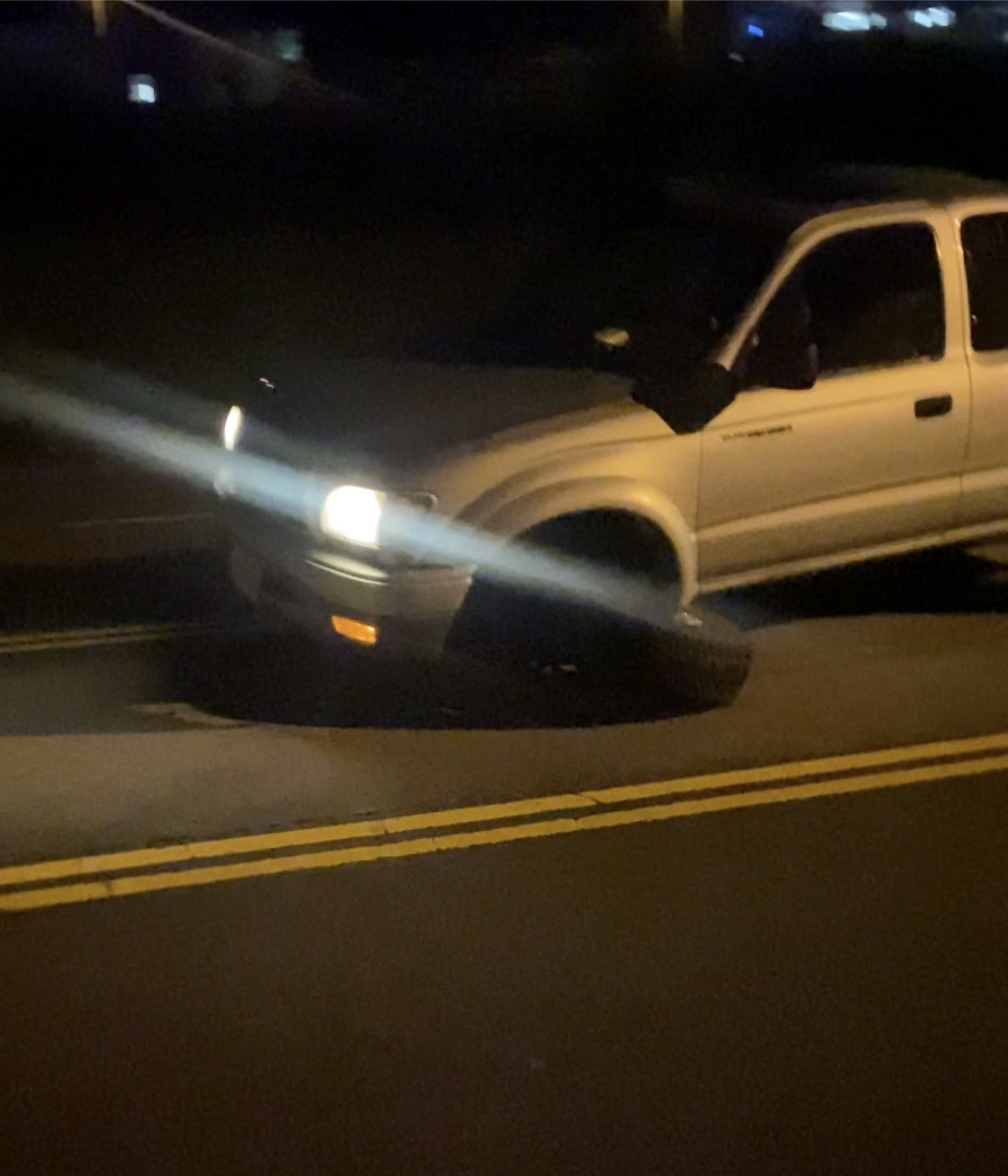

    Lower ball joints should be OEM and replaced early and often to avoid that picture.

    I will add I personally would say OEM for the LBJs and steering rack specifically, everything else I wouldn’t be as worried about. The LBJs because they can cause the failure shown in your picture, and steering rack because I’ve had multiple aftermarket’s leak and fail. Personally I don’t see an issue with saving some money on other parts that likely won’t catastrophically fail.
