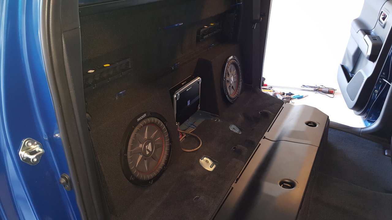

    I have a 2019 TRD OR with the JBL system and I absolutely hate it. So, that being said, up into the attic I went to see what I had from previous installs. I'm definitely not against removing the head unit if I can keep the steering wheel controls. Ultimately I'd like to have the same sub setup as in this pic (it came from this site). Here is what I have:

    Get the PAC AmpPro and don’t worry about swapping the head unit. This will get you flawless audio signal to pump into the LCQ-1.
    Ditch the copper clad aluminum wire and get OFC (oxygen free copper)
    I won’t touch CCA in my shop (and most other installers I know won’t either
    Speakers are a huge subject. Ask 100 installers and you’ll get 100 different answers. Get the nicest ones you are willing to spend the money on.
