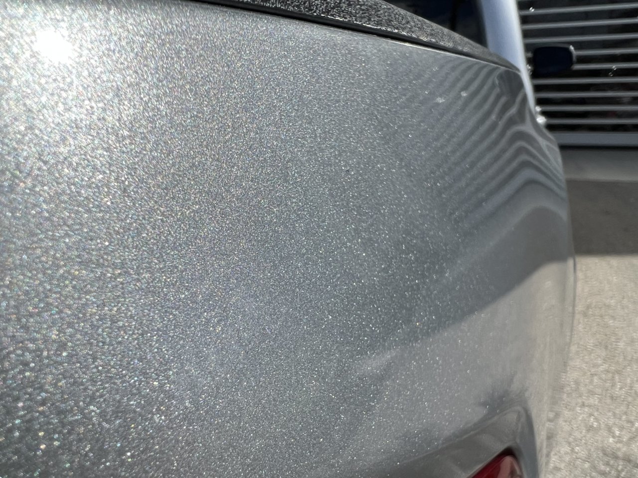

    So, just as a follow up, I just met with the dealer and with the Sherwin Williams rep. Everything that was said pretty much agree with what’s the post of us thread. I was going to walk and just take the truck. but seeing the difference with the truck in the sunlight was killing me. The rep was trying to tell me that if he blended it into half the tailgate, I would never see the difference, pretty much what was said here with blending. But then I told him I run into a problem with the cab being different.
    So he explained to me about the way factories paint with machines vertically versus horizontally by hand and about how to mixes vary because of the way they contract out jobs.
    I’m not sure if that’s 100% correct or not, but since they save the exact mix that they used on file, they said they would be willing to disassemble everything and re-spray panel and get it to match closer. I asked the pivotable question, “what happens if it turns out worse?”and he replied, “it won’t because we won’t call you.” Lol
    Anyway, it worked out good too because they’re going to order me a new tail light due to some fitment issues.
    Tried to take a few better pictures in the sunlight:
    1ED32C04-B269-4B25-8472-8D69C0F9A9B2.jpg CD7D2045-C961-4A63-A2B4-23B6399216E9.jpg
    (It’s too bad I can’t get the whole truck redone… the new paint has more metallic and looks better than the factory, IMO)
