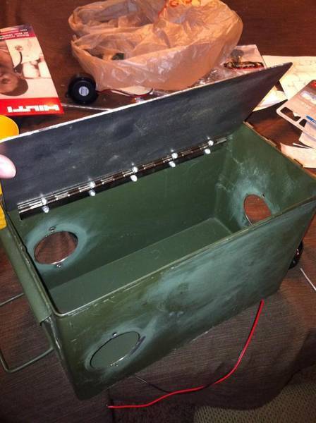

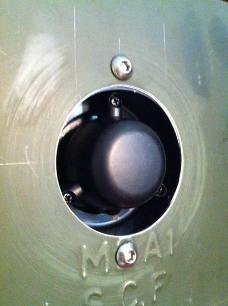

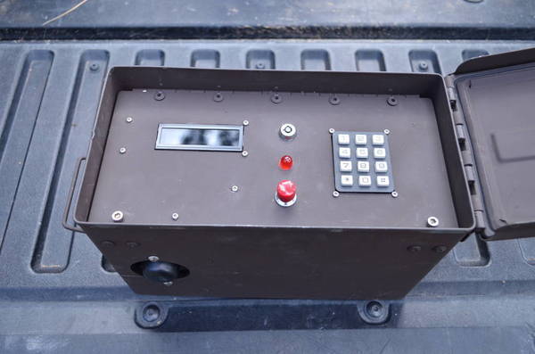

    Ok so here she is from inception to completion...
    1. The ammo box prepped for sirens

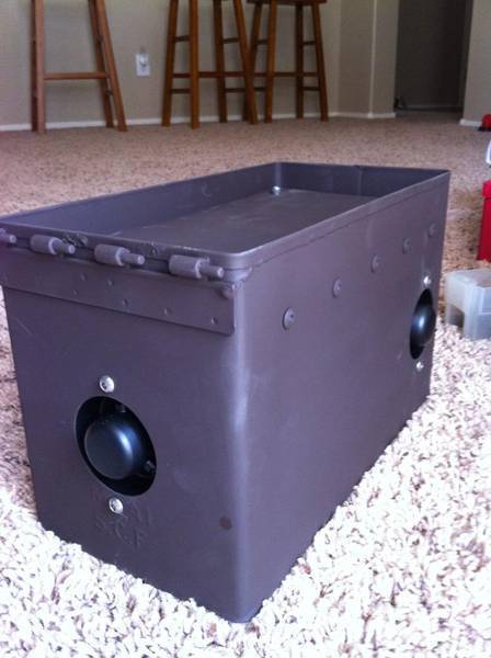

    2. 3 110db 12v sirens
    3. Inner lid for LCD, keypad, buttons and LED riveted in, sirens installed, and box painted flat brown
    4. Internals all installed

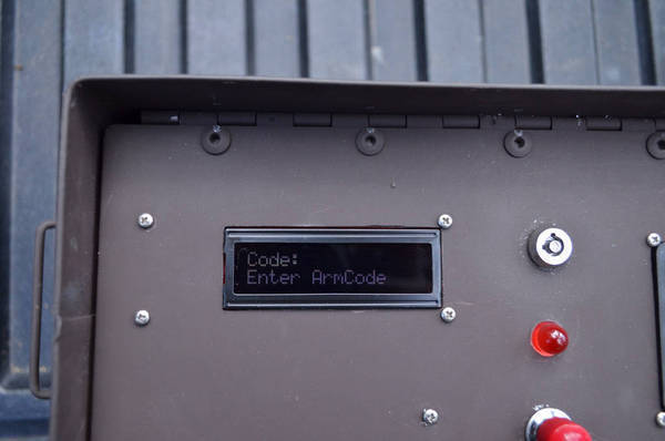

    5. Once the barrel key is turned on, it loads the program and prompts for an arm code (7 digits of our choosing, or more if coded)

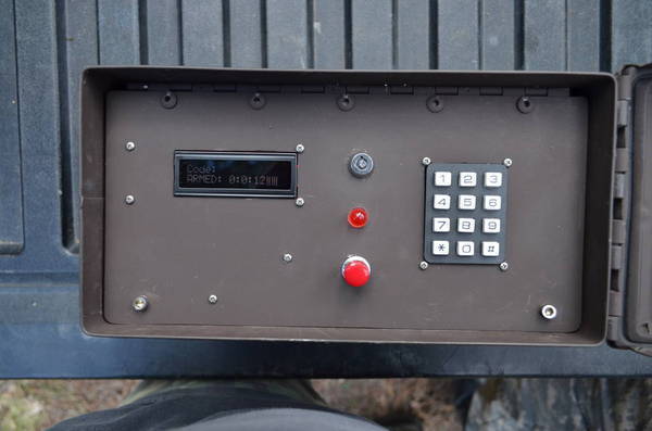

    6. Once the arm code is successfully entered, the countdown starts. The red button is there so the arming team can manually press and alert the siren to notify everyone on the field that the bomb is now armed (my new code will do this automatically). If the wrong arm code is entered, the screen clears and you have to start the code over. The countdown timer can be changed in an admin mode. As the box counts down, it beeps and the LED flashes once per second. As it gets closer to detonation, the beeping speeds up. A separate disarm code must be entered before the countdown timer completes, or else the 3 sirens sound for detonation. You can hear it a LONG ways away.

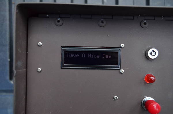

    7. Upon detonation if the disarm code is not entered successfully and in time, a friendly message is displayed
