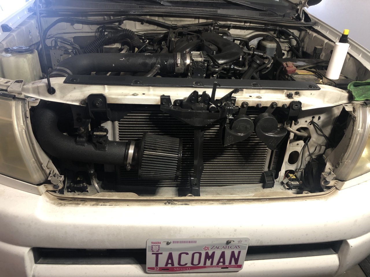

    I installed a urd cold air intake few years back and love the out come !!!!IMG_7141.jpg
    BassAckwards and TegoTaco like this.
